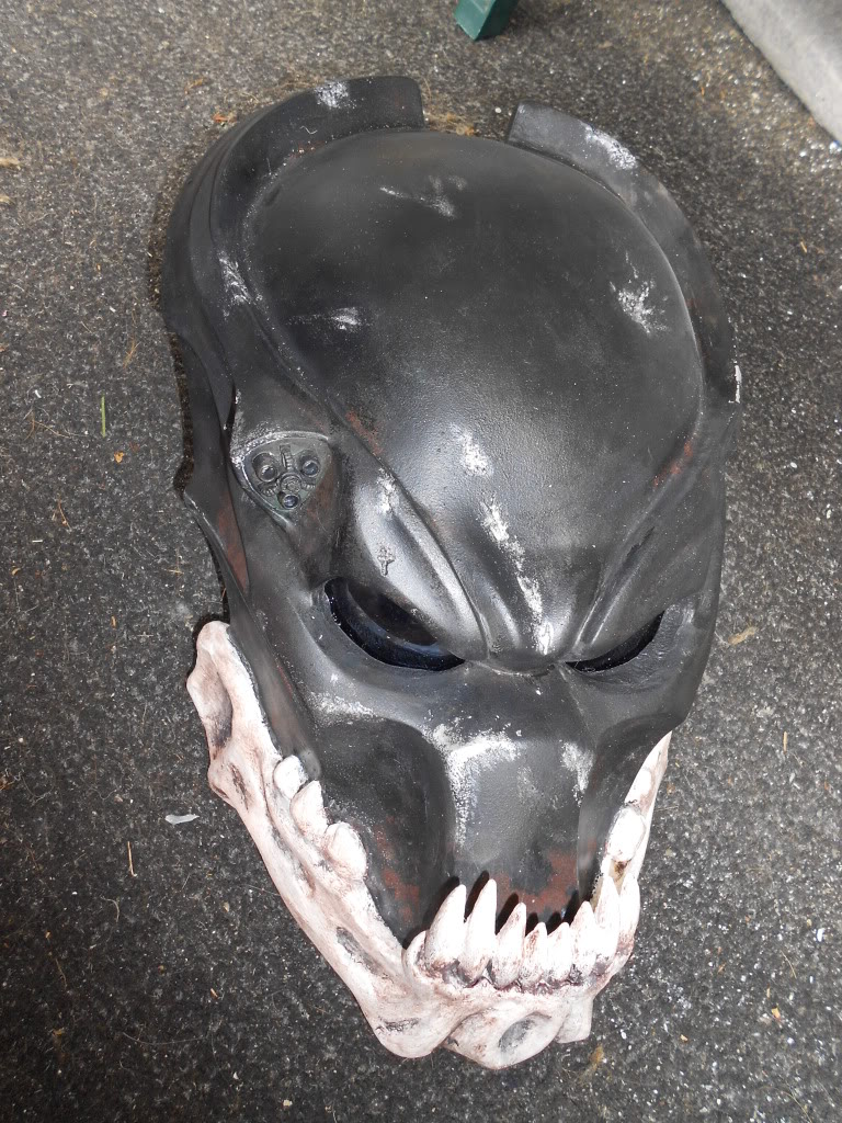

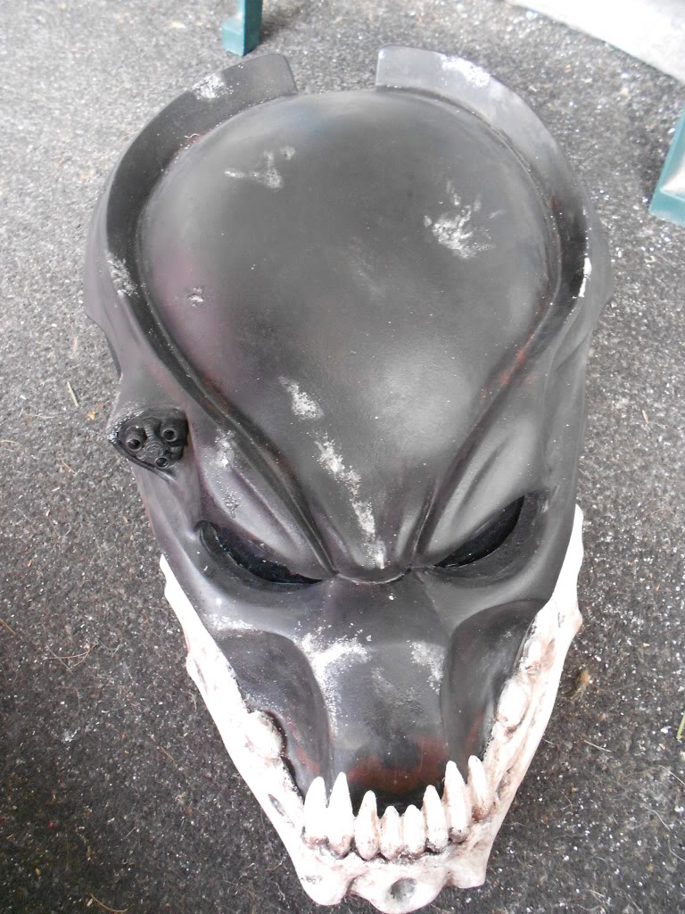

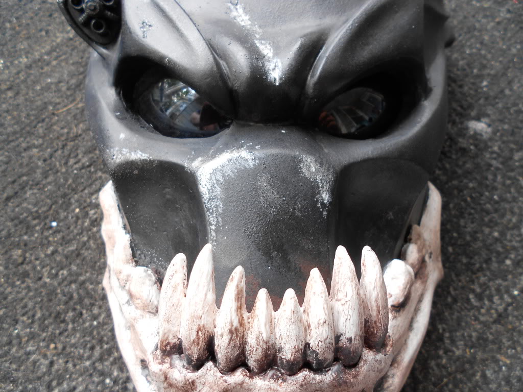

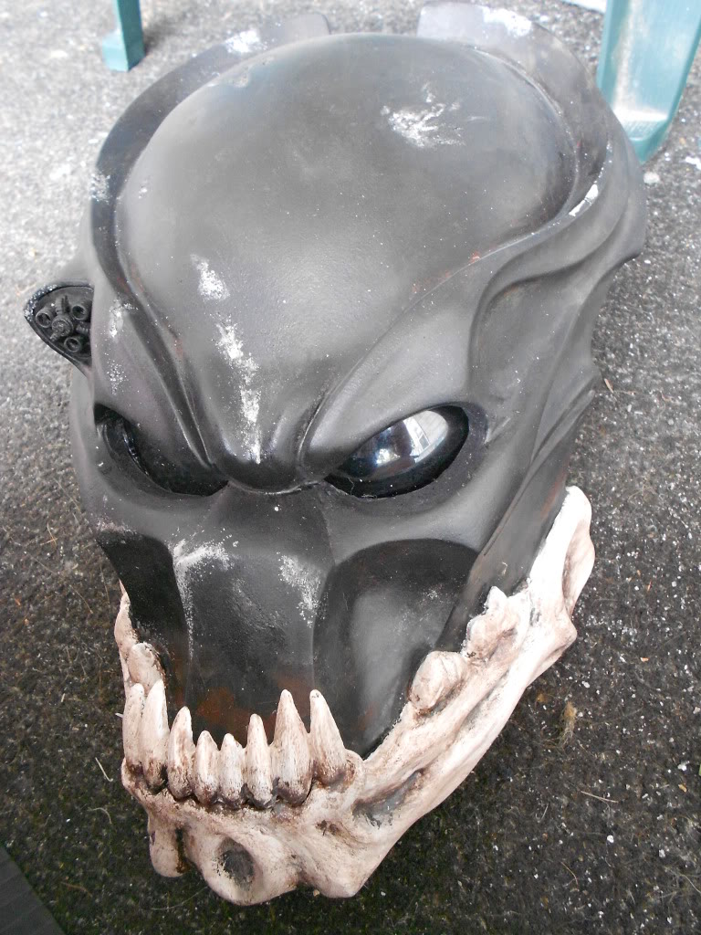

Well, I repainted my Mr Black Bio. I wanted to try out a new weathering technique [new to me] and that is Salt Weathering. Overall, I think it gave me a more realistic look at where the paint would come off battle damage. Pretty much painted it up the same way as before, but I added some more browns and greens to try and make it look like I took it right from Mr Black during the end battle. One thing I did do different was that I didn't use a gloss sealer for the bio, I used Matte on both the jawbone and bio sections. Also, some pics make the jawbone look white, but it's just the sun and how the camera took the pic.

Thanks for the comments guys, greatly appreciated. It's making me want to repaint my Broken Tusk bio and make it look more damaged and banged up. Take a dremel to it and perhaps add more damage, put liquitex on the damage to make it look like the metal on the bio was was torn out more. I've been thinking of doing the salt weathering technique with the ancient gold and reds on the bio.
I like it! Personally, I prefer the matte finish; that's what I used. Just feels more "real" to me, especially if it's supposed to look all dinged up, rusted, and what not. I have no idea what the salt weathering technique is that you mention. Video or website how-to-link?
Thanks. I agree with you too. When I do a bio I like to make it look like it just took it right from the battle itself.
