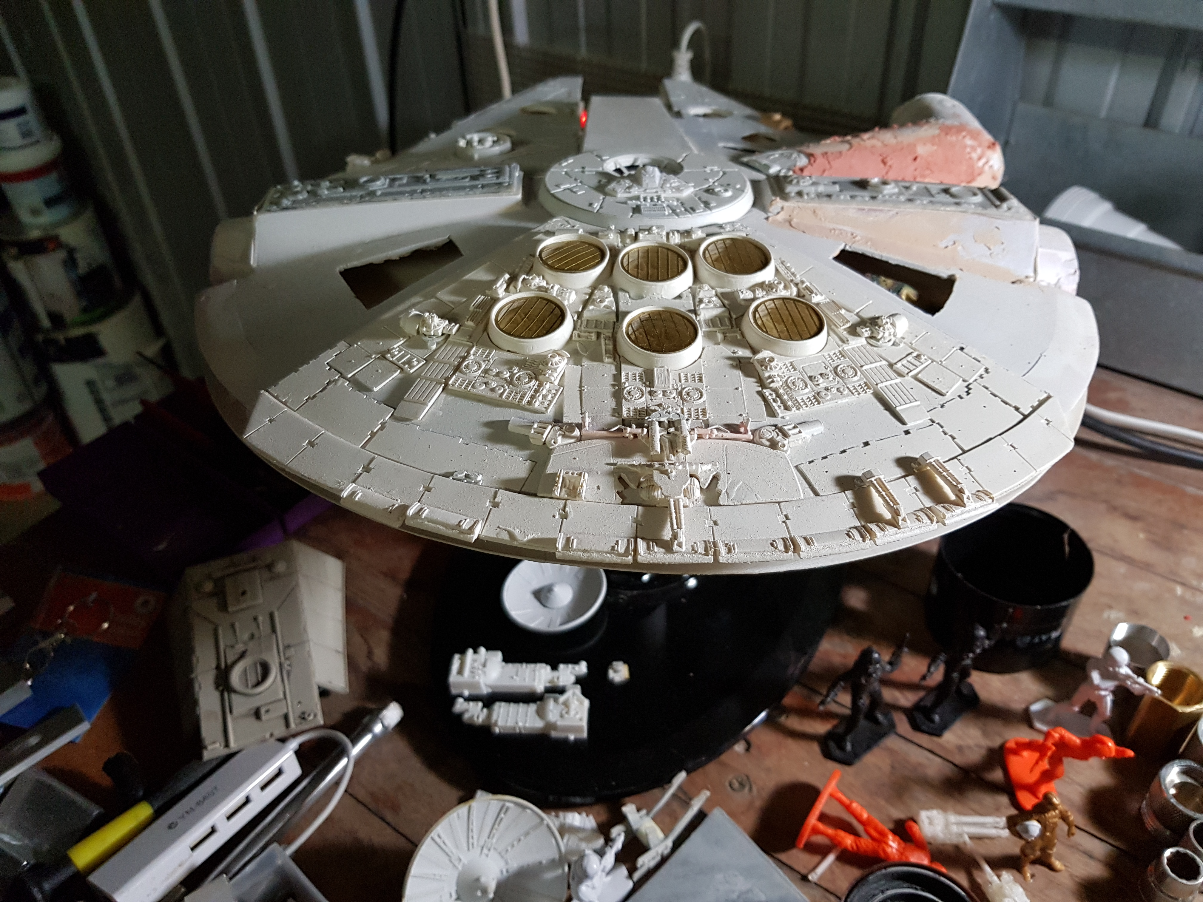

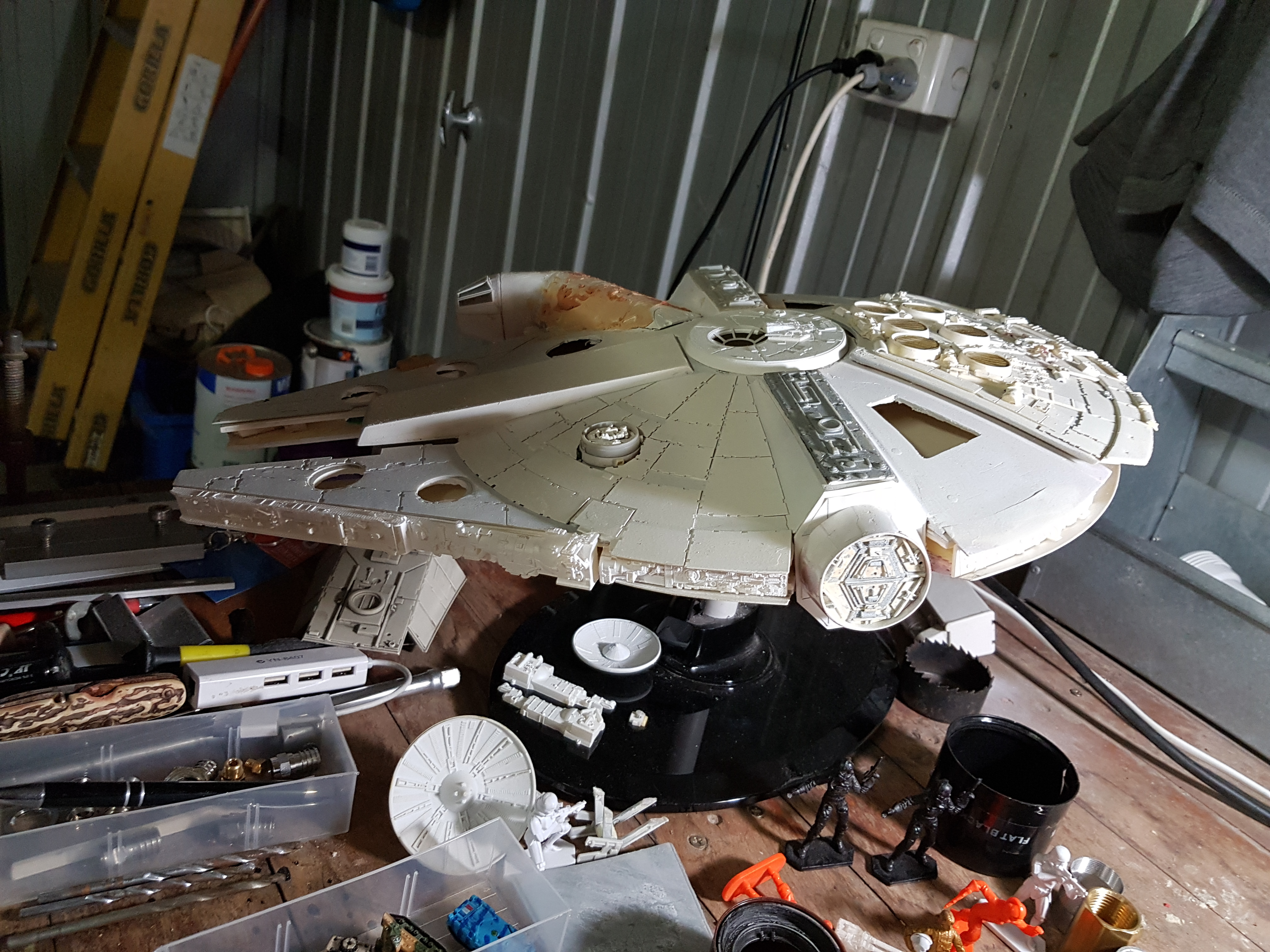

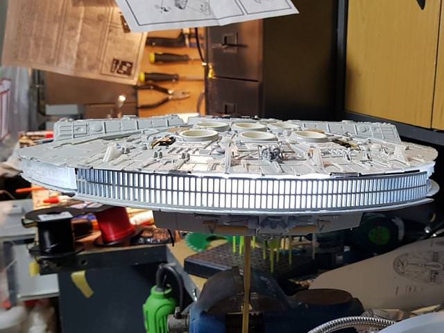

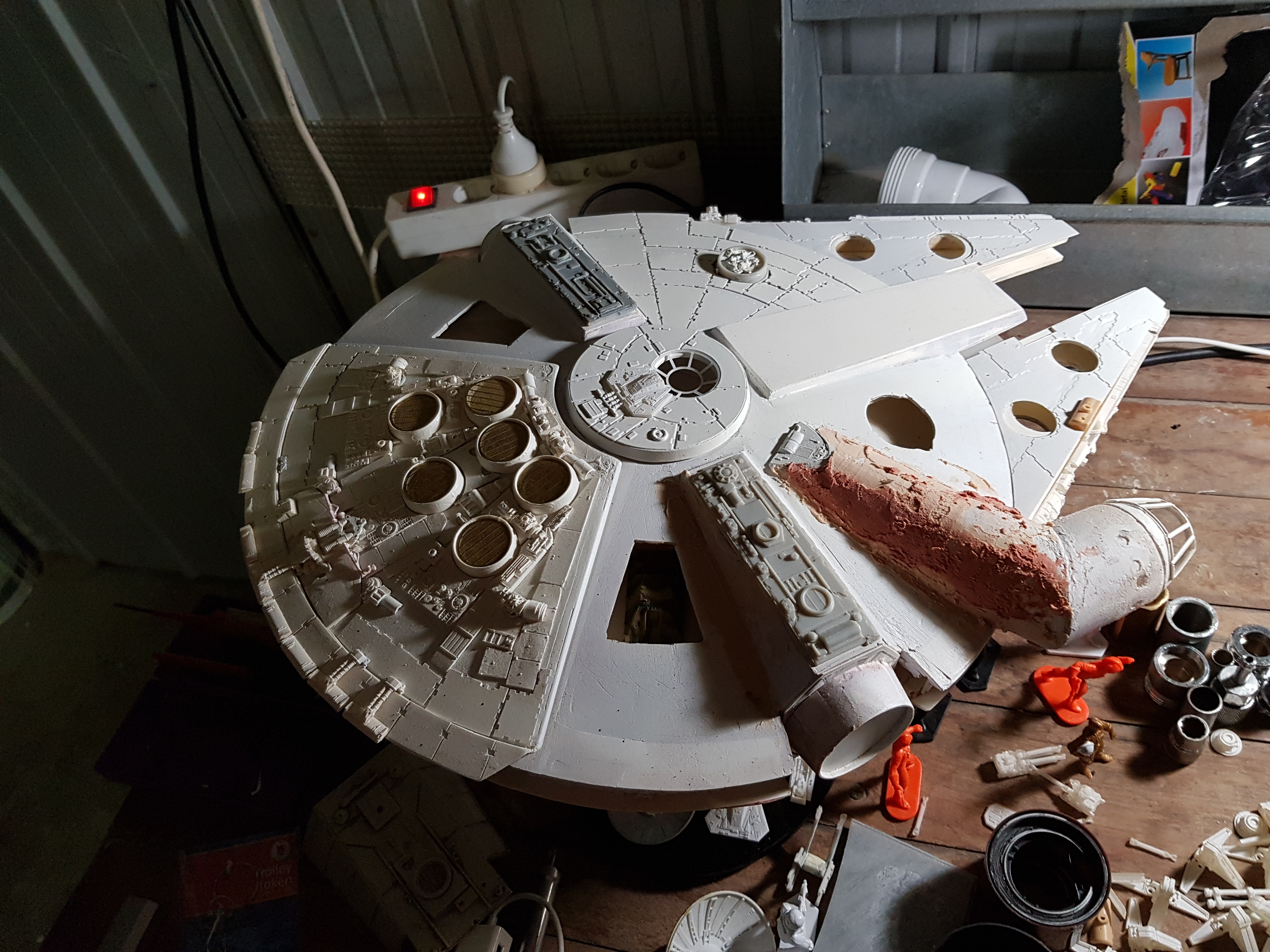

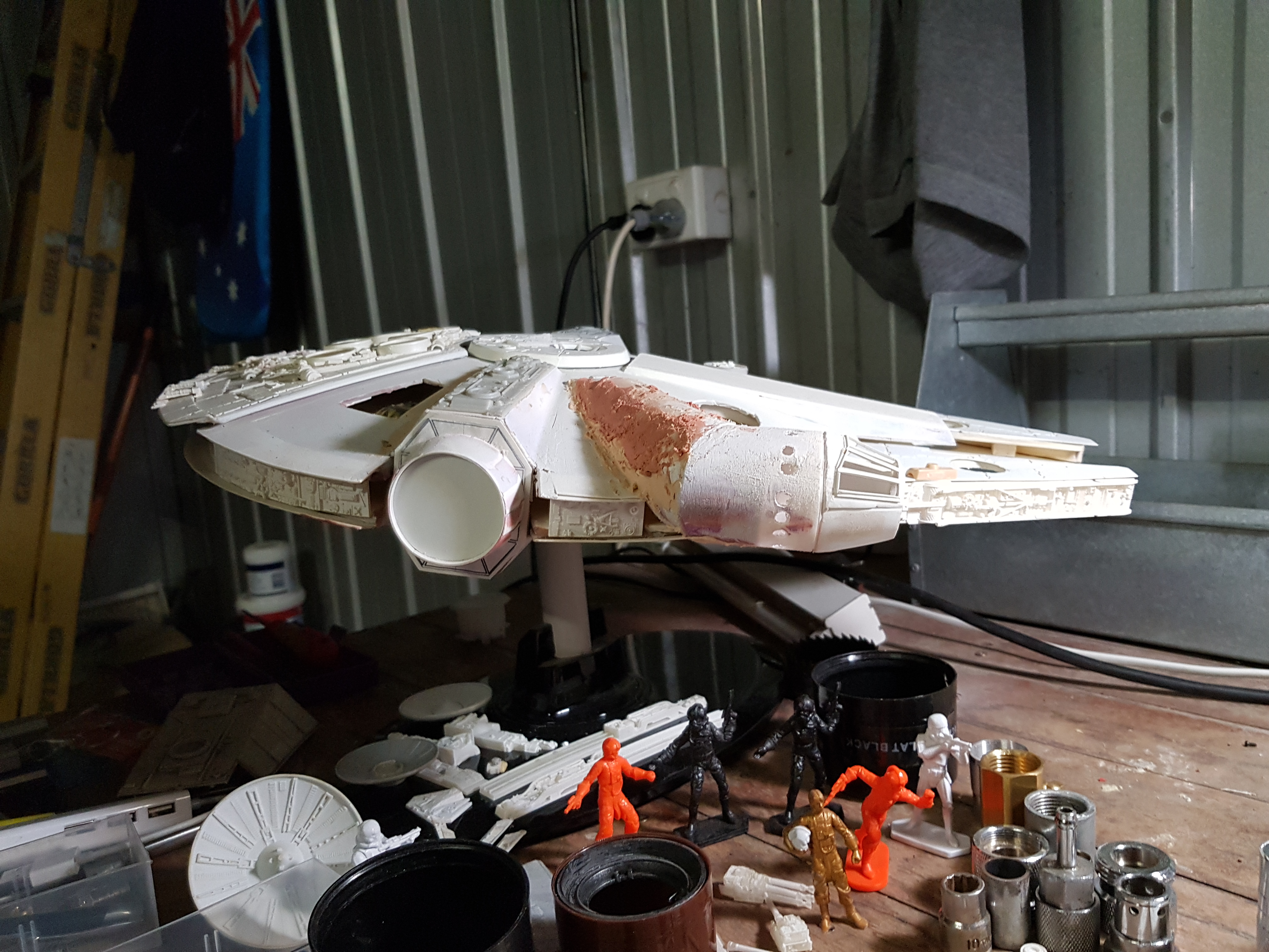

I've not done a lot, per-sae, except spend a great deal of time test fitting and figuring out how and where the 3D printed short walls fit; they don't come with any instructions??? This led to more sanding, grinding and a great deal of swearing when I discovered the inset discs on the mandibles sat too deep for the walls to fit properly. That is wher3e the swearing came into play during the careful removal of the glued pieces, filing/sanding them down without losing detail and still gain me the extra few millimeters I need. Then the center jaw sections were too thick as well, so I ground and filled them down and reworked the detail parts so the sat inside the jaw section. Of course, I only realized this after I added the spots on the lower jaw section.

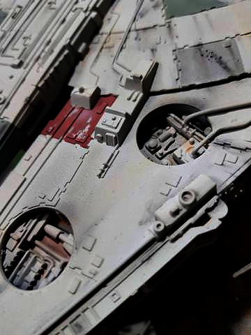

Once I was satisfied I could get the short walls to fit I went back to adding extra battle damage detail on the lower hull. The pieces supplied in the Blue moon kit for the side walls of the docking ring are will work on the starboard side but for the damaged port side I will be scratch building those from .4 & .5 styrene sheet. To get the best approximate look for the tear I ground down the incredibly thick plastic from the inside and then used a fine pointed file and exacto to carve out the damage along with adding some thin styrene cut and shaped to fit the jagged areas where the plastic broke while shaping.
I'm still working out how best to fill the gaps around the lower cockpit tube after assembling the top and bottom halves, but that is still a few weeks off. So before then, I'll be doing the lower hull floodlights and lighting box for the engine.

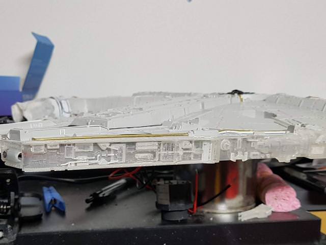

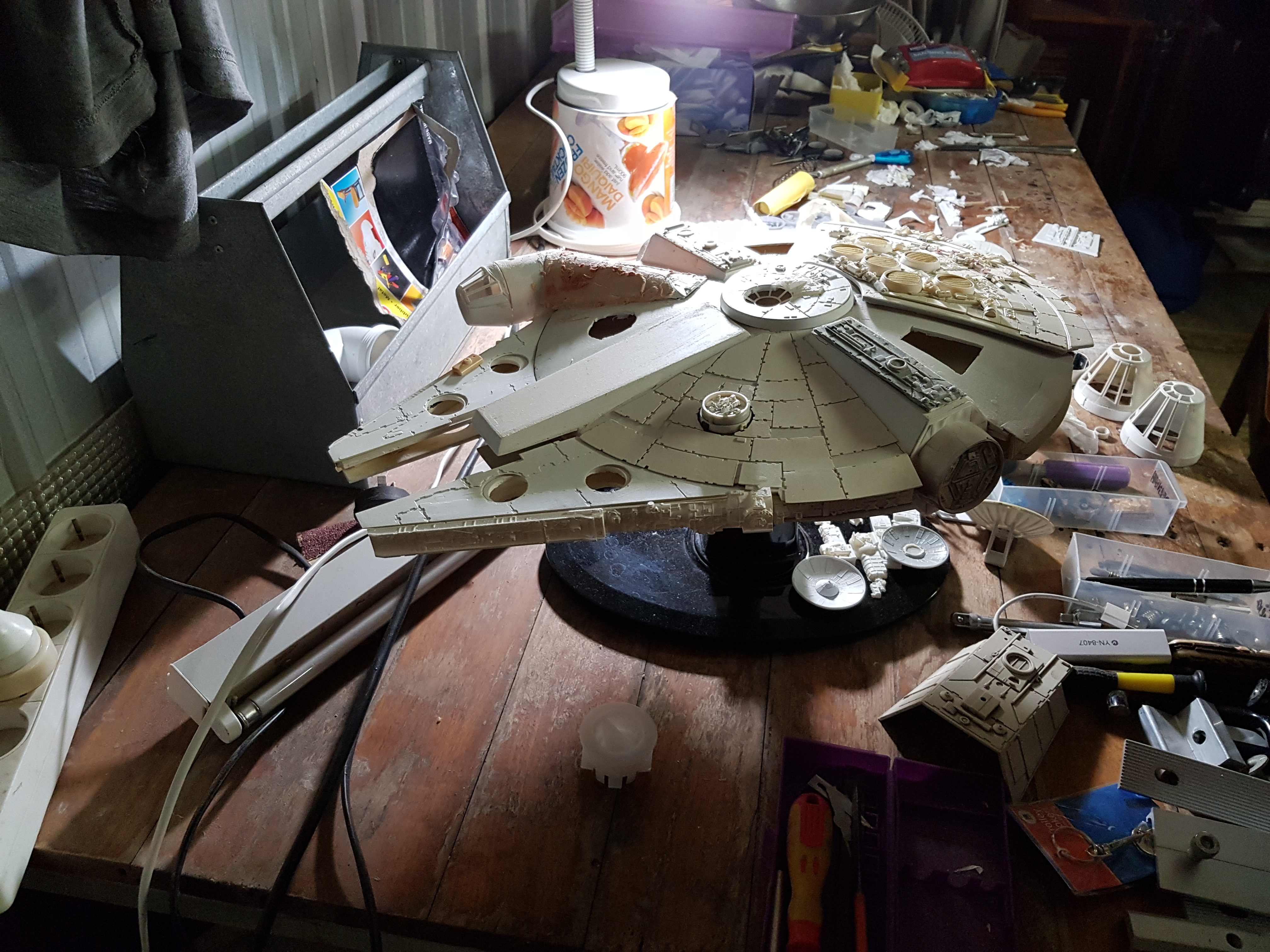

https://i.imgur.com/GXsCpzA.jpghttps://i.imgur.com/sDkf1rX.jpg
https://i.imgur.com/8pUiLGB.jpghttps://i.imgur.com/BS0Vehr.jpg

Can anyone share their method for revising / reconciling the cockpit tube to the shortened sidewalls? Looking for technique as I'll be starting my MPC build in the near future and want to document different heavy-lifting areas.
Hey dude, I can tell you if you get HH set it will come with a usb stick that kinda shows you what to do with his, but basically you shave off the stock wall locator strips from the top and bottom hull and stick them on that edge that you shaved off. Also, HH comes as a thick cast piece. I took mine to the scroll saw and cut off the excess so they'd be easier to deal with. The Shapeways stuff just goes where the stock ones would go. Then of course you have to cut the locator pin barrels on the hull pieces shorter (you probably knew that) Also, I use the laserbond stuff in dabs on the inside to mocj things up, along with some good sticky masking tape. That'll help get set up for trimming and final locating of your new stuff. Hope that helps :thumbsup

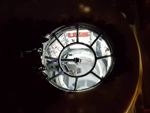

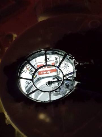

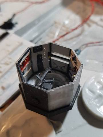

A quick update...

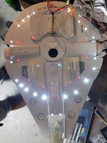

All the lighting is done with the final 'watch your head' fiber optics installed along with the two front landing leg pieces from Tony via Shapeways. My first run at lights for the engines went south; a costly exercise. However, the alternative with 5mm LEDs and a run of adhesive strip LEDs ended up giving me a better glow, which when seen through a thin sheet of acetate sprayed with dullcote gives a nice even glow.

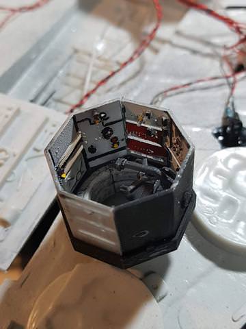

Over the weekend I finished the gun well, again from 308bits via Shapeways. For lighting, I added more LED strip lighting to the inside of the PVC tube along with an alfoil for reflection. There are no fiber optics in the walls. Tony does make them with holes to take thin fiber optics, but mine is all done with backlighting through the translucent parts. And no the wells aren't that bright. The auto iris on the camera makes it look very bright, but in reality, the lighting is a lot softer. The two with the black background was taken with all the lights in the garage/workshop turned off. I tried replicating the colors as best I could by referencing still images. I know some of it isn't screen accurate but for the scale, IMHO, it didn't turn out too bad.
I also added the side walls to the top hull assembly, which after finishing off the lower hulls detail, I should be ready to paint by the weekend.

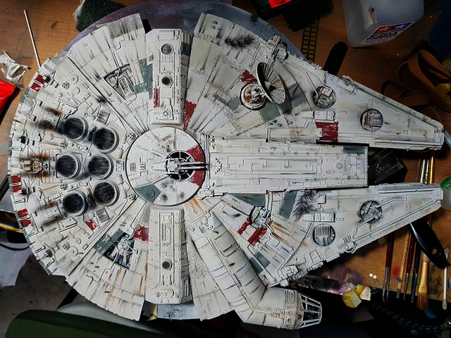

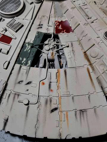

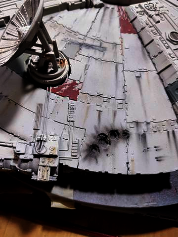

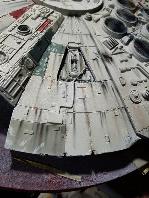

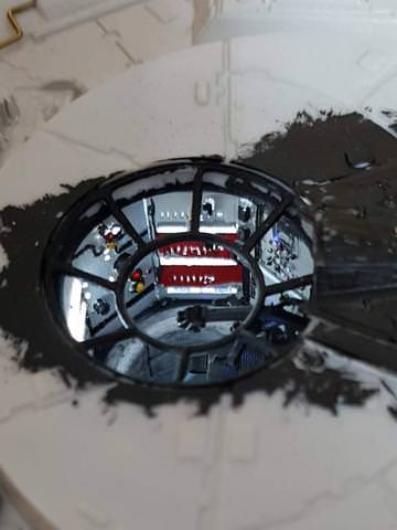

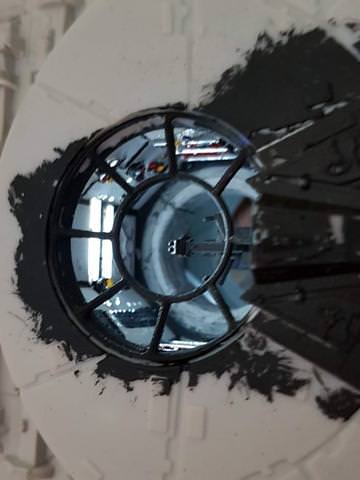

Painting the top hull over the last seven nights have, IMHO, yielded some good results. I would like to thank the RPF member, I'm sorry, but I can't remember who, whose photos of the five footer were posted via links on RPF to an open one drive file along with those I downloaded, several years ago, from Starship Modeler which were put up via Fantastic Plastic. These have been a huge and invaluable aid in with my model.
I have tried to emulate the damage and weathering the folks in ILM did way back when, but I will be honest and say there is a little artistic license at play as well. The mediums I used have been chalks/pastels, Tamiya smoke, washes from the Games Workshop range and some dry brushing for highlights. All of this I did over a black and grey primer followed by pre-shading in flat black, then a coat of Tamiya deck tan and three thin coats of the hull color which is a custom mix from when I converted a 1/72 Revell Gato.
I know I've said it before but the paintwork for any Star Wars build is the clincher, regardless of how fine the detail is if the paintwork is poor the whole model is let down-
But wow! You've absolutely nailed the paint alad61, you should be proud of that build.
Tony's parts look amazing too, they don't look grainy like I thought they might
I guess when you posted this at first I saw it at work and the pics were blocked...IT guys:angry, and I forgot to check again on MY laptop...I think you did a bang up job with the paint, and honestly, yours looks very similar to mine and I'm pleased with mine. I will admit though, my painting skills are still evolving, but you've done a fine job with that build! I love MPC Falcons :D
https://i.imgur.com/eq86rmn.jpg?1https://i.imgur.com/6EoLtxQ.jpg?2https://i.imgur.com/khadkRr.jpg?2https://i.imgur.com/XDJtTLJ.jpg?2https://i.imgur.com/3WdpnOp.jpg?1https://i.imgur.com/47C5LeC.jpg?2
Almost for got, your gun well looks killer! I may try that next time myself, the amount of FO to do those right can be extremely cumbersome
Hah! I also just noticed you bought the FUD smooth gear boxes, excellent choice. they are SO much better than the white a flexible with that funky texture and well worth the extra 10 bucks. I was the one who asked Tony for those in FUD and they/he did NOT disappoint! :thumbsup

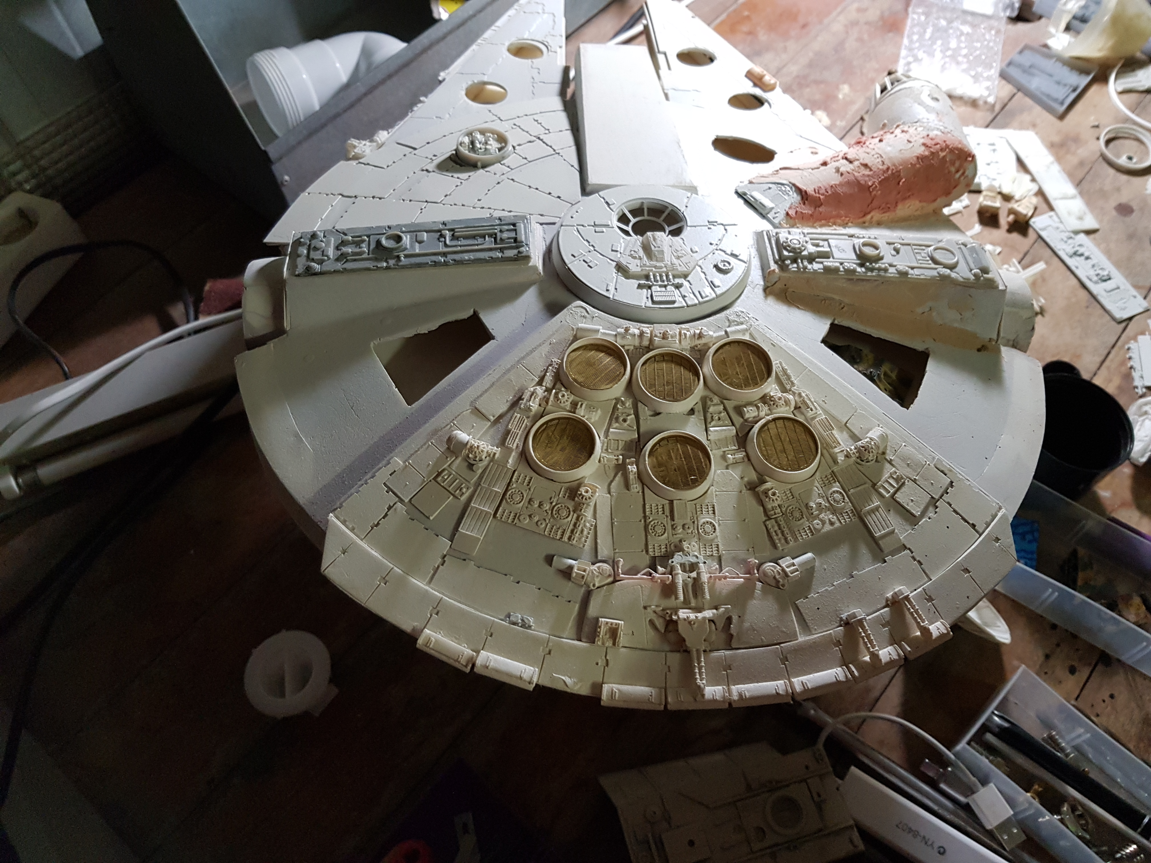

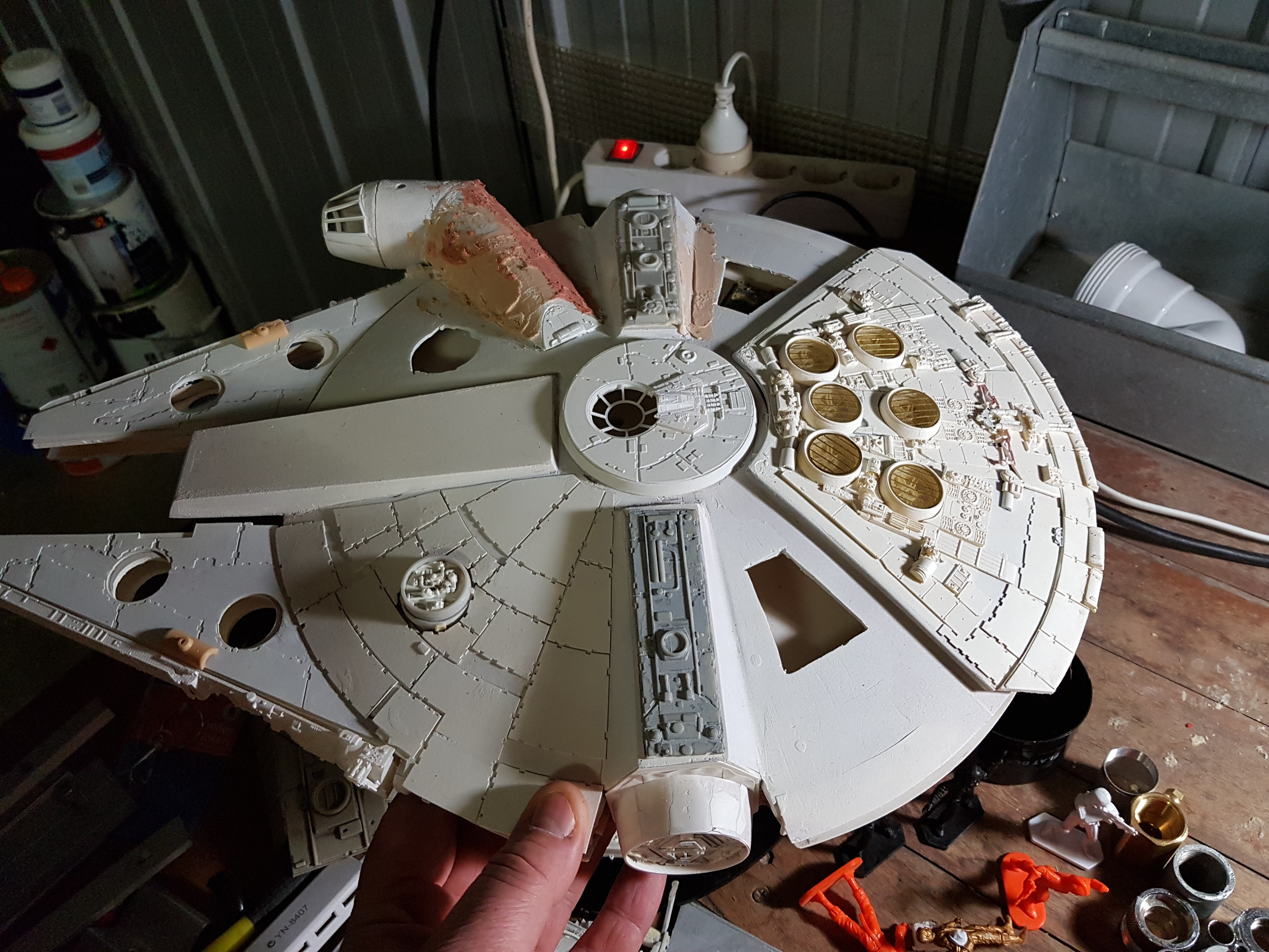

A quick update...
https://i.imgur.com/VlUtsvS.jpghttps://i.imgur.com/e8j8KMc.jpghttps://i.imgur.com/qO18p3p.jpg

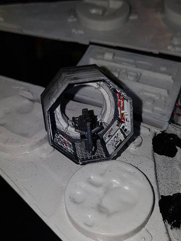

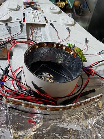

https://i.imgur.com/CpaS03y.jpghttps://i.imgur.com/b5hwlco.jpghttps://i.imgur.com/Vb3oOZy.jpghttps://i.imgur.com/mIXL32X.jpghttps://i.imgur.com/RWQz6c4.jpghttps://i.imgur.com/VxFfYEL.jpghttps://i.imgur.com/r0oqZOB.jpg
https://i.imgur.com/lhOTYnt.jpg
