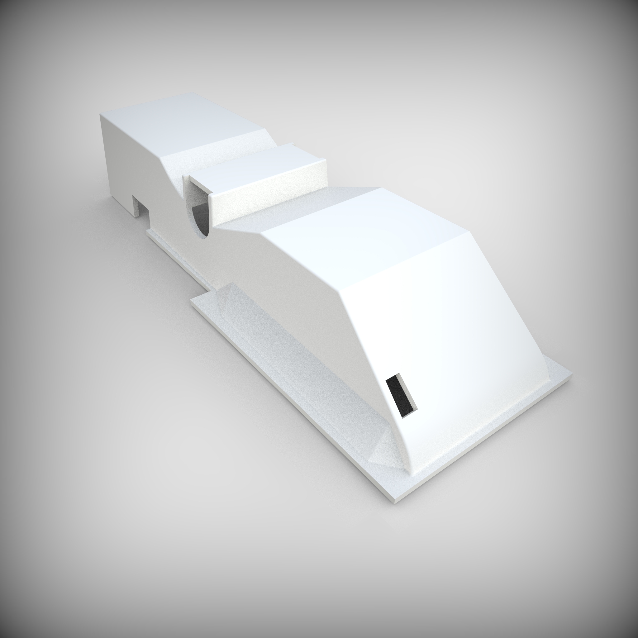

Thank you Andre for supplying the base model for this. I'll probably be posting versions of the "original" part and of ones that have been modified to fit the falcon dome. Also one with a thicker wall section for smaller builds (like my 32" scale).

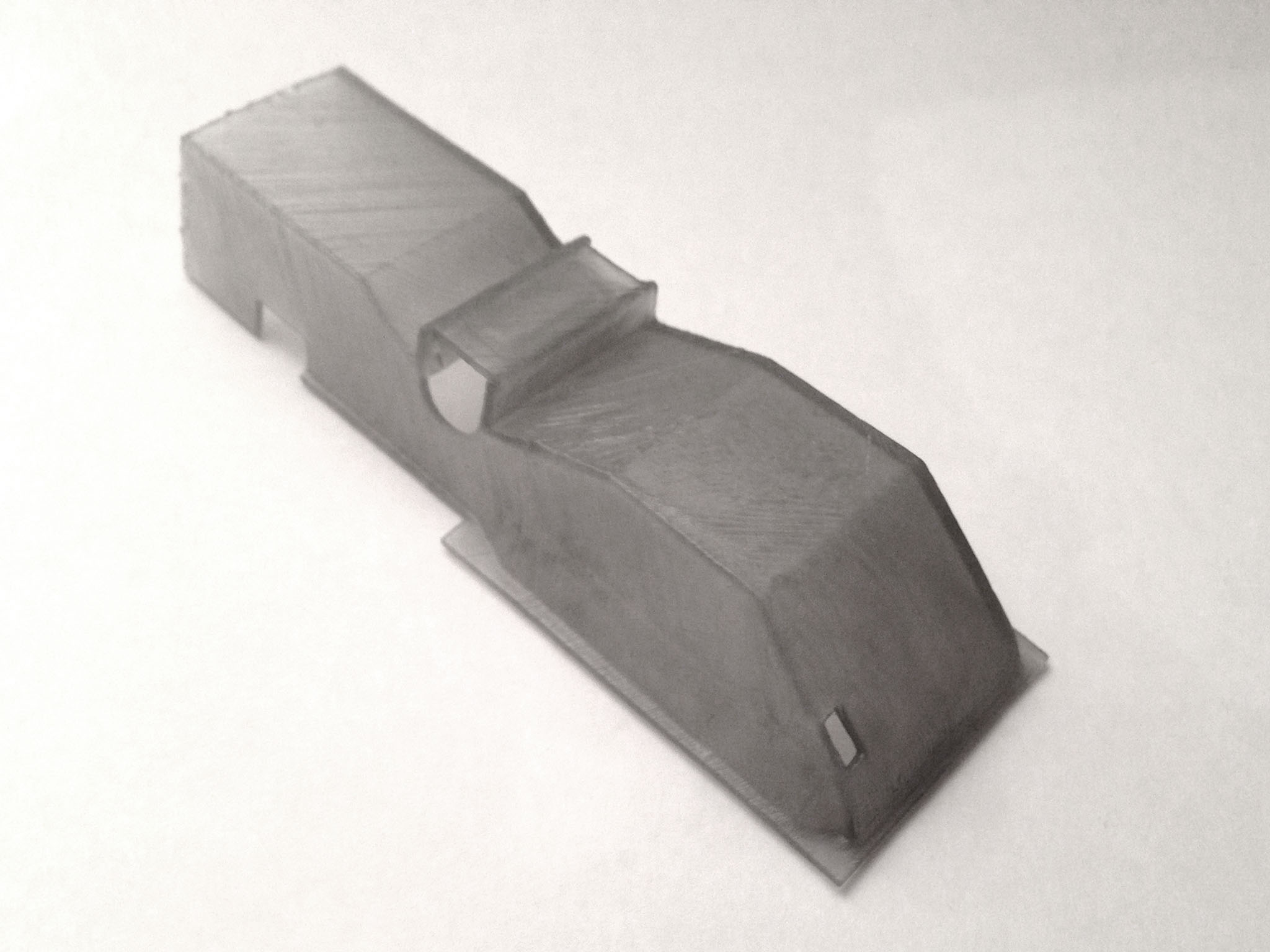

Here is a test print of the above mentioned part. The wall thickness of the original part is 0.05" - making the wall of this half scale print 0.025". Pretty thin!
I'll be modifying the file to have a thicker wall in places that aren't seen from the outside - to keep the appearance of the thin part, but a bit beefier for handling.

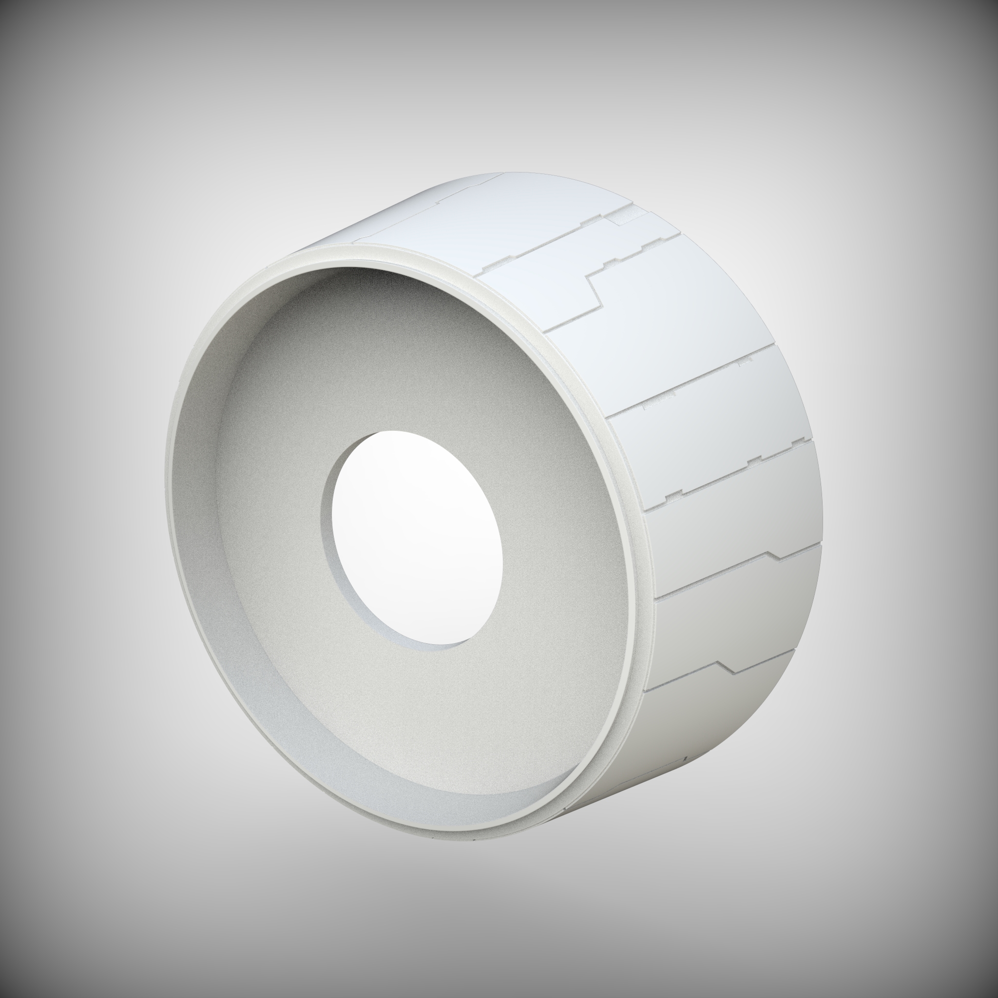

We built a generic version of the docking ring...
Then I traced the armored plates onto the generic ring using the 3D scan as an underlay to get exact plate lines. The plates were added to the generic model...
Next the plates were digitally unrolled from the cone shape to make a flat pattern...

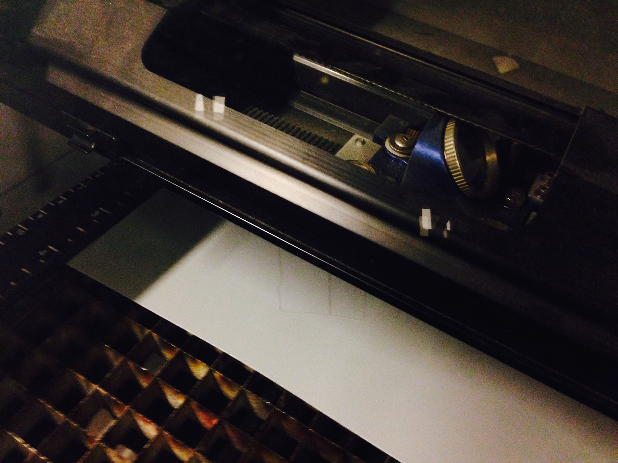

A little pew pew on the laser cutter...

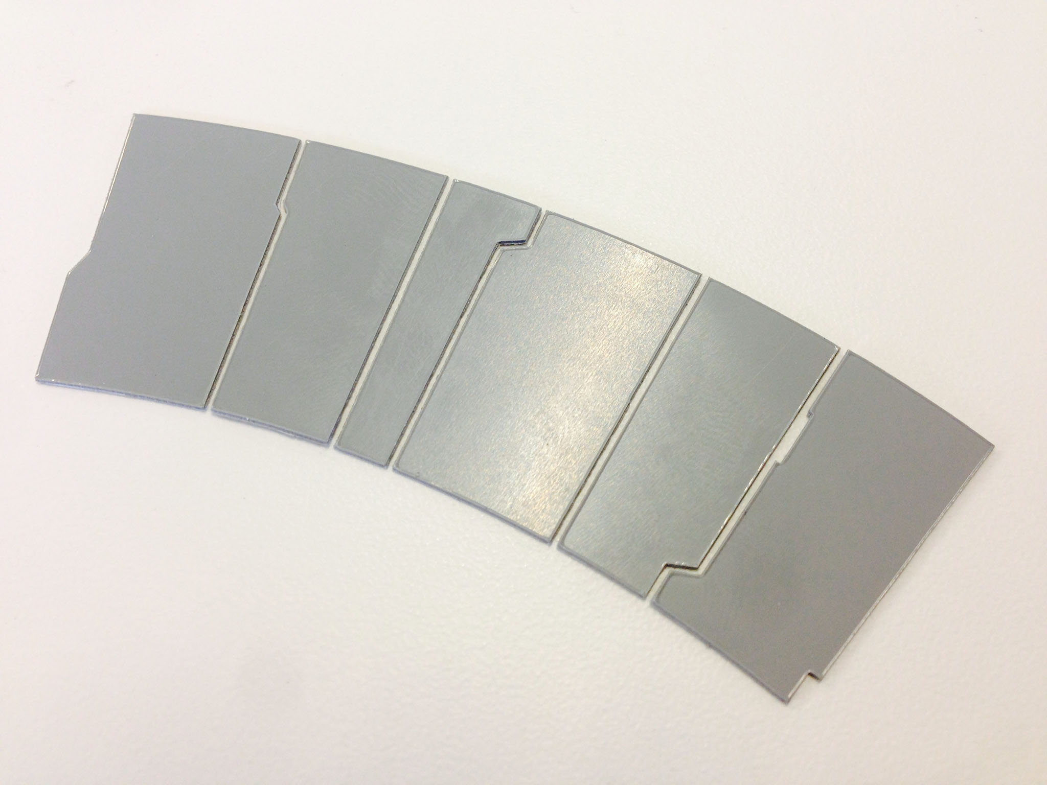

And I have plates that can be glued on!

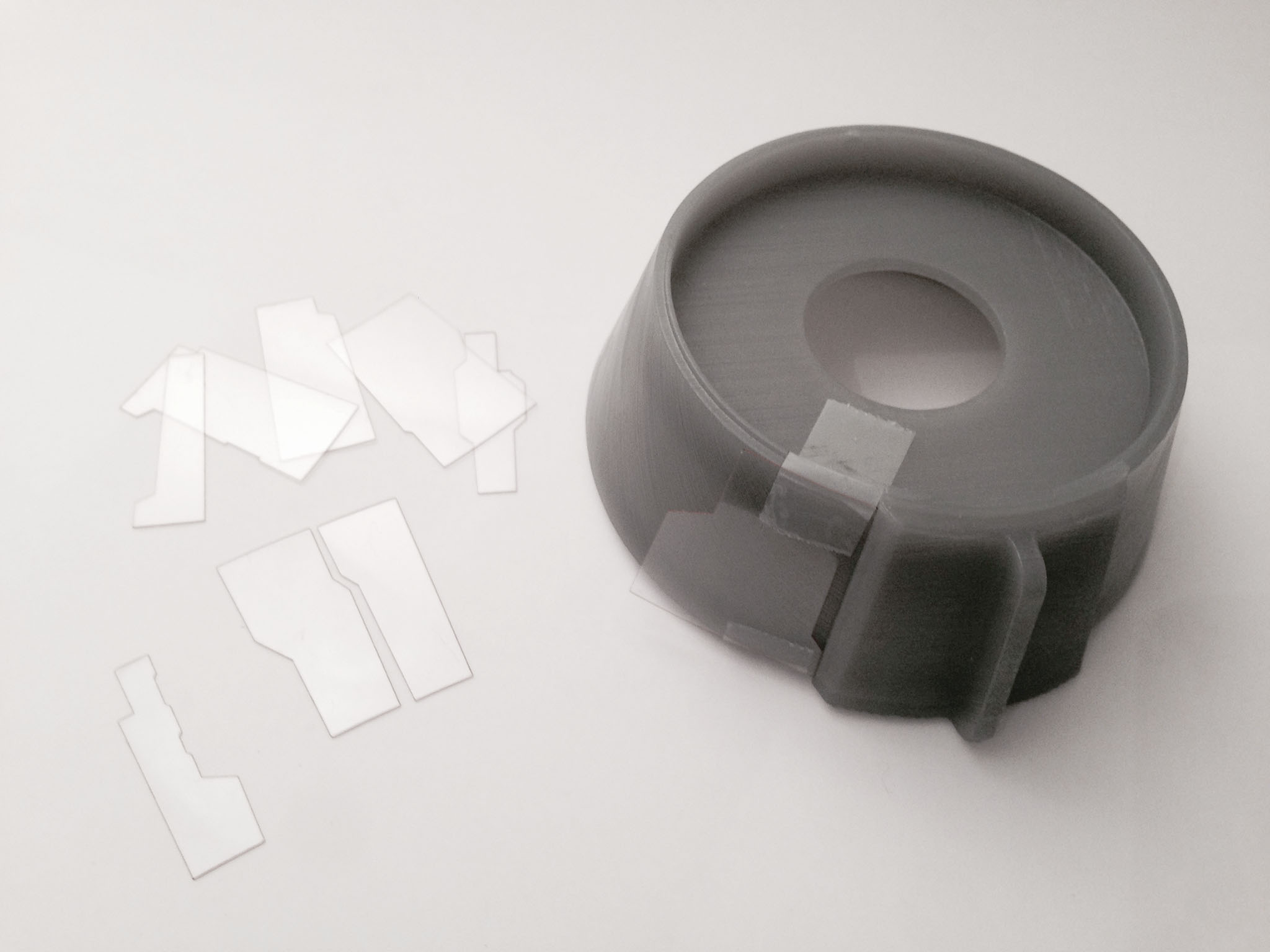

This is still a bit of a proof of concept. The digital method works well. Now I am experimenting with materials. The above photo show 0.5mm ABS - which gets kinda melty. I cut some in Polyester which are crisp and quite nice - but will be tricky to bond and finish, I think. Next I'm going to try clear styrene - which hopefully will allow enough of the laser's energy to pass through and prevent the heat from building-up. Also switching to a thinner 0.25 mm stock should help as well.
Regarding the previous post. I'm still going back and forth between gluing the plates on and just building them into the SLA. One of the benefits of the bonded method is that the surface finish will be exceptional. I won't have to worry about any surface defects in the printing as it will be covered. It also means I 'll have a lot of gluing to do. Not that that is new to anyone who has endeavored to build their own Falcon model...
One of the cool things about playing with the 3D printer is that I can print my own tools. Here I made a little part that clips onto the docking ring to aid in aligning the plates onto the cone such that I can keep the edges of the plate parallel with the convergence axis. A regular draftsman's triangle or carpenter's square wouldn't give the same result.
You can also see some of the polyester parts I cut. They are really beautiful. Next up will I'll be studying bonding materials to the SLA base and other types of materials to cut.

Some updates. I finally got around to working on the port-side docking ring. This one was a bit trickier as we didn't have as good a 3d scan of that side, so I had to employ some other photo projection techniques to get the placement of the parting lines correct.
I currently have Andre doing a peer review of the parts, then I'll post them to grabCAD for anyone who wants them.
I'll be posting them a few different ways: I'll post the 3D files of the starboard and port-side rings as shown - with the armor modeled in. And then another version as a blank ring and the 2D files for laser-cutting the plates, if you want to bond the plates on traditionally.
