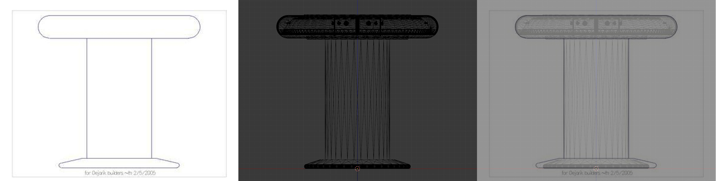

Hello you guys. I have a question about this table. I know that this table done in this thread is a very, very good replica of the original. I have seen many pictures of both and compare them carefully and I think that this is a terrific job.
I also took the 3D model in the PDF posted here and exported it to make an orthogonal comparison with another orthogonal drawing from the side that I have of the table that I got from the page of the Dejarik Builders Club on Yahoo and I found one discrepancy. The top of the table seems to be equal in proportions and so does the main support column but notice in the drawing I am providing the difference in the size of their bases. This triple image that I did was scaled to match.
The first picture to the left is the drawing I got from the Dejarik Builders Club on Yahoo, the second photo (the one in the center) is the orthogonal side view of the 3D model that was in the PDF provided here. The third picture to the right is the two pictures superimposed and notice how the base of the 3D model from the PDF is smaller than the base of the drawing from The Dejarik Builders Club.
Does anybody knows which of the two bases is closer in size or proportions to the original table? Or are both bases educated guesses and a little speculative and the best guess there is as good as it gets? I know that it may be hard to get the exact measures of the real table, does anybody know which one of the two bases is the closest?
