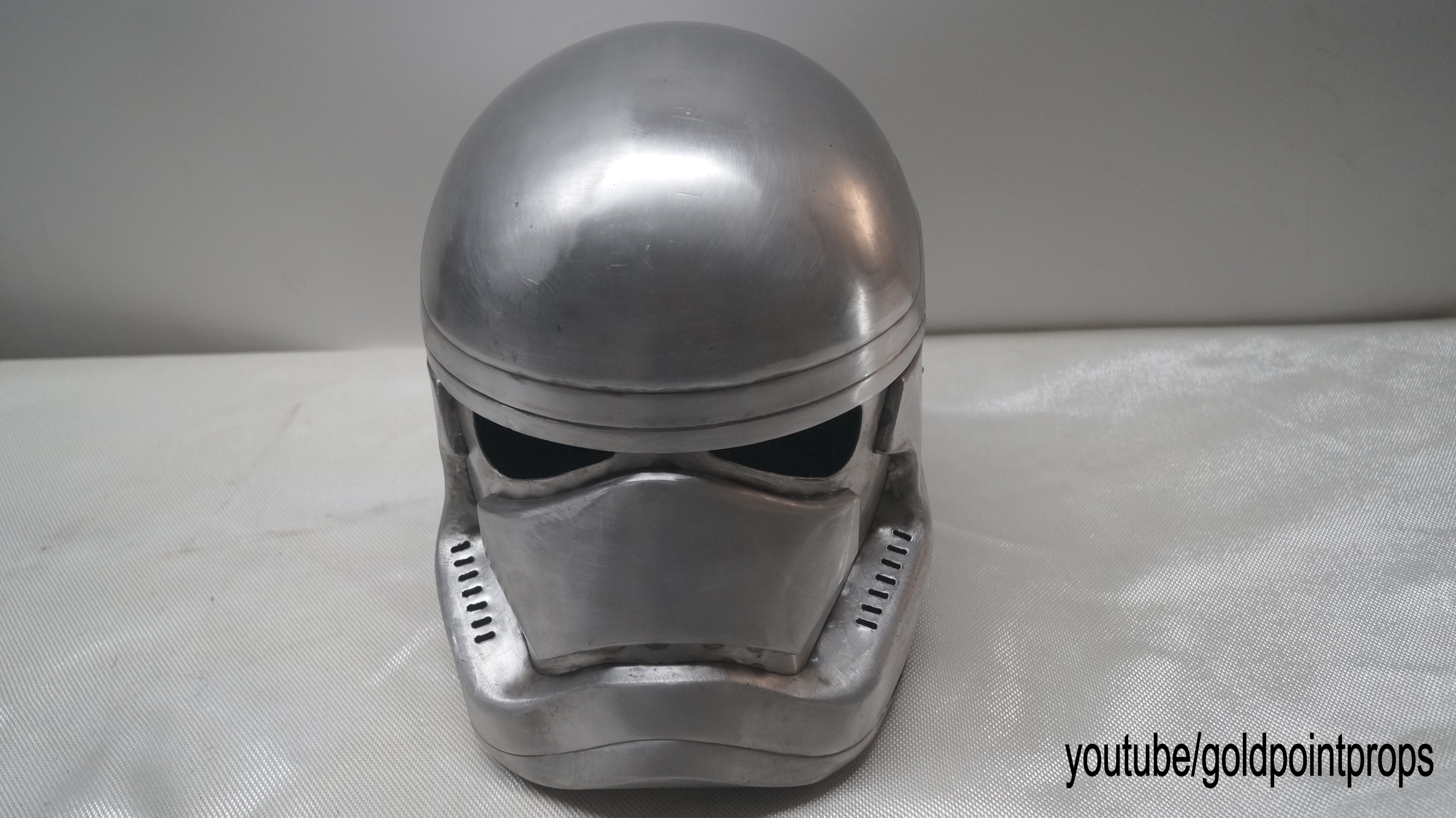

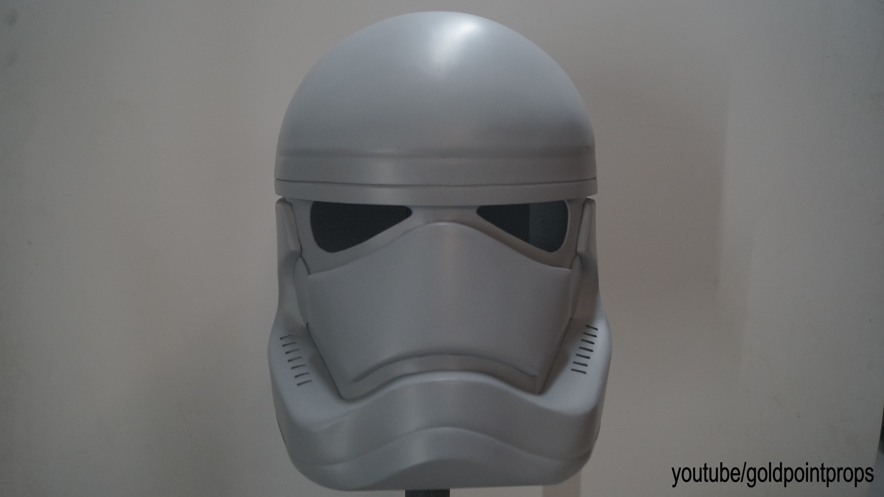

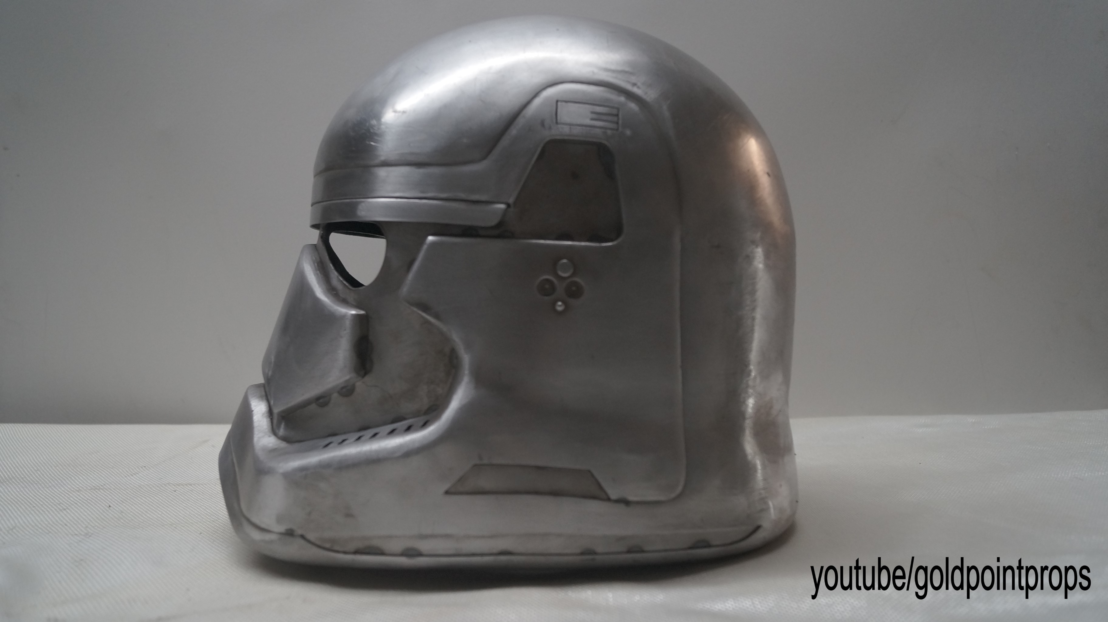

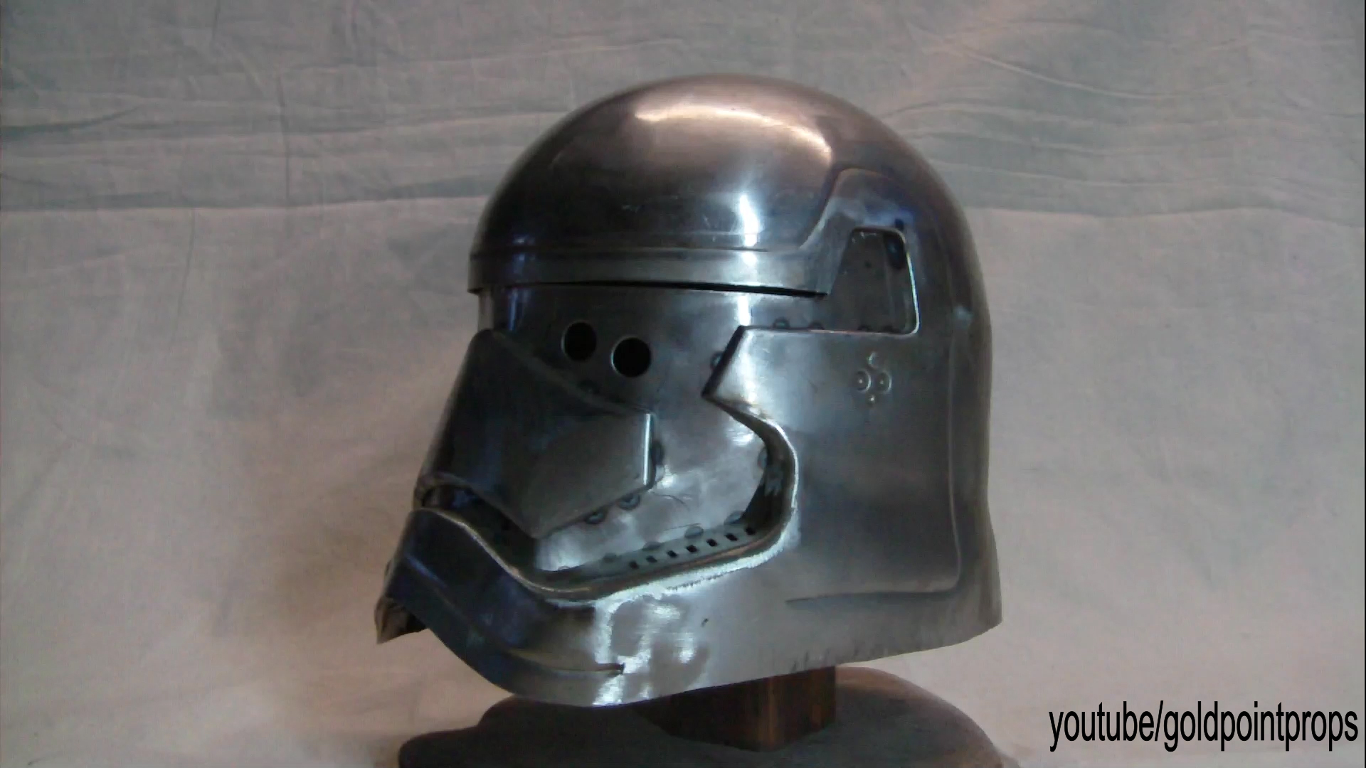

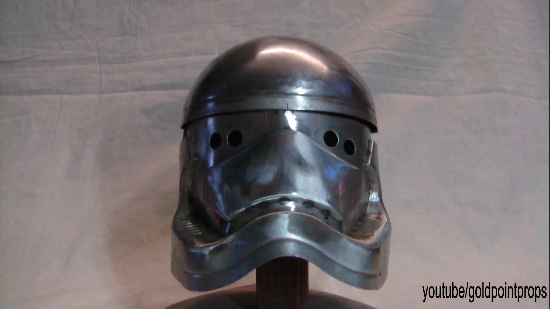

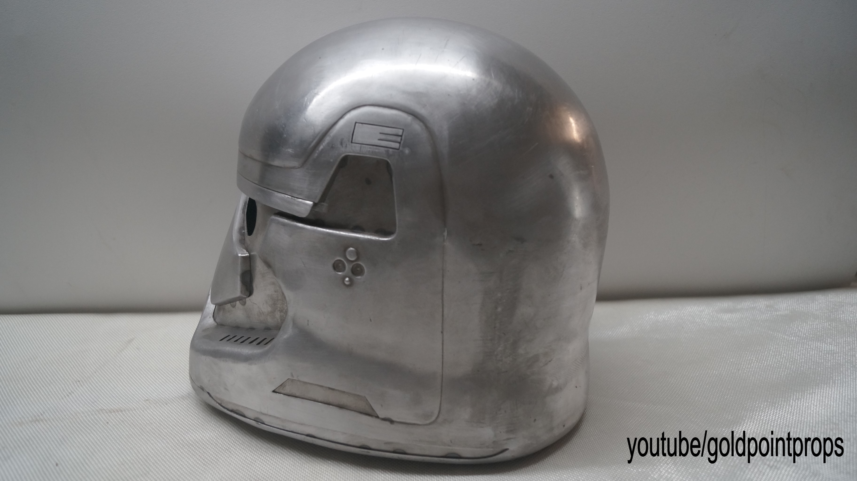

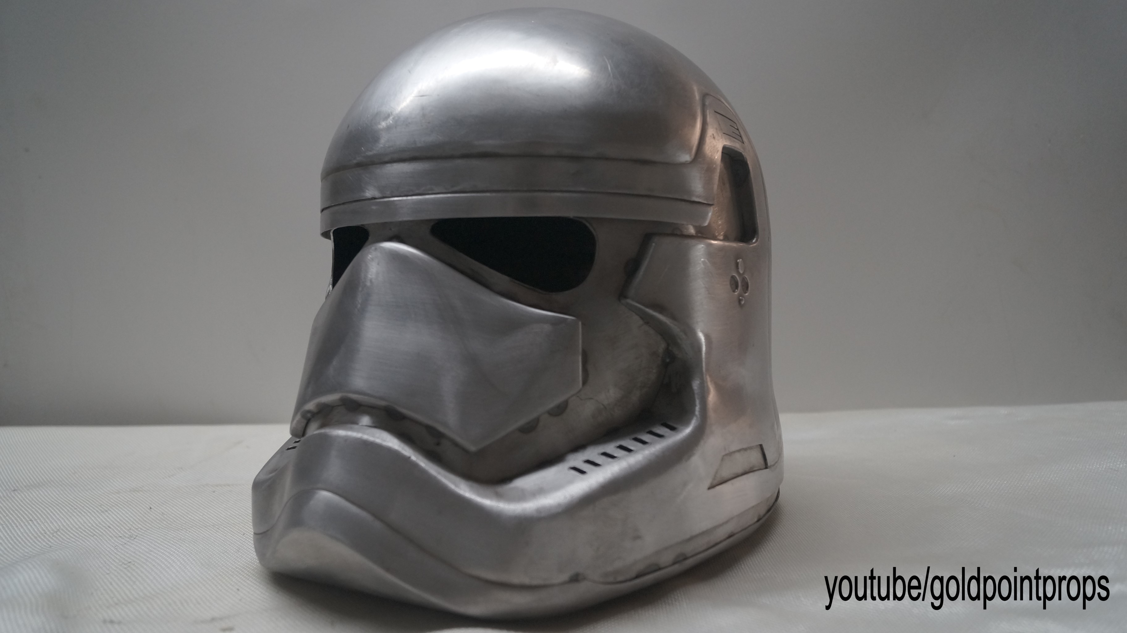

hi my name is Robert I am working on a star wars episode 7 storm trooper helmet.im making the helmet from 18 gage sheet metal. Its almost complete just have a few small details to finish. Ill post pictures of the complete build soon A making of video will be uploaded soon on our YouTube prop channel Goldpointprops

Wow man that's super impressive. I look forward to the video of how you did it :)
Ben
The funny thing is that in its raw metallic form looks better than what we've seen so far in the 2 " official" pics available.
Wow...that looks awesome!I love metal helmets...its a more "real feeling" when you have it in hand.Thats why I love my moded Metal Ironmanhelmet from MR so much!;):thumbsup
You have extreme talent, waaaaaaay better than I was expecting.
-z
And damn. Now I know why this helmet at first glance look better than the real thing. The half-front and the front shot look like the helmet has the classic teeth! The teeth are missing from the new helmet, and that is a MAJOR design element that should definitely have been incorporated to break up the streamlined look.
Man, that shiny thing looks fantastic.

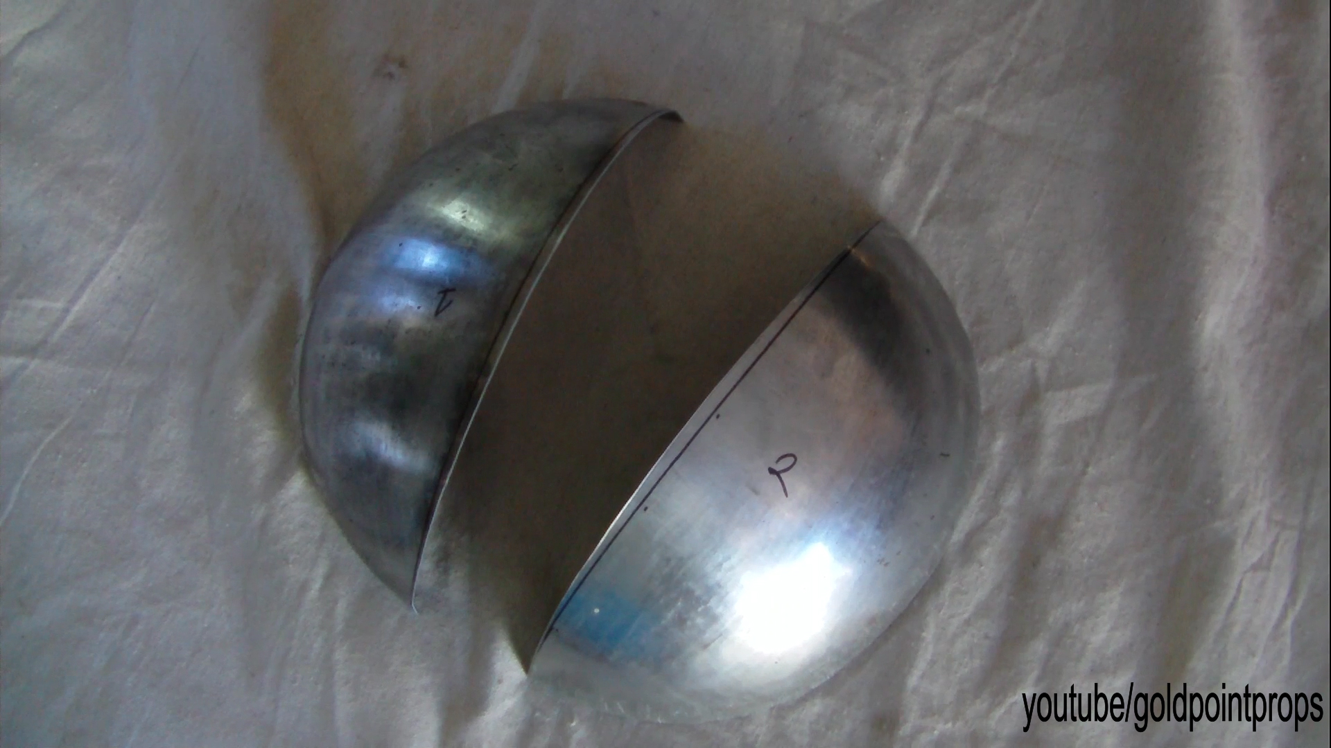

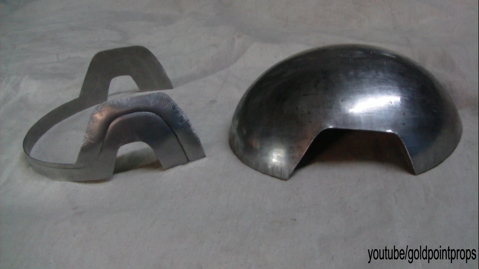

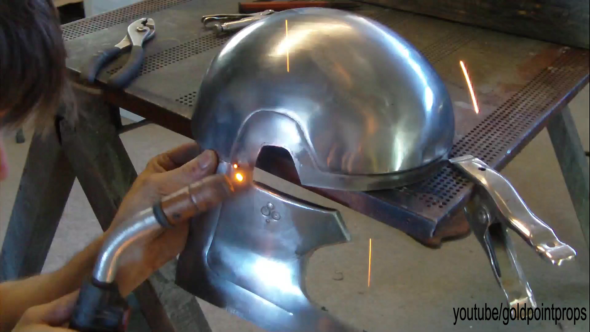

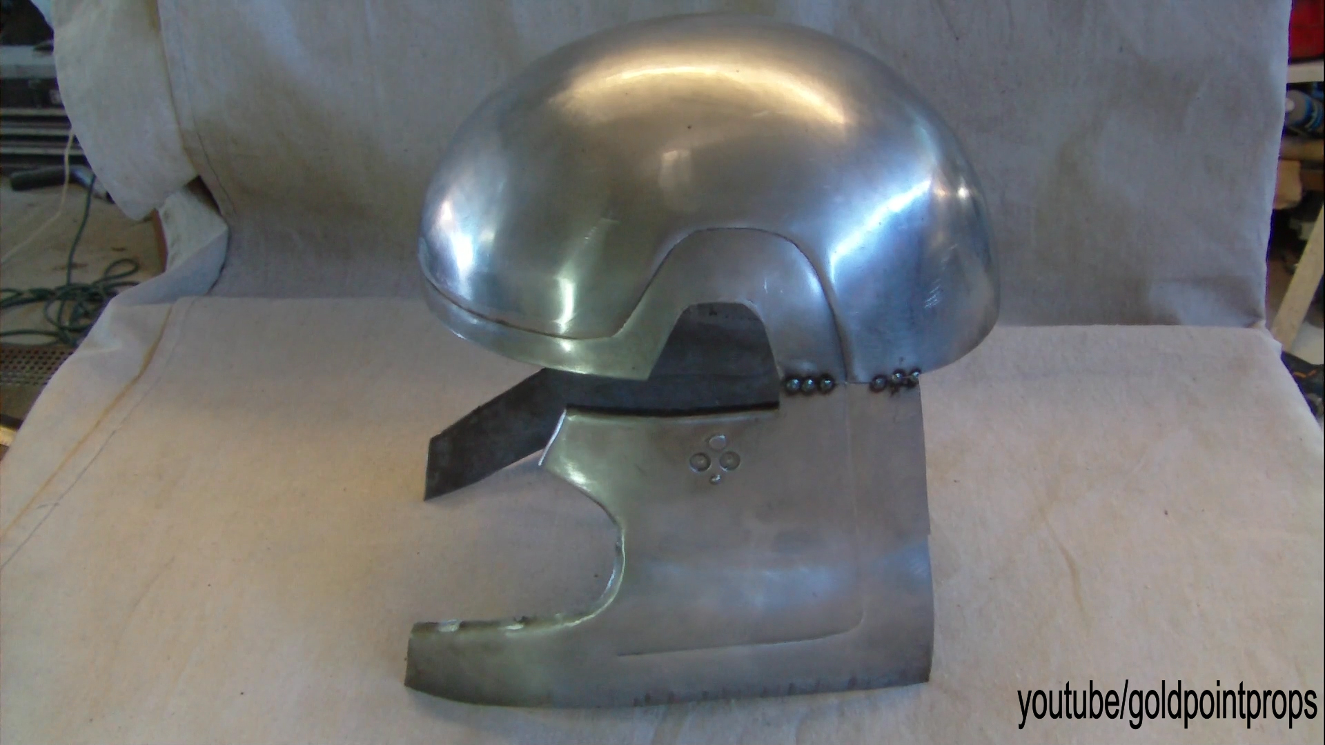

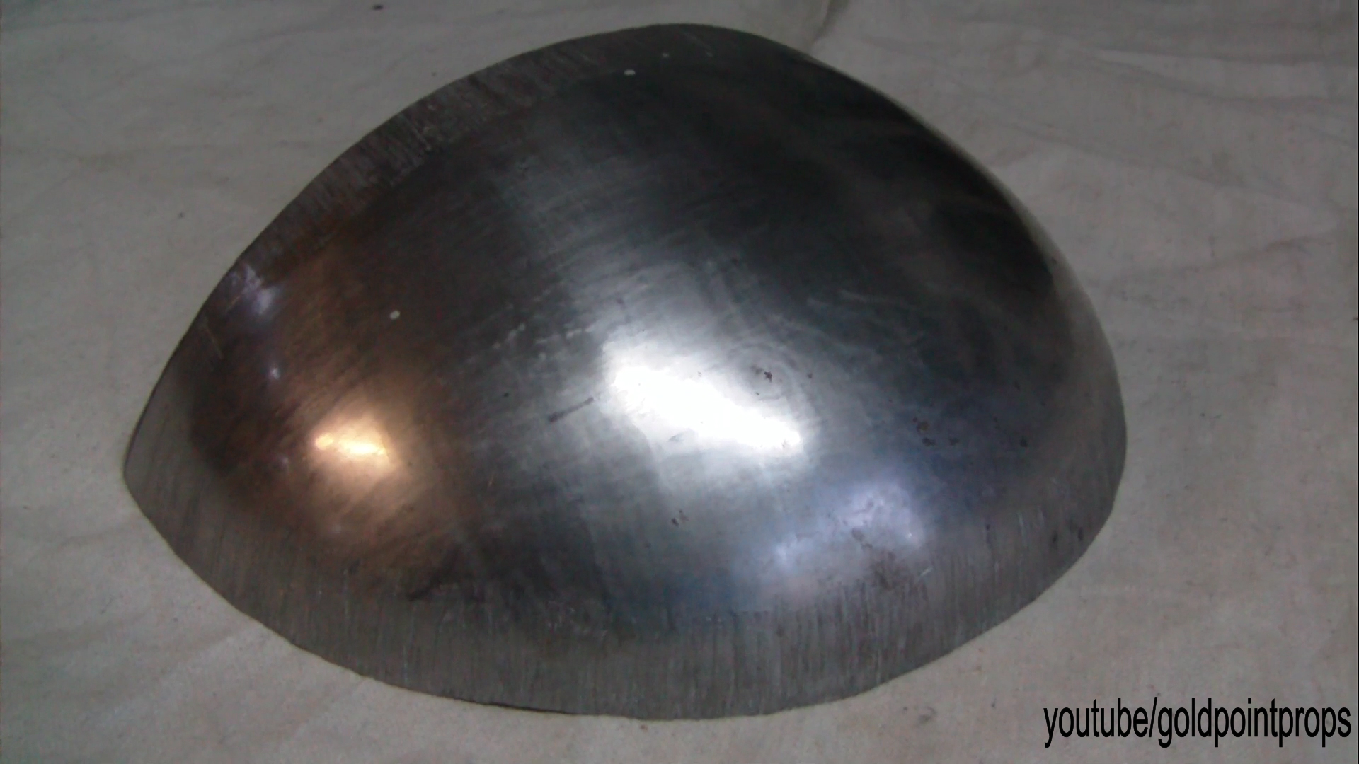

I used multiple hammers and an English wheel to shape the dome
2
I then formed the other half of the dome
3

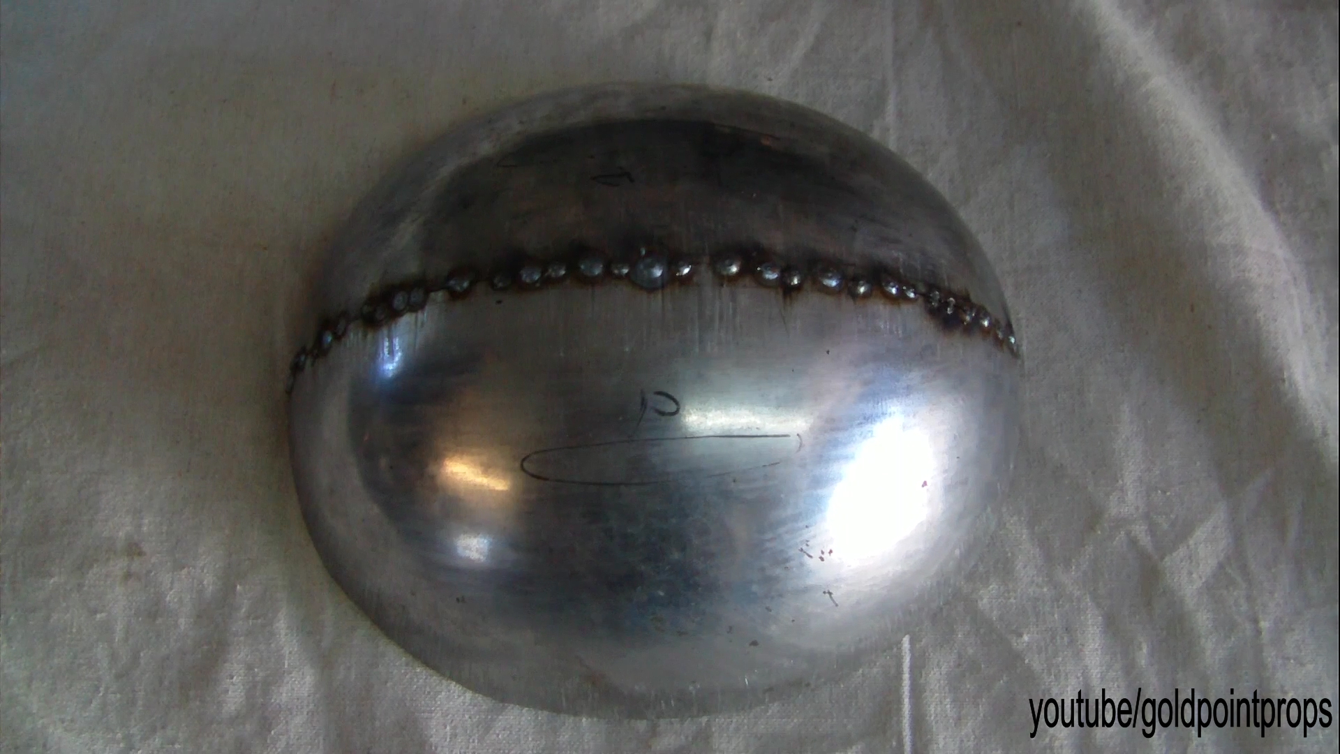

I welded the 2 half's together to get a complete dome.
4

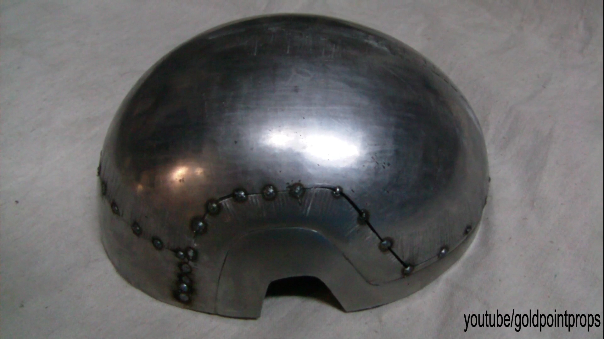

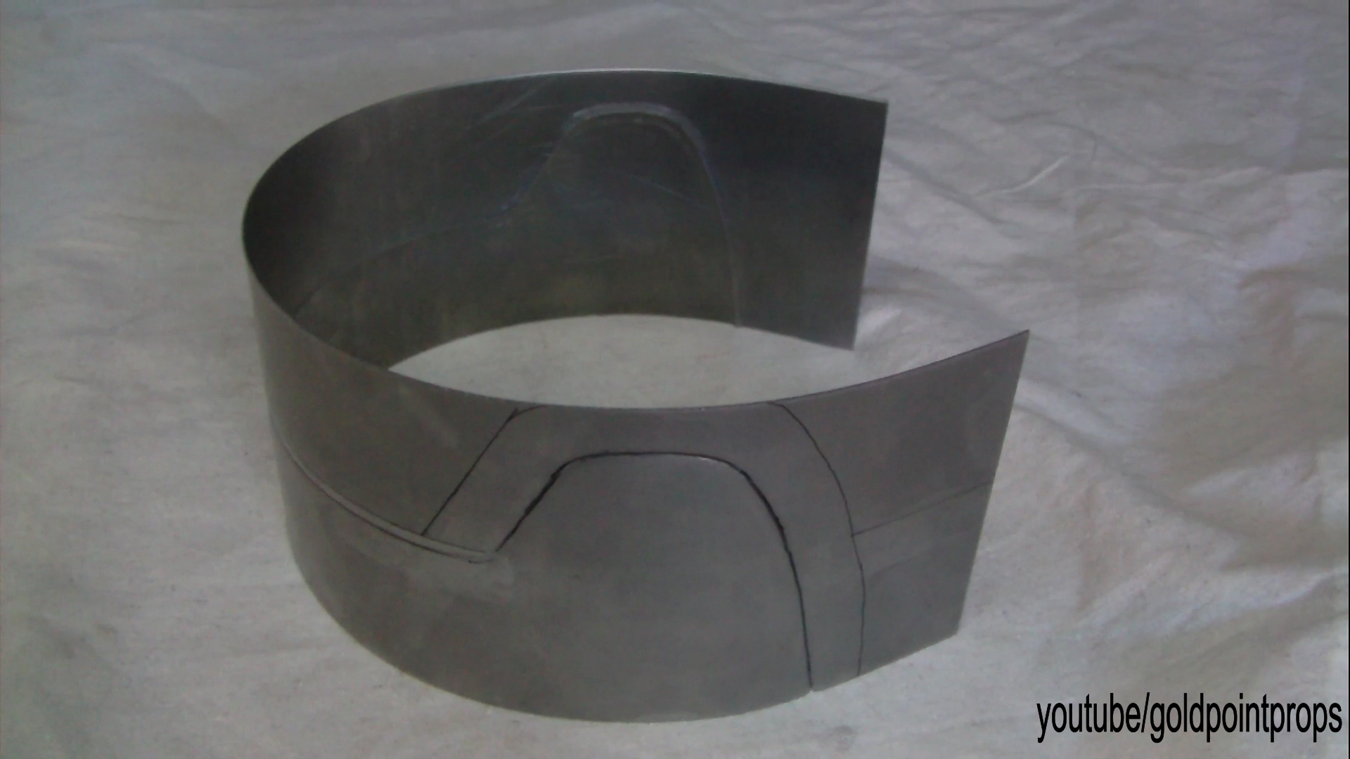

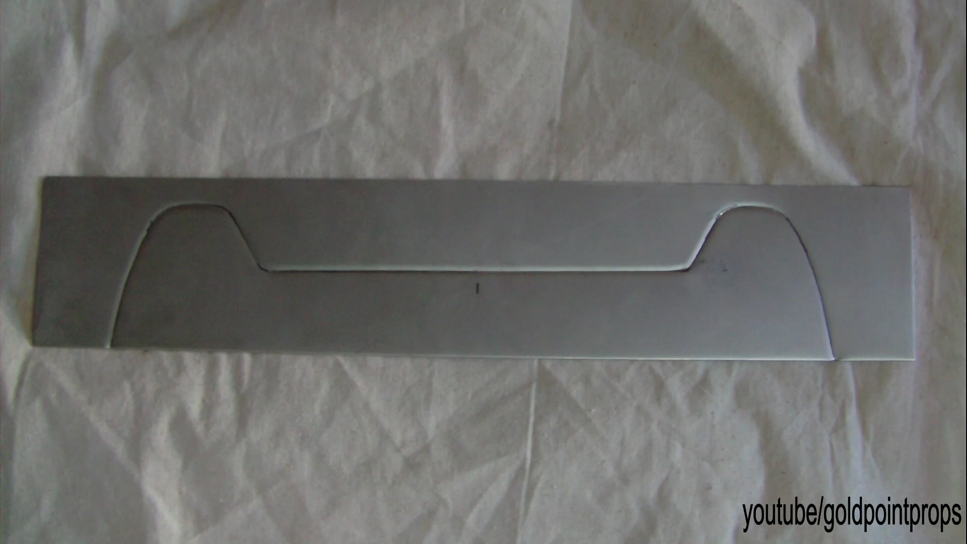

then on a new piece of metal I used a bead roller to roll a bead in the shape of the body line on the helmet.
5

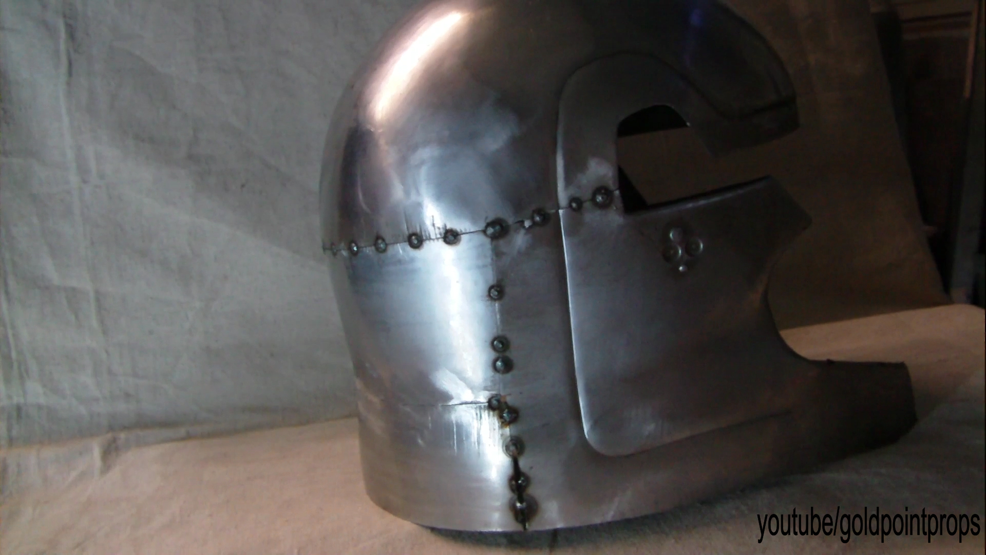

then I trimmed up the bead rolled piece ,.and the dome.
6
then I welded them together. and the top of the helmet is complete.

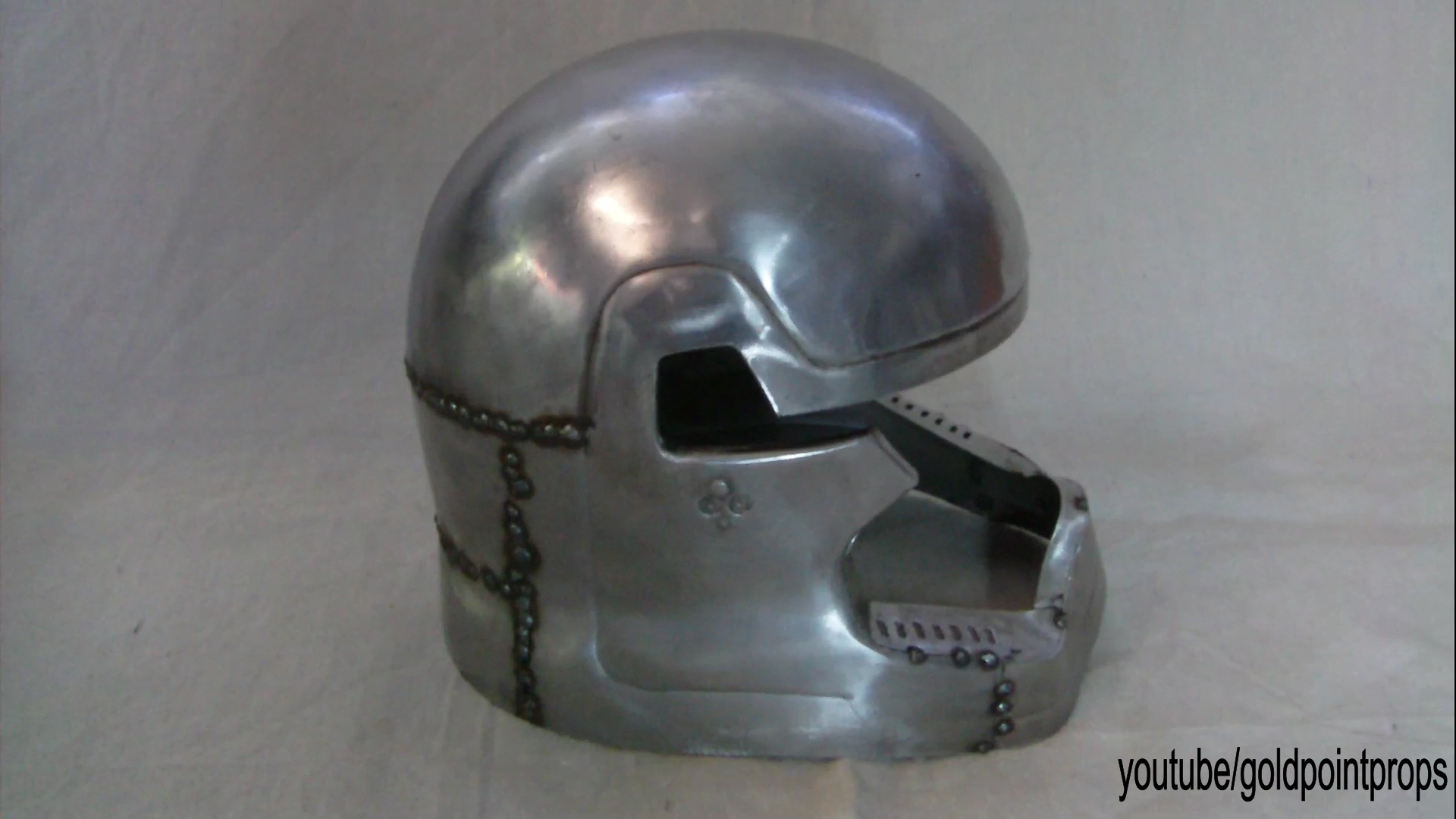

7

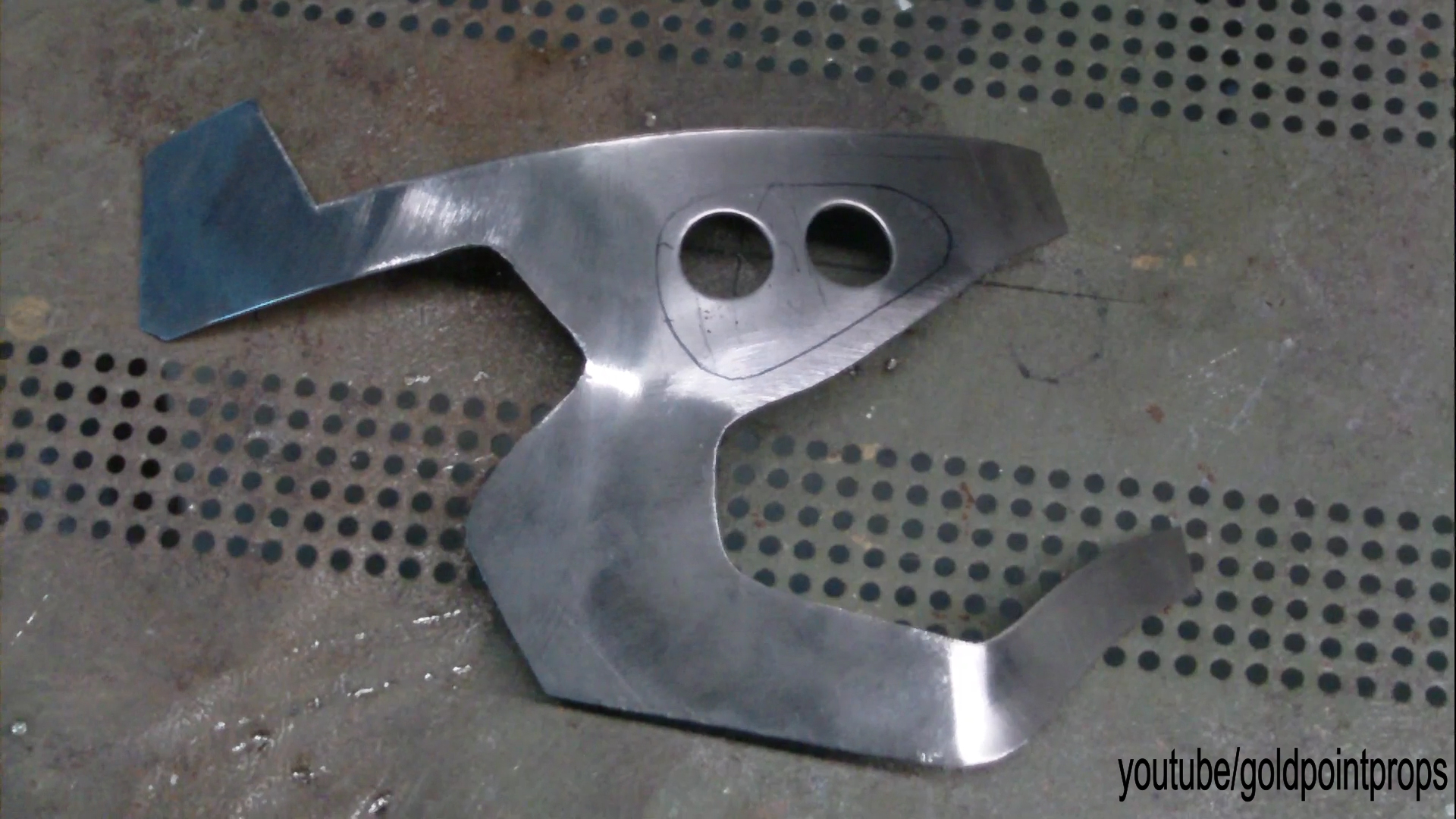

then I formed the side pieces. and continued the bead roll onto the sides of the helmet.I welded these together as well.
8
I did this to both sides.
9
then I formed the back pieces and welded them on.

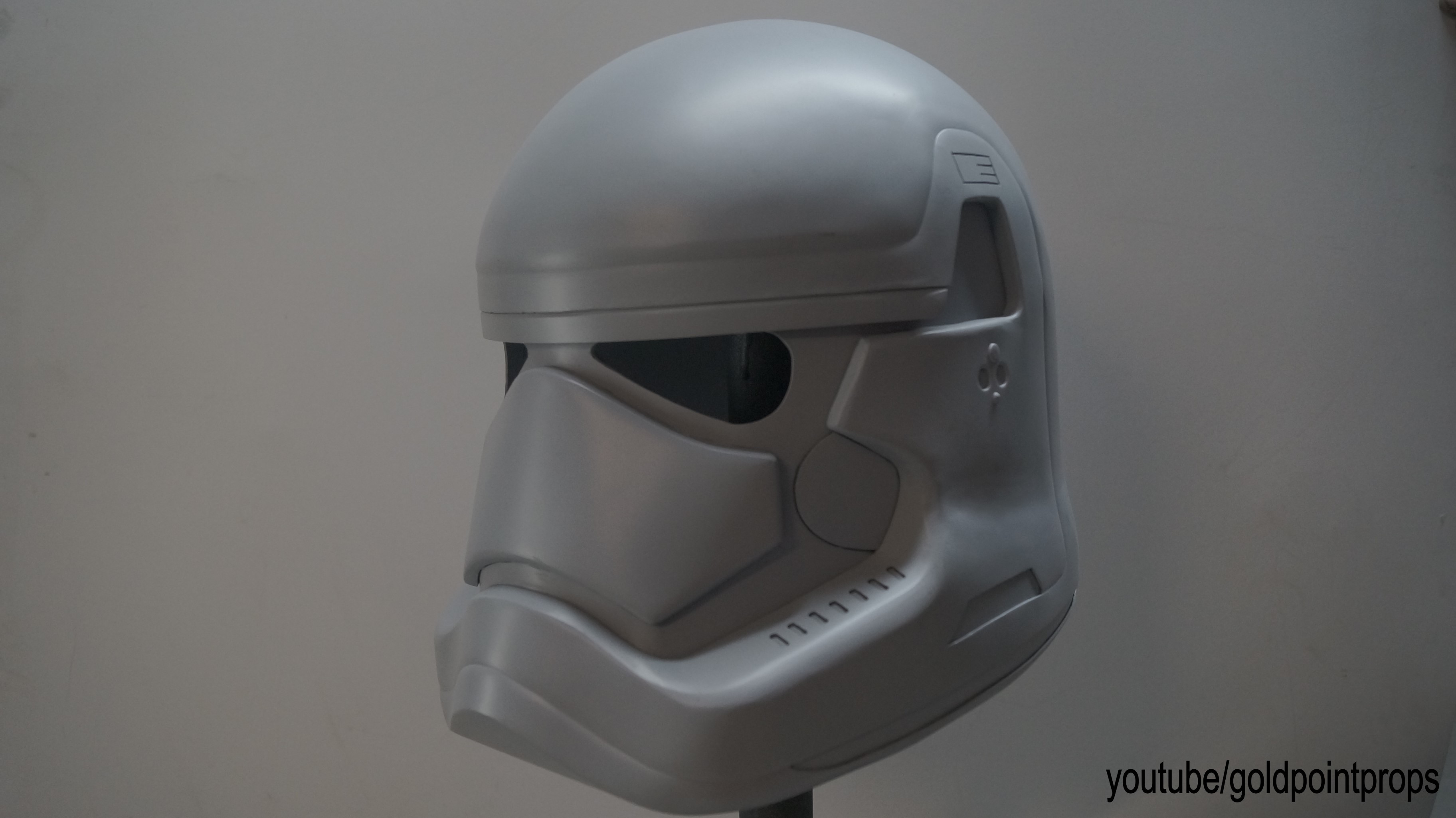

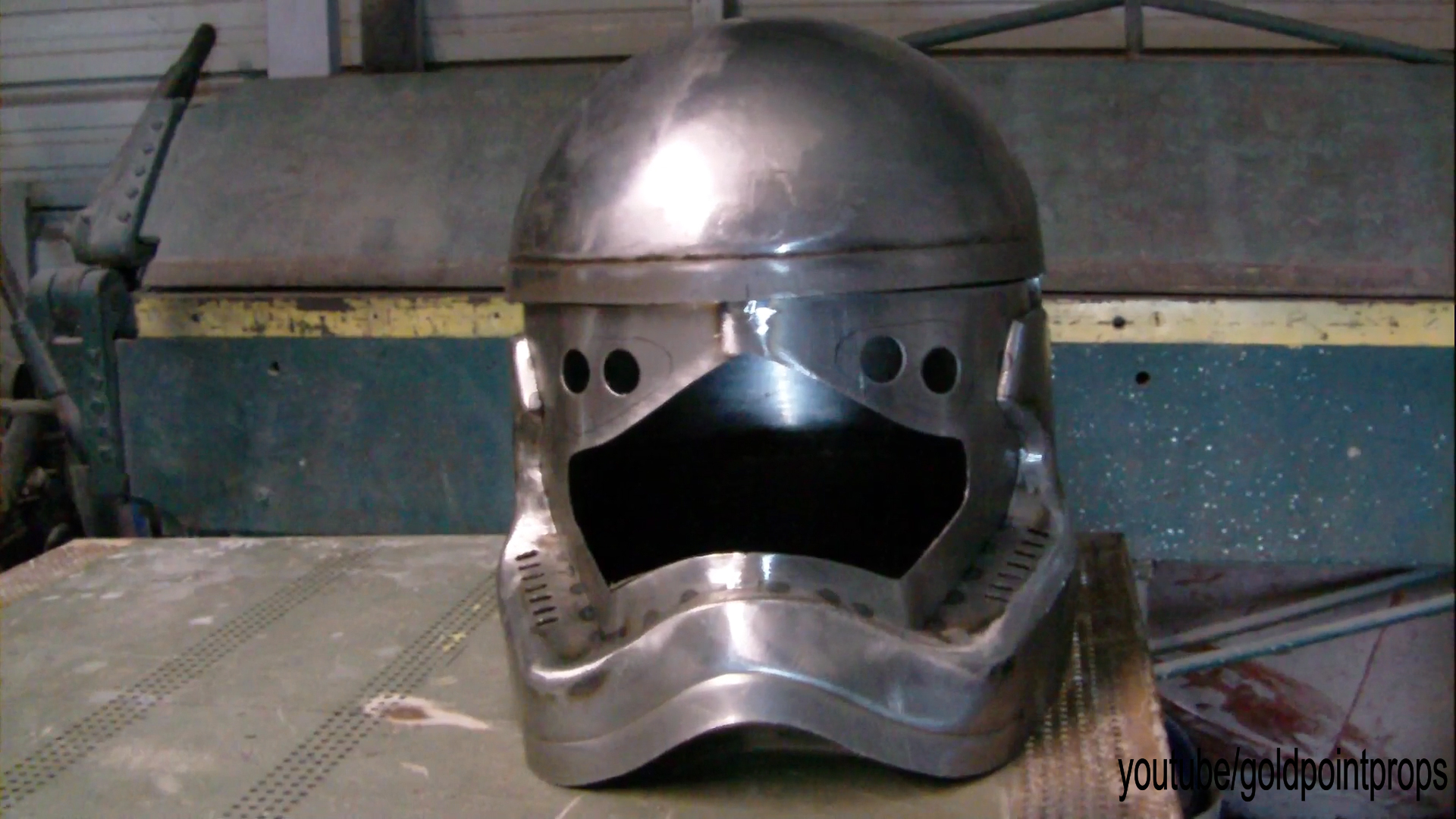

Omg its Iron Man! lol it just has the wrong look for stormtrooper, looks almost like a marvel crossover..... Must be the metallic cause over all its a stormtrooper helmet the side view clearly shows this....once finished it`s going to look amazing
yeah the motorcycle visor with the last minute nose cover doesn't feel right...

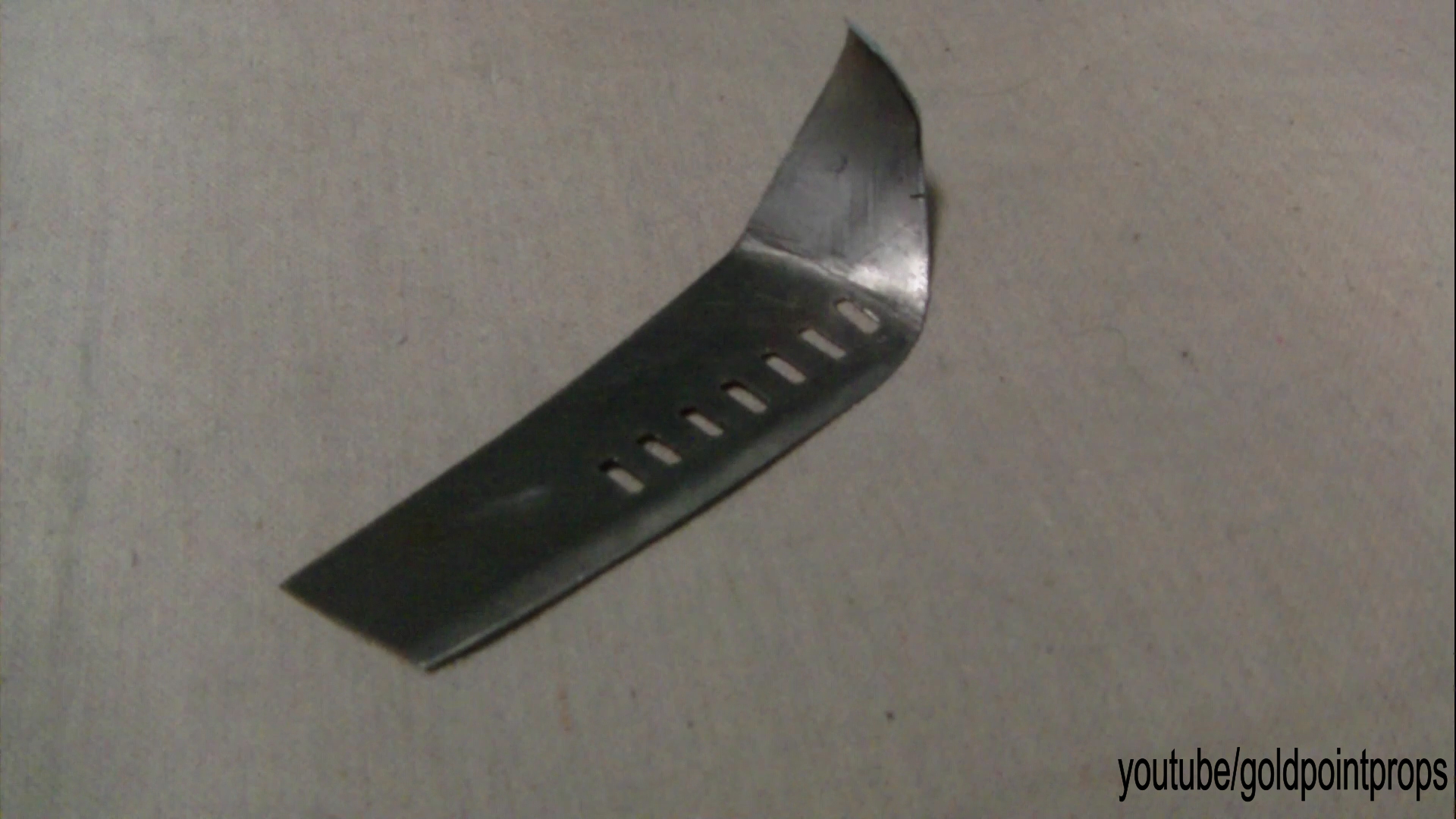

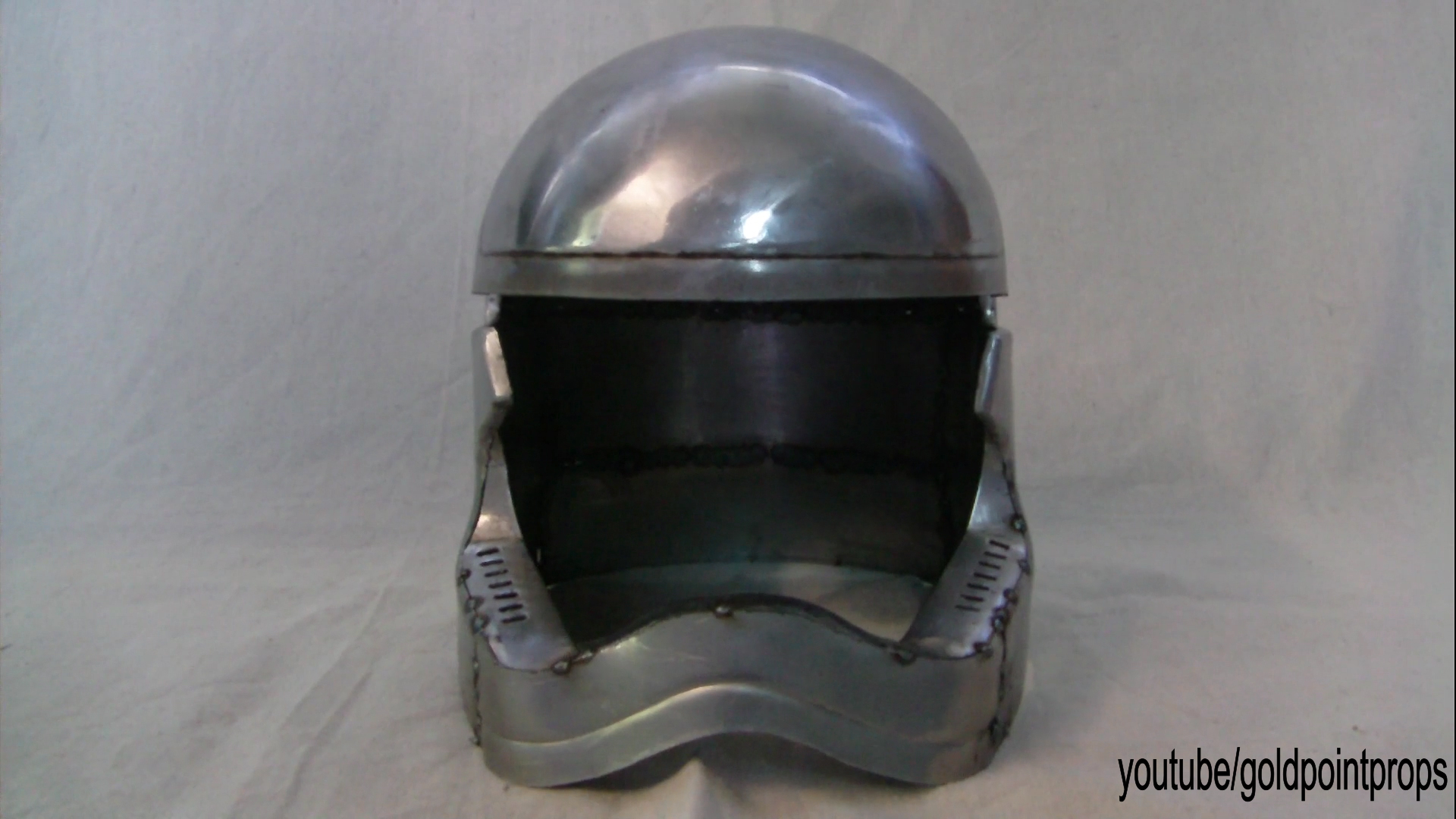

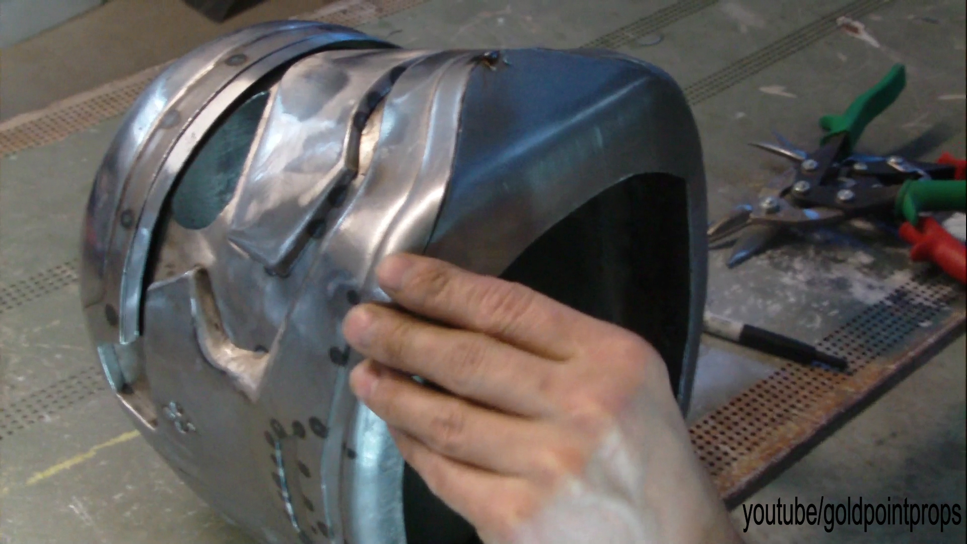

next I formed the piece with the vents in
2
I welded the vented piece on and formed the mouth piece and welded that on as well.

next I made the stepped in piece were the eyes will be cut in .Then I welded it into place

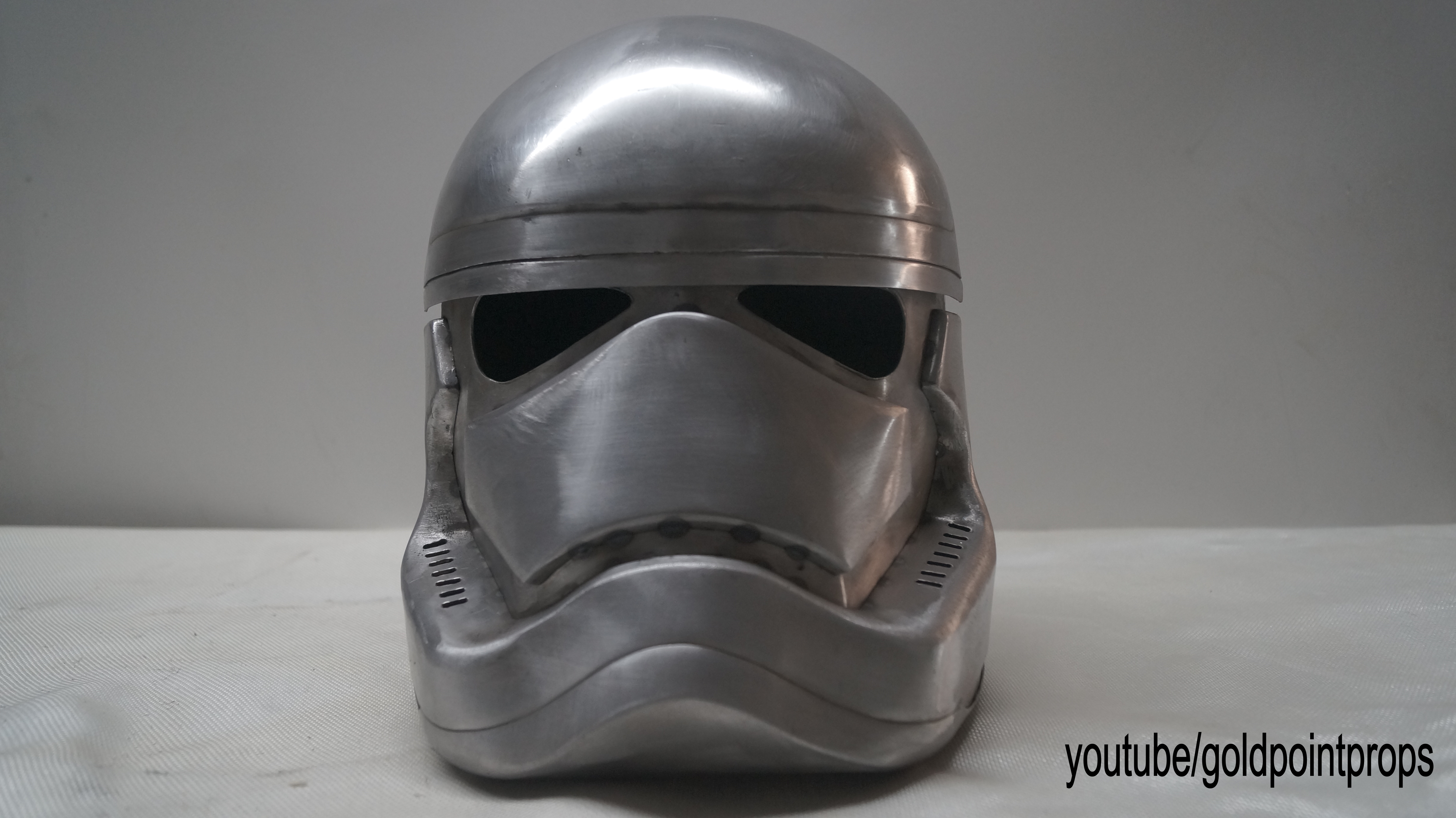

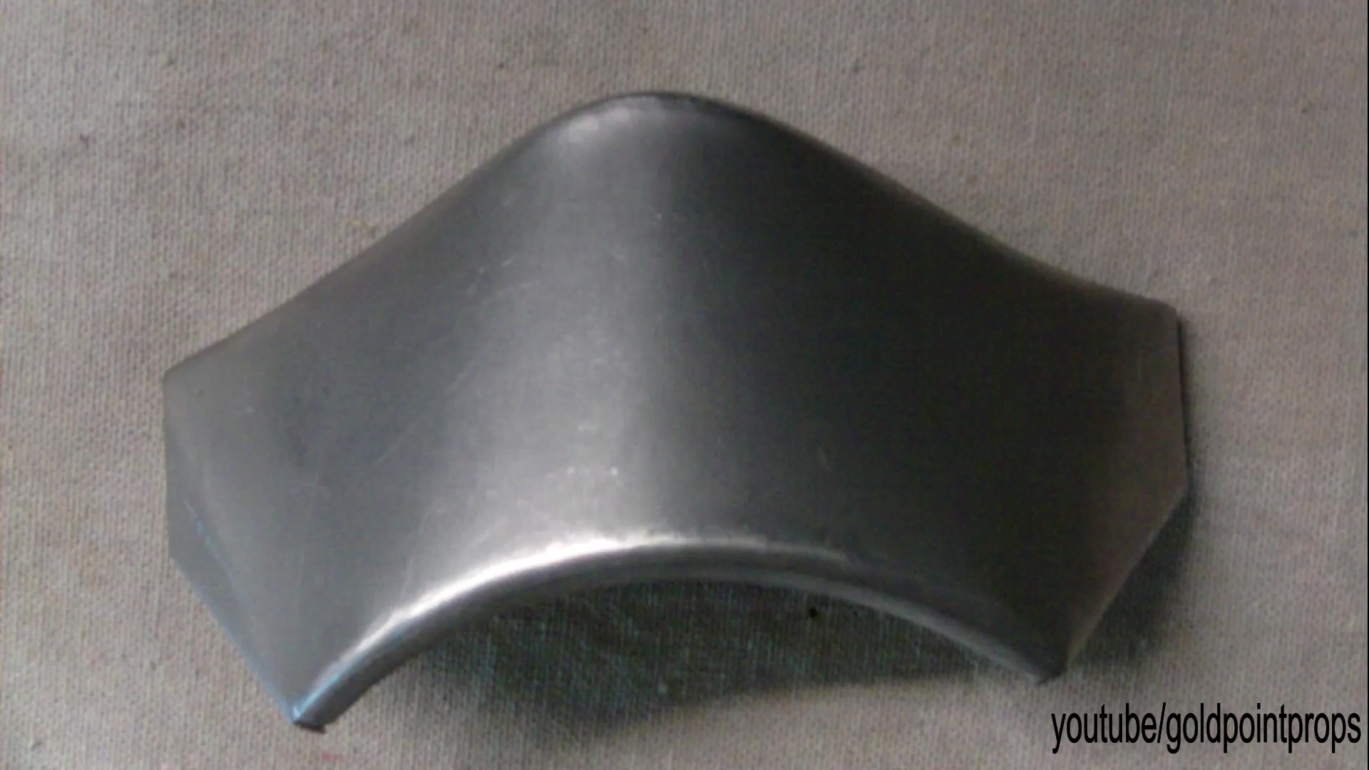

then I formed the nose piece and attached it.
6

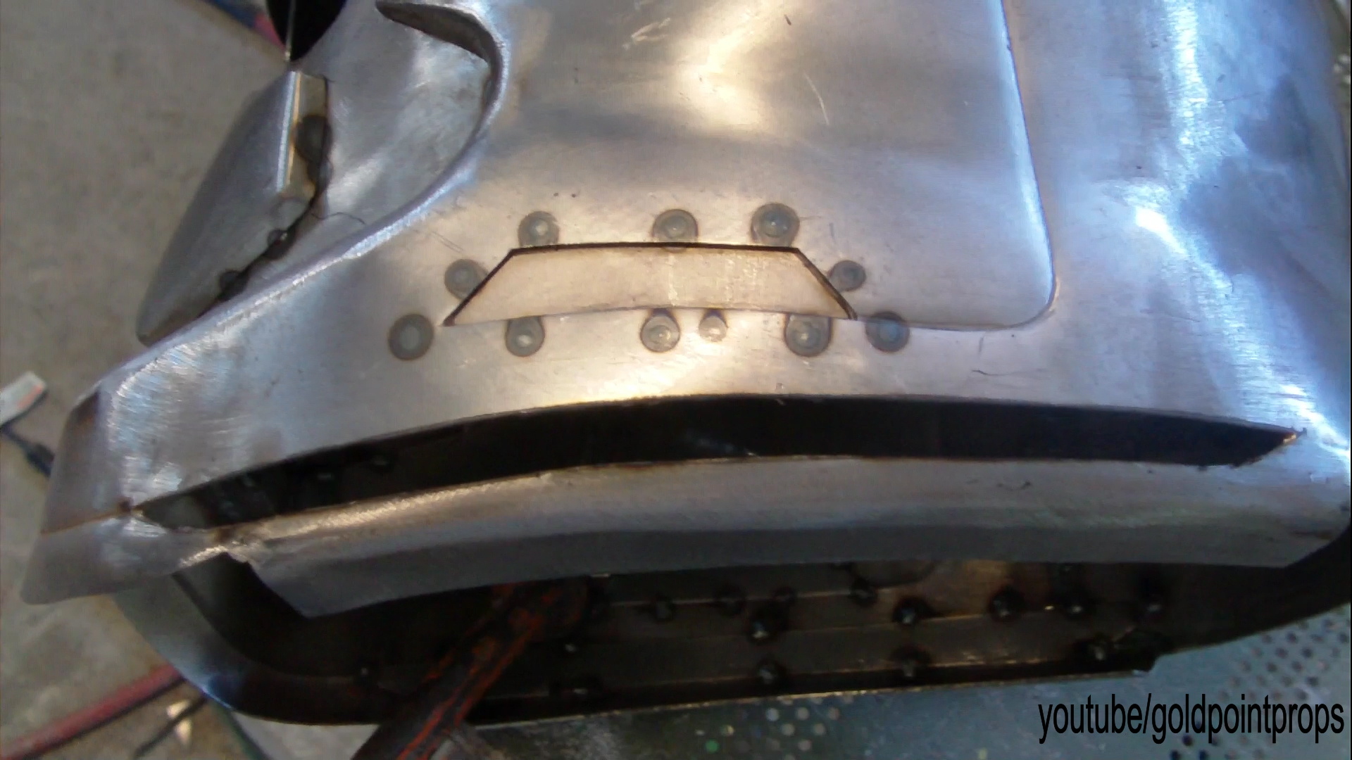

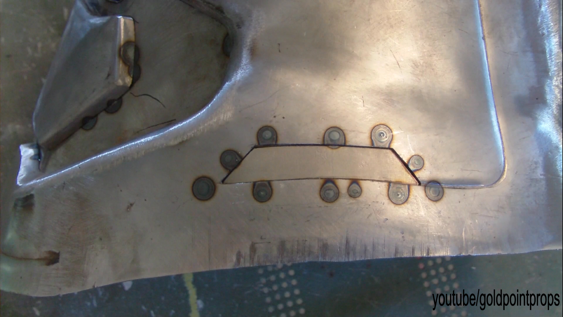

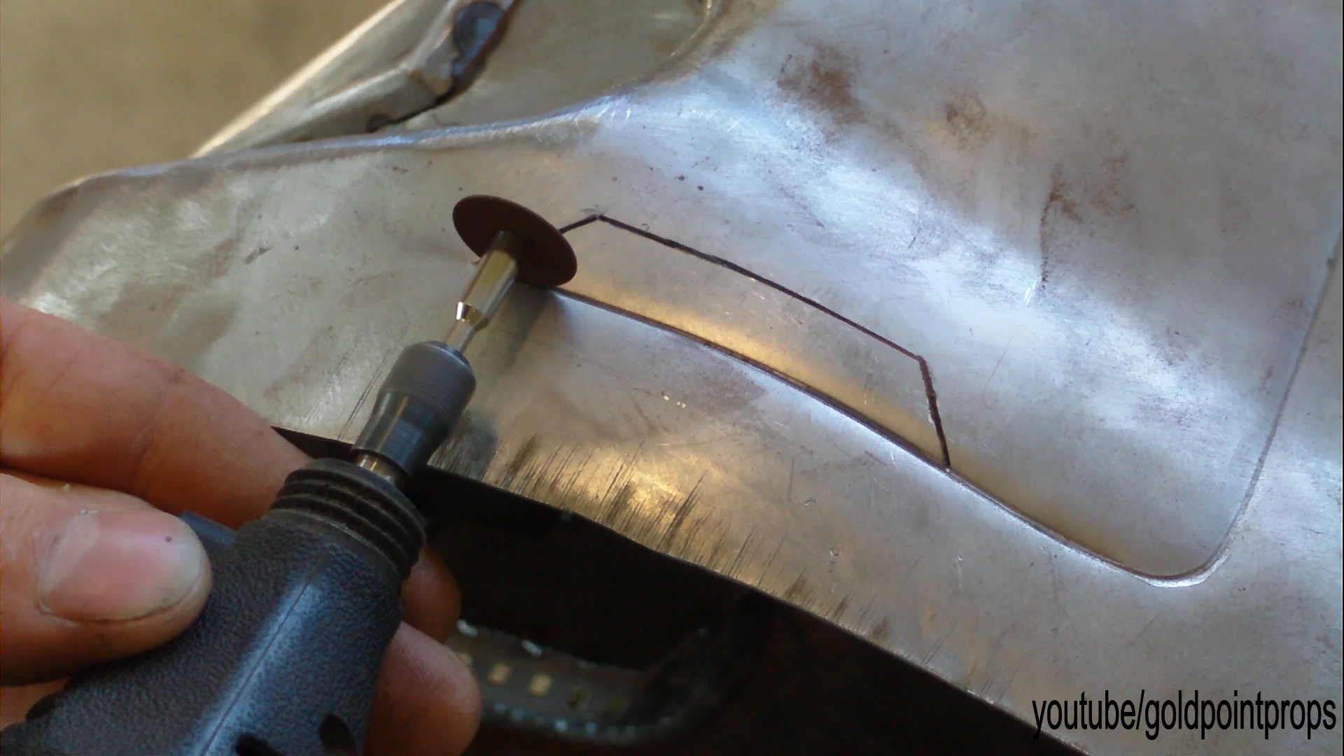

next I cut out the eyes holes
7
then I cut out were it needed to step in
after that piece was cut out I welded a small piece of metal behind the opening.
2
I did the previous step for the bigger step in as well.
3
finally I welded on the lip around the bottom of the helmet
this weekend I am going to paint the helmet. I was going to powder coat it but my powder coating machine is messed up. I am going to use high quality automotive paint to paint it. ill post some pictures once its done.
