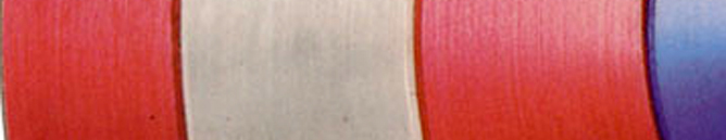

No grooves on the sled. Couldn't figure out a way to make them. Although my shield is groovy. Here's what I see when I look at this hires image from their campaign:
Think of each groove having two sides, like two sides of a valley. Each "slope" of the groove will be the color of the adjacent ring. Get it? So proceeding from the edge of the shield, it would go like this:
RED RING
red slope
clear slope
CLEAR RING
clear slope
red slope
RED RING
red slope
blue slope
BLUE CIRCLE
hope this helps.

thx for the paint advice with the slopes, but im not sure if i can do that xD i am not sure how to mask the slopes, to get only half painted ;/

How do you tape off the rings and get such great looking circles? That seems like the hardest part of getting a shield painted properly.
one way, you could do is make an old fashioned compass, take 2 pencils and some string, measure your string out, tie it to one pencil, and then to the other, and then circle the shield with one, while holding the other one in the middle. could use a tack or tape or something instead of a pencil for the middle.
the way i marked my cuts in the shield was taking a big sheet of paper, enough to cover the whole shield, and then draw the according circles on that. then i cut those out, stuck them onto the shield, marked the lines where the paint should go directly on the shield with sharpie, took the paper off again, and voila-you got markings for masking :)
Sorry, I guess I should have been more specific: I am getting a shield with grooves already cut in it, so the circles are already marked out for me. But thinking about how to mask them off for paint is throwing me for a loop.
oh easy then, just mask the whole shield, and use a straight blade to cut the masking where the grooves are.
