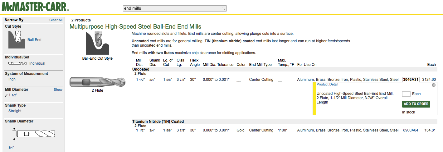

as for fly cutters this has been on my list, i wanted this to try and do a smoother finish. i wouldn't have thought to use a fly cutter to make this radius on the control box.
i would use it just like how i planned for my ghetto hole saw right? except i would do VERY VERY small increments of removing material.
as for the 1-1/2" end mill, i ALWAYS remove small amounts, .010 at a time. it takes me forever, but again im no machinist so i really dont want to break anything, or hurt myself
but back to the flycutter. i would set the flycutter up so it makes a 1-1/2" diameter? and then slowly remove material?

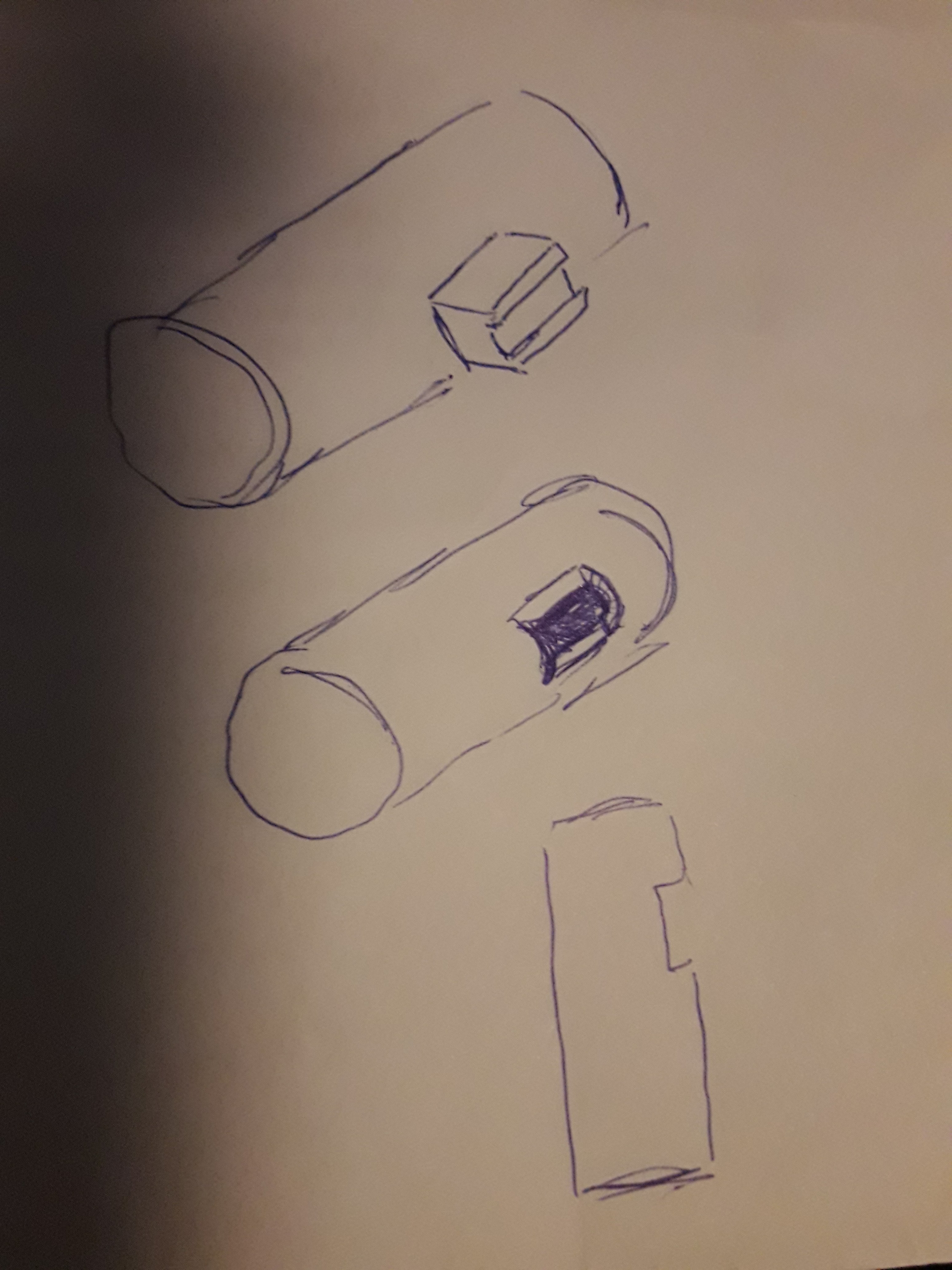

maybe too late...
you could always *NOT* round the inside of the control switch and cut the pipe to accept a rectangle.
see crappy drawing below.
cutpipe.jpgIn other words, file down the pipe flat in the area the control thingy is supposed to fit. A lot less wasted material. Use big files til you get to a close fit, then teeny tiny files to get a nice snug fit.
Attaching a rounded piece to a pipe leaves me wondering how you would securely attach it.

maybe too late...
View attachment 804515In other words, file down the pipe flat in the area the control thingy is supposed to fit. A lot less wasted material. Use big files til you get to a close fit, then teeny tiny files to get a nice snug fit.
That can work if the box is narrow enough or the hilt's wall is thick enough in relation to it's diameter. With a 1.5" O.D. and a 1.25" I.D. and having a minimum of 1/16" wall thickness on the center line after milling the area of the activation box (for screw threads), the activation box can be about 5/8" wide max. Not too shabby.
As for how you would secure it when curved, you would secure it the same way you do with a TCSS activation box (they also have a curved bottom)... with a screw. You only need one and the curvature prevents the box from rotating. It's a very secure setup.
