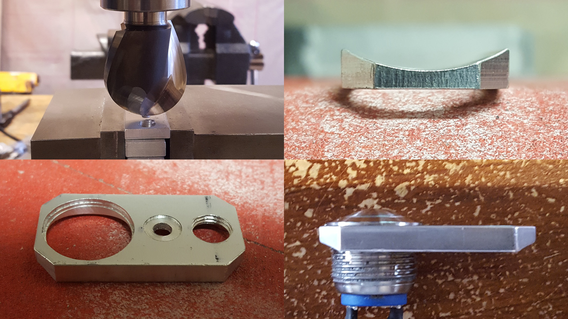

I have made an activation box for a 1.5" dia. lightsaber before using my mill. There are two good ways to this with a mill. The first is not the best way of the two but will work. If you have a standard 1.5" end mill with a 3/4" shank, you could mount the box vertically and make your bevel. I did something similar to that using a 1.125" dia. and a 1" dia end mill (both with reduced shanks) for some saber parts. However those large end mills like to grab so you have to be very careful when doing it this way. The other way, the better way, is to use a ball end mill (again with a reduced shank so that it would fit in my tiny mill) of the diameter that you need. I used a 1.5" ball end mill to make the radius for my activation box. Here's a pic of the activation box I made and the ball end mill in the mill, just before milling the bevel...
Alternatively, one might also be able to do this using a drum sander with a 1/5" dia. sanding drum.
