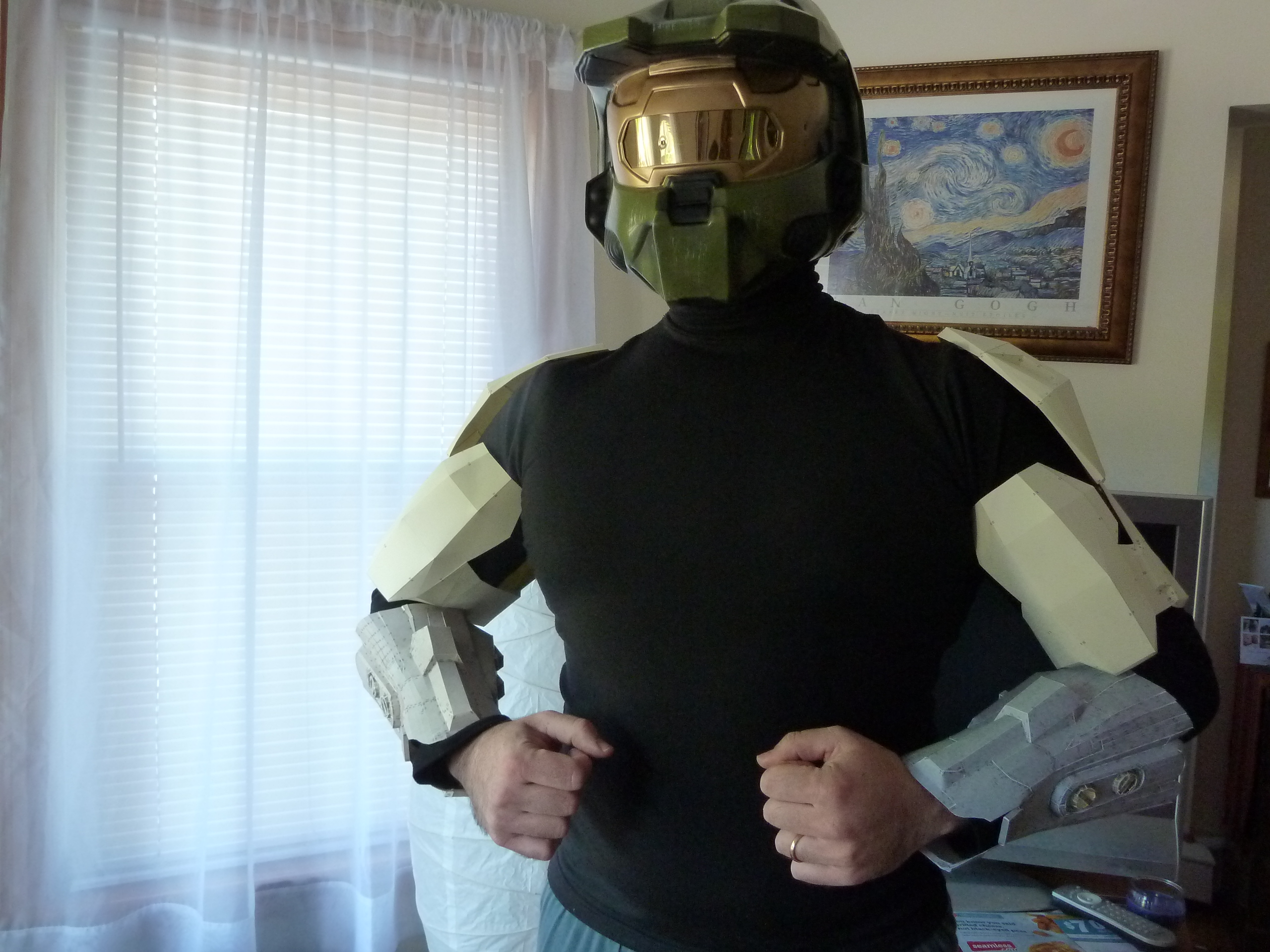

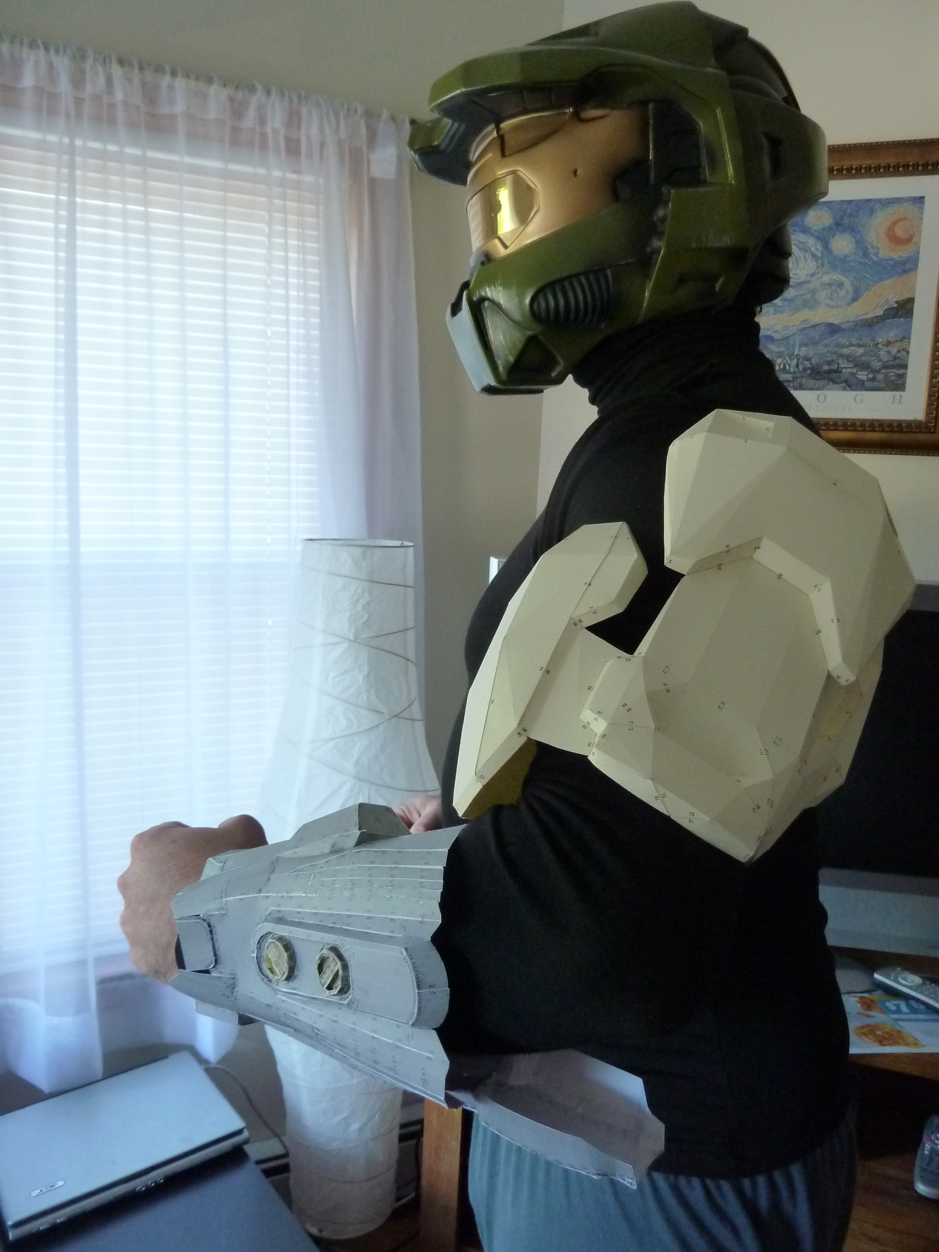

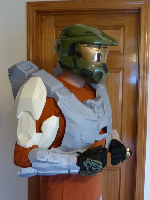

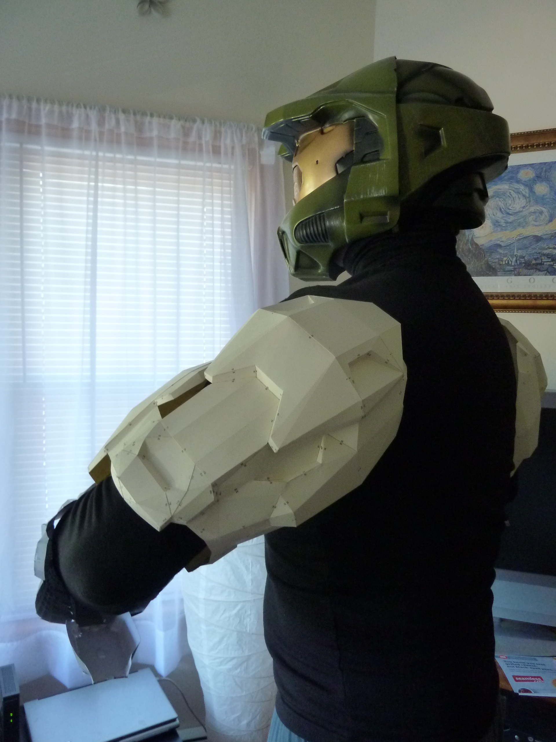

Paper model of the arms completed (The helmet is in plastic...I bought it for Halloween...)
Re: Halo costume
Nice. Foam does look nice when done right as chef has said. I prefer resin/bondo just for the paint side of things. Helmets in foam though don't look the best. My opinion though.
