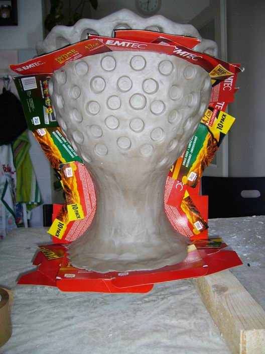

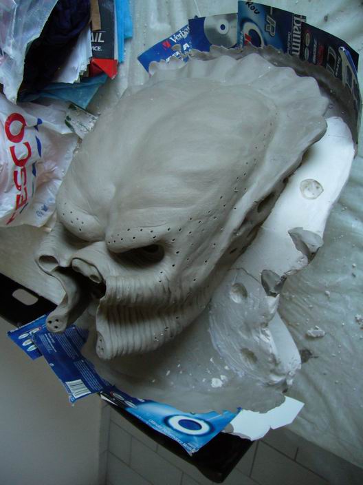

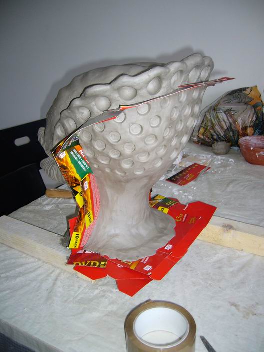

First thing, my wall.
Because I´m using water based clay, I cannot use it to make wall.
One way is cover clay wall wtih plastic foil, which prevent stick it to sculpt.
It works on normal head, but with pred not. Because wall on back side hang with no support - so it falls down.
I throw away clay and thinking about cards wall - but haven´t cards :)
I think up new wall material, which everyone have - CD/DVD paper boxes! ;)
Look at the first two pics for this wall ...

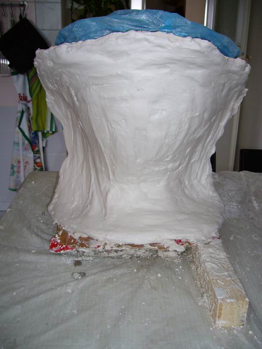

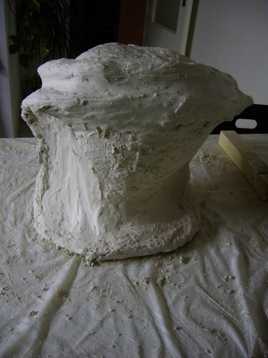

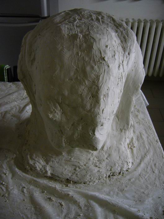

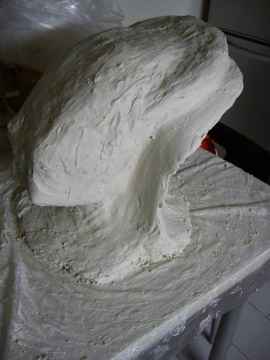

Second thing is that I started molding back part first.
Because it can be easily done in vertical postion and there can be some errors (dreads will cover it)
When it´ll cured, I can lay down sculpt on back molded side and front face part will be in horizontal position.
It´ll be very easy to fill every problem areas as mount and eyes

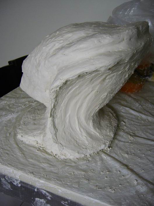

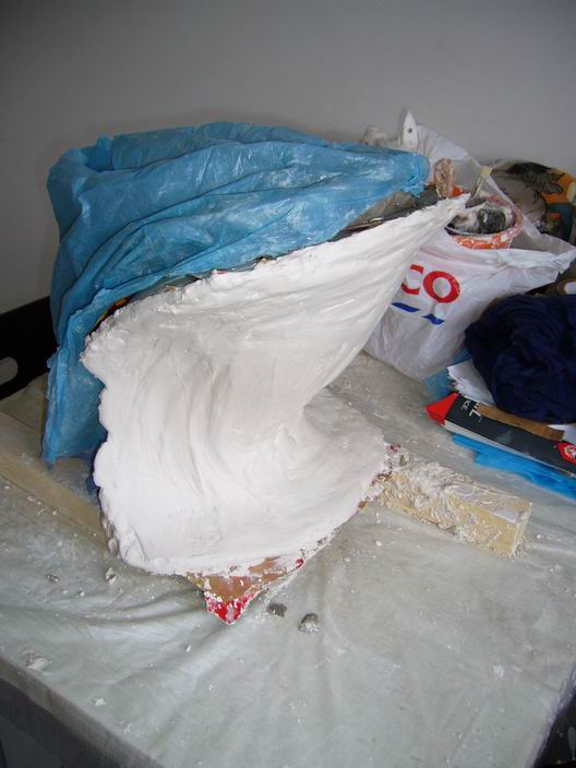

Look at the seconf two pics for back side mold ...
Now, I´m waiting for cure back part. Bad thing is, that I used about 6 kilos of plaster, and not have more :)
I hope I´ll buy it today yet and make front part of mold.
I´ll post pics when it´ll be finished.

Using the dvd cards isn't a bad idea....But it's card....and the wet plaster will turn it to mush.....If you had waited, I'd have posted up another method that used a similar thing, plastic coated playing cards. The other thing I did but neglected to mention as I was in a rush to post up...Was that I used masking tape on the brass shims to tape them together and form one even surface...But you've not done a bad job...Uisng six kilos of plaster isn't a lot. My last head sculpt weighed 40kilos.. I hope you sealed the clay as I said, otherwise all your hardf work could be for nought....Remember when you remove the cards tou seal the groove that's been made and retexture the area before going to do the front half.
You´re right maverick and I expected it ... but this boxes have outer side like a playing card, so I used this side opposite plaster.
When I removed wall, this cards was little weaky, but it done good job (yes, only as reserve solution).
You can see removed wall on first picture.
Then, next pics show finished mold (yes, I tooked a car and went to hobby store for 15kg of plaster :) ).
I finished it a few minutes before (about 11 p.m. in my timezone) and I´m totally ruined - I worked on it from morning :)
Now I´m going to bed a leave it cured till tomorrow evening, when I´ll came from work and I´ll open it.
I hope it will stay in one piece (two pieces :) ) and the mold will be good ... but I think that will be a catastrophe ;)
I think you´re curious too, so watch this topic and you´ll see how it will looks ;)

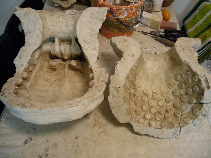

Looks like you've done a good job there....Thoight the outer parts of the mold do look a tad thin...A good rule of thumb is to make you'r molds around an inch...hmmm...About 3-4cm thick all over when working in stone...Silicone and fibreglass are a differnt matter....Just be very gentle when prying it apart... Still for a first timer, you've done a great sculpt and the mold looks good too. Nice work.
So, as I said, here is photos of next process - separated mold.
It was same ***king work as molding, but I did it :)
Yesterday, I tried to open it, but it was still damp and it mouldered.
So I only removed outer layer of plaster until I saw separation line and waited to another day.
Today I opened it - it takes some pieces of plaster fall off, but only on edge, so main mold stayed in piece.
Only small back part broke during opening (as you can see on photo).
But it still hang on bandage and it´s connected with mold.
I think it´s not a problem, cause it can be repaired easily. And btw it´ll be under dreads and it can be little inaccurate.
I´ll try put together it with hot glue tomorrow - plaster don´t work.
Next horrible thing was removing clay from face part (mainly manidbles).
During it I destroyed some details but I think that it´ll be still good mask :)
Next time I´ll do it separately (as member Ruffkintoy here)
So, I think, I done good job for my first time :)
I still can´t belive what I´ve done - I thought I can´t make my own mask without experience...but thanks to this forum and friend in my country who makes horror masks for his films, I´m doing it! ;) (and maybye some kind of talent:))
Now, I ´m only going to make some repairs and cleaning of mold and then wait to fully cure.
