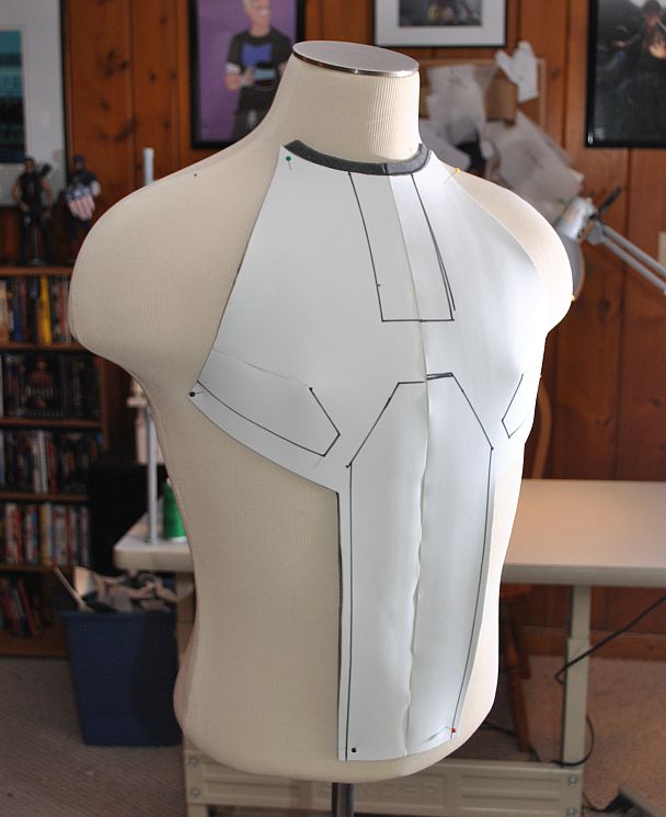

Like most projects, I started with a basic pattern block built to fit the measurements and then mapped out the detail lines.

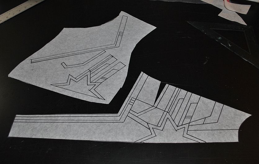

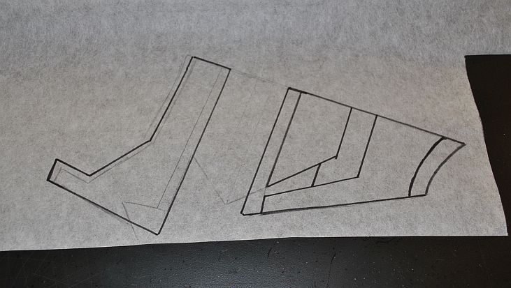

I then cut the muslin test copy apart and began tracing the final patterns onto Swedish tracing paper. During this process, details were revised, lines trued-up and templates cut for both the 'soft' parts and the pieces to be cast.

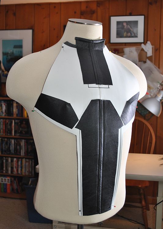

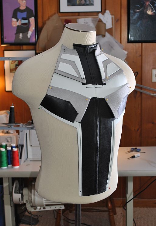

I then began by building up the base for the chest - working the vest front to back (the same way the Captain Marvel was built). The base chest pieces were cut from 2mm craft foam and backed with headliner. These pieces were then assembled with contact cement.
Once the base pieces were together, the base black areas were added. The material used here was a thin and very flexible faux leather.
From here, the green sections were traced out and drafted in headliner and craft foam to review scale and placement.

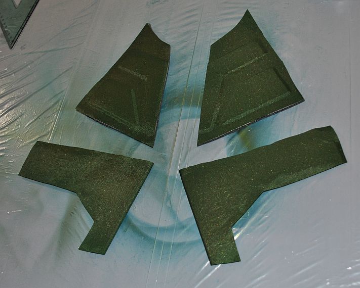

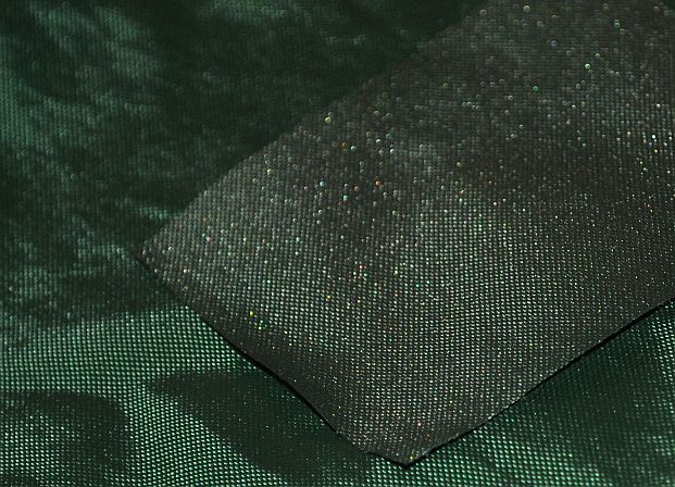

For the green sections that were being made in foam and fabric, I selected a 200 weight coated nylon in hunter green and and heavily color-working it with paint.
Initially, I'm airbrushing the fabric with an acrylic metallic paint.

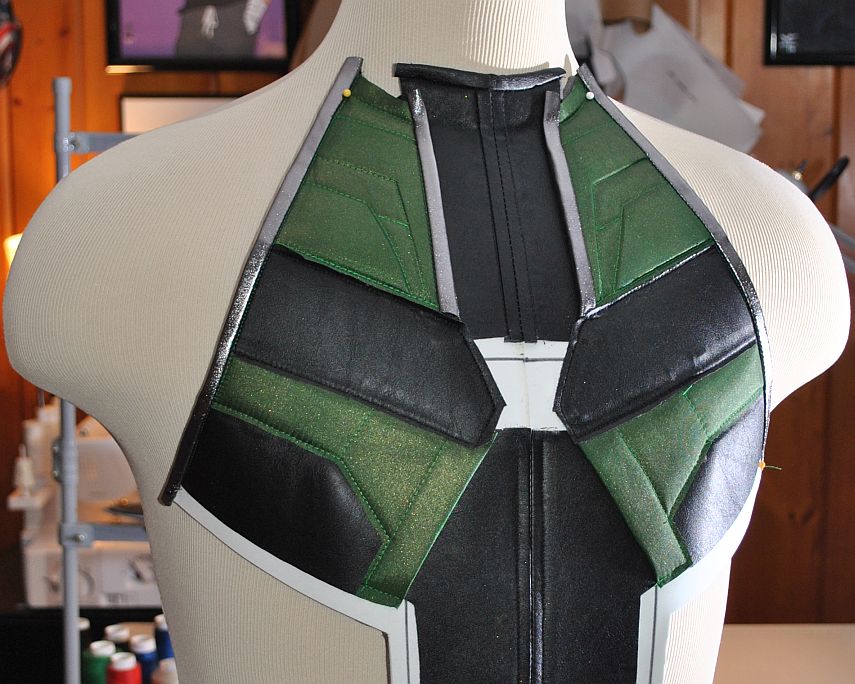

After the pieces were painted, stitching details were added (same as Captain Marvel) and the pieces were added to the base chest along with the gunmetal edging and the rest of the black that will fill in gaps.
Here's a pic of the chest so far that shows (roughly) how the cast pieces will fit on the foam/fabric sections of the chest.

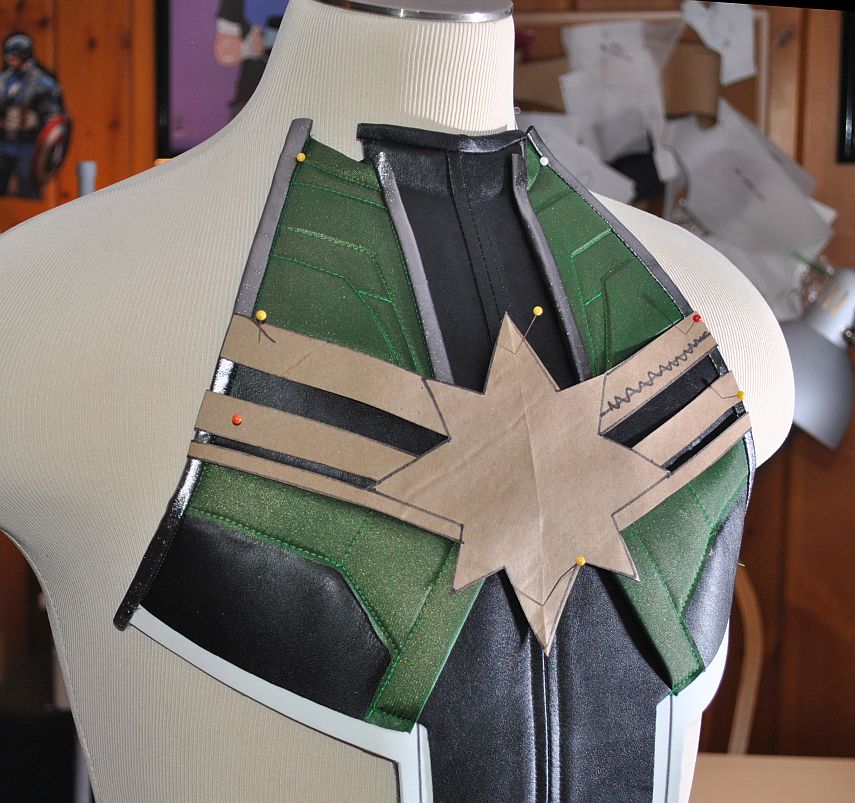

I then began rebuilding the chest plate. The new one was constructed using the same techniques as the one above, but with the new fabrics. I’m using a medium-weight blue metallic spandex, red cordura and the same red faux leather that I used on Captain Marvel.
Here’s the new chest with the paper template for the star and stripes pinned to it.

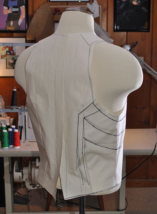

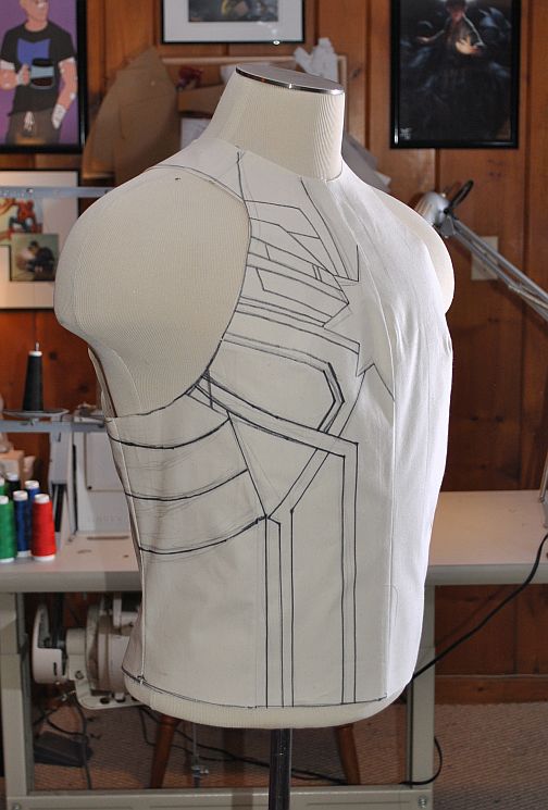

Kind of a short update, but made some more progress on the vest. Moving along, I started on the side sections. The details for these pieces were sketched out on the muslin mock up. Then, a muslin base was created and the detail pieces were cut, edged and added to the base.
The side-front sections were created as an entirely separate piece with the black section to the front and the red and gold details added. Then, the entire piece was sewn down to the main side section.
Here are some images of the side sections added to the front.
