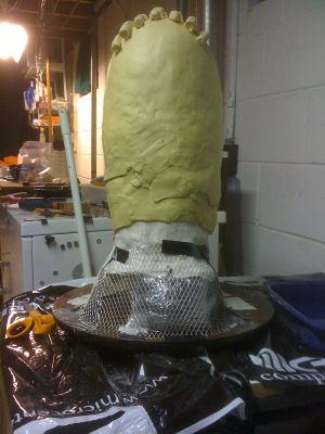

I suspect that 30 pounds of Klean Klay should be enough. I don't remember exactly how much I used when I did my Predator mask, but I know that my Godzilla mask was bigger, and I didn't use 30 pounds for that. I did have to extend the neck to make it wide enough for Godzilla's shoulders, though. I made a rough outline of the shape I wanted, using a wireform mesh, and then I applied plaster bandages over that. I still had to apply plenty of clay over it to get it to the right shape. It came out like this:
Here are some more pictures of my Godzilla mask process, along with a snarky comment at the bottom about the OpenOffice HTML editor.
