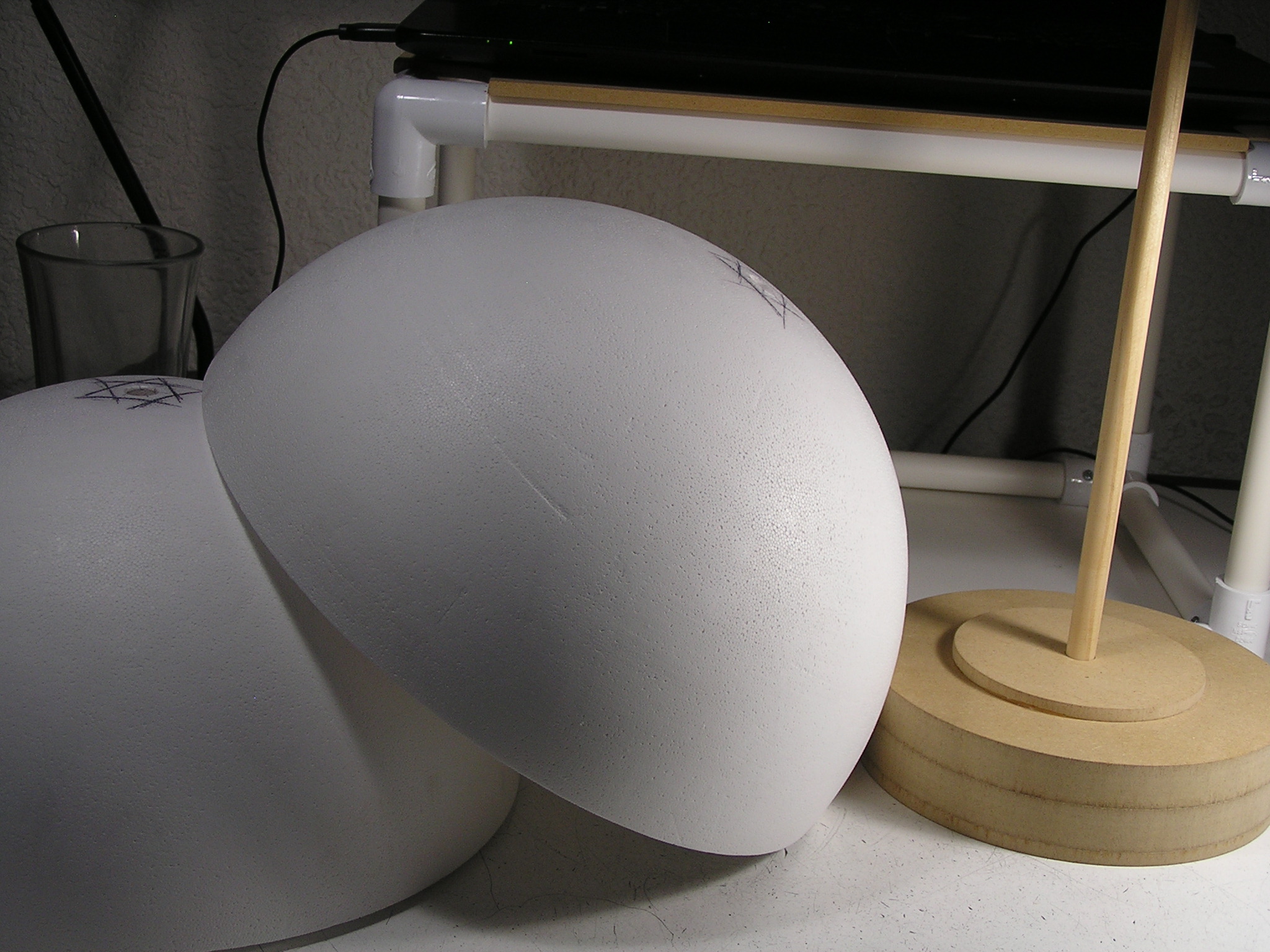

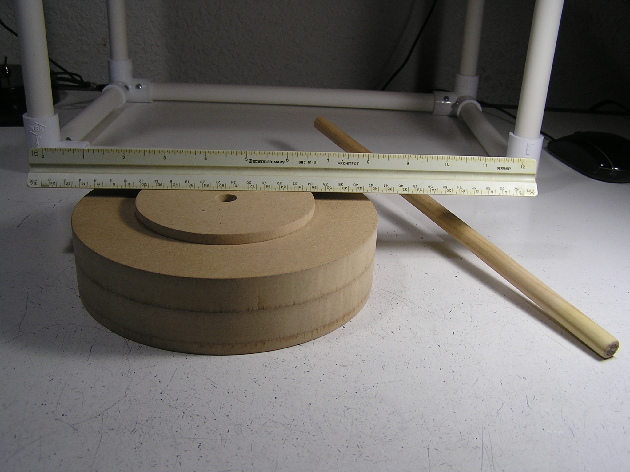

3 circles of MDF, 7.25 inches in diameter. Bottommost circle is 1/4" thick; 2 next layers are 2 pieces of 3/4". Top center circle is 4.25 inches in diameter. 1/2" hole drilled through all layers, except the bottom.
Poplar dowel 1/2" wide, 14 inches long. Bottom 2 inches sanded slightly so the dowel will spin freely inside the MDF hole.

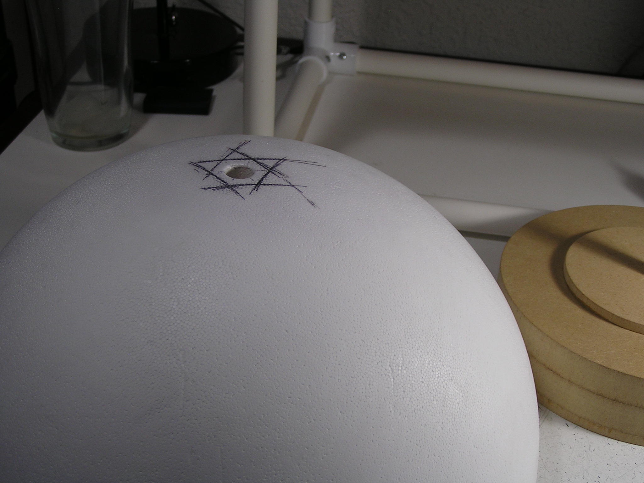

2 styrofoam hemispheres with interlocking teeth, 12 inches in diameter. Northern and Southern hemispheres designated. Sharpie marks to ensure alignment once the details starts to get painted on.
1/2" hole drilled into north pole and south pole. Hemispheres connected to form sphere. Poplar dowel inserted, creates good pressure fit, locking hemispheres together. Glue unnecessary.

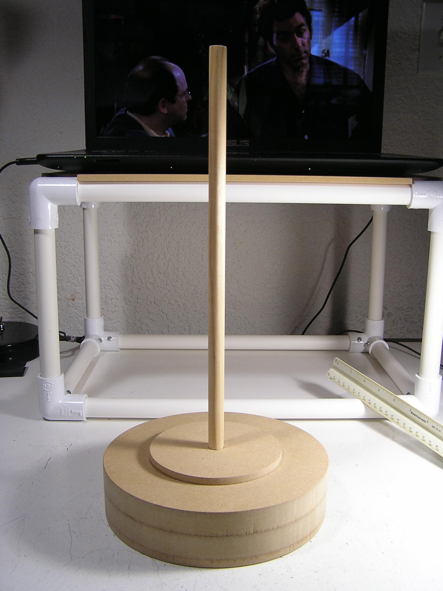

Assembly inserted into MDF base.

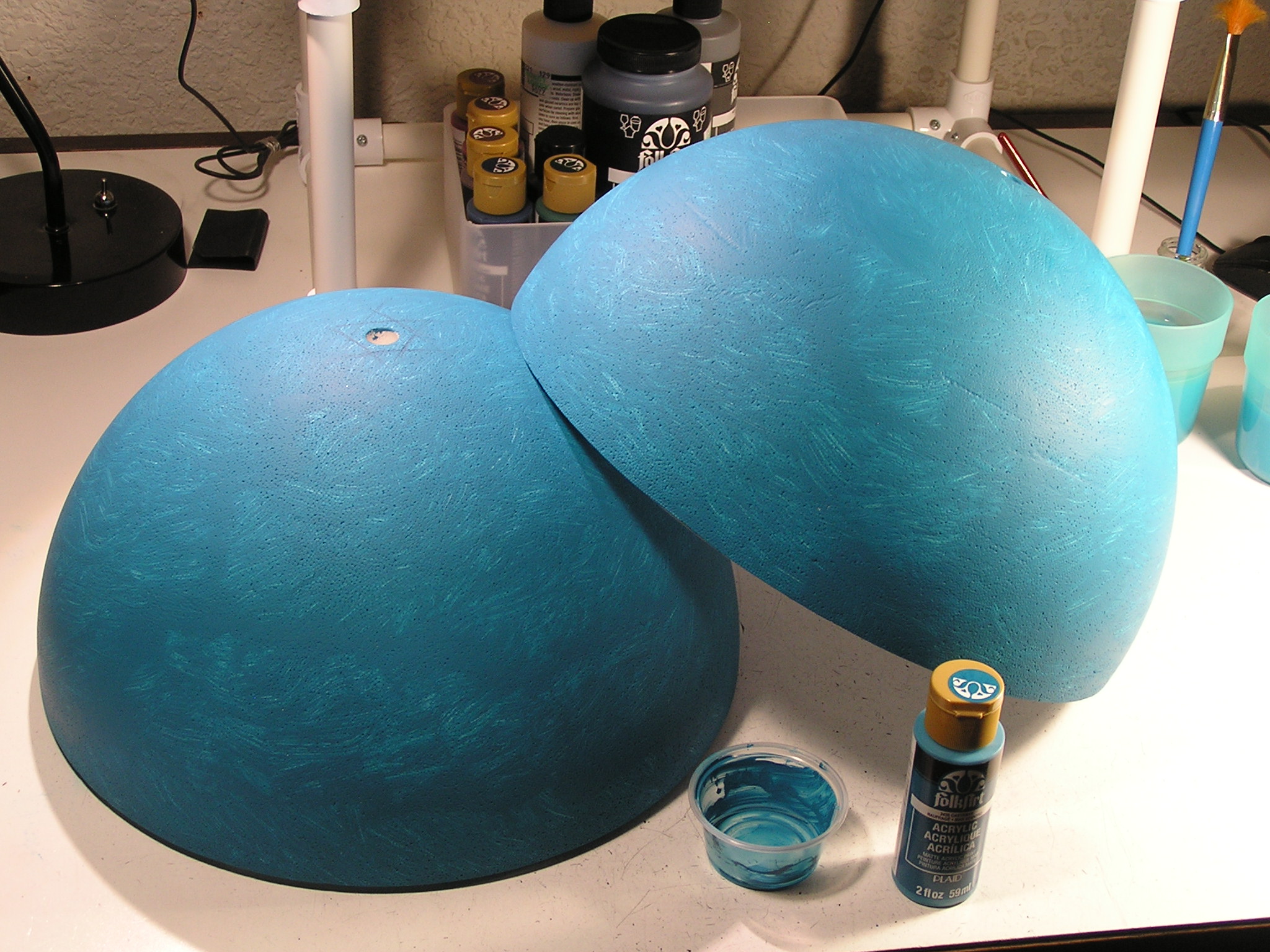

Approximately 2.5 episodes of Seinfeld to paint the first coat. It's Folk Art 2428 Castaway; a nice aquatic blue. It's a bit darker than I intended, so the next 2 coats will be a lighter shade. I want the foam cells to disappear a bit more, so I may have to do a lot of coats.
interesting project. i wonder if the paint will ever fill the foam or will you have to treat it with modpodge or something?
Mod Podge would have been a smart idea. The first coat of paint gives me confidence that 3 or 4 more coats should make the cells disappear to my satisfaction; maybe not 100% disappear, but good enough.

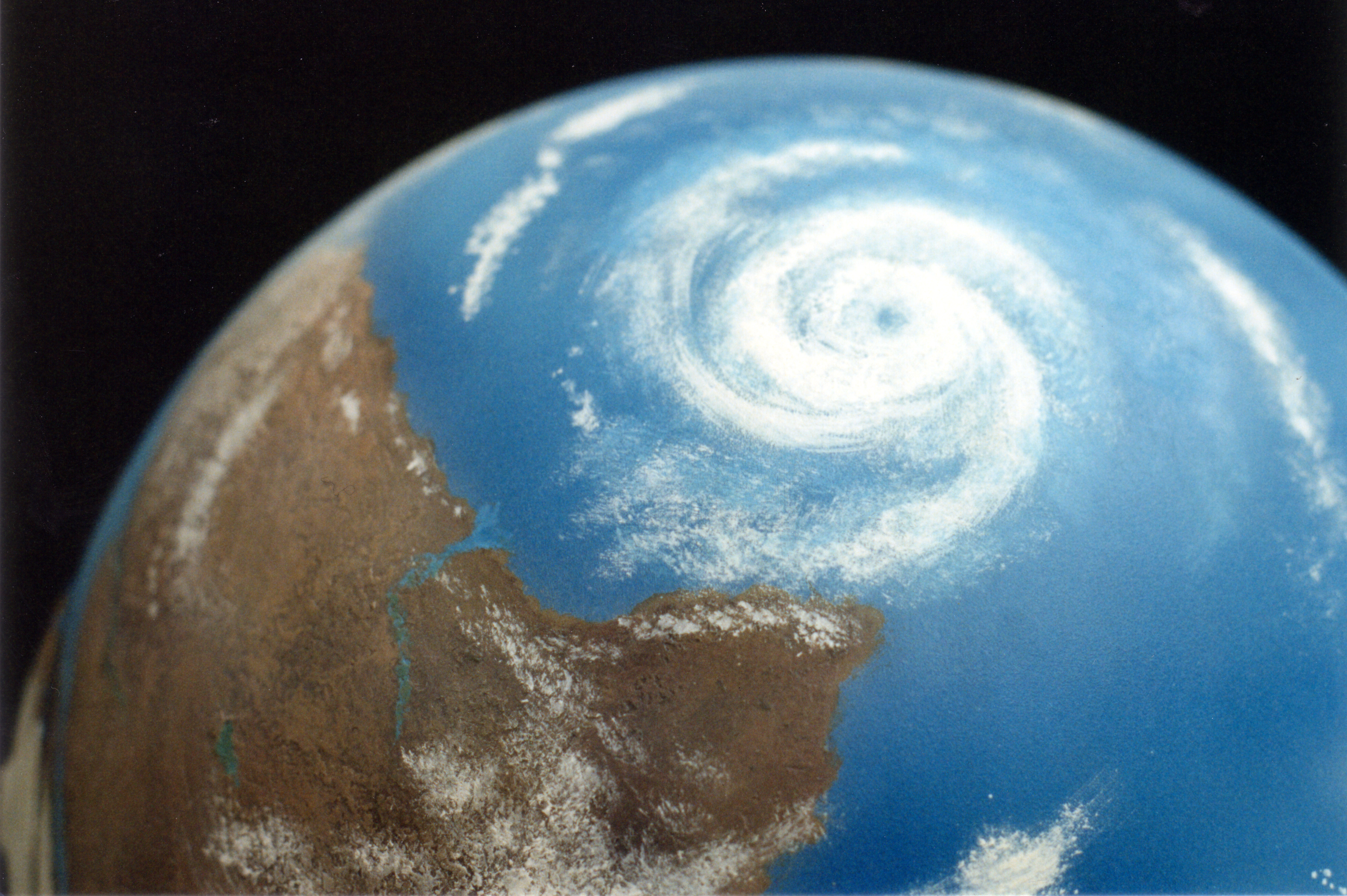

I made this a few years ago (ahem 2002), I used Tamiya putty to make the landmasses, smearing the drying putty on top of each other creates a very good layered texture that can be drybrushed very effectively, and the clouds sprayed and brushed on :)
That's extremely beautiful. Do you have a thread about it, or more pictures? My globe won't be anywhere as detailed as this. It will be a tool I've been intending to make since 2005, so that I can get accurate distances and consistent paths when describing travel in a novel I've been writing since roughly 2000. I might even need to add a coordinate grid. Been taking my sweet time.
It was made as a set of 2 Earths, 1- 500 million years old and 2- 45 million years old
Using the putty the create the landmasses was easy, because of the airdrying putty, when I apply a next layer the previous would smear out and create wonderful textures ;0
Very cool. I did not expect Pre-Cambrian Earth.

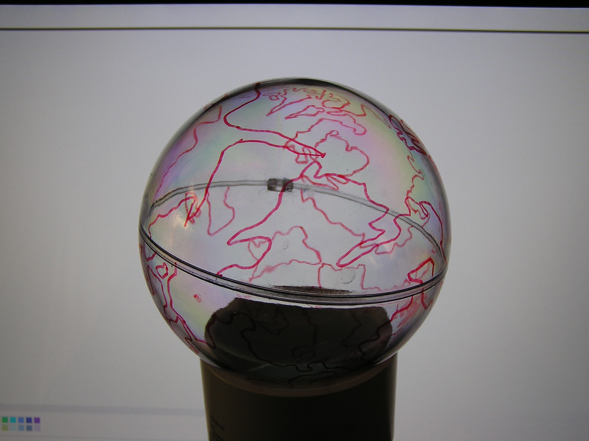

I'm using a 4" acrylic bauble and Sharpies to brainstorm where to position the landmasses. I initially wanted to use an opaque one, so it would be less visually confusing seeing the lines of the landmasses on the opposite side of the planet; but I couldn't find any opaque ones. First I scribbled the landmasses on the outer surface with a black Sharpie, then I refined the lines from inside the bauble with a red Sharpie; then erased the black lines with rubbing alcohol. While the land placements seen here are not final, at least I figured out how to use the bauble's transparency to my advantage.

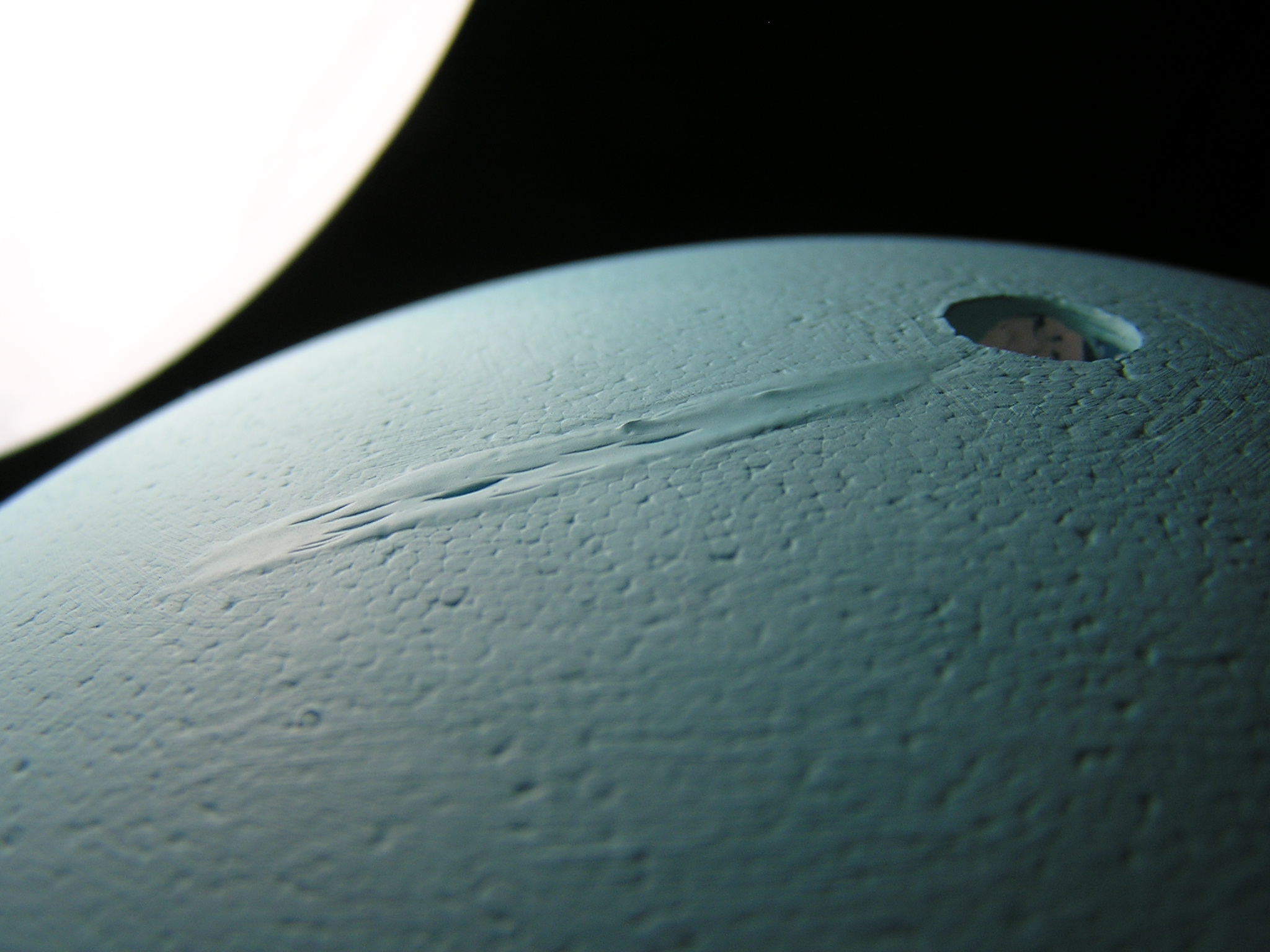

I dropped one of the hemispheres by trying to handle it from inside while the paint was still wet, and it got a nasty dent. Now I'm trying to fill the dent with paint, as dumb as that may be. I'm going to hot glue some tongue depressors into the inside of the hemispheres to serve as handles. Also, I'm starting to feel like a styrofoam ball is a huge mistake for this project, and I should have just invested in a proper cardboard ball from the start. Or maybe I should strip the paint off, and add some layers of paper mache. This is so annoying.
The paint-filled scar. Multiple fingernail marks to test the hardness over several hours. It was disappointingly soft, but I was able to rake it into the shape of a mountain, and then compress the mountain down into the dent, presumably increasing the density of the paint. The blue seen here is 3 coats of Folk Art 6459 Ocean View; and a 4th coat was applied after the pictures were taken. The foam cells really are not disappearing at all, so I've given up on that delusion. Anyway, I added another glob of paint to the scar, and I'm going to let it cure for about 2 days, to see if it hardens to a point where I can sand it to shape.

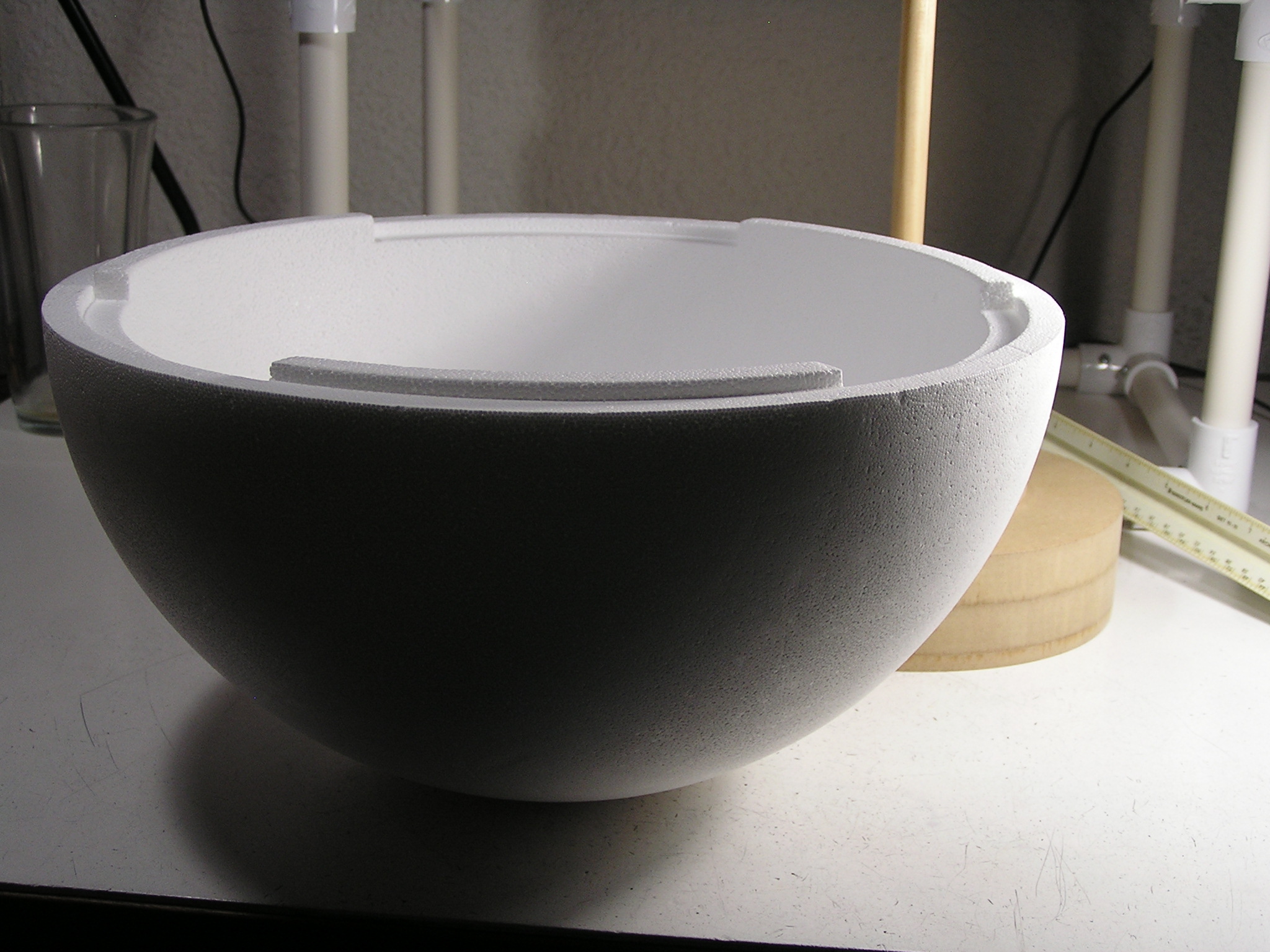

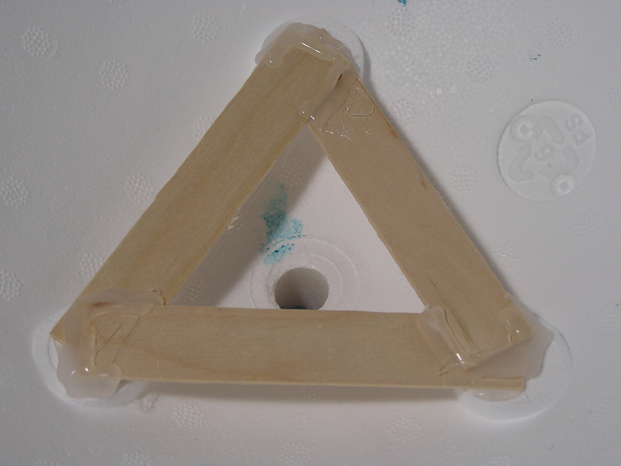

There are 3 cylinders protruding from inside each hemisphere, making the ideal spots from which to glue the aforementioned tongue depressors. Both hemispheres received identical handles. I've tested them, and they're working exactly as intended. Something interesting to note is that the manufacturer's circle that appears to be the interior center of the hemisphere is not the true mathematical center. The hole that I've drilled is. Both hemispheres look this way.

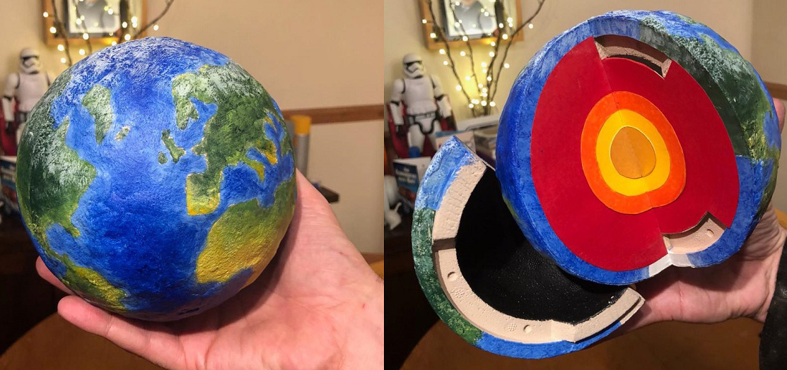

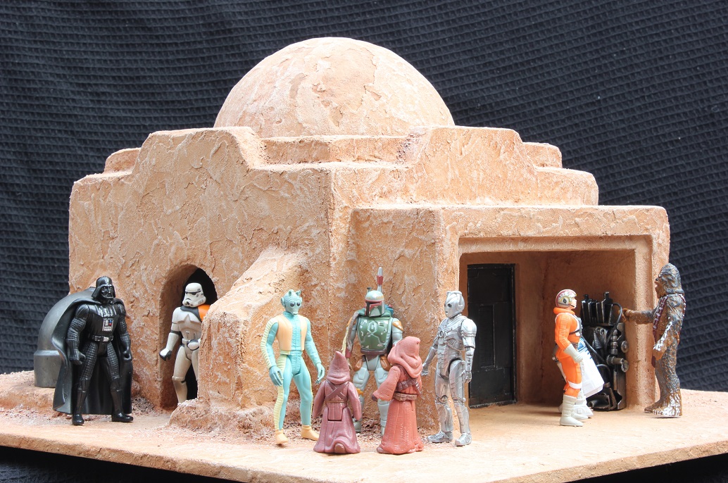

I made a globe a year or two ago out of a styrofoam ball and covered it in household spackle that I textured for the land and sea masses, then painted it up. The piece was extremely tough, very durable and survived being taken to school by my daughter where it was rough handled by her classmates. When we got it back, there wasn't a mark on it - not even a scuff or a dent.
Forgive the roughness of this piece, but it was done in an afternoon (a last minute request, so to speak) and had to be made to look like it was put together by my daughter for a science project. But you get the idea.

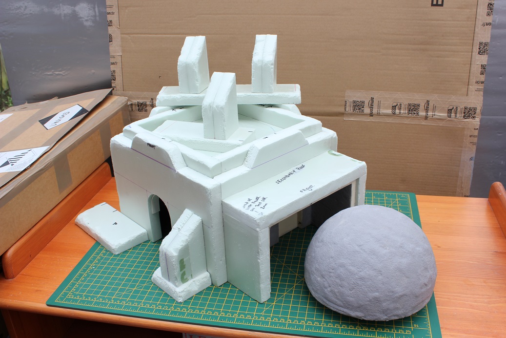

EDIT: I just remembered, I used the same spackle technique on another foam build, this time a Star Wars play set for my son.
One day, I'll finish it off for him with various plant on details and proper weathering.
Those look amazing, and I've considered plasters, but I'm very hesitant to use anything that will potentially produce gypsum dust if it cracks. I'm considering something like paper mache, but with carpenter's glue.
If it's any consolation, I have pieces like this that are nearly 25 years old and I've never had it even remotely crack, let alone crumble. I don't know if US spackle is any different from our UK household filler, but I think they'd be the same more or less. You could mix carpenter's glue or PVA as a binder, I've done that before when adding grit to the spackle, so I suppose that it can give you extra peace of mind.
Failing that, try an acrylic render, Jesmonite (developed for the housing industry, but adopted by the film industry for scenics and model work) is a great one, it goes on like spackle, but is for all intents and purposes a plastic.
I personally haven't used spackle in over 15 years. I may have to buy a small tub of it, like 10 or 15 ounces, and do some drop tests with a smaller styrofoam ball.
