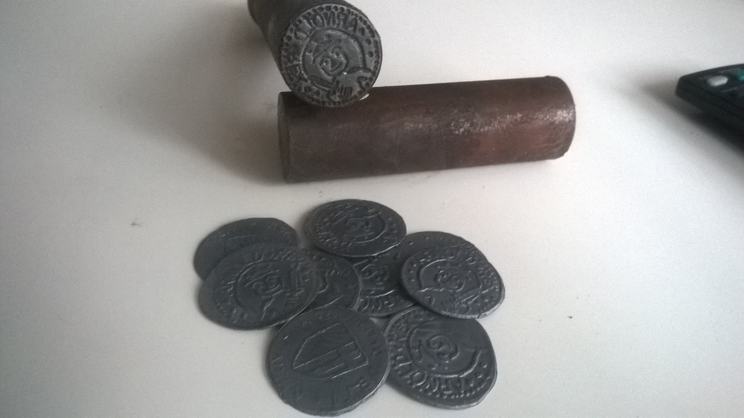

Really nice coins. But you say that you etch the coins because it is cheaper then having coin stamps made. But why not etch your own? I've included a picture of the stamps I made, the coins are lead because my hammer isn't heavy enough.
What are you using for coin blanks?I've tried to flatten coins but they got to hard to use.
-R-
I hadn't thought of etching my own die. I would still need a 60 ton press (according to the listing) to make a clean stamp, so I etch them. I actually do find etching to be a soothing thing. Some people yoga, I etch. The blanks I used can be found on Etsy or Ebay. They're conveniently called coin blanks.10 for $7, or 100 for $40
