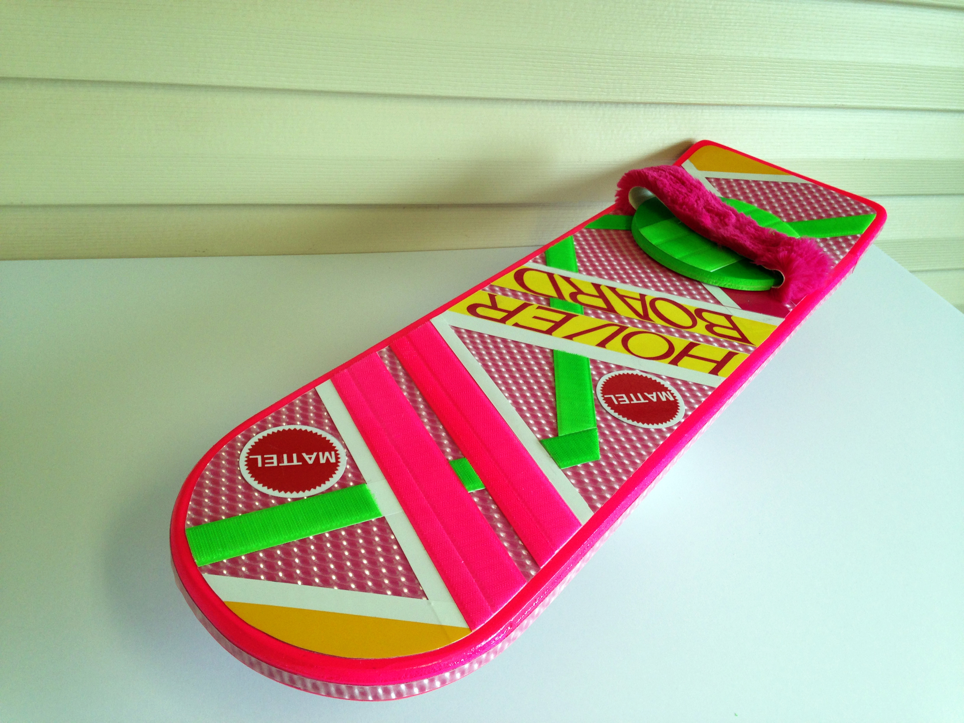

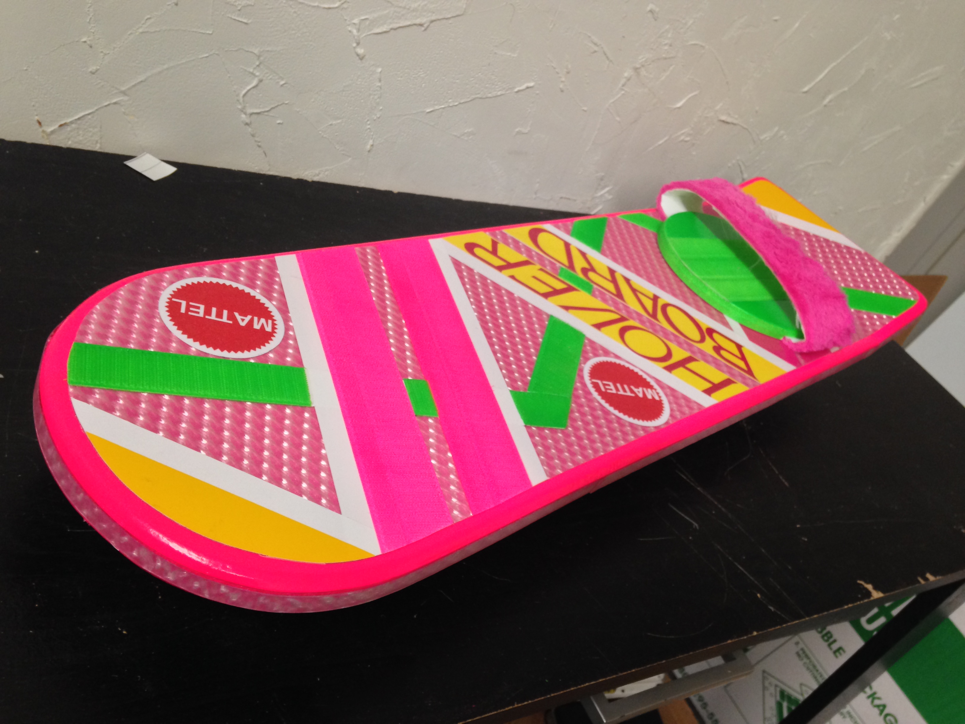

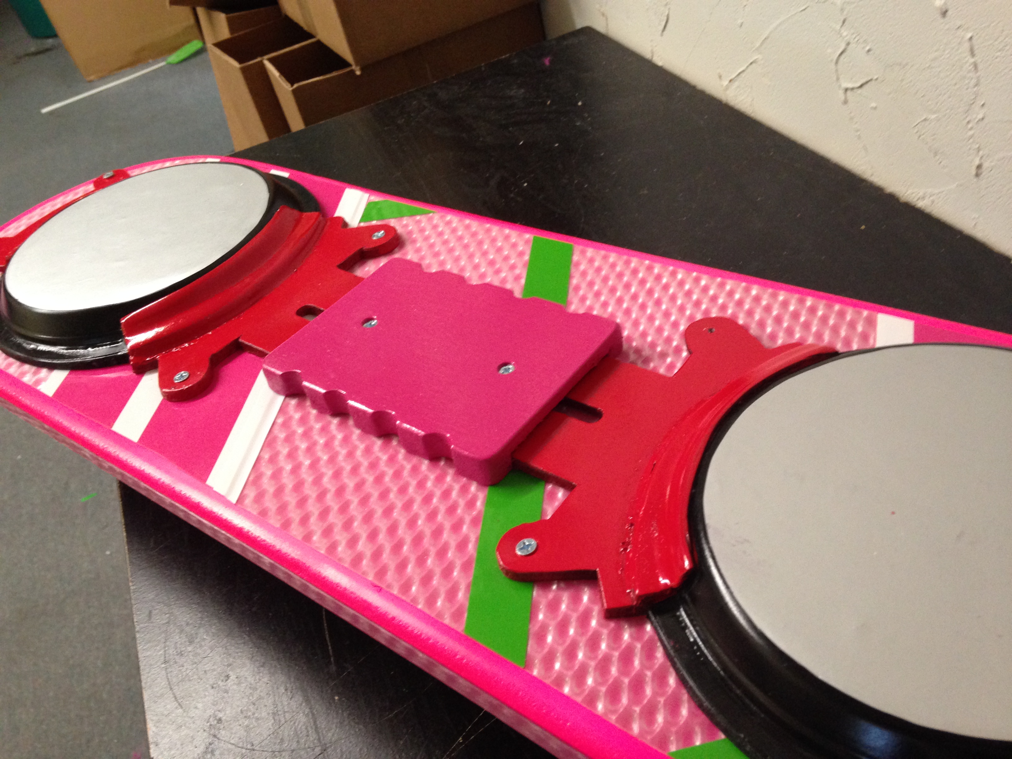

Here is the latest hoverboard production. I have switched adhesive materials so the lenticluar material on the side is flush with the board. I also adjusted the size of the foot pad - it is actually supposed to be 6" I made it 7" before - my mistake - and I have adjusted the radius of the board edges and decals so they look really close to the original hero board. Tell me what you think! IMG_0767.JPG

Maybe you should start your own progress thread....

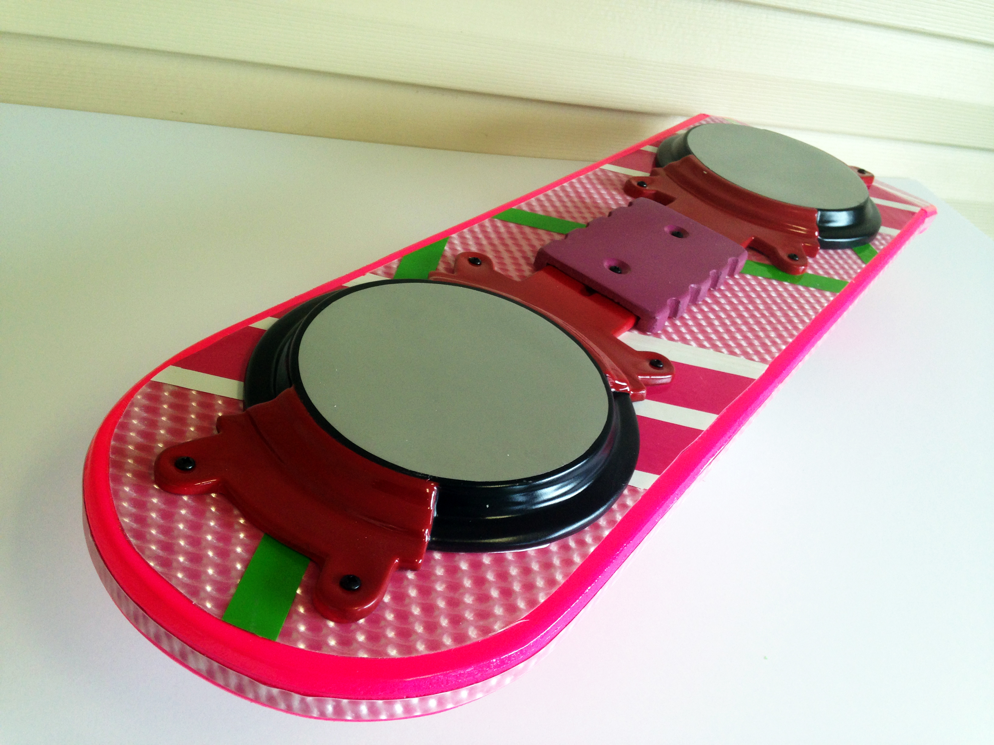

I was able to exact color match the battery pack on the Hero hover board it is almost a Barbie Pink! Very cool! Here is a pic of my latest. BTW I am getting a set of vacuum formed parts cast from my originals for my next build that is exactly like the screen original. IMG_0800.JPG

Here is the latest hoverboard production. I have switched adhesive materials so the lenticluar material on the side is flush with the board. I also adjusted the size of the foot pad - it is actually supposed to be 6" I made it 7" before - my mistake - and I have adjusted the radius of the board edges and decals so they look really close to the original hero board. Tell me what you think!View attachment 350120
Great work contec Looks amazing!!

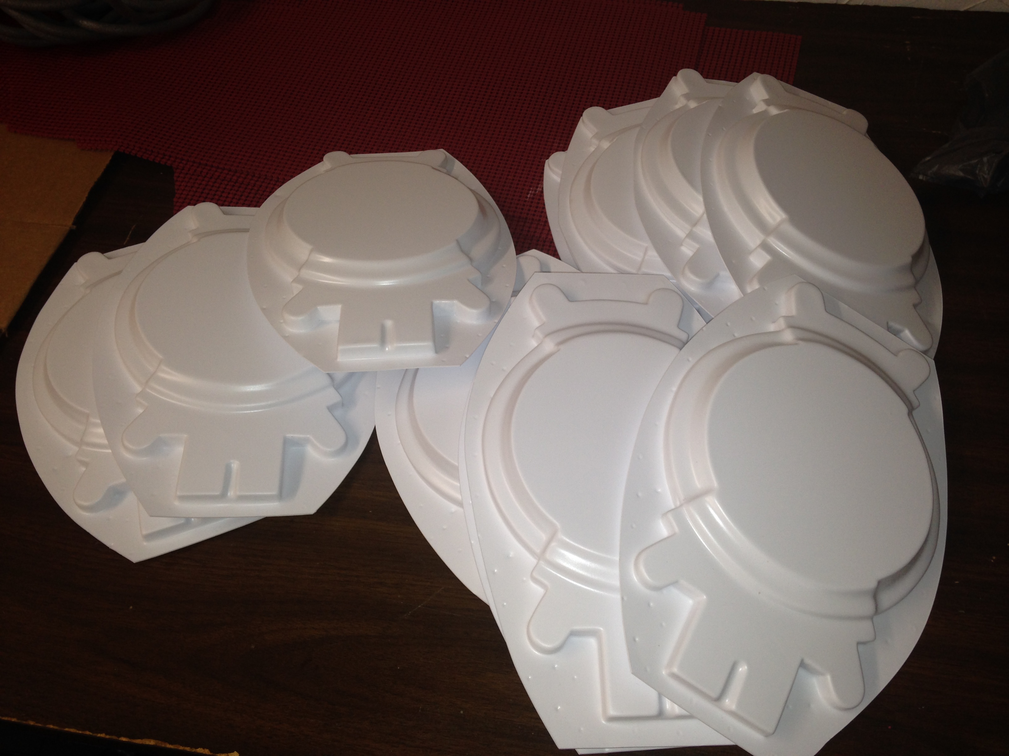

Hi backintime2015! This is exactly what the front and sides of your board will look like... however, I created resin parts based on Bob Gales actual schematics from the original prop - I have had a third party vacuum form all of the parts for my final build. The parts will arrive this week (Wed) and I will ship your board out soon after. You will enjoy the board I am quite sure!

Will my boards green velcro match the thickness of where it splits off? In your ebay pics the width of your velcro looks off and not accurate.
Sent from my SM-N900P using Tapatalk
The green velcro is in 1" pieces all the way down the board. And as you can see in the picture here - I am using a 1mm 3M double sided adhesive film instead of the double sided foam tape. It will withstand heat up to 158 degrees Fahrenheit. It will look like it does in the picture above - screen accurate.

I saw the ebay pics - I have made changes to the angle of the velcro and now it is flush as you can see in the pic above.

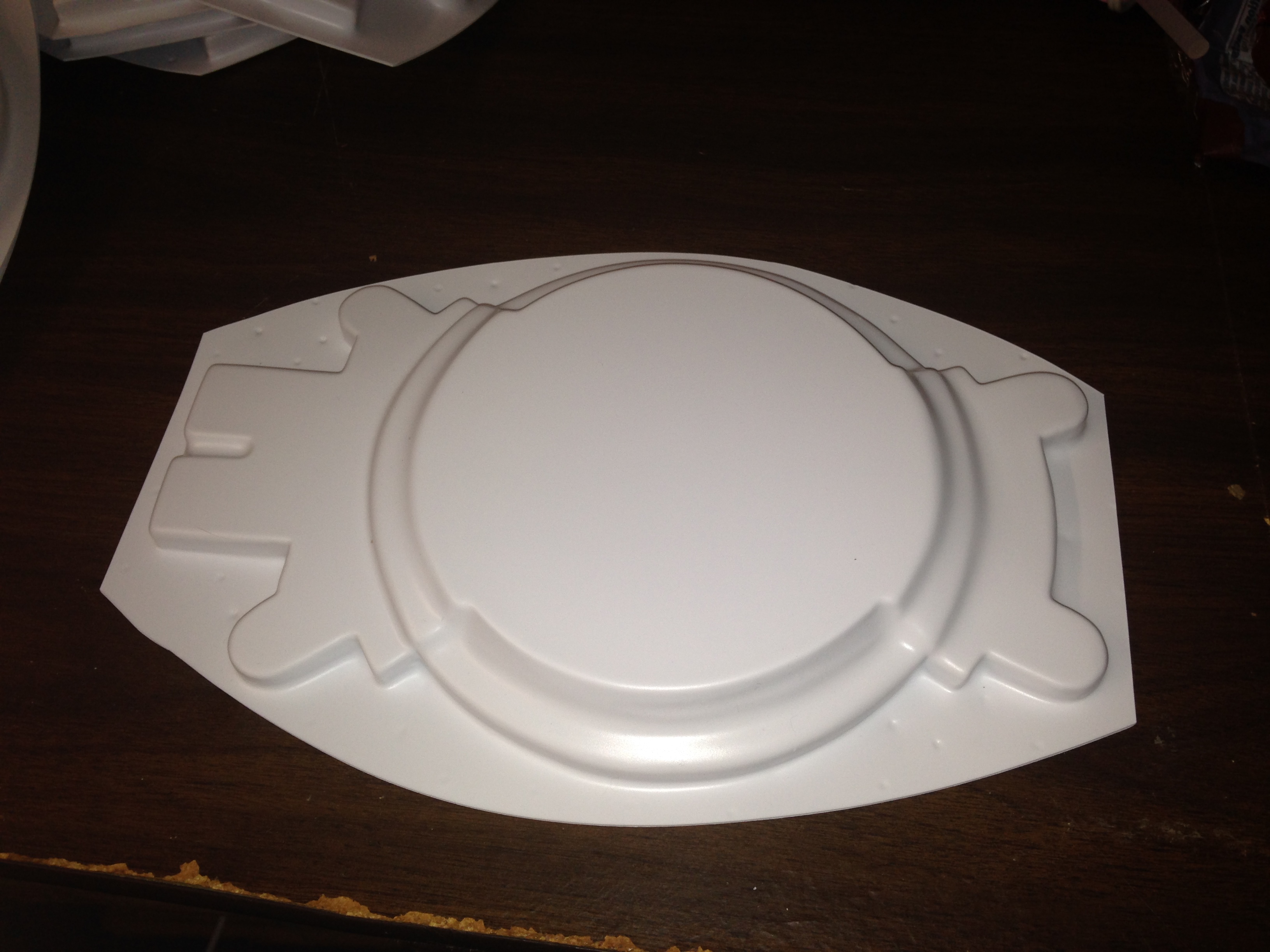

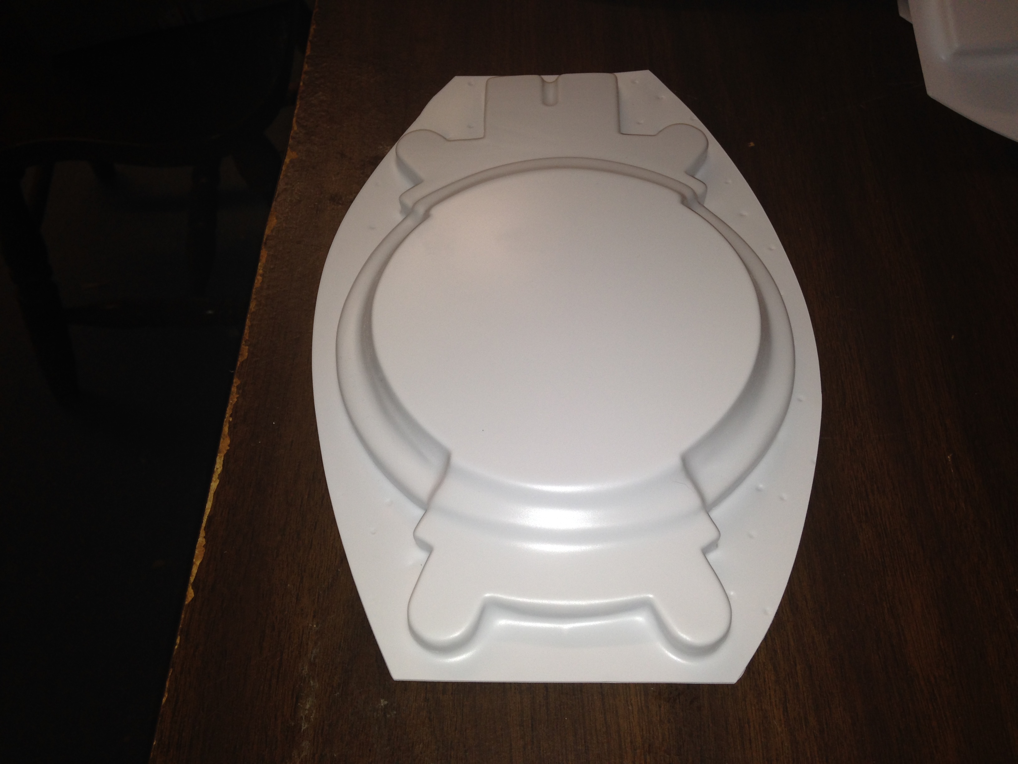

Here is a solid resin part - the battery pack - made from my RTV cast that is going to be used to make the vacuum formed part. And the color is screen matched - I had it mixed by a painter and now I have the correct color! Yay! View attachment 351147
Here is the latest Hero Hoverboard with the all new Vacuum formed parts pulled from my resin cast.IMG_0856.JPGIMG_0862.JPG
