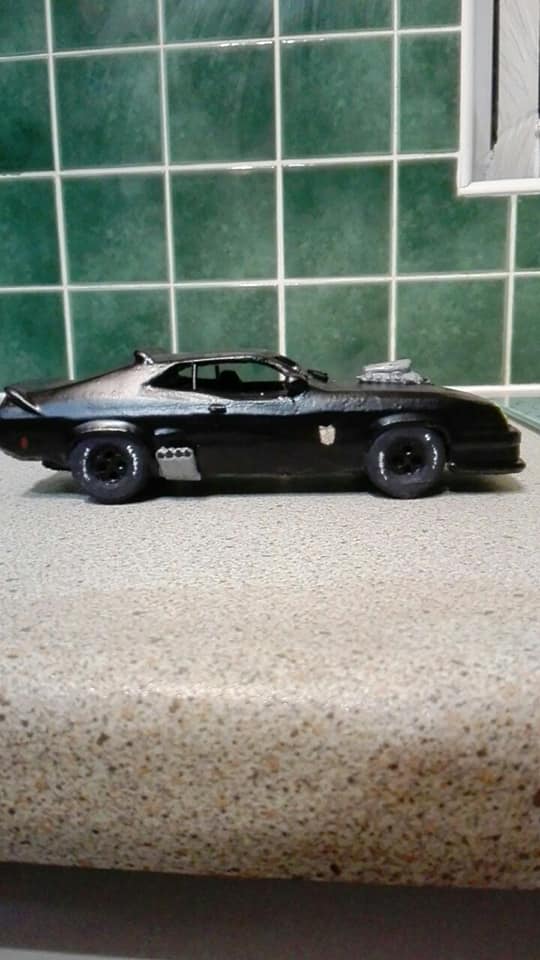

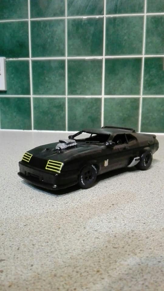

This is a work in progress (for about ten years!). It's a '70 Torino with a '73 Mach I Mustang hood and modified Dodge Daytona front clip. I also shortened the rear end and built up the area above the rear quarter window.

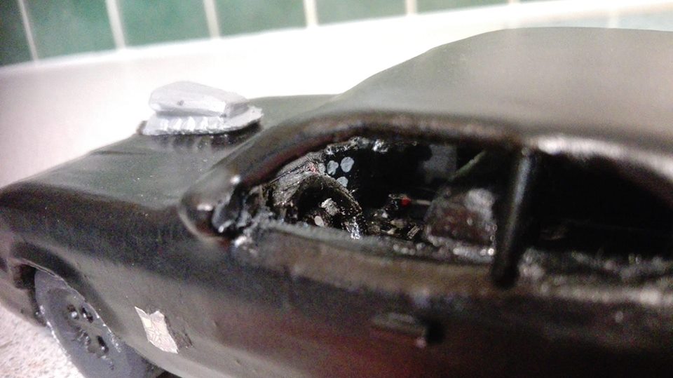

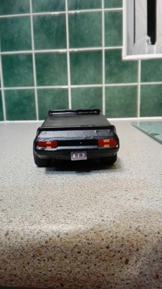

Don't be too harsh on this one. I built back in high school, around 1984. It's a '77 Mustang with another '73 Mach I hood and a mid '80s front clip. The fuel tanks are 1/35 scale 50 gallon drums. I even converted it to right hand drive.

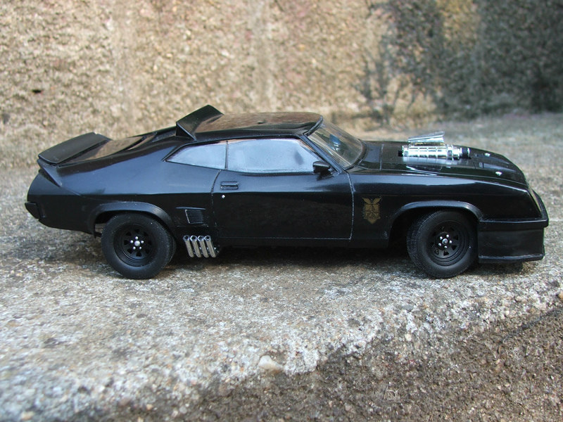

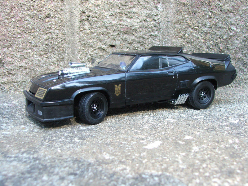

The Aoshima kit is still the best one out there. here's one i back-dated to the first movie version:
Mad Max Black on Black by aus_mus, on Flickr
