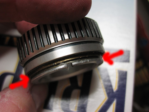

I finally beat the Seagull camera to bits to remove the knob and now I think this piece needs to be removed in order to remove the clear plastic and numbers inside.
Does anyone know what to do here? I tried pliers and it won't budge.
No man, the black ring on the face is threaded. You don't have to remove that bottom piece.
It took me forever to figure that out, I was getting mighty p o'ed and realized that little black ring just unscrews.
Good luck and lemme know if you need any other help!! :)
Lol! Thanks. It took me a while, but I figured it out. The Seagull is an absolute riddle.
How many rotations does it take to get the black ring out?
I don't think the knob on mine is as perfectly round as it should be, so after an hour of trying and two sore thumbs it's moved maybe 10-15°.
It is very thin. Shouldn't take much at all from what I can remember.
