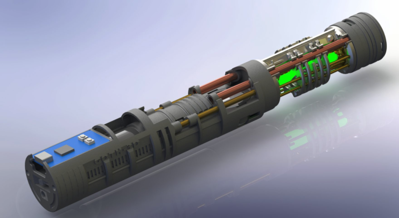

I was looking at the Rudy Pando's V3 chassis made by GOTH Designs and I think it would be a good contender for this V2 but I dont really have proper measurements to make sure... whatcha think?

Did some quick checking on mine and it looks like it could fit, although you'd probably have to shave down the cone knob screw. The ID of the pommel (2.97cm) is smaller than the booster, and the ID of the grenade is ~2.8cm (my calipers didn't reach so I had to find something that just barely fit, and a lighter at 2.77cm across did the trick). The booster and pommel should be just long enough, too, although that I couldn't measure exactly
thats sounds great! thanks for taking the time and measuring the I.D.! this may be a strong contender for a crystal chamber reveal ;)
