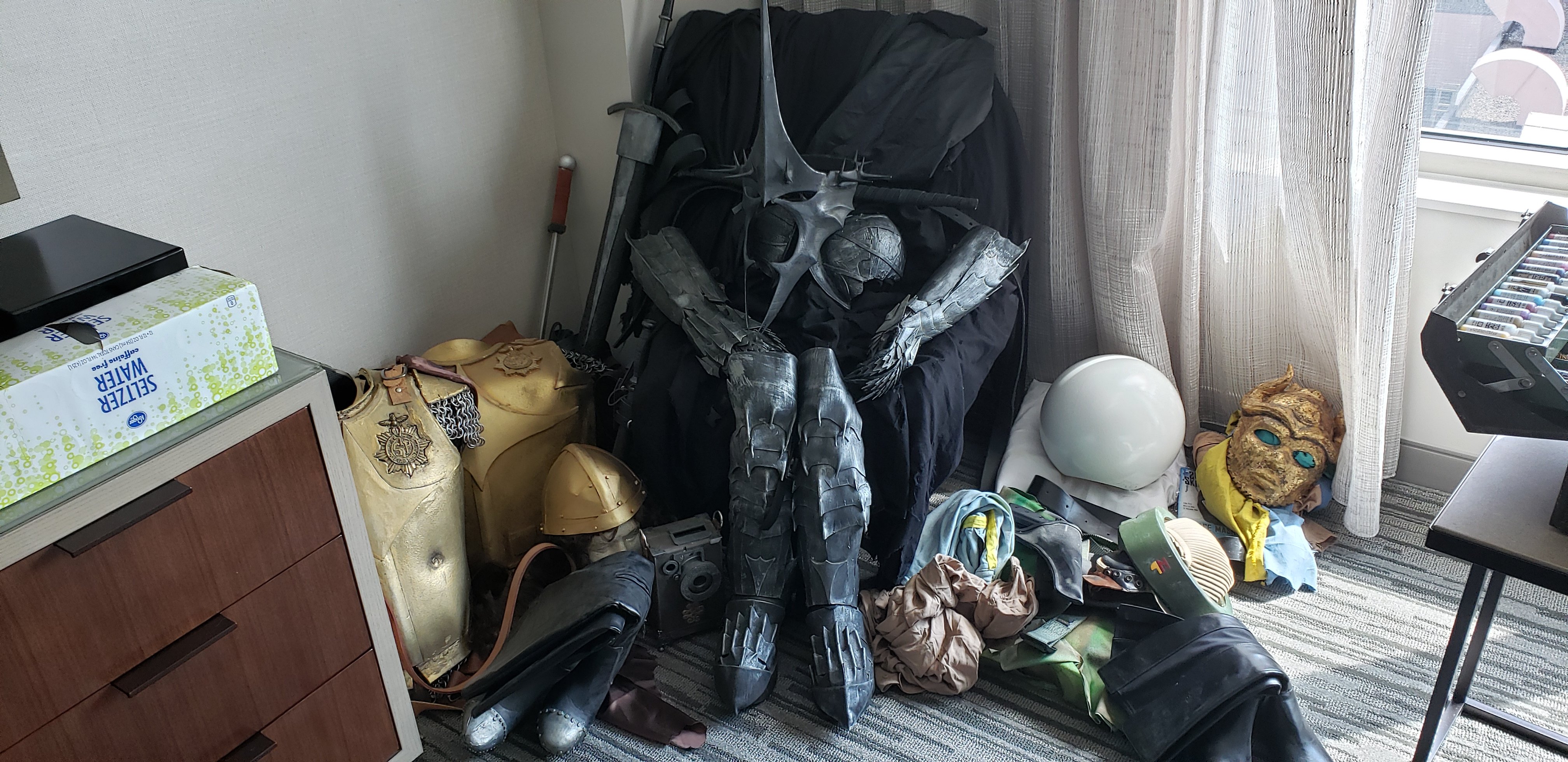

New Punished Props video he makes a Ring Wraith robe, very helpful
My robes were free hand, but the boots/leg armor were patterns I found online. If you want em I'll send em to you.
