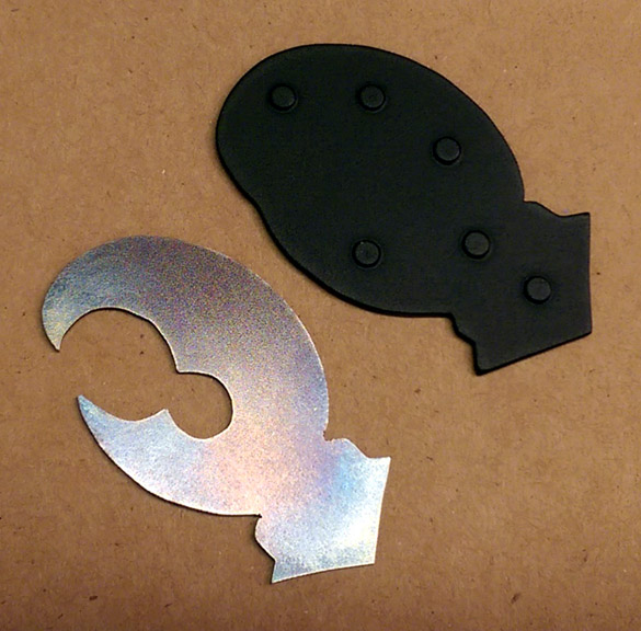

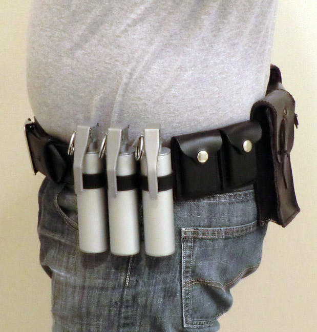

So I had a bit of a setback... it never occurred to me to measure the thickness of the belt. Turns out it's a whopping 1/4 inch thick :oops: It's beefy! Unfortunately, the clips on the grenade plate are just barely 1/4 inch deep at the bends. But with the nubs of the pop rivets intruding into that space, the belt gets hung up on them. And leather doesn't compress. Thankfully I *did* have the foresight to check this *before* I attached the grenades.
Anyway, I found some clips online that are allegedly 1/2 inch deep at the bends and they're arriving tomorrow. I also pulled a new styrene plate and got it trimmed down and marked for drilling.

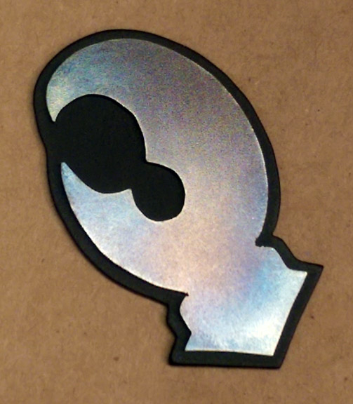

In the meantime I tackled the claw electrode for the left glove. I hadn't really thought much about it and was simply going to make it out of styrene. But when I *did* start to consider it, and began thinking about how I would paint it and how I might achieve a burnt metal effect, it occurred to me (duh!) that I could just cut it out of metal and burn THAT with a torch. Which is exactly what I did. After zeroing in on the proper size with a few print-outs, I transferred the shape to a sheet of .030 inch thick steel and cut it out with a jeweler's saw - took all of about 5 minutes. After said torch burning, I brought back a bit of metallic shine by buffing it with steel wool. I cut a backing plate out of styrene and added some stand-offs - just to add a bit of visual interest by raising the metal plate off the surface - and painted it flat black. I then glued the two together with a bit of JB Kwik epoxy.
And then I attached it to the glove with Barge.

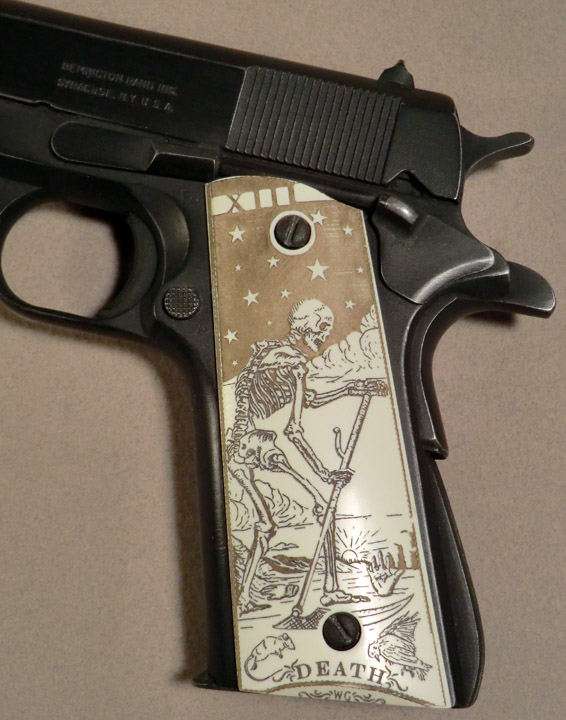

I also tricked out my 1911 with some custom grips. The gun is a solid resin casting that I bought from Matsuo years ago.
I had been thinking for a while that I wanted some unique grips for The Lobster's gun. A couple years ago I bought some faux ivory grips with the Masonic symbol on them - I thought that could imbue the character's background with a little bit of mystery. But I was never completely sold on the Masonic symbol... and the grips were a bit plasticky looking (they weren't that expensive).
I decided to take another look online recently, to see what might be available, and found these at Wicked Grips. I thought they were perfect for what I was going for. The Death card from a Tarot deck in scrimshawed ivory (actually laser-etched resin). What could be better? Definitely lends a supernatural vibe to the character.

Yeah, I'm basically done - I just have to assemble the grenade unit and that will be it. I got the new clips and they're actually about 3/8 inch deep at the bends - should be plenty of room. I got them trimmed down to fit on the plate and all that's left is to drill them and drill the plate and assemble everything.
