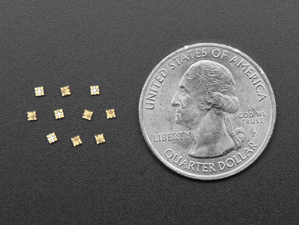

Was it this LED strip? Ultra Skinny NeoPixel 1515 LED Strip 4mm wide

yes that's the one, I used 2.5 strips, 1.5 on the back side of the blade all the way to the tip and 1 strip in the front side just short of the 1st slope change.

The problem of the skinny leds i had to use is that they are rgb only. Cant fit standard sized neopixels.

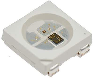

They have many different sizes of 'Neopixels' (WS281x)
Example:
I believe they are 1515 size packages.. and not the normal 5050 package
Yes, the link you sent is 7.5mm wide... I cant use that on this blade. Need the 4mm wide to be able to fit inside the hilt section. Also those are too tall and would be covered by the opposing wall as they dont have clear casings
The 1515 are clear on the sides and just about 1mm tall which leaves about 2mm before hiting the top wall.
