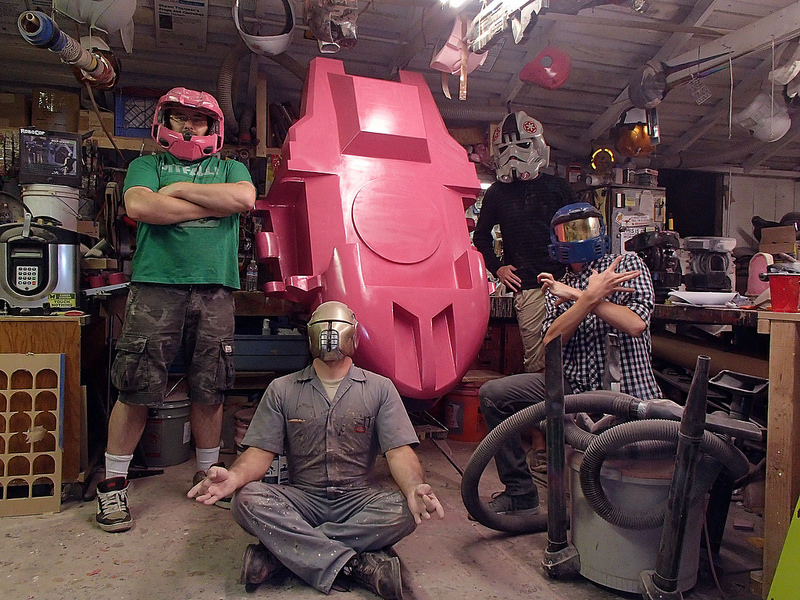

Plenty nervous. If you go to Maker Faire | The Greatest Show and Tell on Earth, they've got a countdown until the gates open for the event. As of moments ago, there are 17 days and 10 hours before this thing will be unveiled for the public. So yeah. Not enough time.
Today was a busy day that ended like so:
There's a handful more pictures to post, but I don't have the energy to make a worthwhile post. Instead, here's this:
