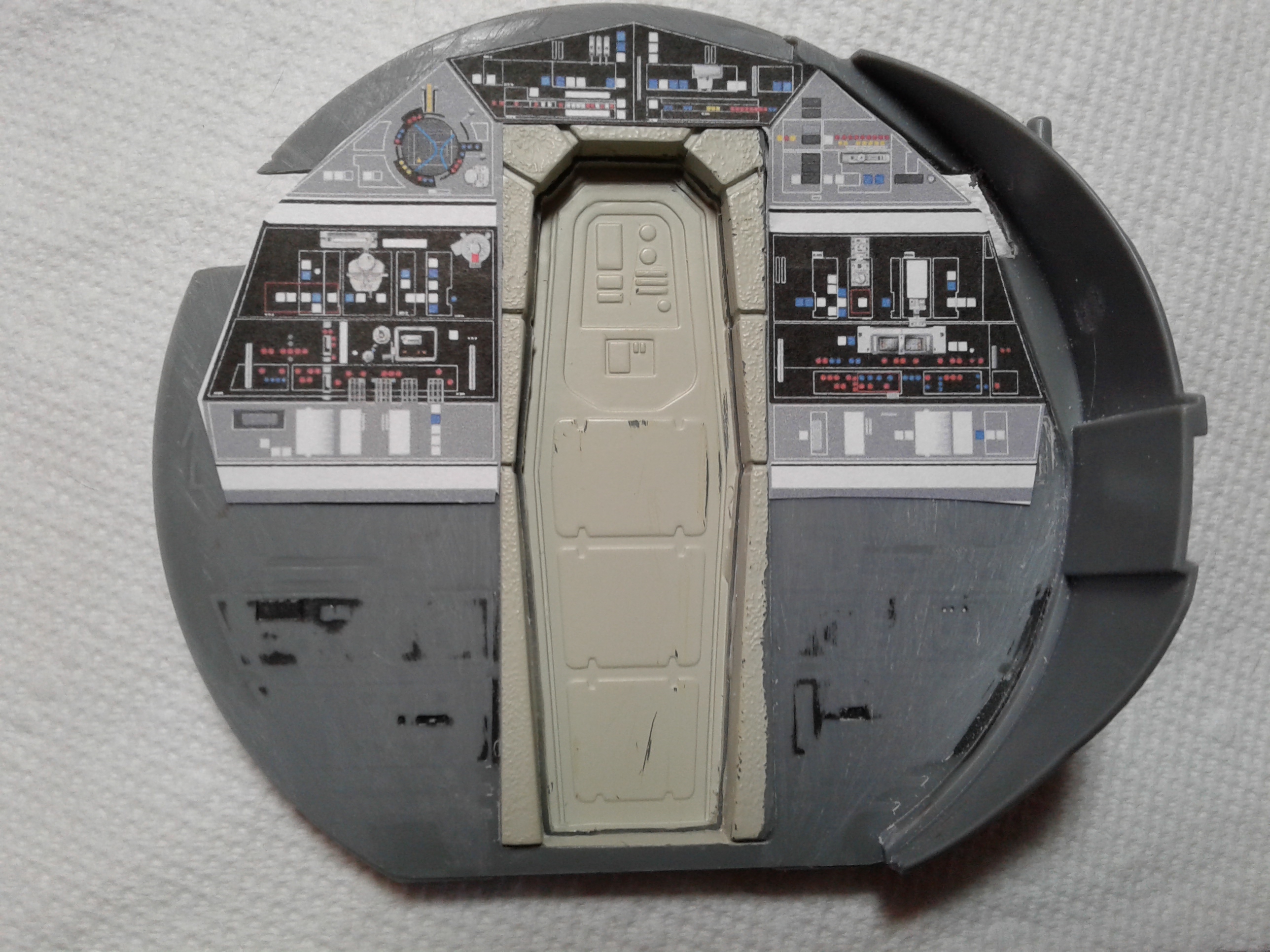

I have completed cutting and adjusting the cockpit bulkhead's door way. It's not perfect but close enough. I checked fitment of my custom decal, and found Hasbro offset the cockpit sizing on the black panel near the top center. It's been elongated about 6% or so. I will add more lighting with the new panel size, while I finish up the bottom grey panels and bottom light bars.
Don't mind the door being marked up, light scratches from hack saw. I am not a pro, so I used basic tools on hand. A small rotary cutter would have had cleaner results. I figured on doing painting, so the marks won't be a problem.

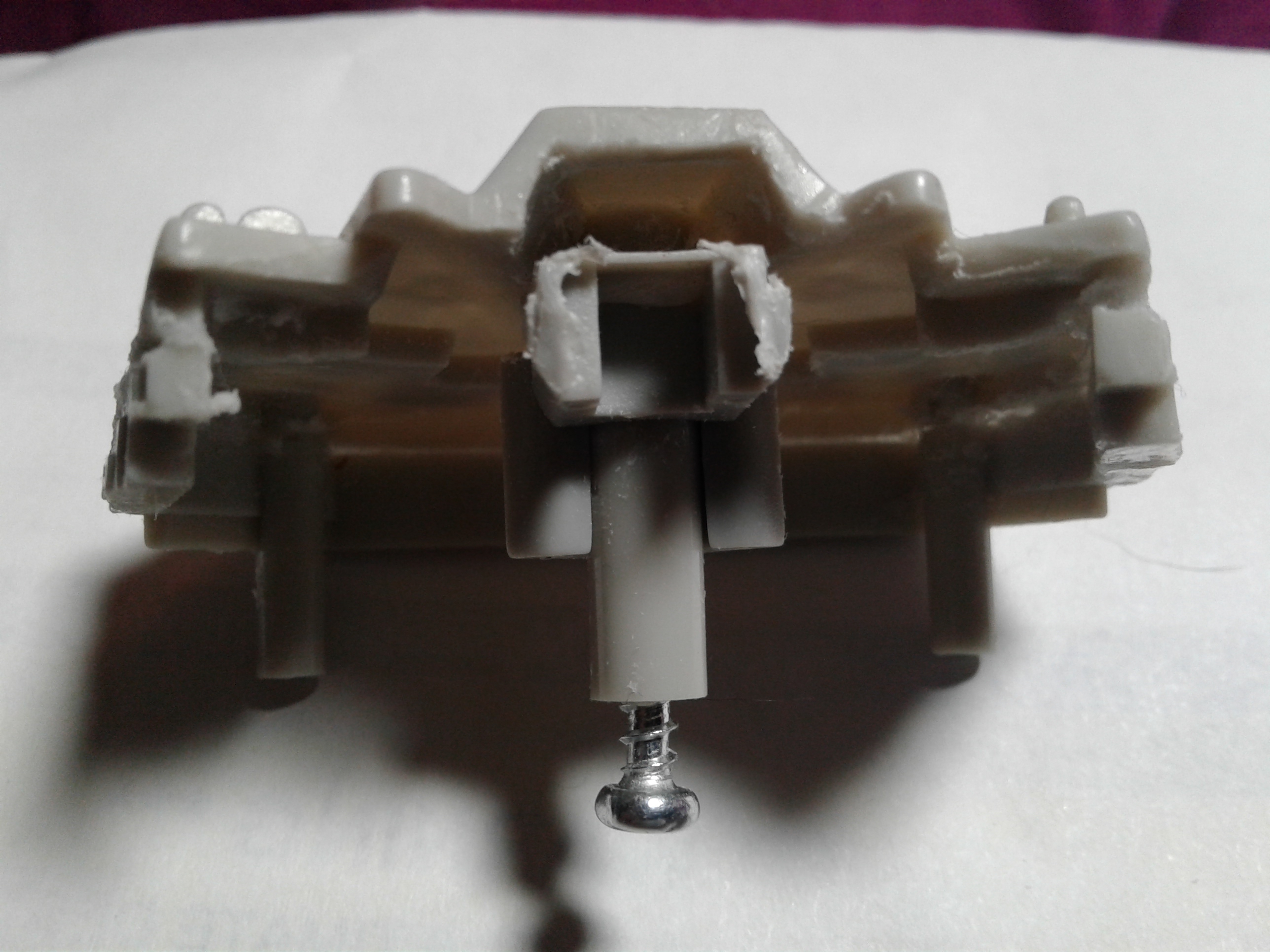

In aggravation, I mangled up a quad canon box, for use with a Heroes 3D printed replacement canon. It felt good! Ha!

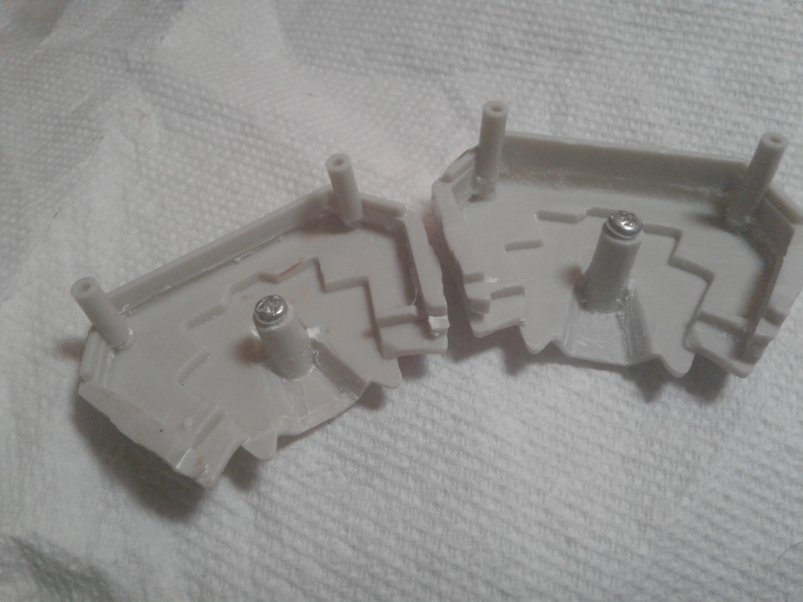

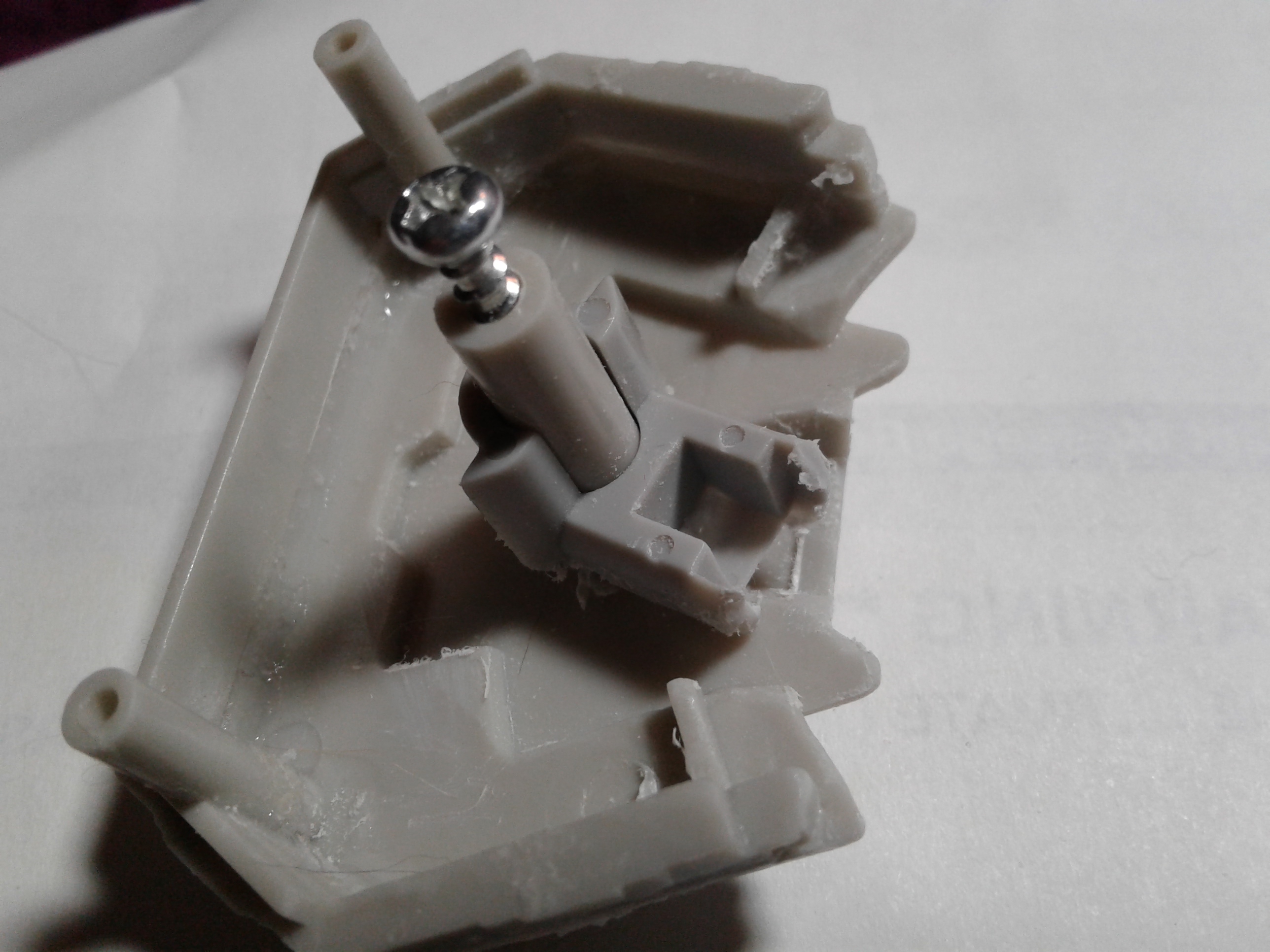

Here is what I have done to make it have articulation, unlike all other 3D parts upgrades. The canon won't be as stong, so I hope my securing with fishing line holds up, unlike my first trial... a 2 meter drop, and missles flying everywhere on impact. I doubt a 2020 Legacy Collection Falcon would have come out as clean, from hitting tv top and the floor.
I have yet to trim the center mounting leg, for proper fitment, and create my fill in paste, using a muxture of the original toy plastic dust, from sanding and MEK. No painting required and will make the piece look molded, when done.

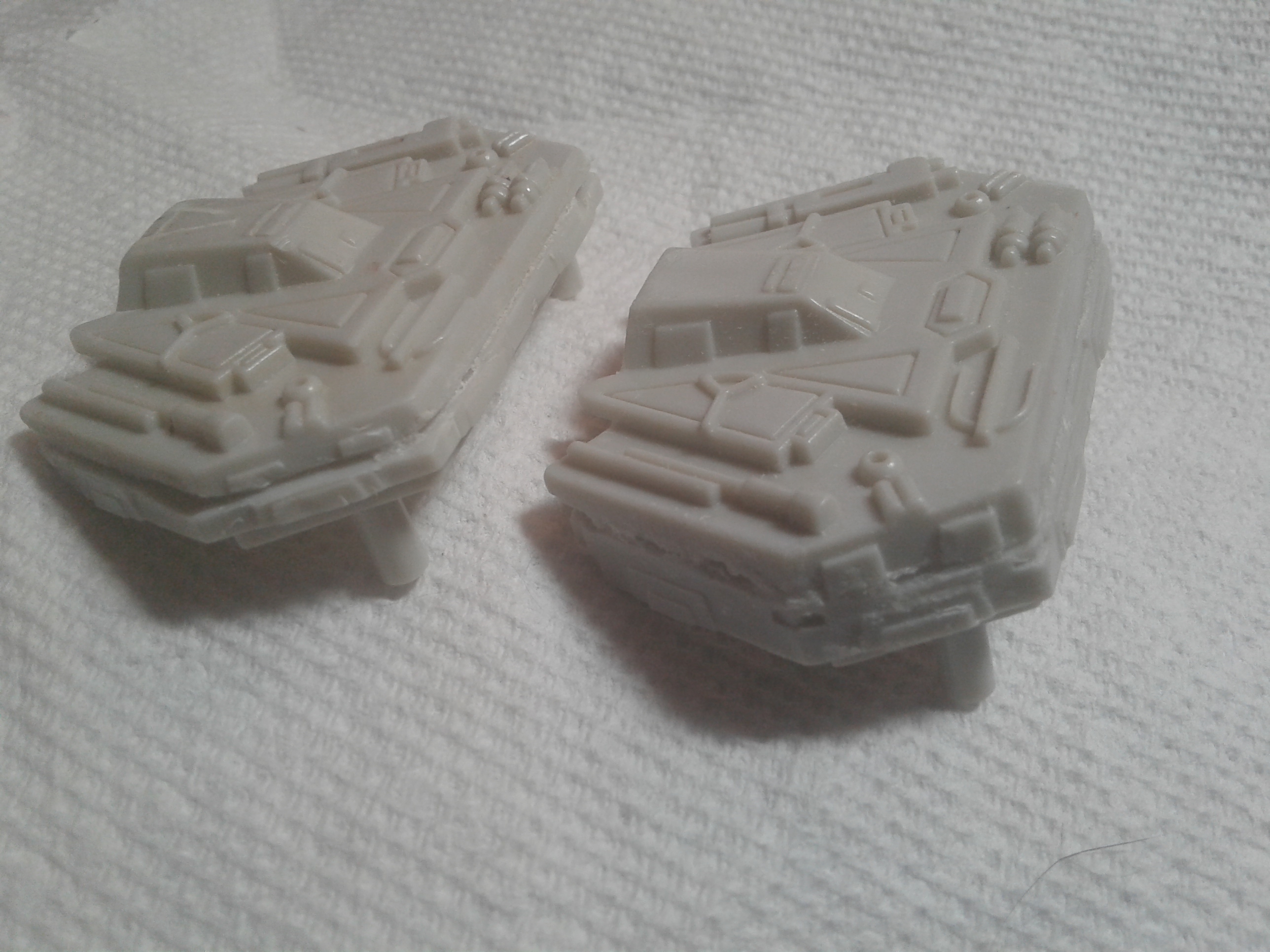

I cut up the second canon box, a wee more to scale. Actually just a wee taller than it should be. I figure the one above can be used fore the bottom canon box, since it is 2x taller than scale. The bottom boxes are all 2x taller than they should be, so the canon boxes were way overly tall like door way to the cockpit was too deep. Han and Leia action figures could have made out in the deep door opening, if there was a curtain covering it. Practically a smuggler's bay if a fake door was added. Ha!
I will have to create a custom canon holder / pivot arm, but it shouldn't be a problem.

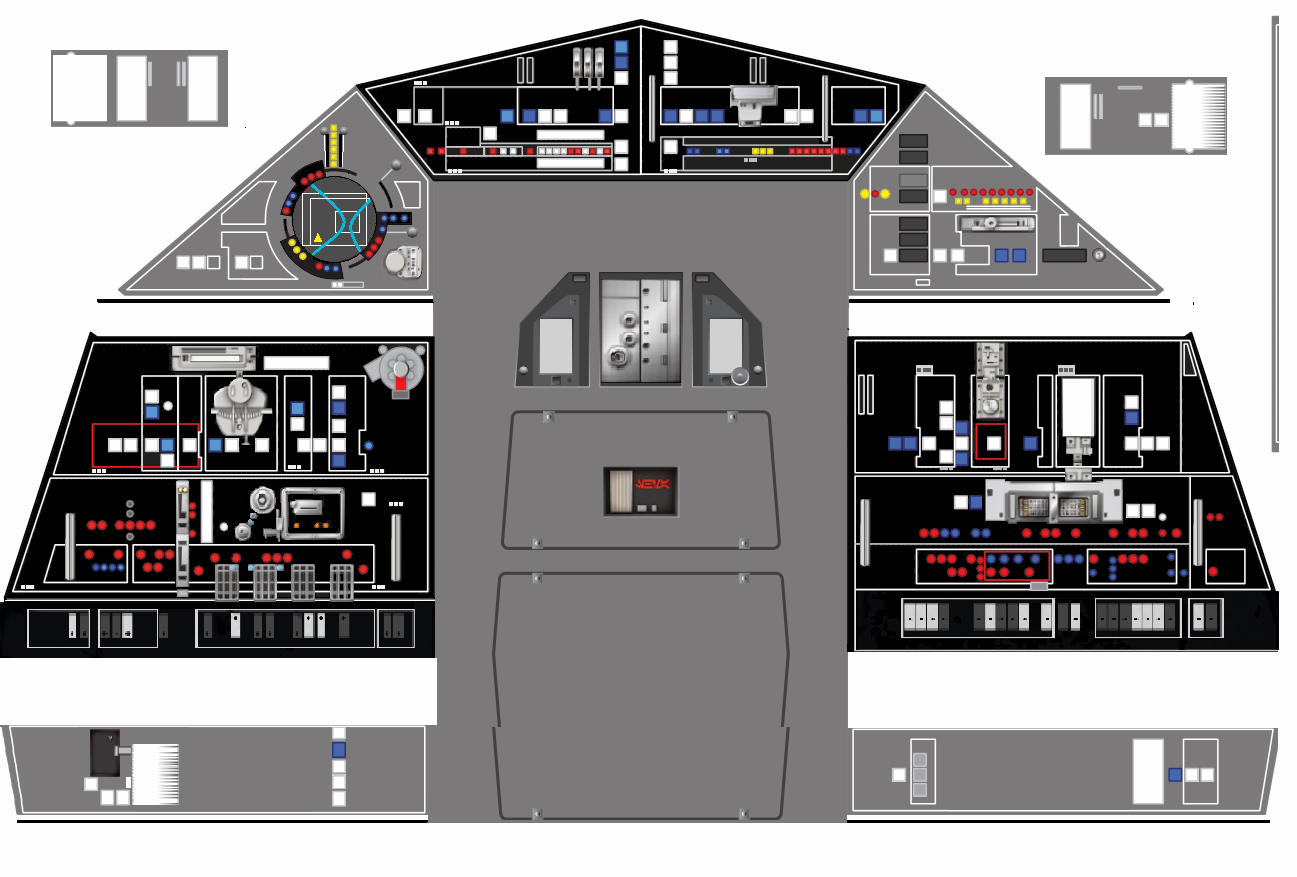

If following along... my bulkhead decal posted a few replys back will update with changes, time to time. It's sort of a backup, in case I secure erase again. Ha! About 90% done with the decal, as of now. Once completed, I will make a template to cover the bulkhead and to mount the decal on. An cut aluminium can should do fine, as it is thin and can be pin holed by hand on a block of wood. Then paint white to fill in the transparent lines of the decal.
Here are the two canon boxes. Mostly ready for the home made MEK and plastic powder filling putty to be smoothed in and set. Won't do it until all plastics are ready for application. Rather make a batch and do all at once.
The shorter box shows the sloped walls much better than the overly tall structure. Because Hasbro did slope the walls, the fitment had to be carefully placed as stepped sections. To keep the alignment, I did 45° angled cuts so that the top and bottom try to self center. Some areas were cut higher but wi allow the plastic fill putty to join with more surface area as I build up the sloped walls, from being stair stepped.
Updated more on the decal, and will need to edit the colours and fix an error when adjusting a greeble. You probably would not notice it, if I told you there was an error. The decal will fit nicely being that I had to make changes to the panel sizing while trying to keep to the scale. If you were to mentally remove the ANH switches, you probably would think everything was proper. Though i did not keep all the lights... the wee ones a bit too small to make a difference. Though I kept some, to see if they will light up enough to be noticable.
Even if there was no lightling planned, the printed decal is light years better than the lack of detail given by the original bulk head. Hasbro could have at least made an attempt with a decal rather than raised greebles with very little detail for any accuracy.
I am just about finished with my cockpit decal. There is a few things, that I am religning a wee bit, for symmetry. The very small greebles have been removed to eliminate clutter. They are basically very small square representations of words, for labeling around some of the panels.
Got notice I should be getting my Shapeways 308 Bits parts in before Xmas. Yay! Still awaiting on mold putty to create fake Hasbro parts from the 3D printed shapes. Hopefully I can mold the cannons with all the electronic bits encased. Two 2mm leds in the body wired up to a simple RC timed transistor switch, to automatically flash, independently between top and bottom barels. Segments of fiber optic will run through the barels. Wiring magnet wire from a mini radio transormer, through the arms ( negative on the left, positive on the right) should allow pivoting through a cup and pin method, without stressing the fine magnet wire. Thats my plan, it can be done with other cannons on the 2.5" kits. So we will see.
Finished up with my bulkhead decal. Its not perfect but has a lot of details of which may throw you off, if your comparing with known layouts. Some details were too gratuitous in fine detials, and not were needed, once printed to scale. Basically the base layout that worked best for the Hasbro was not as perfect as I had hoped. Many key reference points were off by changes for visual fitment with scale, being smaller while keeping visual queues. This should look different in comparison to my previous layout shown in progress updates. So, if you have a Hasbro Legacy Falcon, this decal can be the base to further enhance on your own skills, either by further manipulation or by adding lighting, as I will be doing... or just as it is, for a proper decal to enhance.
You may not like my final revision, but it was like the book, Give A Mouse A Cookie. Once I corrected one thing, another is easily shown. In fact, I did not realize one component greeble was over sized, being elongated, until finished. Basically all the black panels were ppurposefully done wrong. They were too accurate to be coincidence. What triggered the final corrections, was watching ESB, where Solo did the Fonz move, to the Falcons panel to activate th system. I caught a glimps and froze, noticing the thick border around the lower black panel. It is hard to reproduce, other than a thick white top and bottom borders. So far I think I am the only one to introduce them into a bulkhead for the Falcon. Either you will like it or not. It takes a bit of time to get use to them. But there you go.

I finished up the bulkhead decal to my liking, and updated the image above to my print ready decal. Found many errors were created after adjusting various panel layouts. Had to resize or reconstruct borders around lights and buttons.
Some may notice I added green lights, and moved the rack panel handles to a more strategic location. Nobody would obstuct status lights or make holding the rack unbalanced, by the handles being to close to the center. Added more greebles from a few ESB scenes. Which started my endeavour to correct further.
Everything matches up nicely, both blown up for detail work or in applying to the cockpit. The decal should fit 6 per page, and plan on using a few as sacrifical templates in creating light passages and testing alignment, before completion.

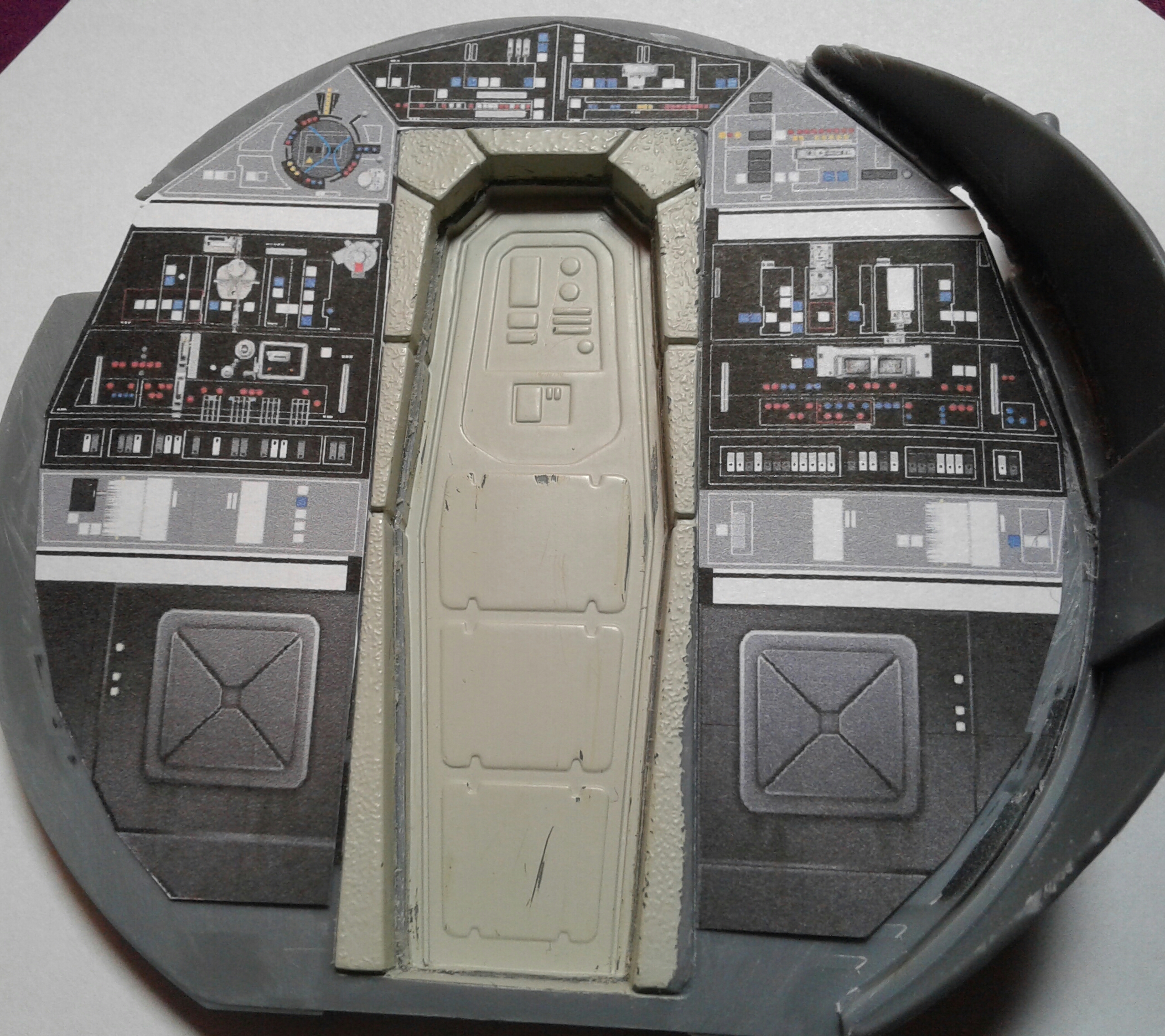

I printed out a sheet of 4 images. I did not format the decals to fit nicely within a close grouping, and also did not set borderless print. The paper I used was Avery transparent matte self adhesive 8-1/2 x 11 sheet, with matte photo high quality setting on my printer. I could have adjusted print with override to saturate colours and black levels. But wanted to see how it came out overall.
I like the colours, but until I mount it in the cockpit, I won't know if I need to overlap another decal to darken it up enough to keep light from bleeding, and show deeper details.
