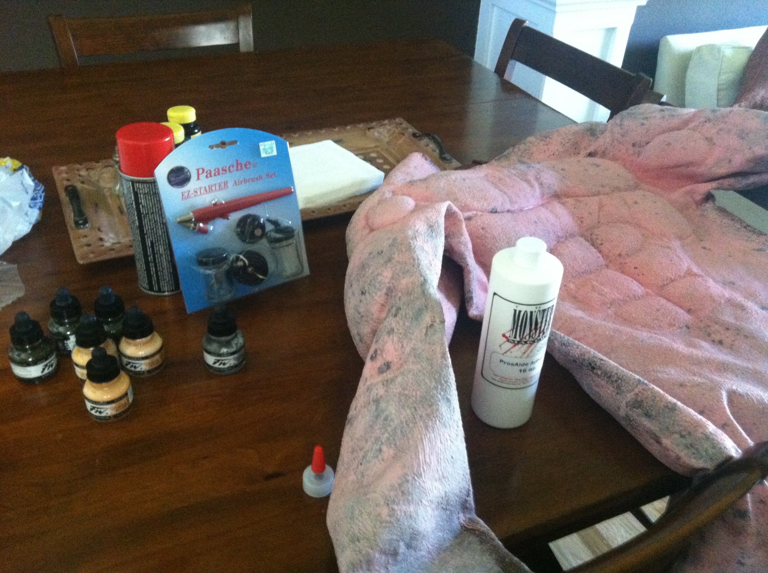

I am just about to go buy a lot of inks and an airbrush! going to start it today! I have prosaide, inks, airbrush, and sponges. Thats all i need right? sponge to apply prosaide, air brush and the inks?

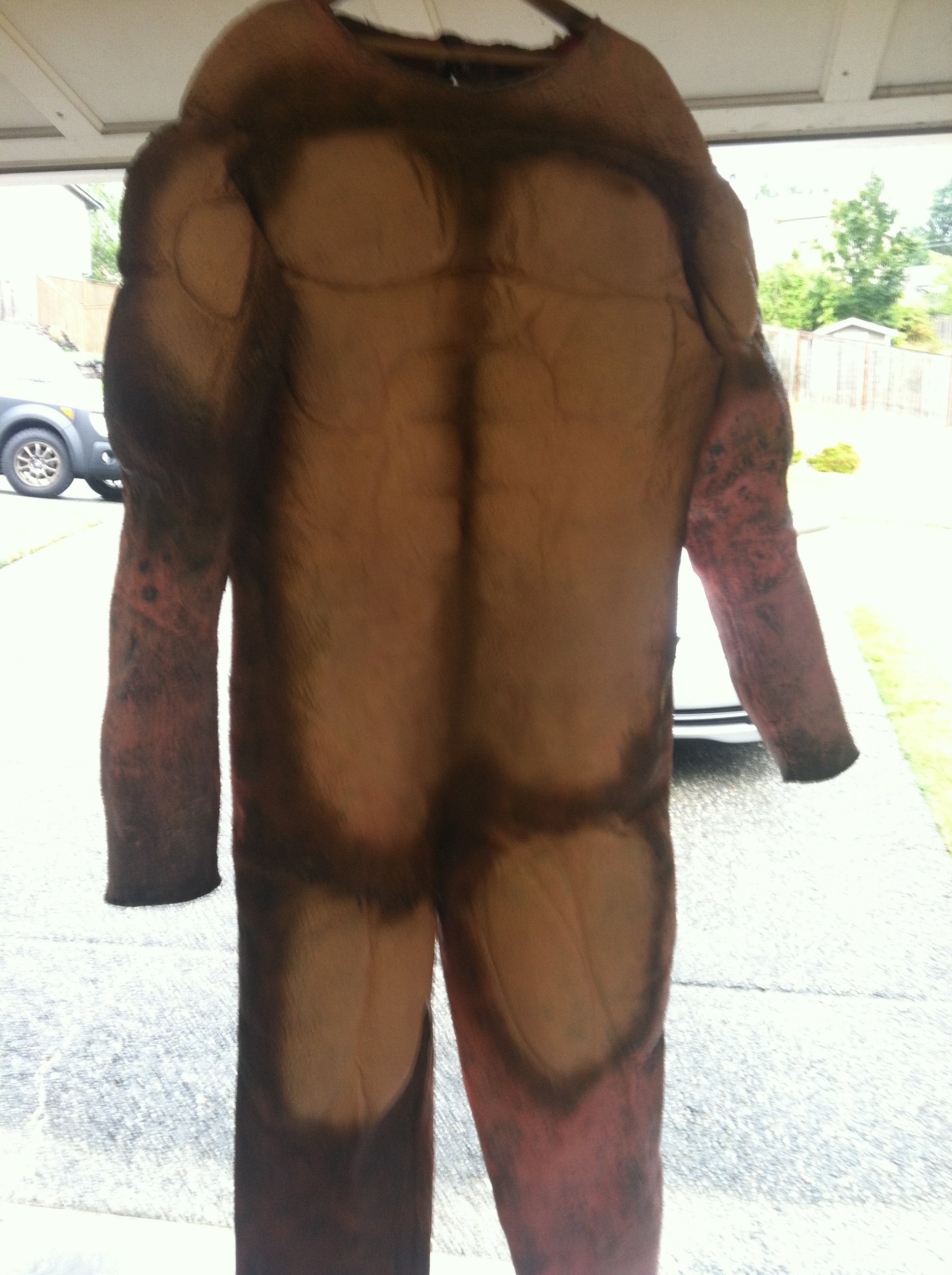

I started to apply ink. I used flesh tint, next will be antelope brown then black. My airbrush can't continue right now because I don't have anything for air lol, but I'm liking how it's turning out!

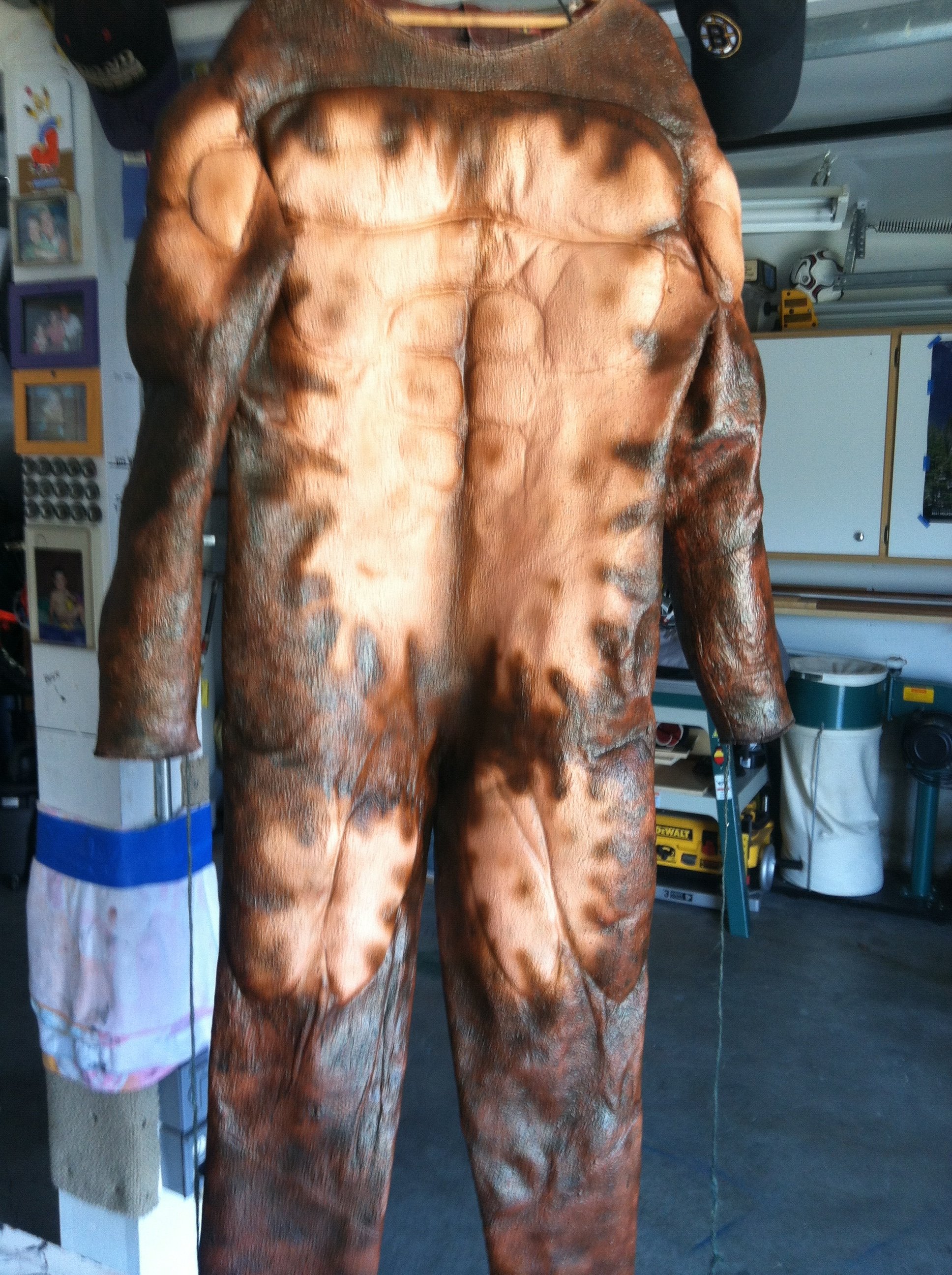

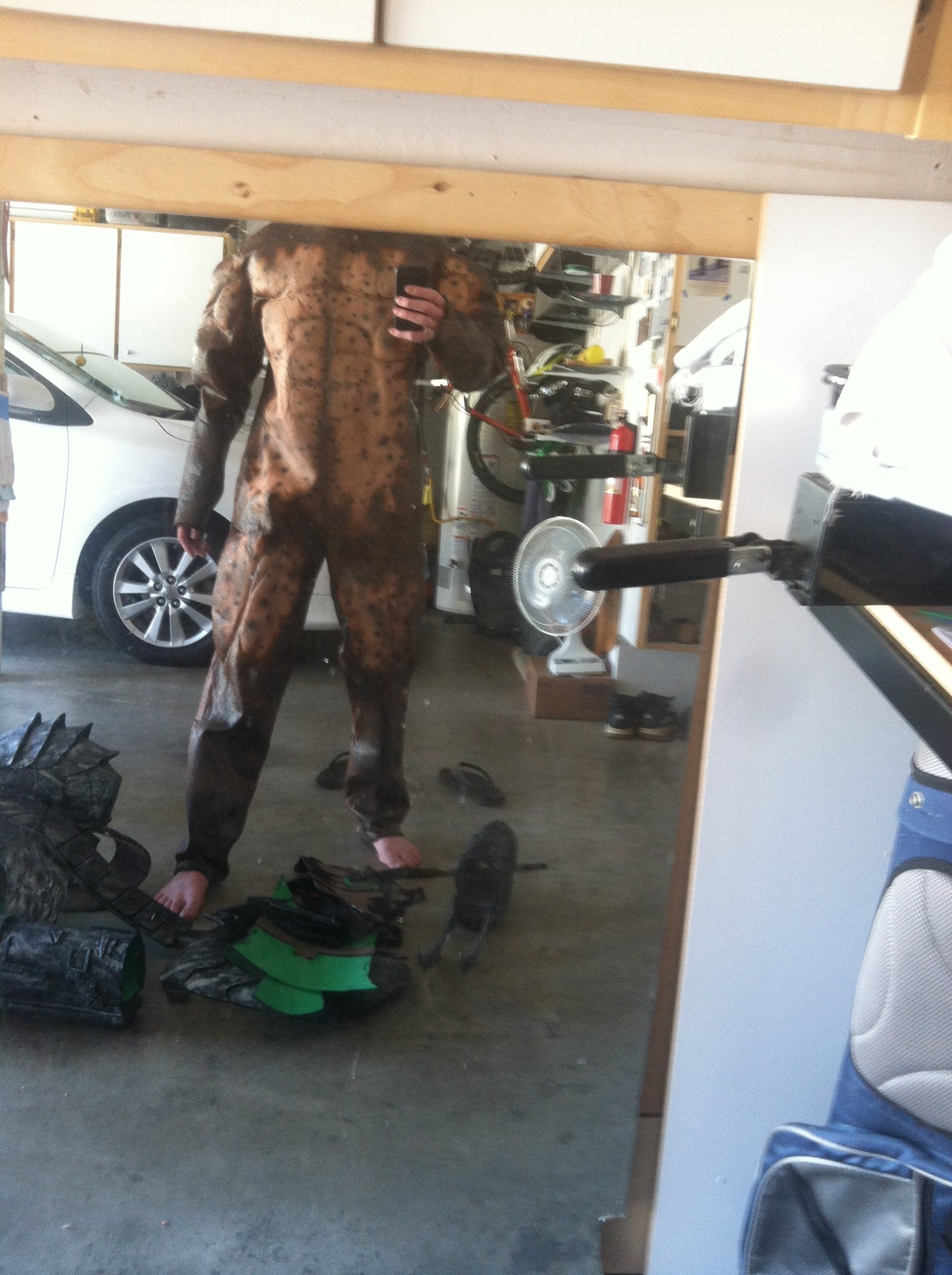

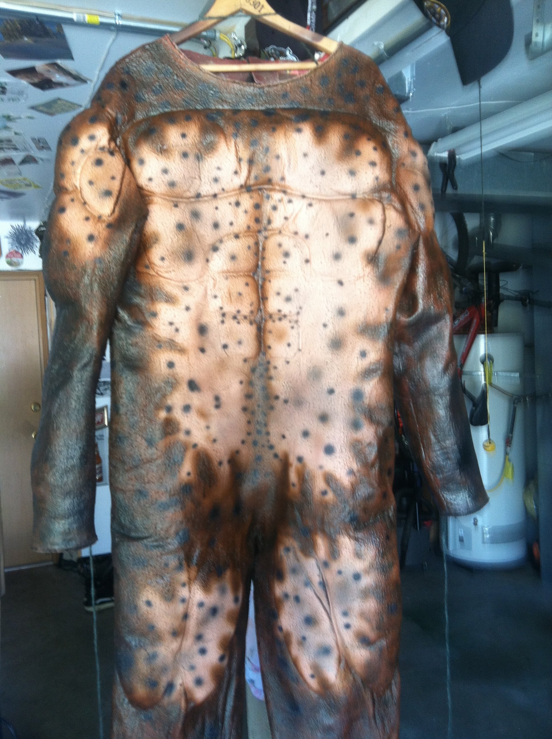

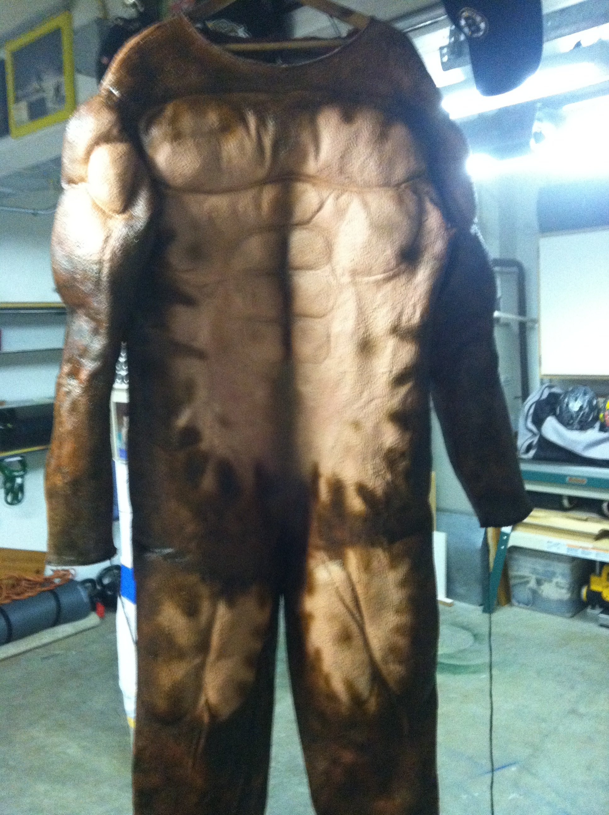

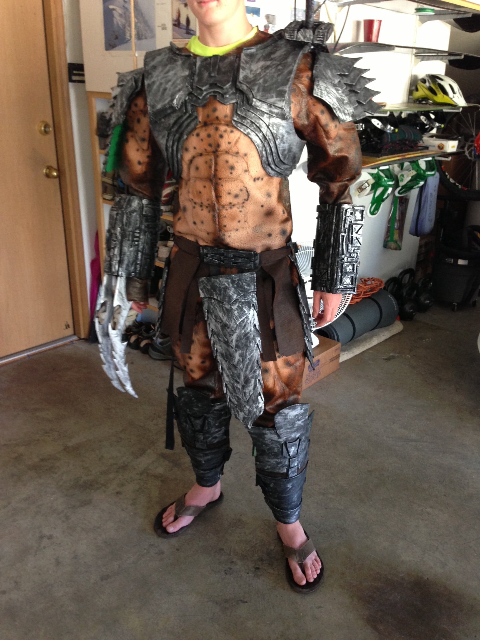

my suit is now done! Thank you everyone who helped me!:) I am very happy with how it looks and all I need to finish is my mask!:) here are some pictures of my suit
