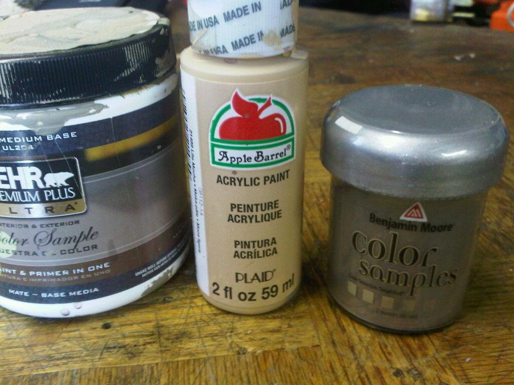

I have a hobby lobby nearby, but FW inks come in small amounts so id
have to buy a ton, my friend sent me this, he uses these paints to airbrush things, any of these ok?
Stay away from latex paint. There are things in it that react poorly with RD-407 that will cause it to detiorate quickly (what I have been told). The cheap acrylic in the middle dries hard and will crack the minute you try to bend or flex the latex. I don't know anything about the other one, so can't say. Remember this. Latex was never really meant to be painted, hence the reason for special processes and paints. Ultimately the choice is yours, but if I were you I'd stick with what has already been proven many times.
Brian
I'm sorry but I don't think I understand, this is all a huge headache, I've done tons of searching and googling and can't find anything that really gives an answer. I have no idea on what paint to buy, I have the prosaide, isn't that used to help the paint be flexible? I'm really confused and have no idea what to do, I know this stuff takes time and patience but I've been working on this entire costume for about 8 months and just want to try and finish it
