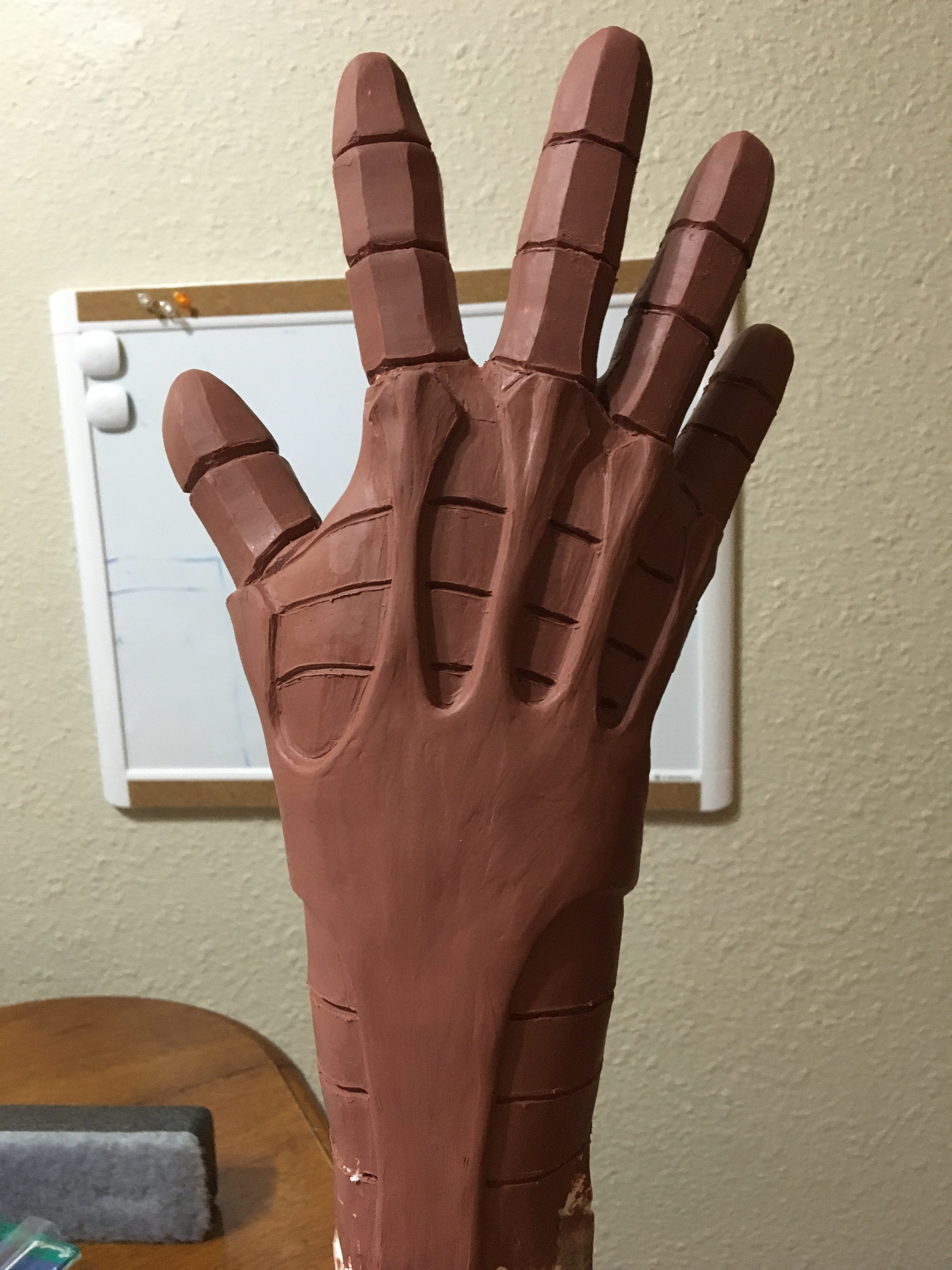

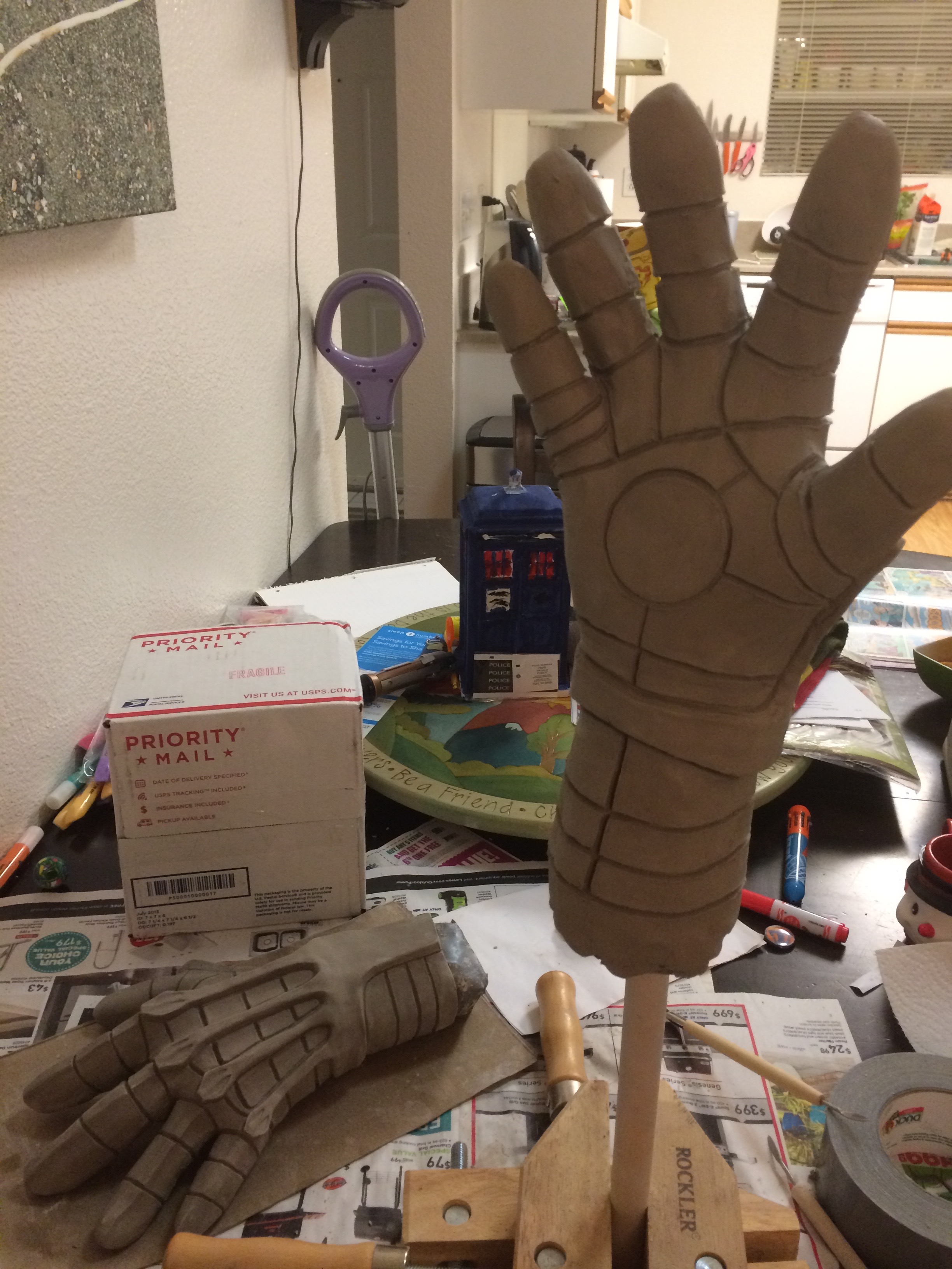

I'm going to attempt to make new latex cyberman gloves. My last attempt didn't go well with the plaster.
I understand that plaster molds are the way to go. But they also quickly fail, like you may only get a few pulls from them (and I'll likely have friends that want them if it comes out half-way decent). And in making the mold, you typically destroy the clay sculpt getting it out of the plaster.
Can you use something more permanent like resin or plastic as your negative instead of plaster? Or is there some other method that is preferable?

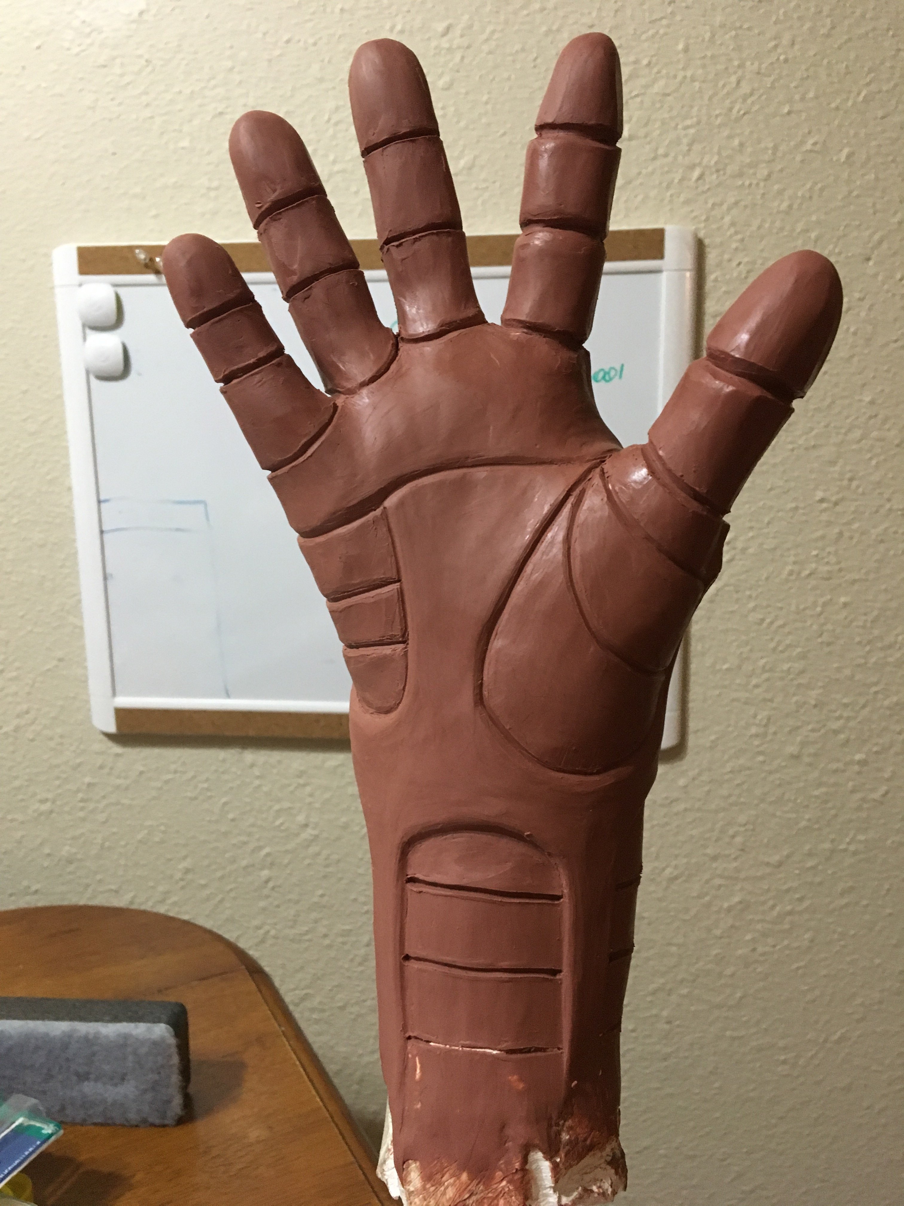

I laid the glove sculpt horizontally like the one laying on the table and had it supported in the box I made with foam board. I then did two pours per half, very quickly following each other. Letting the one half set for about 30-40 minutes, spraying between them with mold release (though I've also tried using Vaseline). The gloves are finicky, image below.
Edit, I should also say that on the next glove, I intend to not go as deep with the detail lines. They were about 1/8". I think I can get away with less and use paint to get a deeper effect. The palm of the glove was before I found a good reference photo, so I channeled Iron Man a bit ;)

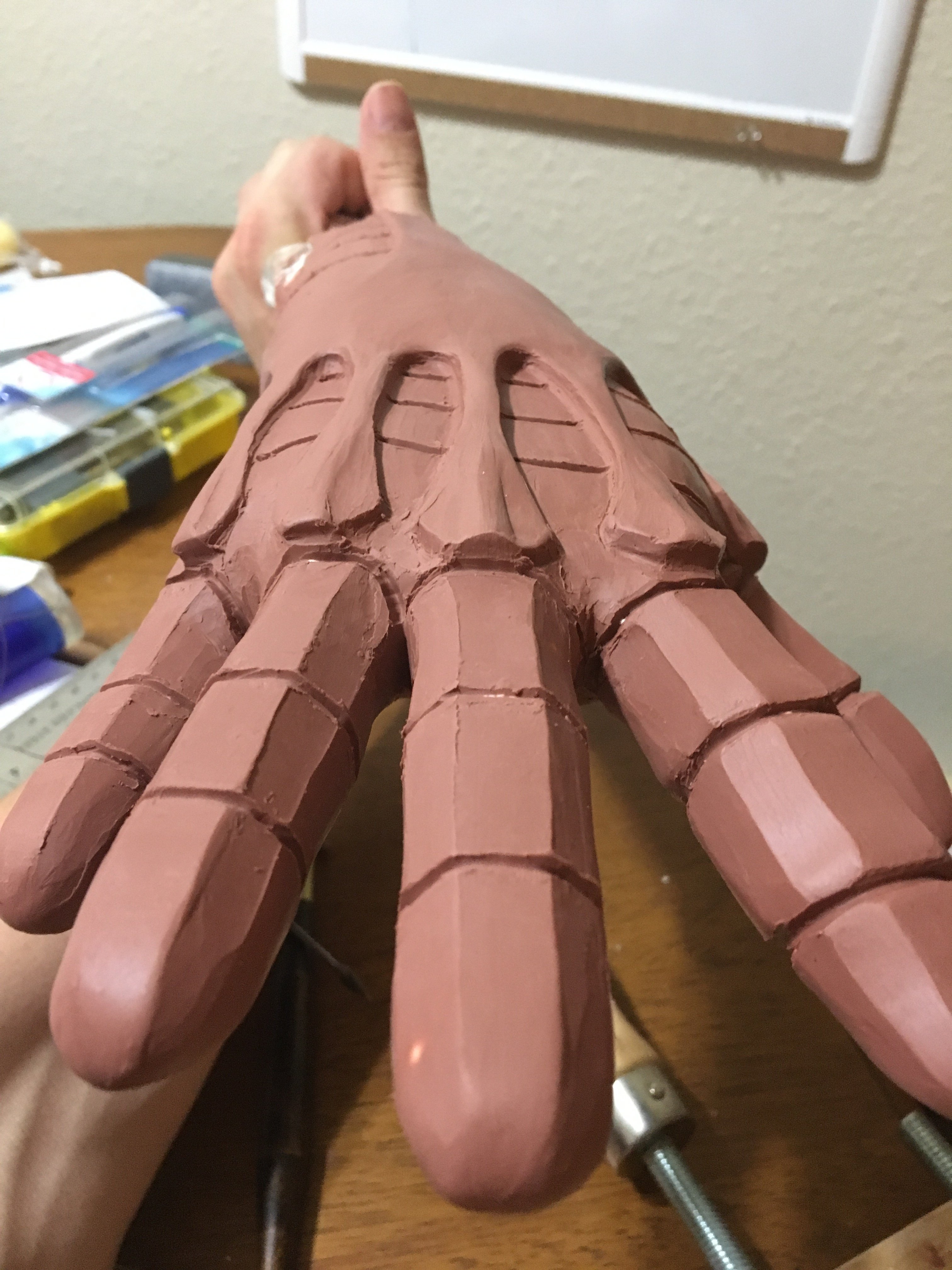

I've got one hand about 95% done. Just have to do some final cleaning and smoothing. I'll give the casting a go this weekend. And hopefully NOT make a mess of my apartment.
