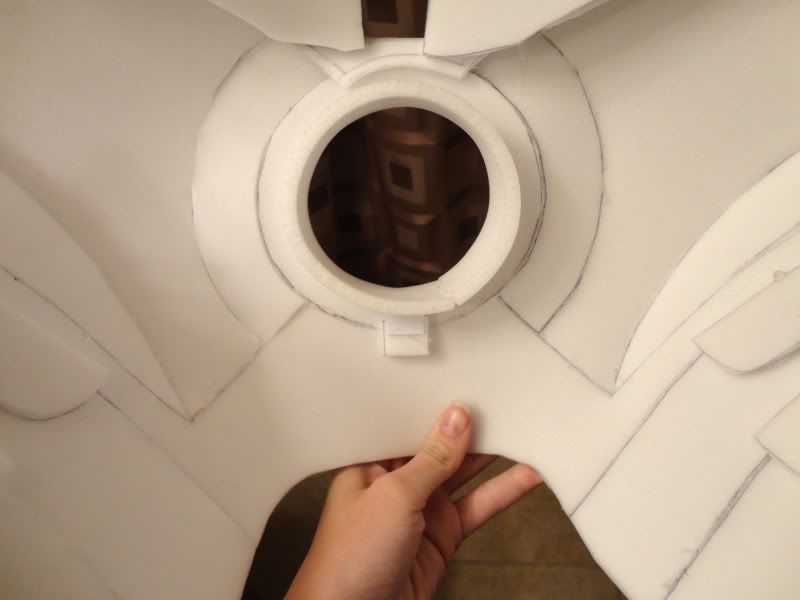

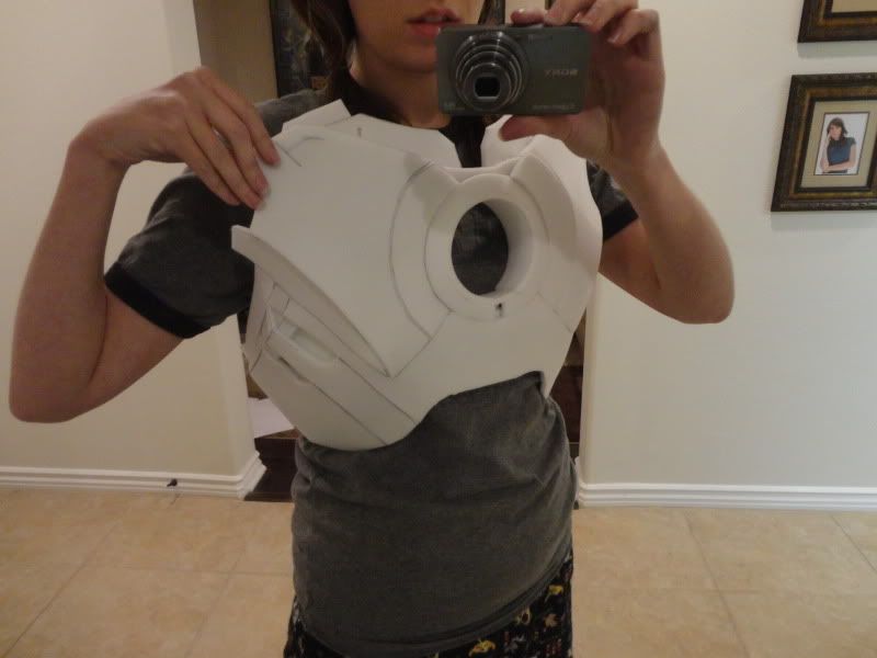

And now, some progress.
So my plastazote foam (6mm, medium density) FINALLY came in and I got straight to work using it all up this afternoon. I hunted down Stealth's Robo3687 foam mod and started cutting parts out like a madman. It only took an hour or so to end up with a little pile of foam pieces-- which seemed a little daunting to me.
Thankfully though all it took was some gluein' and bending to get it looking like something good.
finished, the chest looks like this.
it needs some fixing here and there but overall, I'm pretty happy with what a single afternoon's work got me!

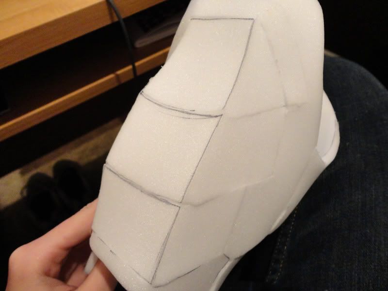

It looks very good, could I ask for a few detail photos of the inside? I'd like to see how the bends and folds mate up. I already do some work with the thick floor mat foam, but this looks like it might be a little easier to work with.
sure, I'll take some tomorrow! I have to warn you though, it isn't super pretty. I coat the seams inside with hot glue to keep the bonds strong.

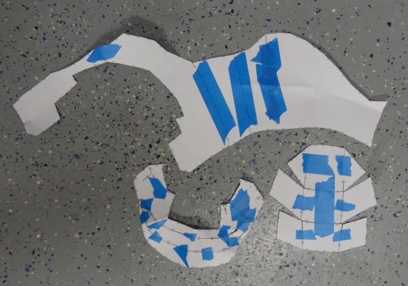

Awesome!!!! So where exactly did the templates come from? I don't recall ever seeing them anywhere.
here ya go!
honestly, it's hard to tell that it's not as clean as the outside. I tried to take some pics of angled pieces put together as well, but it just looks the same. I actually line my seams with more hot glue on the inside to keep them strong.
Click for amazing templates

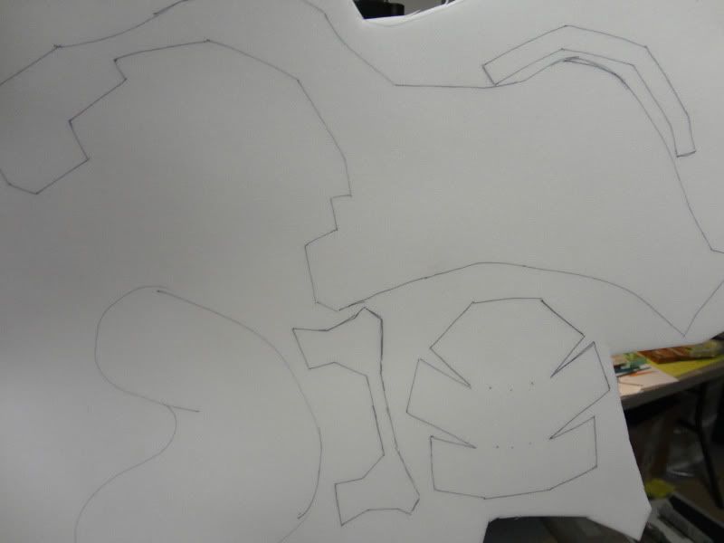

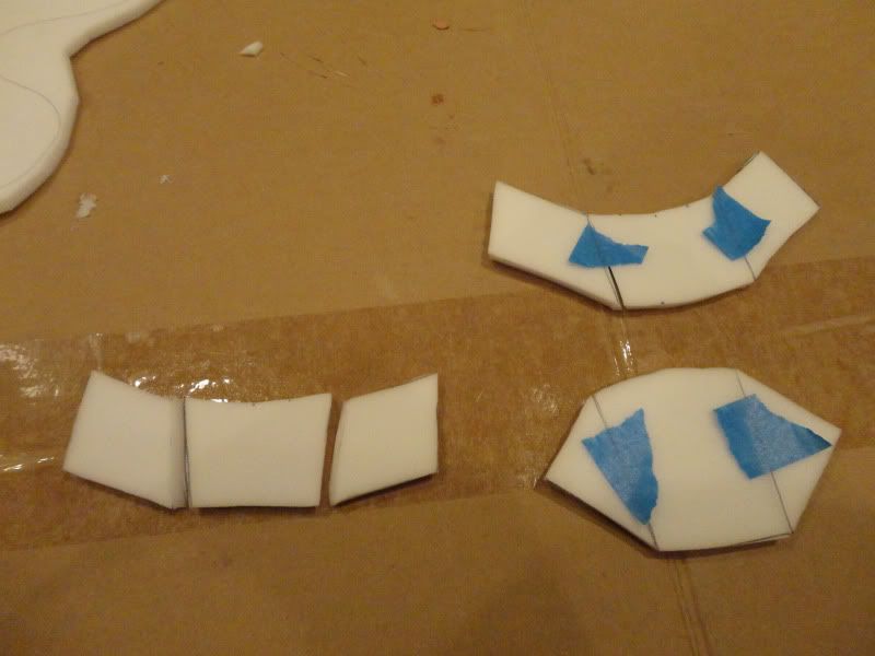

Picture time!
because my foam can form with heat so well, a lot of the template pieces can be combined to make a more accurate/smooth piece. Here's a pic of some work I did on a bicep.
drawn out on the foam. The big blob is for as piece that was too complex to trace on flat foam.
The solution is to cut out the piece, bend it with the aid of a heat gun, THEN trace it out, cut, etc. It's a lot easier.
as you can see, this is actually six pieces. My thought was to cut it out as one, then seperate the six individual pieces so that they would match up perfectly when put back together.
honestly, the results are only -ok-. I'm really not happy with how mess the bicep ended up, I think I'm going to redo it.
anyway, thats where I stand right now!
