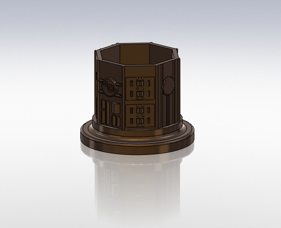

I don't know if you need the following pics of the Kylo Ren Force FX lightsaber battery holder or not but I thought I'd take them for you anyways. Side 1 of the battery holder is the same as the side of the lightsaber that has the belt clip/battle damage. If looking at the bottom of the battery holder, I rotated it counter-clockwise (or rotated it left if you prefer) for the pics of each of the seven remaining sides. I hope this helps.

[EDIT]: Also interesting note, looks like the cutaway from the celebration hilt looks like sides 6,7,8 of the ffx battery holder, with 7 in the center.

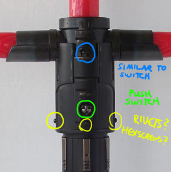

After looking at your V2 model, I'm curious if you'll be adding the details to the newer emitter that I've circled below? I've seen those details on all the licensed versions of the saber so far, and the rivets/hex screws are always there, and the on/off switch is always the same/same design.

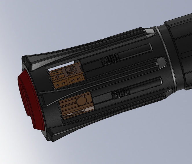

And well the little surprise is something that V1and V2 (no to mention V3) did not have, a way to install switches to activate etc.
Changes made to V4 are:
1. Added the threaded portion to eliminate the coupler. To achieve this I had to change the Led housing to a 1" one instead of the original TCCS piece. I also made inner channels for the wires.
2. Modified the cutout detail portion to match the inner core details from the hasbro fx saber batery holder.
3. Added the side screw to be printed, but can be changed to holes if you guys think that reals screws might look better.
4. Added holes for the red and blue outer wires so you dont have to drill them.
5. Last but not least I made a back door to add push buttons or a slide switch to activate. (ok that was the little surprize) There is a removable piece that gets secured by a screw and this way you can add the switches easily.
pics
Front view
Cross section, red arrow shows the pocket for an 8-32 nut to help secure the blade. Blue arrow is the hole used to screw the back door to the emmiter. Green arrows show the two holes to be used with small set screws to secure the LED housing.
Back view, green arrow shows the new pocket for the back door.
This shows the back door cover with the push buttons.
These views show the LED housing and the internal wire channels.
So i think it is ready for a print test... Thanks.

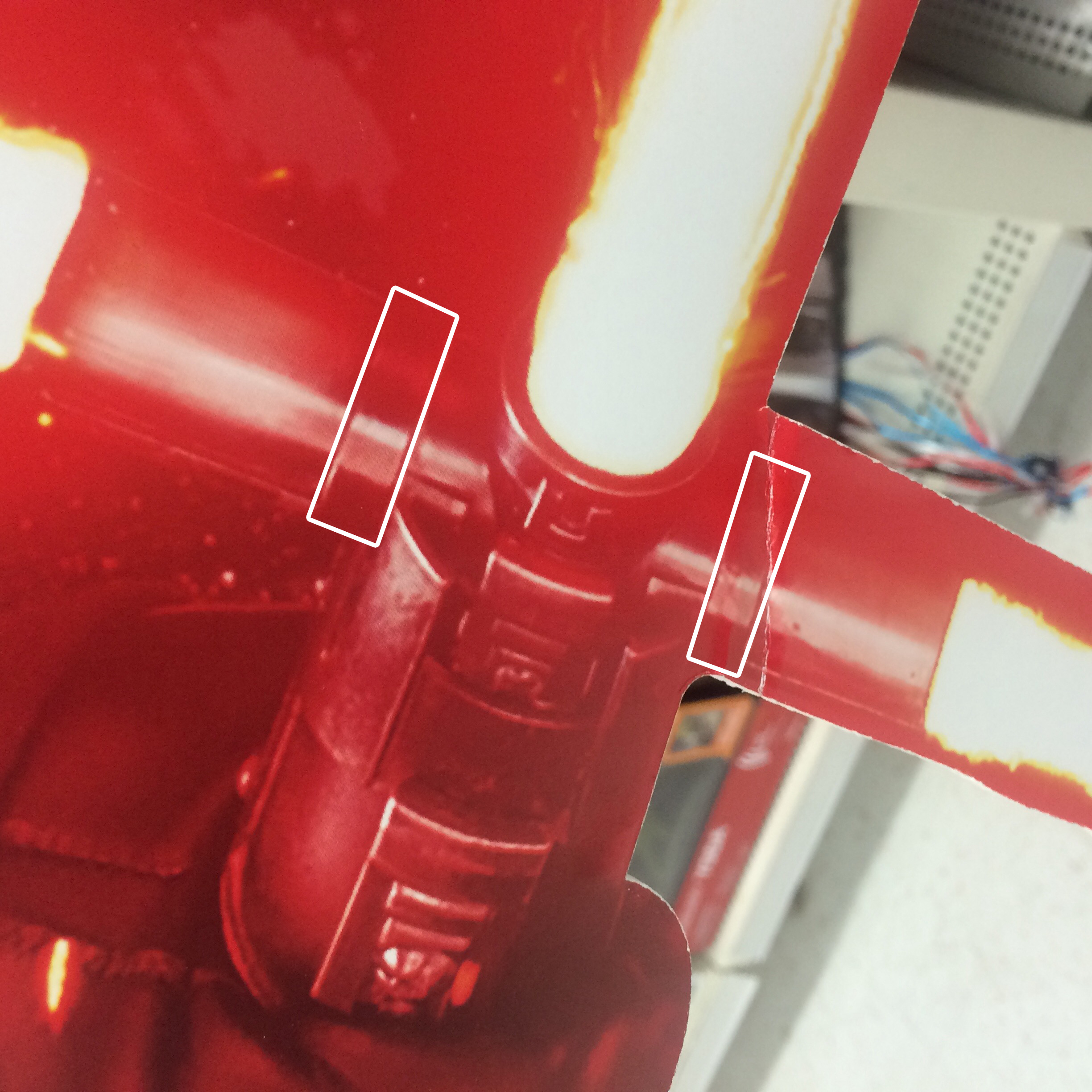

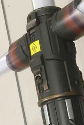

I noticed that the rings at the base of the side emitters on the hero prop appear to be straight up cylinders all the way around, they dont taper down on the bottom like the Celebration one, or your model. More like they are flush with the outside of the main body cylinder. I believe all toy versions we've seen are like this as well. They are also a bit further out from the main body and emitter. Just wanted to share. This shot is from a store display promotional shot.
Though i admit it is hard to tell from this photo, I might just be nuts.

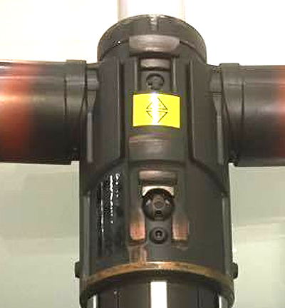

Here is the Force FX. Not sure what that main big nut/button thing is, but I dont see it fitting on your back door piece with the push buttons. The one on the top is a downscaled version of the larger one on the bottom. I'm sure someone can get better pics if you need them, a few people here have one.

Ill have to use design freedom otherwise that piece will not allow this design to work... however I can make the model of that nut and if you use a hex screw it can insert on top of the screw head? ;)
for now I just added those two horizontal bits.
