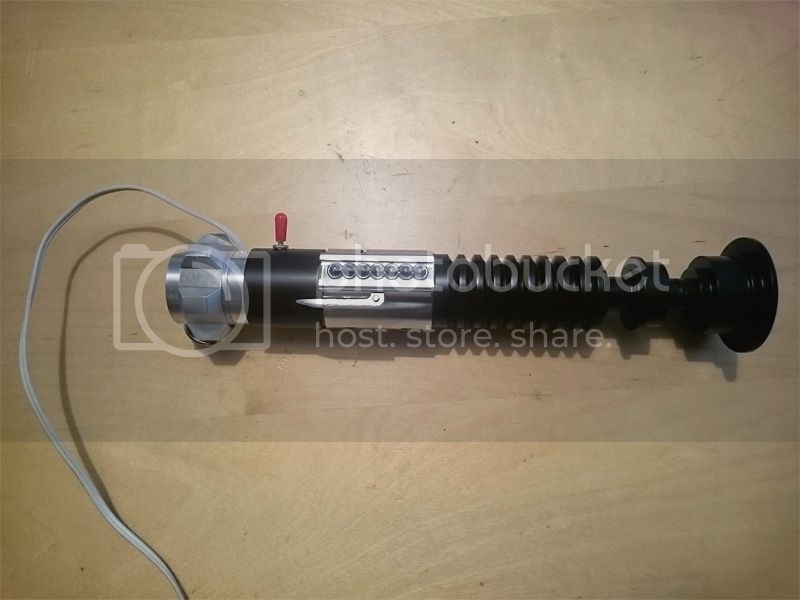

And I just had to get one of these to go with thd9791's resin post-RotJ Vader sabers.

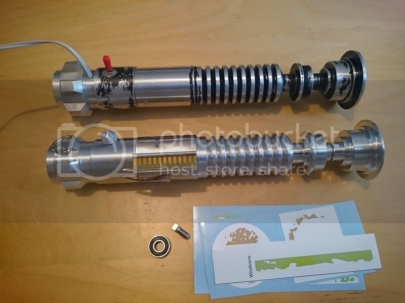

VERY nice ROtJ luke casting! is that from the rebuilt piece run being cast right now?

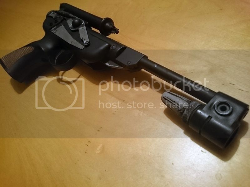

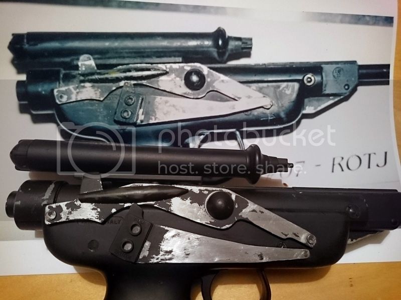

Also, do you have any closer photos of that rotj leta blaster? thanks!

I love the Leia blasters. Those were never my favorites until I got a deactivated one from OdiWan72. I'm going to have to do the ANH now. I've been keeping an eye out at gun shows to try and find one that I can shoot.

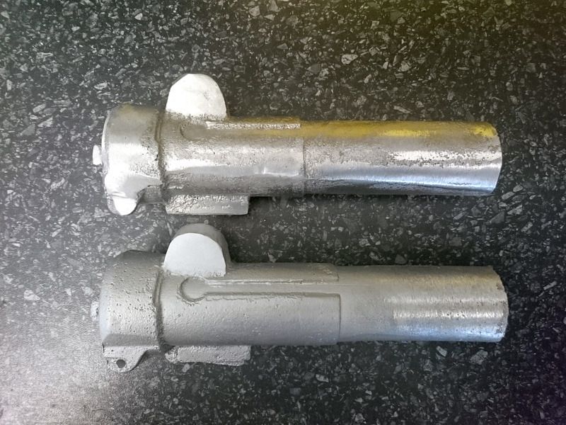

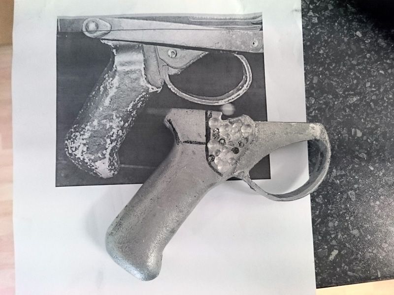

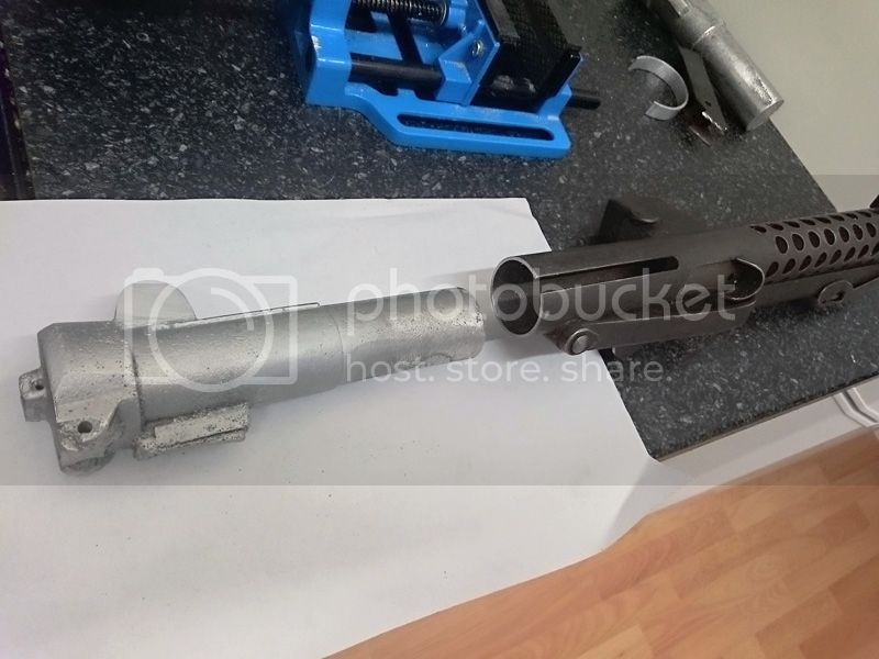

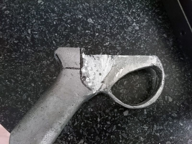

Working on an ANH E11 Bapty/Tunisia stunt blaster. Got another deactivated Sterling and cast aluminium grip and receiver section. I had these once many years ago but sold them because there was too much work involved and working solid metal with hand tools is not my thing!

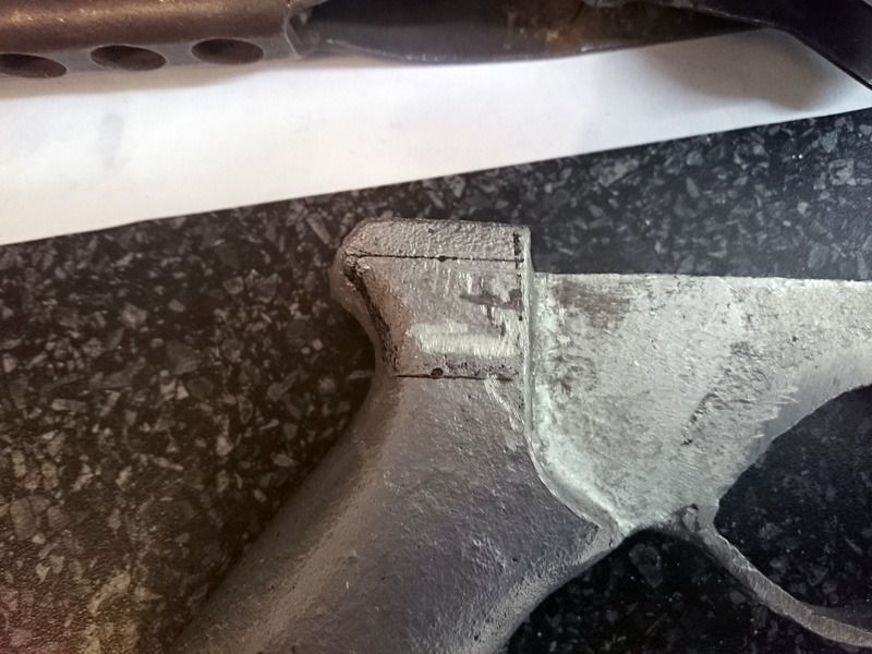

One side of the grip was completely wrong, but some advice from Sidewinder and eight hours later...

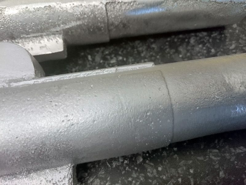

The receiver cast was about 15mm too short so I extended it with metal filler mixed with silver sand and silver paint and a coat of zinc aluminium primer. Should look okay once painted/weathered. Top is unmodified, bottom after mods.
You can make out the seam here where I extended it.
Re: Project updates 25 June - Bapty/Tunisia ANH E11 stunt blaster WIP
Very nice! Where did you get the cast parts from?
Same place as last time but the molds are wasted so these are a lot worse than the ones I had in 2009.

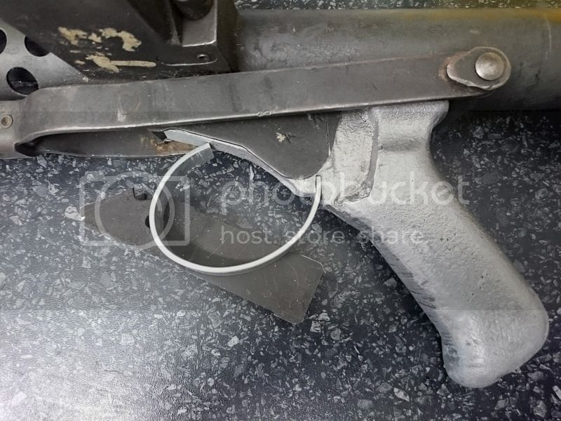

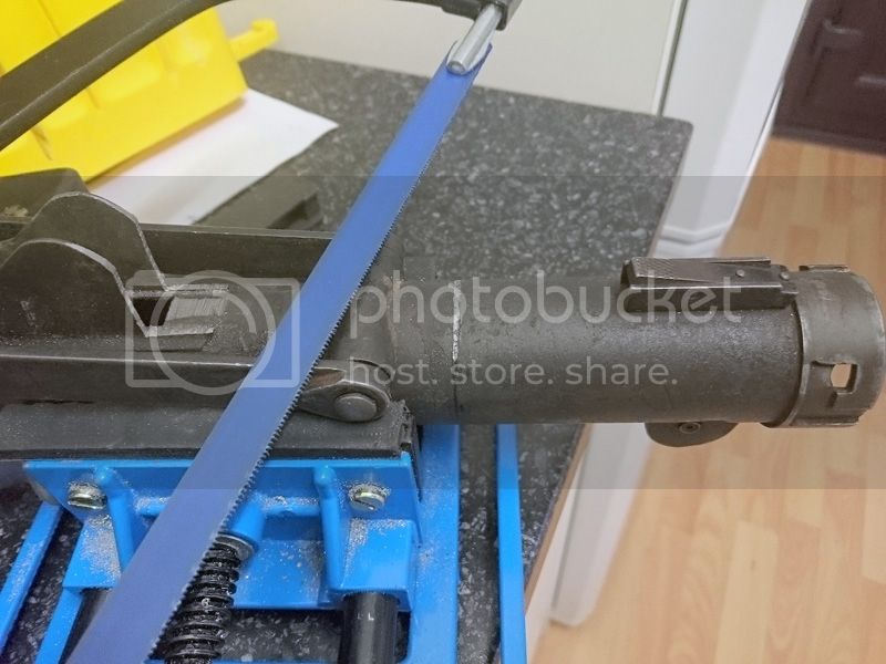

Project updates 26 June - Bapty/Tunisia ANH E11 stunt blaster WIP

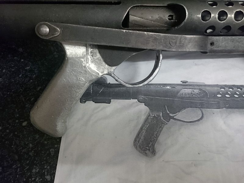

Aluminium cast trigger guard removed and slot cut (with incredible difficulty!) for new one.
The most nervewracking part.
And the cast piece doesn't even fit! Someone needs to have a word with the caster. :facepalm

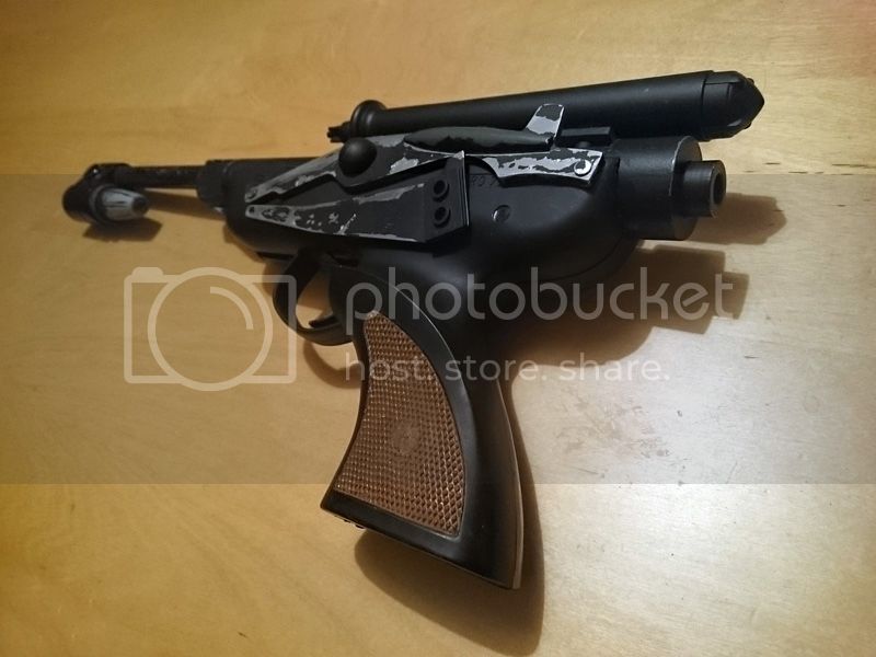

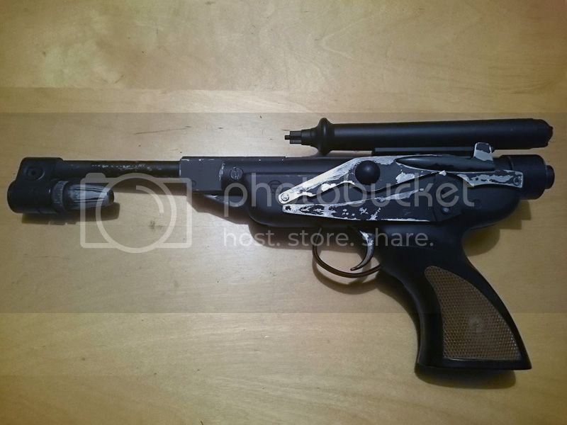

Project updates 2 July - Jabba's guard blaster and Lewis Gun update

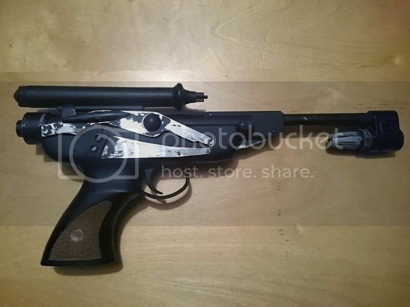

Had this one completed a while ago but never got round to weathering the right side due to lack of reference.
Layout is slightly different on this version but I already had the parts glued down so I left them.

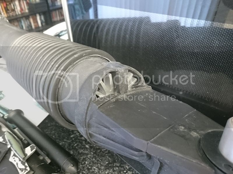

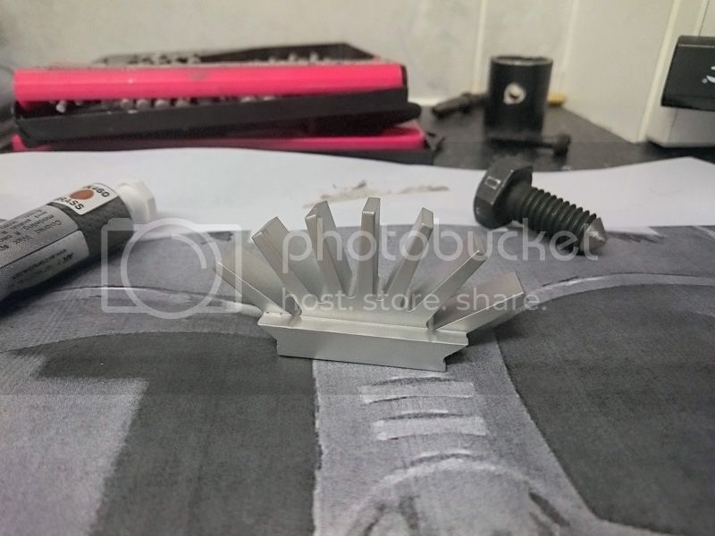

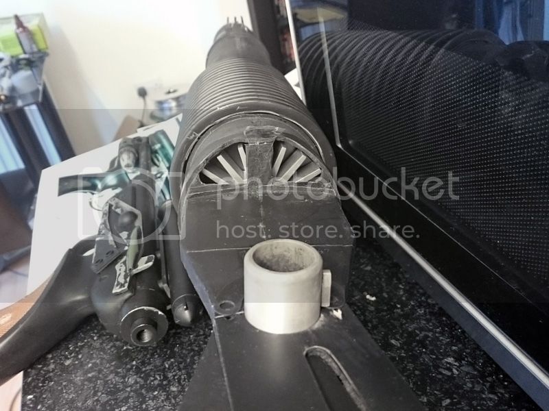

Lewis Gun update. Gouged out more of the back of the shroud for 3D printed simulated fins. Still a whole bunch of upgrades planned...
Re: Project updates 2 July - Jabba's guard blaster and Lewis Gun update
Did anyone ever figure out what the Jabba blaster scope was? I'm regretting selling mine now, yours looks great!
Only the back part was identified as a radio knob. The rest is scratch built/resin cast.
Wow - beautiful work! Regarding the Jabba blaster - what's your go to for weathering without scratching up the surface?
Sometimes I use masking fluid but it's tricky for very fine details.
e.g.
But for the Jabba blaster I just scratched the paint away with a small flat screwdriver for the fine details, and sandpaper to to the larger areas.

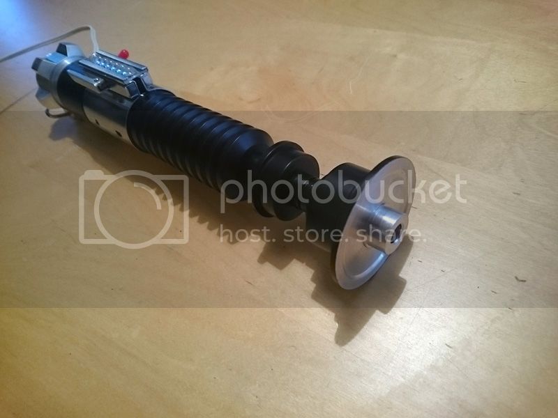

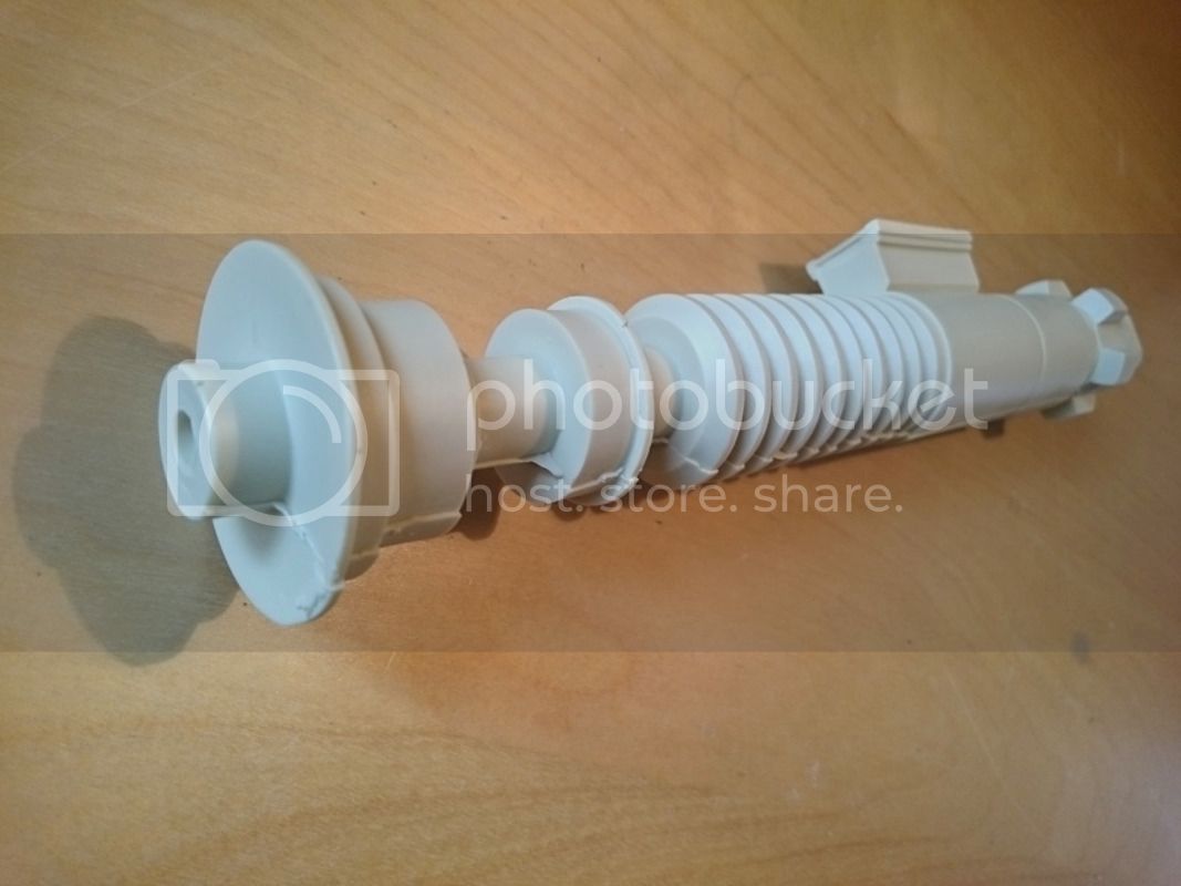

Project updates 2 July - Jabba's guard blaster/Lewis Gun, ANH/ESB stunt sabers, V2...

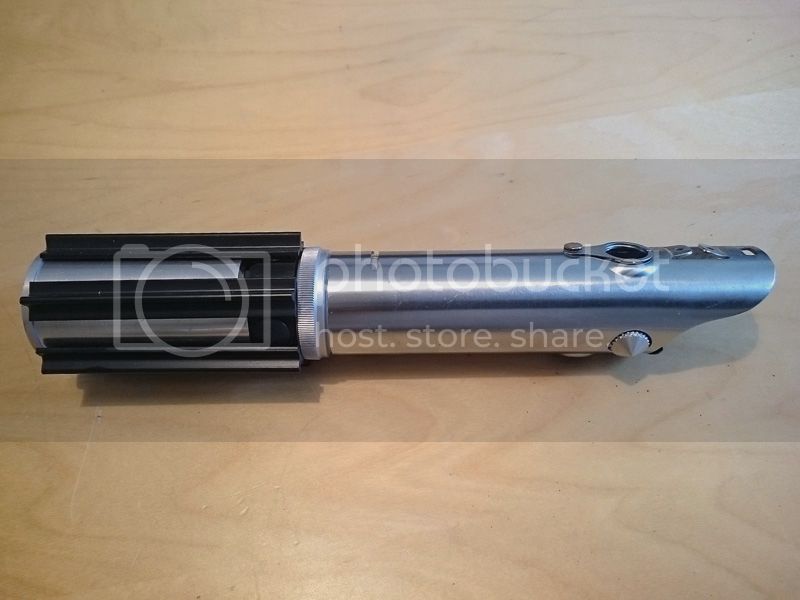

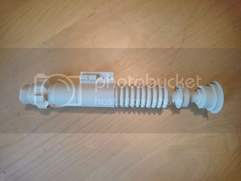

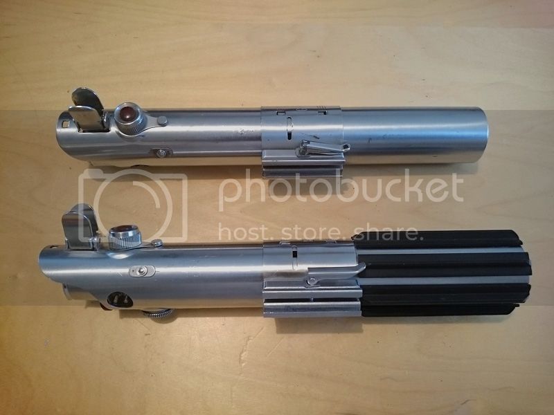

Back burner sabers got some attention today.
One of these will be TFA which leaves me a spare Graflex! :)
