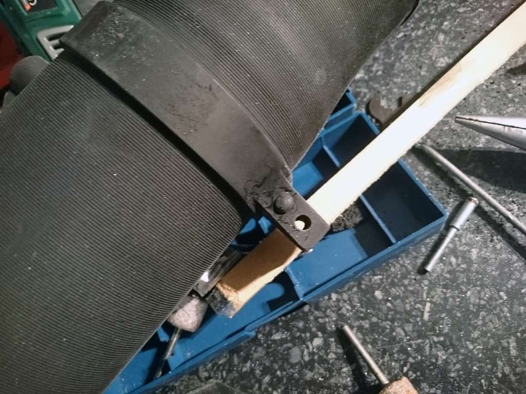

The rubber is hard enough to fill and reshape (it's just not possible to get it as clean looking as you would resin), but the foam inside the rubber outer layer is impossible to clean up. So far the only thing to do seems to be to cover it up but that's not always possible.

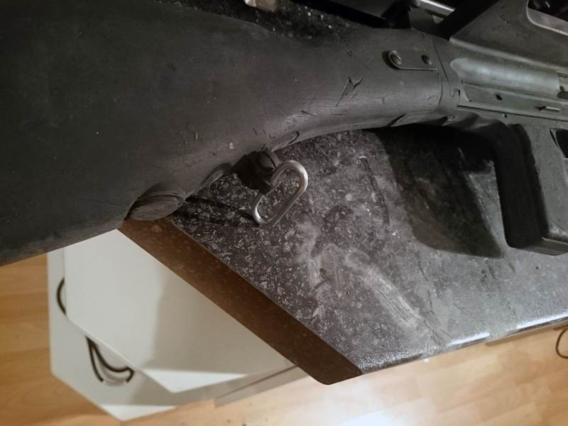

I'm replacing the destroyed rubber sling rings with metal ones.

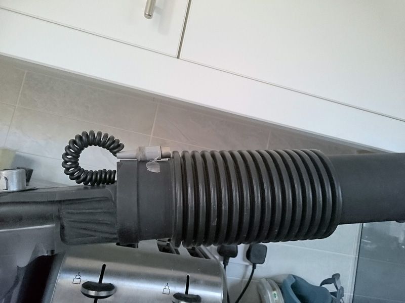

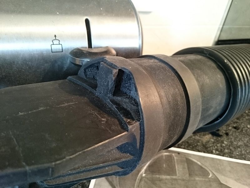

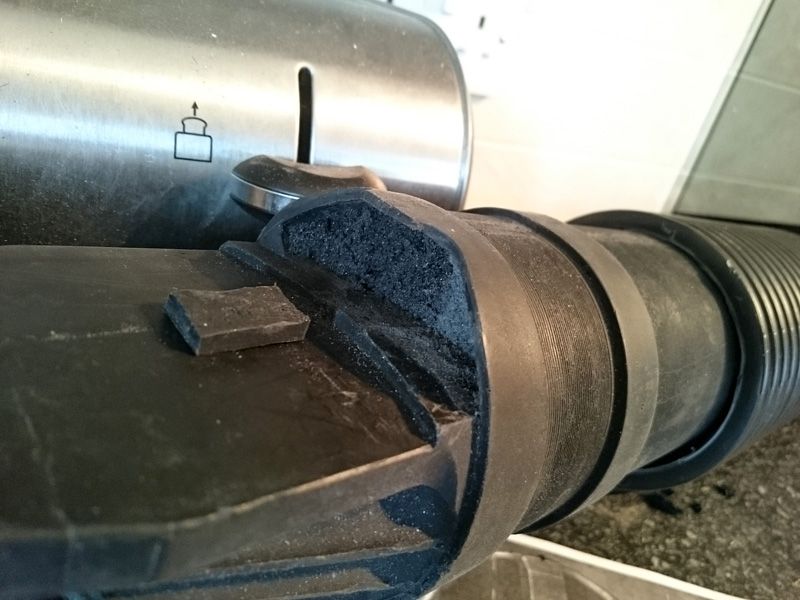

And probably a bad idea but trying to add the missing barrel radiator fins. I had to cut into the foam here and need to dig deeper, but my dremel flexible extension cable snapped.

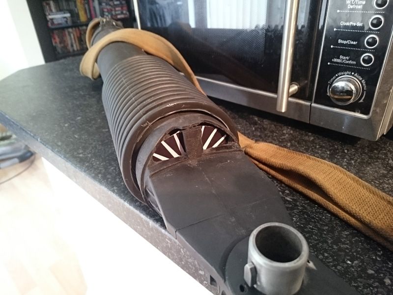

the radiator fins have been simulated with a decal.
If I can find a metal or plastic tube the correct diameter it might be possible to gouge out the thick tapered wall and insert that for strength.

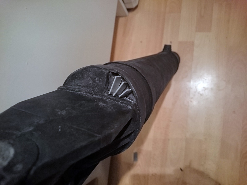

Thank you guys. I did some more work on the Lewis Gun. Really gouged out a lot from the back of the barrel shroud so that a 3D printed piece of the radiator fins can be inserted. As well as 20mm deep I also cut out a chunk 10mm down so the added radiator fins will be behind the ledge.

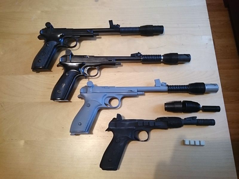

Leia blaster madness. From top to bottom: Resin Odiwan72 kit cast from real Margolin, real deactivated Margolin with vintage parts, lightweight Rubies conversion for my lifesize Leia display, resin cast from original RotJ. I may get another Odiwan72 kit and make a more idealized RotJ version.

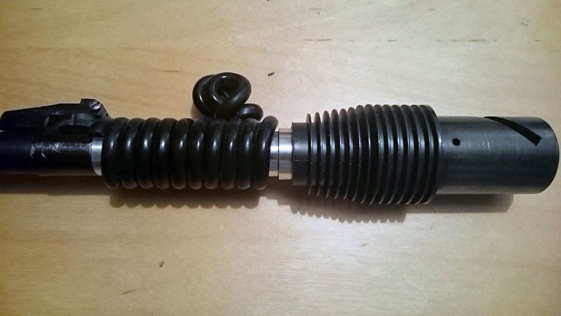

Coiled cable from vintage headphones, machined extension and compensator from Scottjua.
