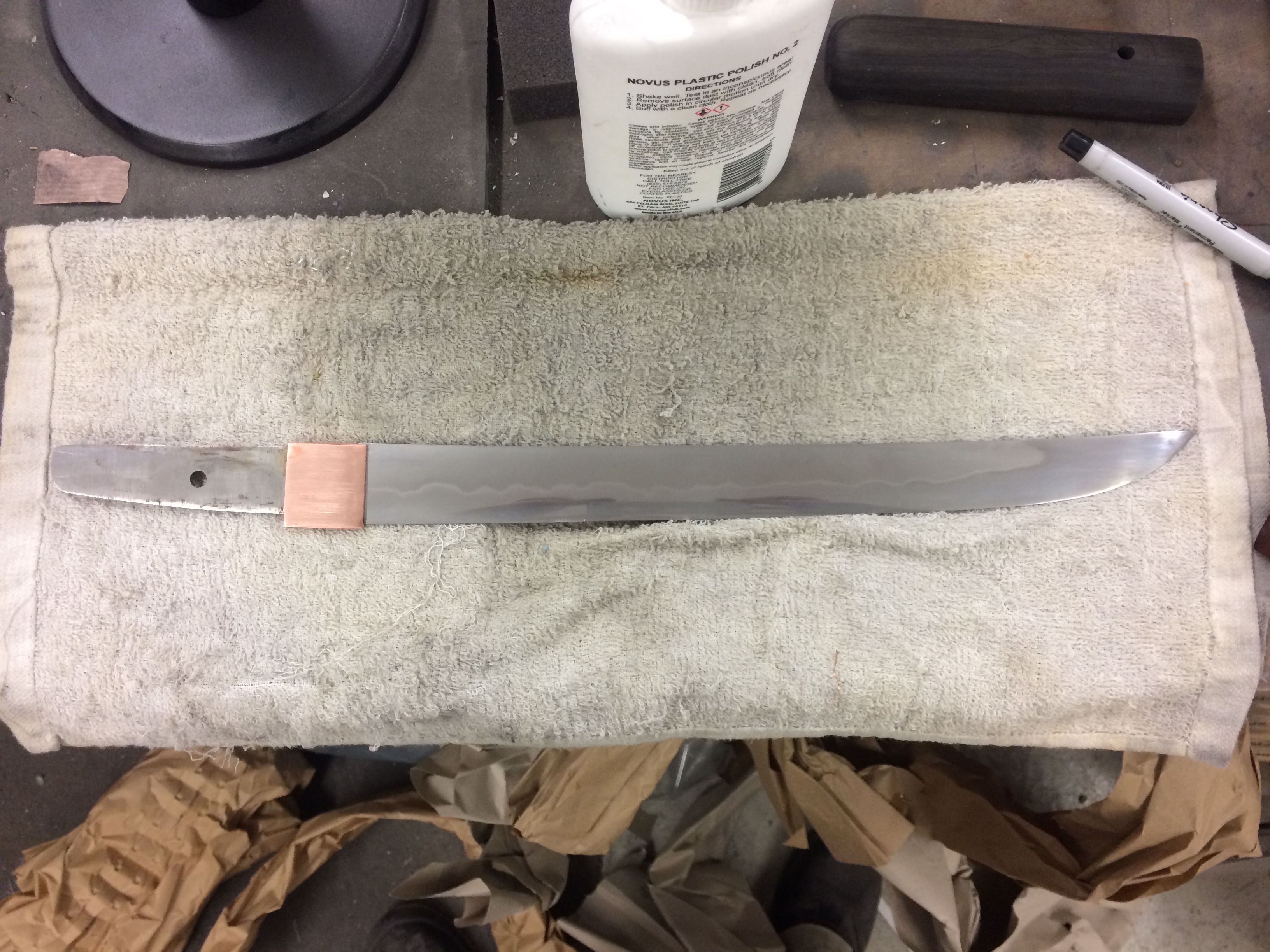

And therein lies the difficulty of faking one, especially a traditional Japanese one! The polishing is an incredible art. Here's a picture of one of my blades with a more modern style of polishing, and you can see that it's the back of the blade that looks a little hazier than the hardened edge. The appearance can still depend on light and angles, but much less so than a traditional polish.
The habaki also would usually be made specifically for that blade, and is the only one of the sword fittings that is made by the smith himself, and stays with the blade for its lifetime. They're not in fact that hard to make with even a cheap anvil. I make mine cold, no need to forge them.

And therein lies the difficulty of faking one, especially a traditional Japanese one! The polishing is an incredible art. Here's a picture of one of my blades with a more modern style of polishing, and you can see that it's the back of the blade that looks a little hazier than the hardened edge. The appearance can still depend on light and angles, but much less so than a traditional polish. View attachment 1428023 The habaki also would usually be made specifically for that blade, and is the only one of the sword fittings that is made by the smith himself, and stays with the blade for its lifetime. They're not in fact that hard to make with even a cheap anvil. I make mine cold, no need to forge them.
Ive heard that there are the traditional and modern polishing techniques, but didn't know the differences. Did you make the SHOTO? So you are saying the hardened edge should polish better than the slightly softer back? That would make sense if so.
Yes, I made the blade. I'd actually never come across the term shoto, I would call it a tanto.

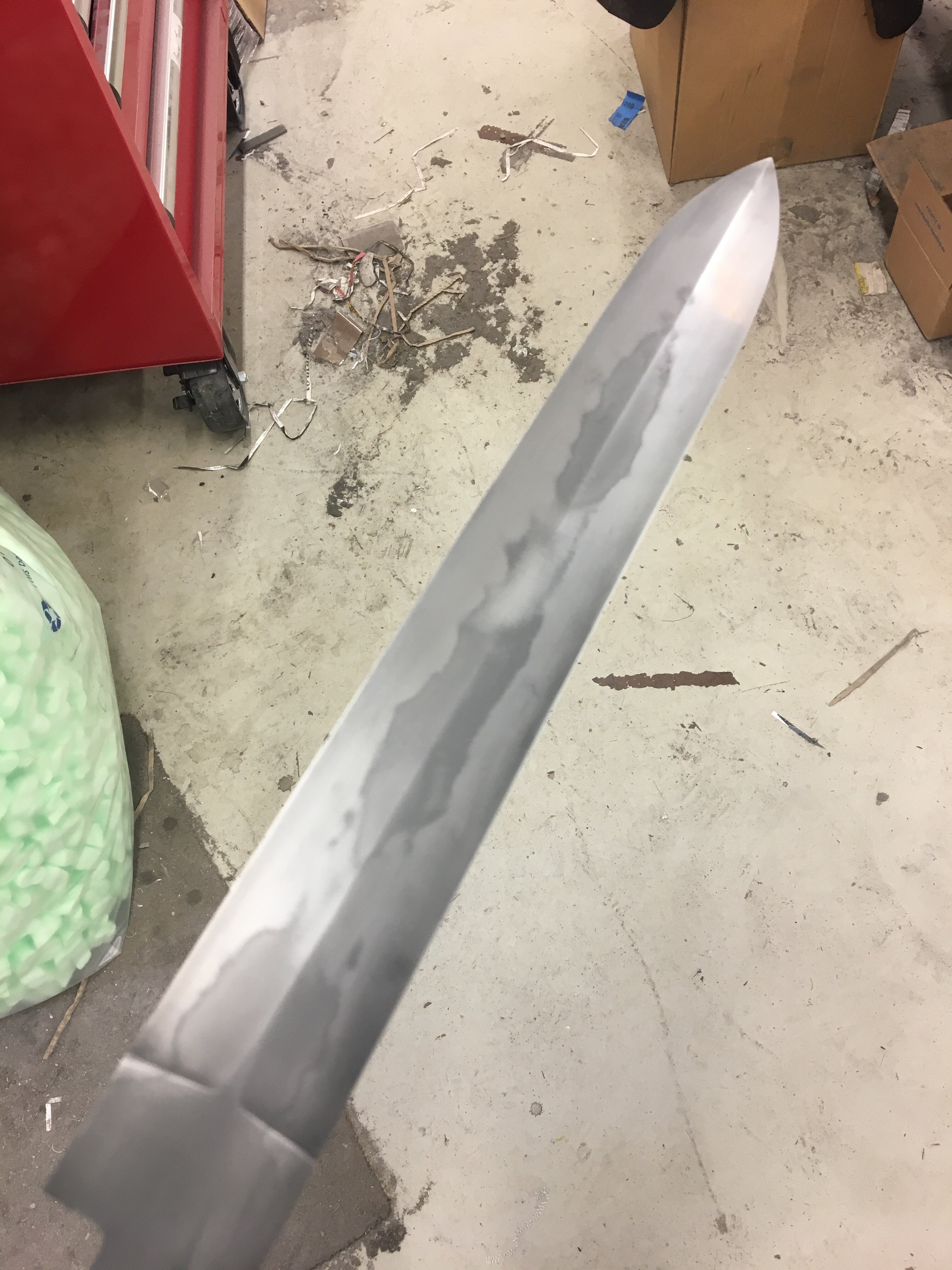

I don't know if it's correct to say that the hardened steel polishes better per se, but that the hard and soft parts of the blade respond differently to the polishing process. In a modern or hybrid polish as they tend to get called, I will use sandpaper up to around 1500 grit, then start to etch with lemon juice. After about 15 minutes of rubbing the blade down with lemon juice I'll wipe it down and polish with a metal polish like T-cut. Degrease the blade, then repeat the lemon juice. Keep going until you have a result you're happy with. It's the etching process that brings out the contrast between the hard and soft steel.
Many western smiths will etch with a dilute solution of ferric chloride (and I do too for damascus blades) but I find it too aggressive for a hamon. It makes it very obvious and when making a Japanese style blade I prefer to stay closer to their aesthetic values. Here's an example of a ferric chloride etch on a western dagger that I was playing around with. As you can see it's VERY obvious, and there's no vanishing depending on the light!

I don't know if it's correct to say that the hardened steel polishes better per se, but that the hard and soft parts of the blade respond differently to the polishing process. In a modern or hybrid polish as they tend to get called, I will use sandpaper up to around 1500 grit, then start to etch with lemon juice. After about 15 minutes of rubbing the blade down with lemon juice I'll wipe it down and polish with a metal polish T-cut. Degrease the blade, then repeat the lemon juice. Keep going until you have a result you're happy with. It's the etching process that brings out the contrast between the hard and soft steel.
