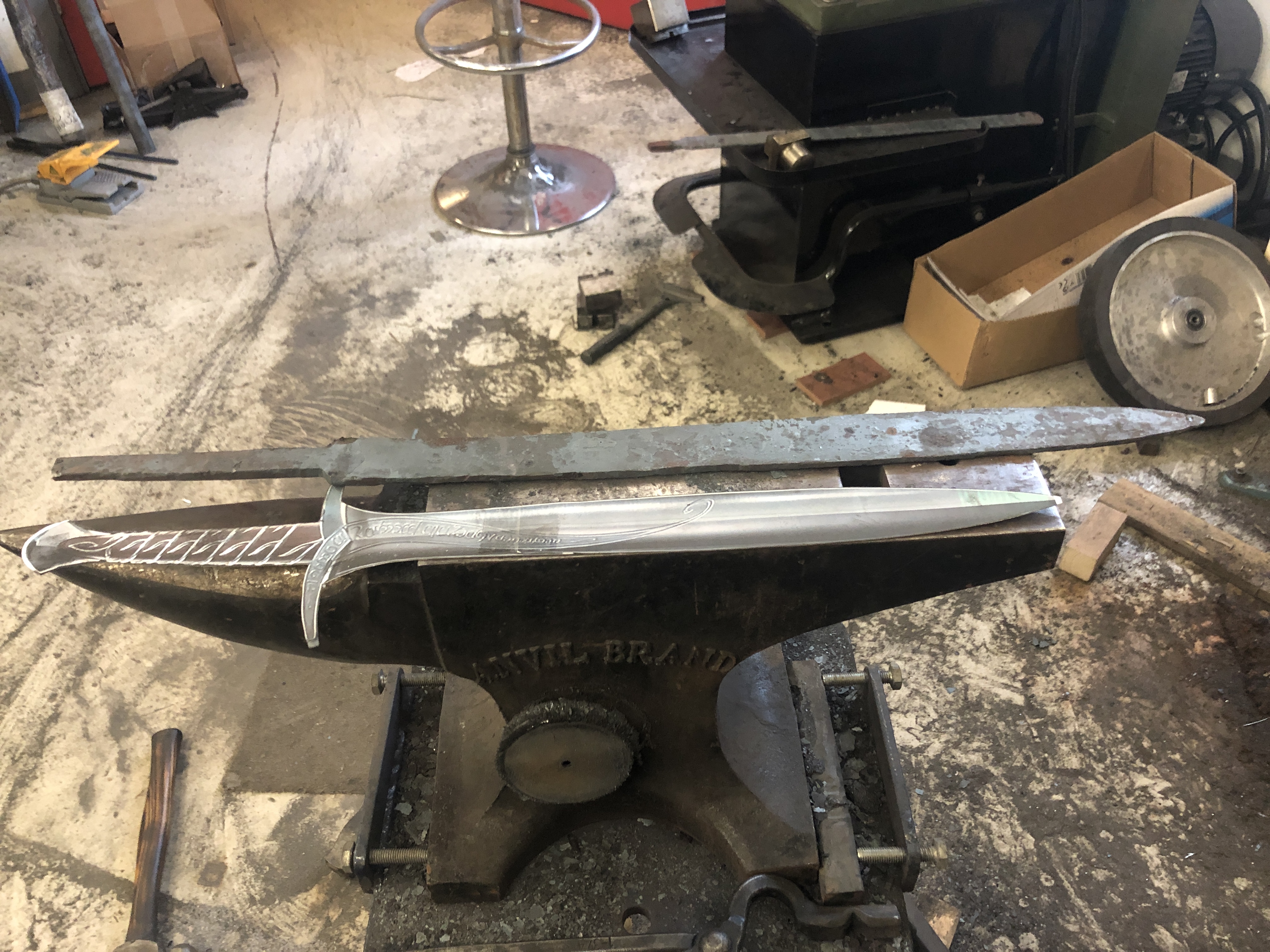

I've been working towards making a damascus steel version of Sting as I think it would fit in quite nicely with the elven aesthetic. My previous couple of weekends have been just building the layer count on the billet, but today I got to do the rough forging to shape, and it turns out I allowed more steel than I needed for it. I had planned to make it as an 'in universe' build, i.e. it would be the size of the dagger in a human hand, not the scaled up version that was used for Elijah Wood. However, forging it out has left it far bigger than I needed.
So, suggestions taken, what should I do? Should I just cut it down and make the smaller one anyway, or should I try and stretch it a little further to make the scaled up size dagger?

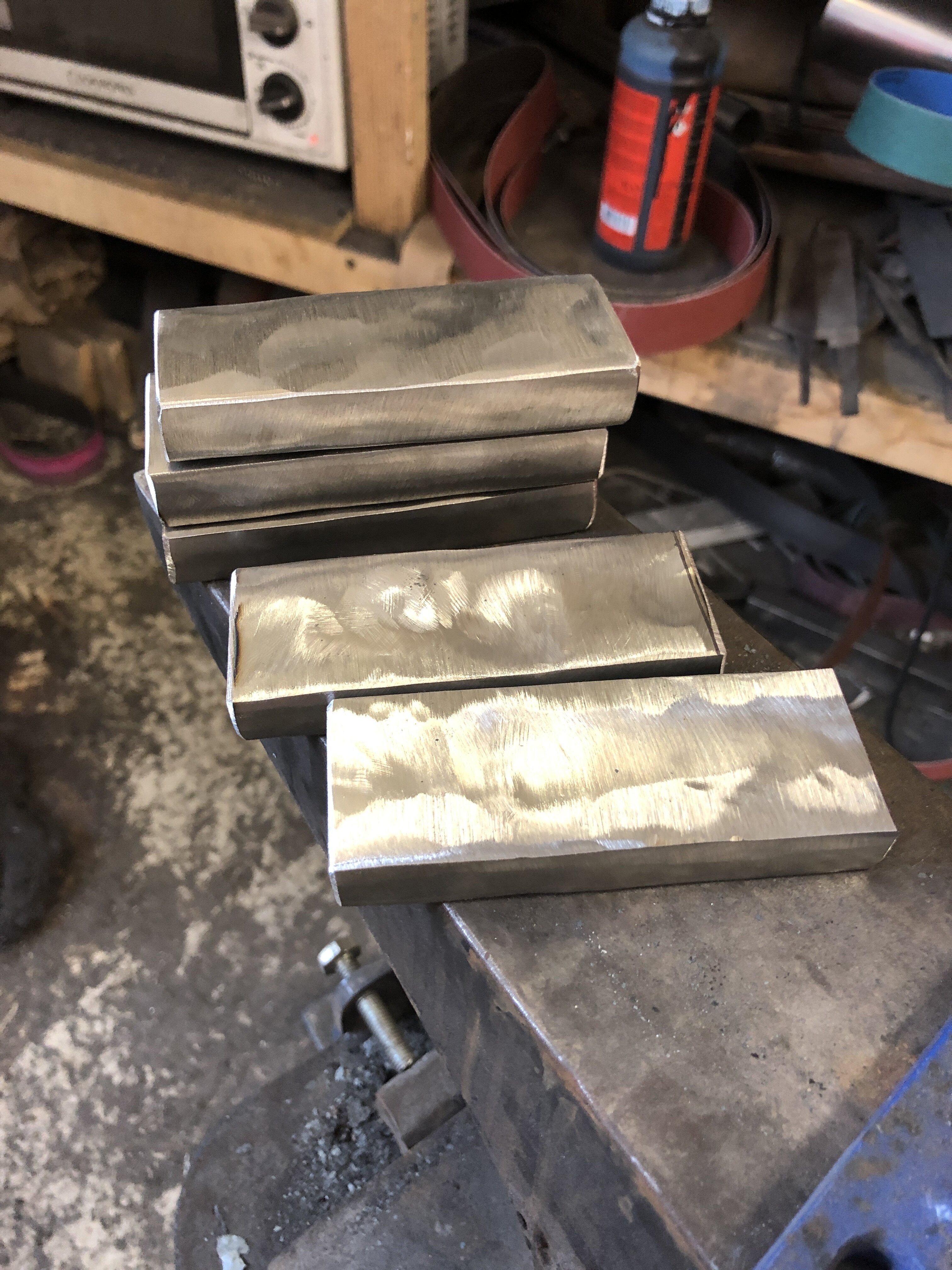

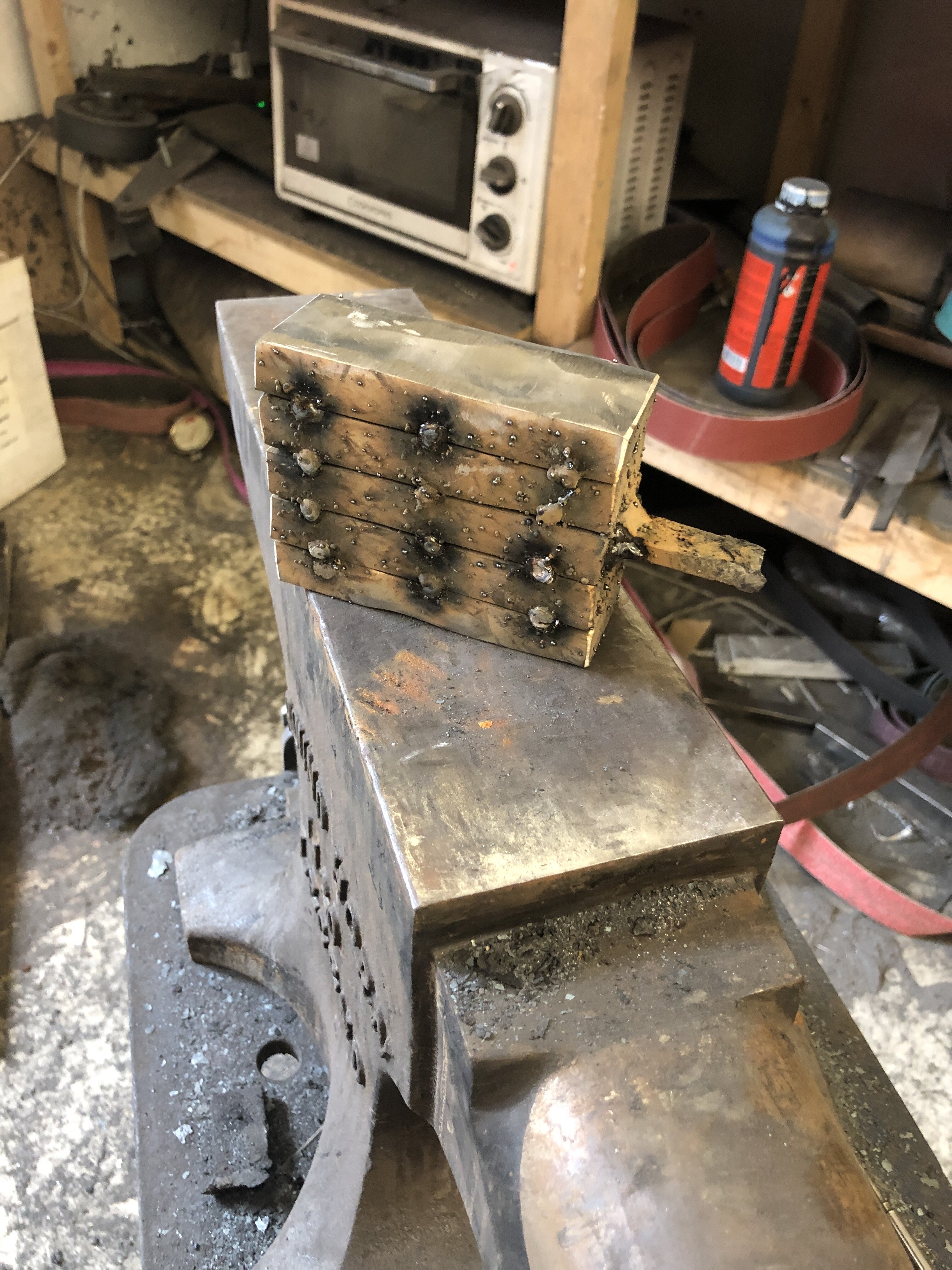

I didn't start taking pics right at the start, so these blocks are all 35 layers of steel already forge welded and drawn down to about 12mm thick.
Tack welded together for the next forge weld, 35 layers x 5 brings us to 175 layers. Then forged down to about 12mm thick again. The bar's about 24" long.

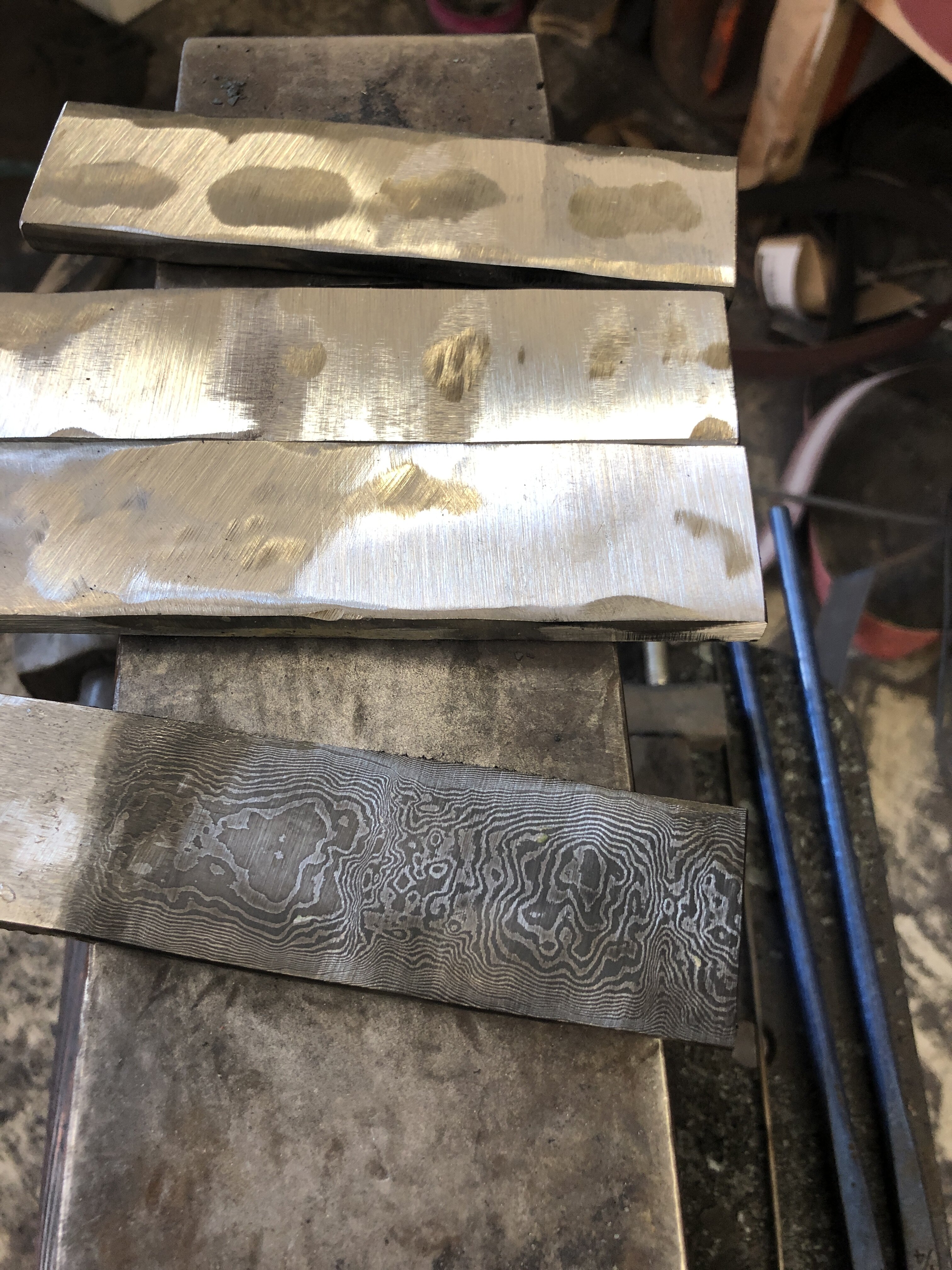

Once that was forged down, I cut it into 4 again, and at this point I wanted to see how it was looking, so one of the pieces has been dipped in ferric chloride to etch it lightly and reveal the patter. It's not that dramatic as it's still relatively thick for only 175 layers. The more it gets compressed, the more layers will appear at the surface.

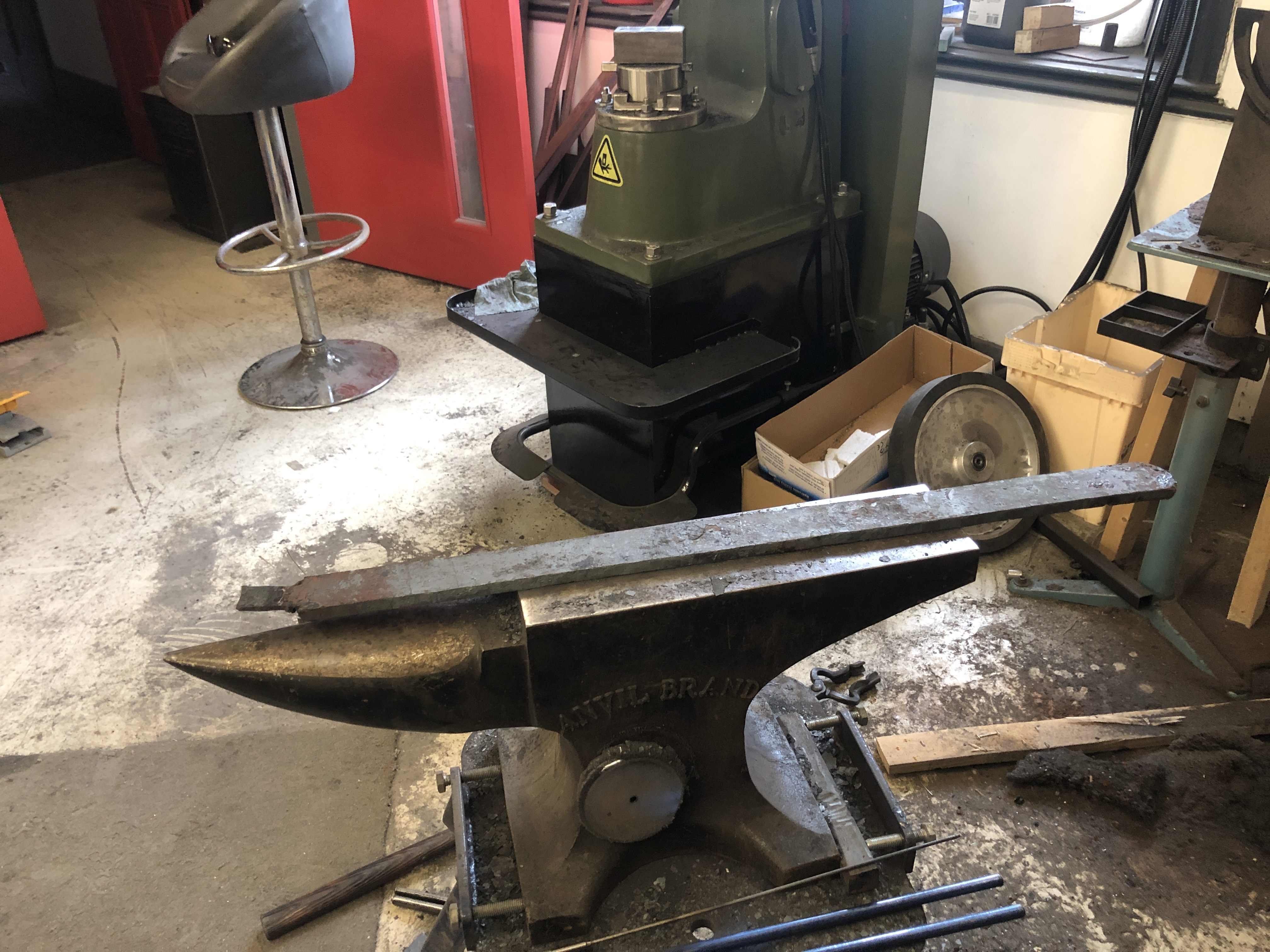

Here's the billet. Part of this will be used to make some kitchen knives and you can see where I've marked in chalk how much I think I'll need for the tang (at the right), and then the blade. I was wildly out on how much I needed for the blade.

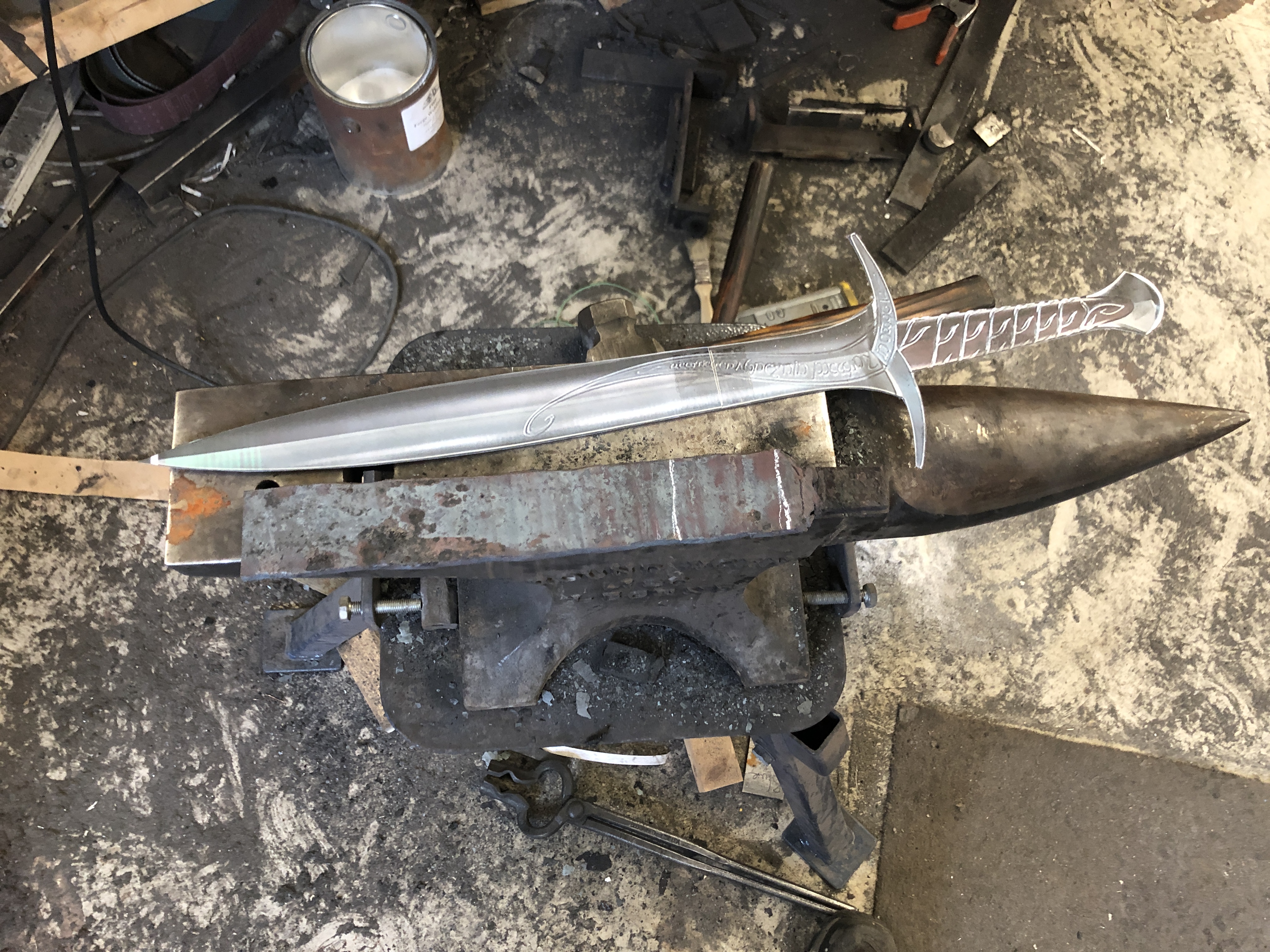

And next to my cardboard cutout guide.

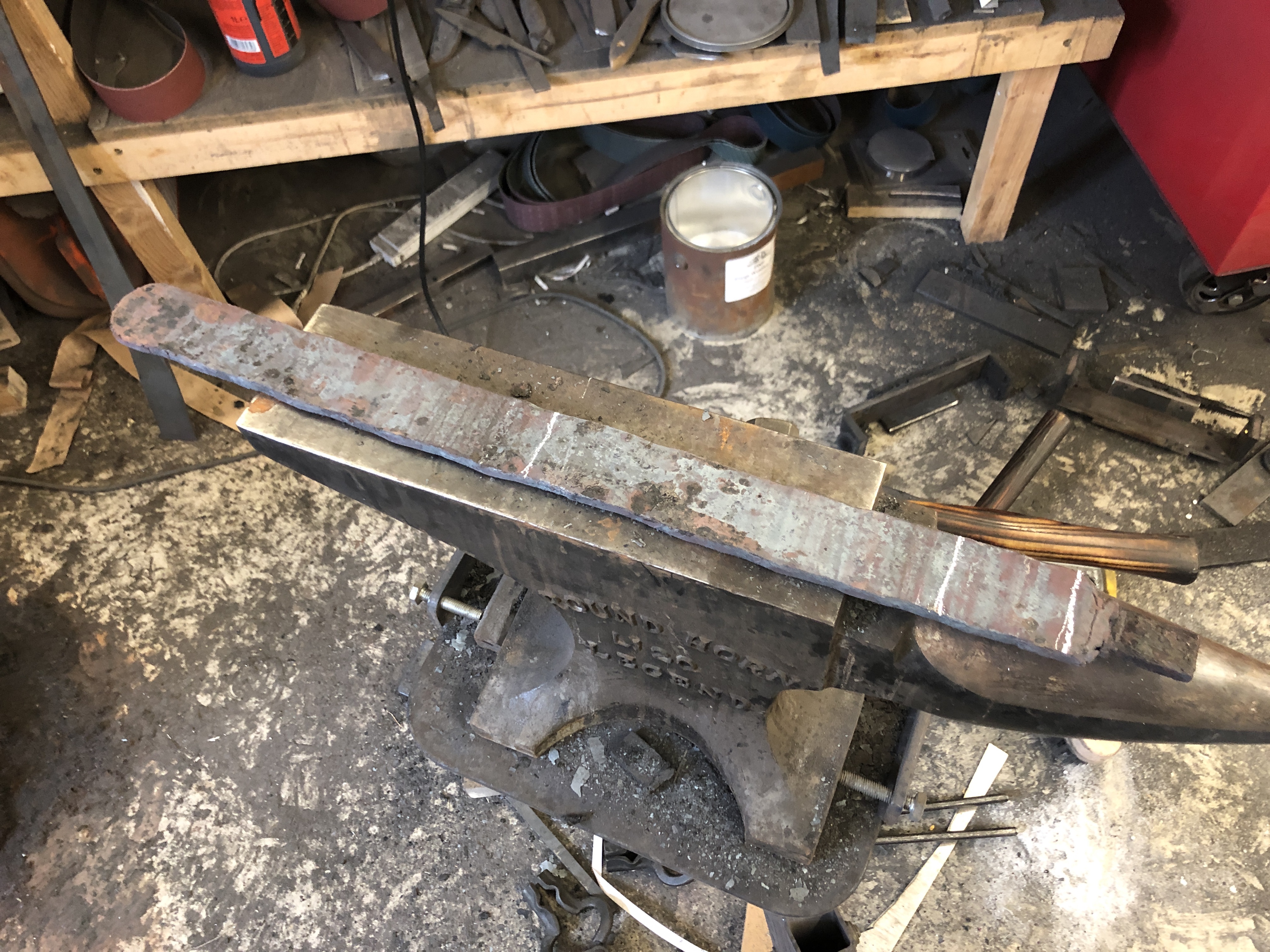

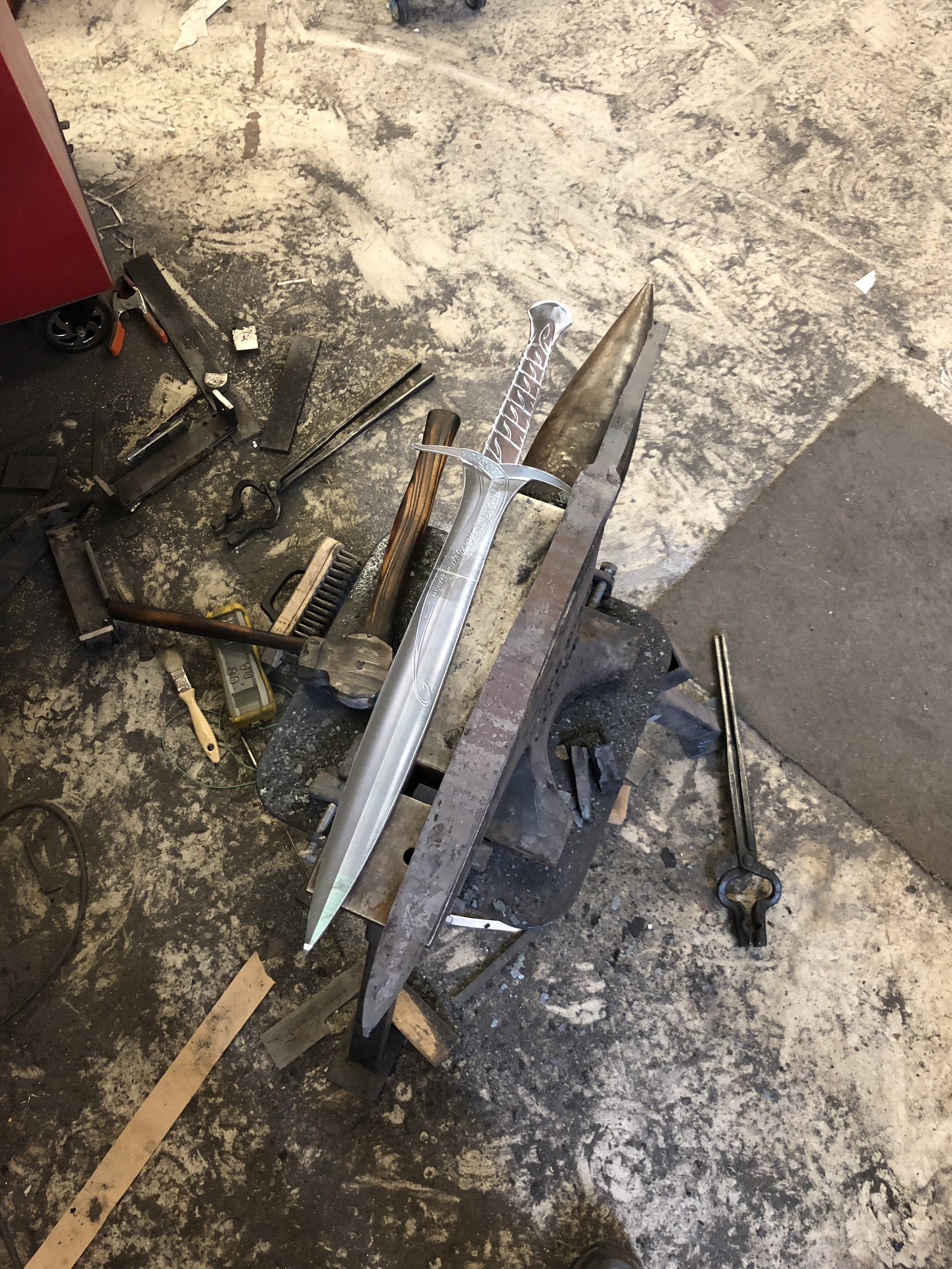

And here's where we are. I haven't started forging in any bevels yet. That's next weekend.

I just asked my brother who is a diehard Tolkien fan. His opinion is to go hobbit sized, no hesitation. Two opposing opinions, sorry that I could not be of any help. The steel might give you it's opinion too.
ScoobiJohn
i bought a replica and it was small sized and i got to admit it felt wrong and to small - from the film we see it in human sized terms - if i was making one i'd go big (not huge but something that could be called a short sword)

I’m leaning towards cutting it down to the smaller size now. I’d have to stretch the tang out a little more than I’d like to make the larger one, and I don’t want to sacrifice strength and functionality.

you envisage fighting lots of orcs? :)
actually get it - things should be done right
Exactly. I'm making a dagger. Not a dagger shaped object. And also one day I may sell it, and it will have my name on it. Who knows what that guy will do with it?

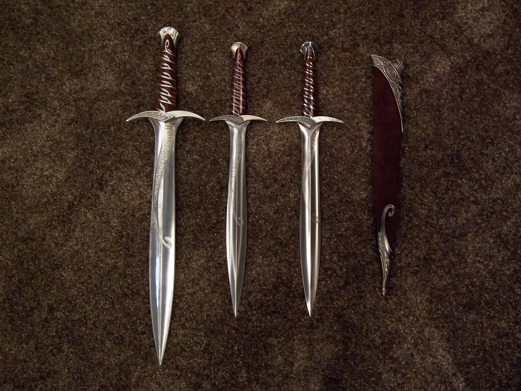

Stivie, thanks for that pic! Settles it in my mind. Smaller size.
