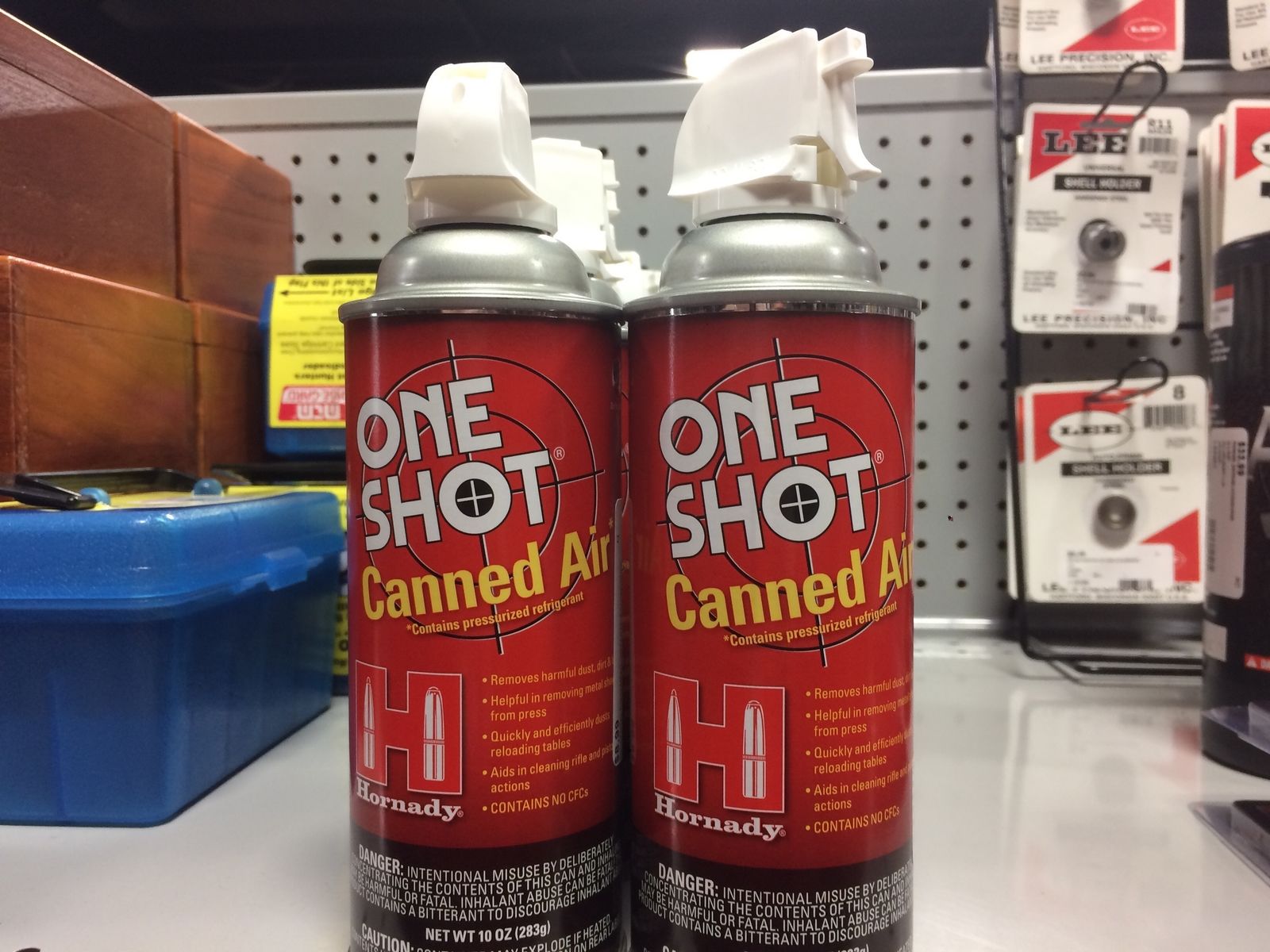

Continuing the theme to think outside the box, I saw these at eBay. It was one of the options that came up searching "canned air". This might be a bit too skinny, but it's hard to tell from the picture.

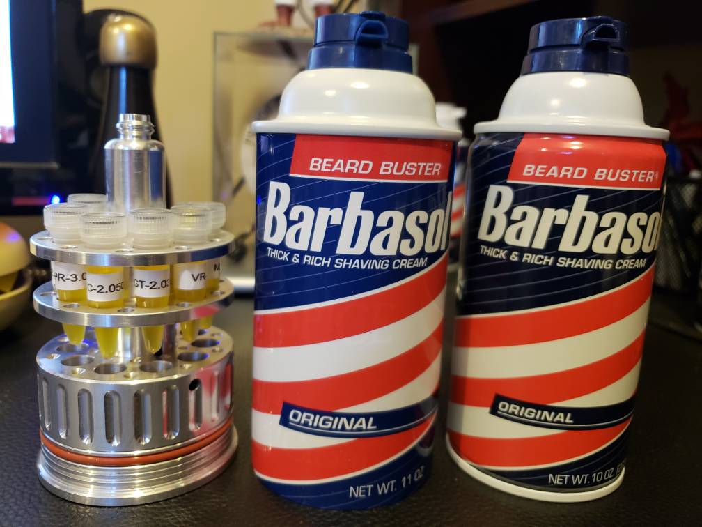

Here is my accurate shaped can with Paul's barbasol graphic printed on vinyl paper. The newer barbasol can you see is uncut bought new from the store compared to my yardley of london spice. I'm happy how it came out it my only flaw is that I can see faintly the text underneath the label of the yardley can. Not sure how I can get rid of that. Anyway there you have it. 20180508_151227.jpg20180508_151242.jpg20180508_151410.jpg
Sent from my SM-G965U using Tapatalk
Here is my accurate shaped can with Paul's barbasol graphic printed on vinyl paper. The newer barbasol can you see is uncut bought new from the store compared to my yardley of london spice. I'm happy how it came out it my only flaw is that I can see faintly the text underneath the label of the yardley can. Not sure how I can get rid of that. Anyway there you have it. View attachment 815774View attachment 815775View attachment 815776
Either paint the can white before adding the label, or strip the factory graphics off. (I'm unsure how one would go about that.)
Looks great, though.
I was thinking a thicker vinyl paper stock?
