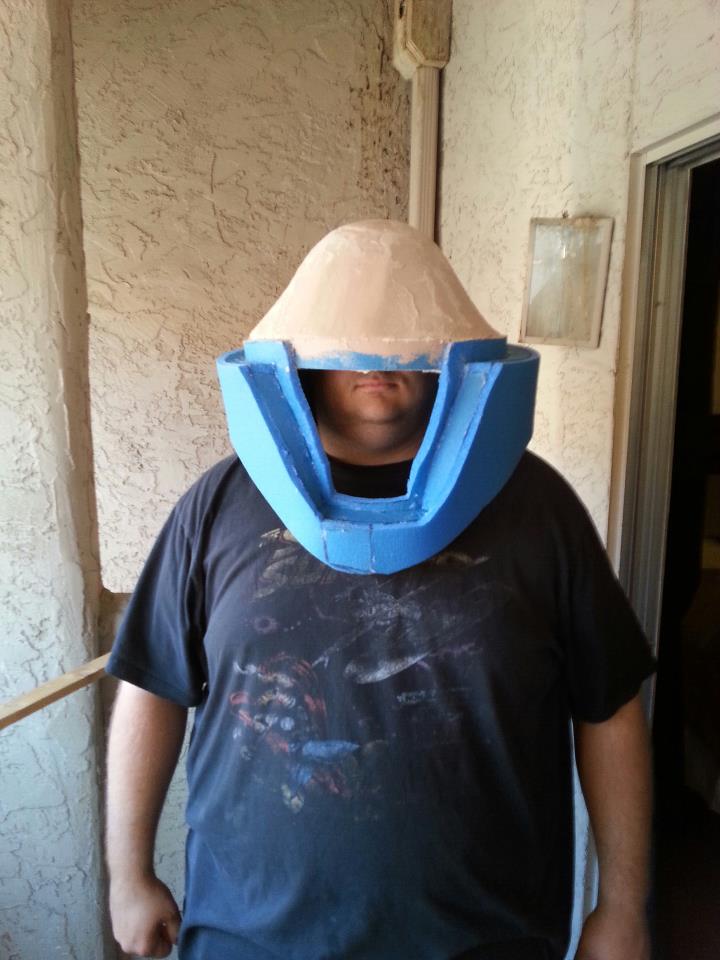

Using Blue camping mats to build the under structure

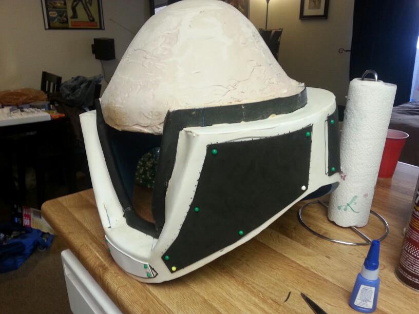

Used a rubber ball, and plaster cloth to get the basic dome structure built

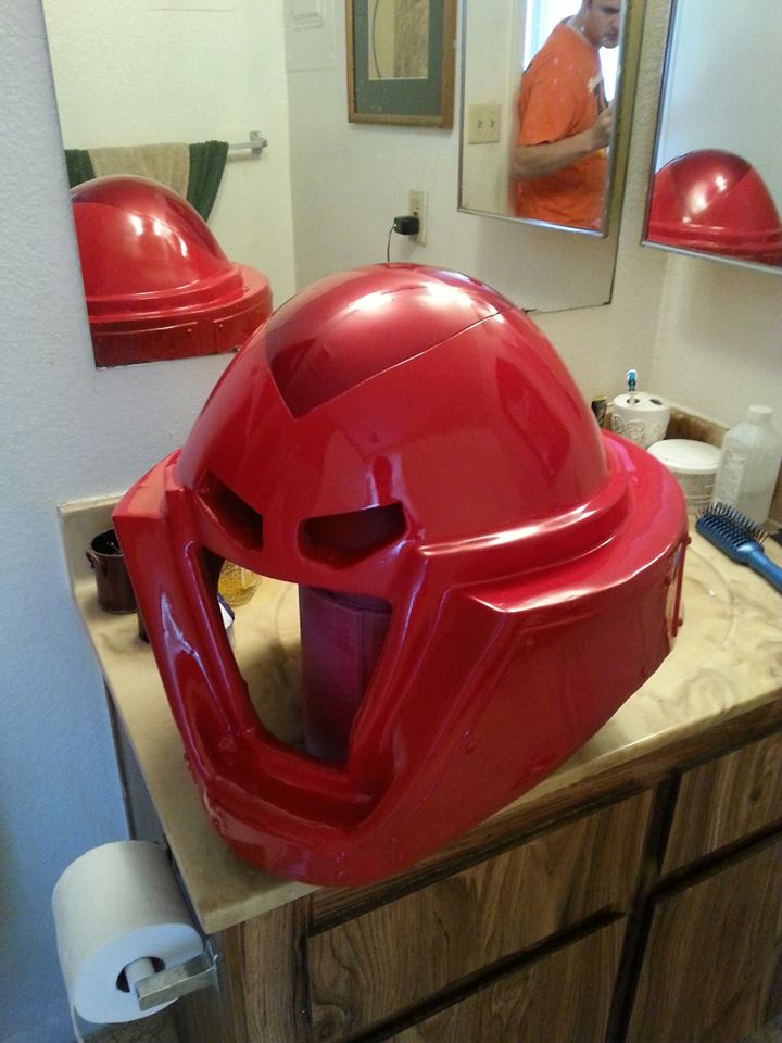

Final paint job done. The finish turned out great IMO

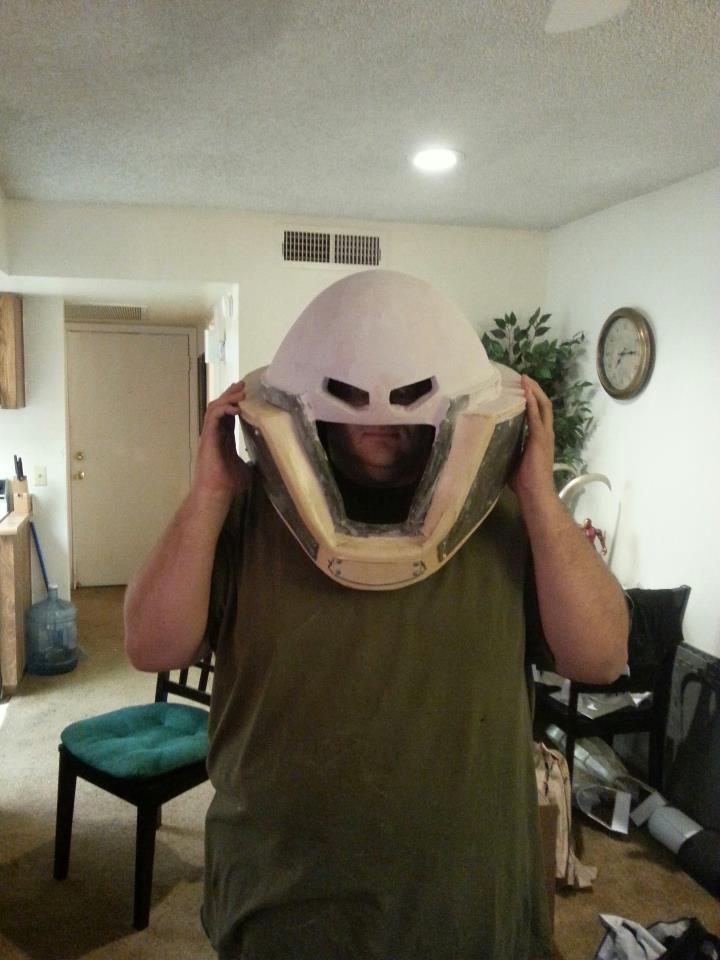

Final test fitting. He built the rest of the costume but my part was done. Needless to say, he was very happy.
