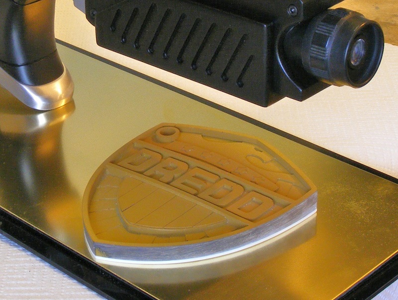

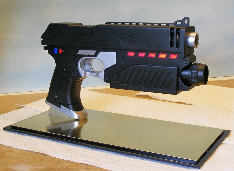

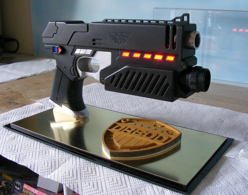

I’ve mounted the lawgiver on the base of the display case. I’ve stuck a thin sheet of brass on the base rather than paint it. The wedge is painted Rover Cashmere Gold with a gloss lacquer, which I think is a close match to the brass.
I originally had the badge mounted at about a 20 degree angle, but it was shadowed by the gun.
It’s now almost flat, just sloping downwards slightly.
I’ve just got to clean this up and paint it with the Rover Gold and the project is finished.

hey man what did you use for the base of the display case? is the base spray painted
edit nevermind i see it "sheet of brass"
next question where did you get the sheet of brass?
and how did you do the little red window cut outs? is it acrylic?
