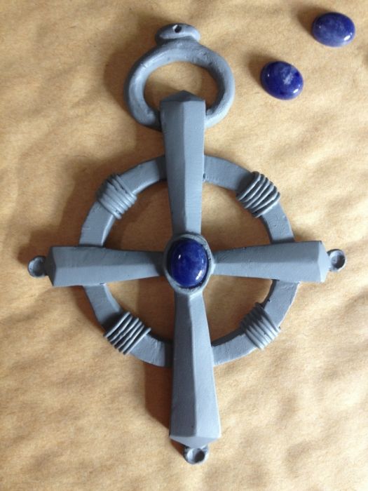

Re: Robin Hood Prince of Thieves - Pewter Medallion - Re-tooling the master on page 2
OK, here's a shot of the new master, now in a coat of primer. It still needs a little refinement, but it's close to being ready for the new mould.
In this shot you can better see the new "setting" I've carved from the resin, ready to accept the new centre stone.
I've ordered some of these stones to use in the centre. They are made from Sodalite, and should be the perfect size. Fingers crossed!

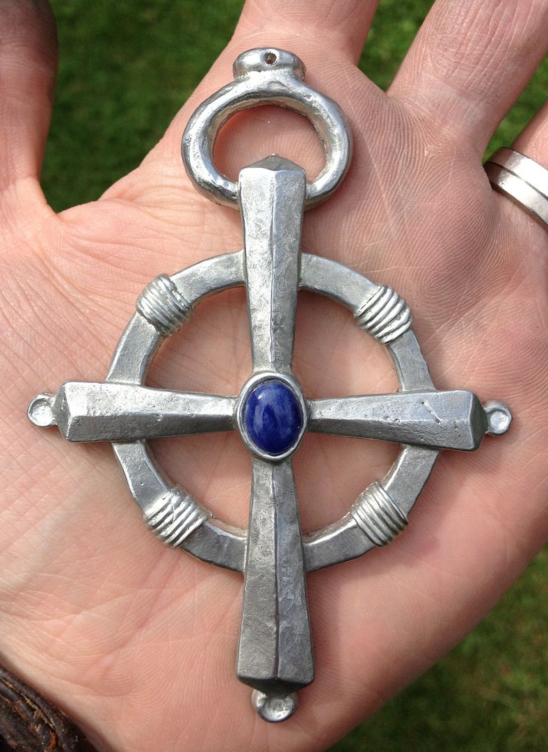

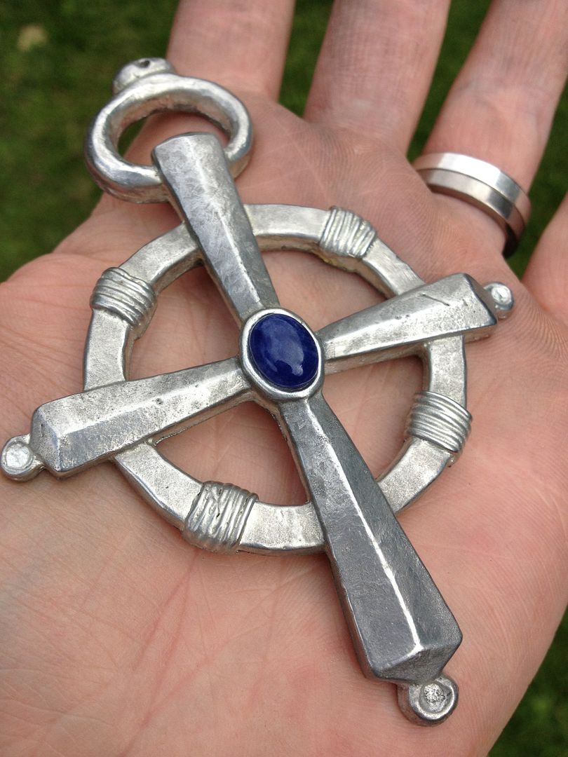

The rubber finally arrived, so I have been able to make a new mould, and take this first cast in Pewter. This is after cleaning up the flashing around the edges, and a little bit of polish, the stone is just sitting in place at the moment. There is a small "scar" on the right side of the crucifix as you look at it. This was an eyelash or something, sitting in the mould when I cast the pewter, so it won't be there on subsequent castings. I may use this cast as a version of the medallion that was damaged in the fire.
I've got to say I'm pretty excited about this project again. It's been worth the effort to re-tool and re-mould I think.
Finished photos to follow shortly...
Thanks, iDD.
The wires are a different approch for sure. The problem with how I was doing them originally, was that it left the two ends of the wire exposed on the reverse. Which was fine, but it just bugged me a little.
What I'm trying to do with moulding them into the cast, it to keep a nice clean surface on the reverse. Once the gold leaf is in place, an there is a wash of ink filling the "ribs" of the wire, I'm hoping they will "pop" a little more.
I should have a few photos up of the first finished prototype from this new mould later today.
Thanks again for looking.

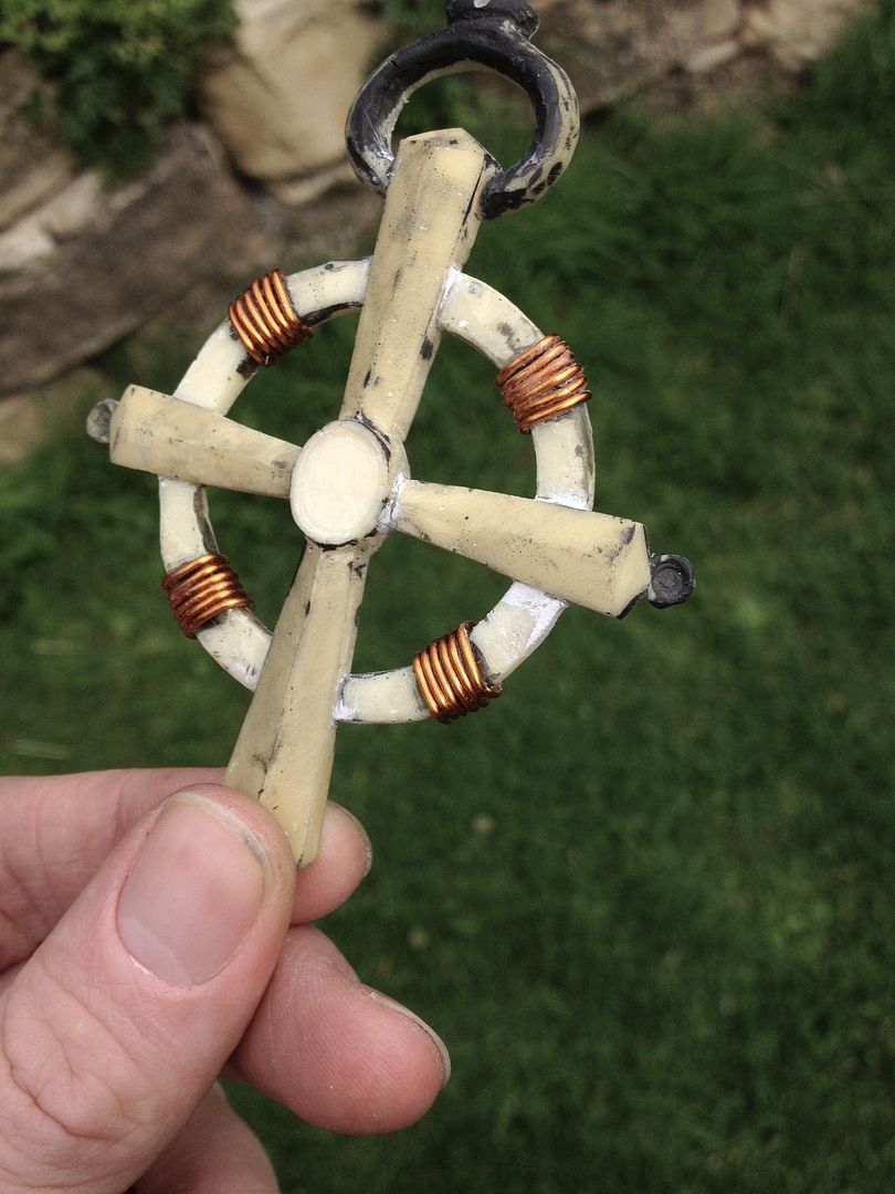

Re: Stripped down and re-built. Robin Hood Prince of Thieves - Pewter Medallion

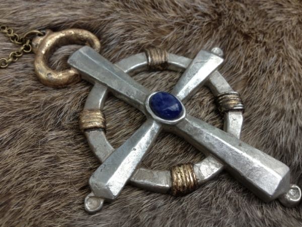

Nearly there. I'll have another go at the finishing on the next cast. The size I used to fix the gold leaf was pretty old, and didn't hold up very well to the weathering process. Not perfect yet. YET! ;)

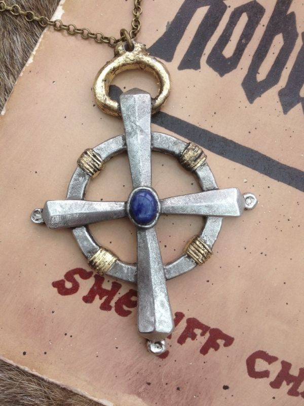

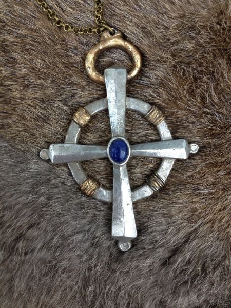

Another cast, and a slightly different weathering technique...
it's getting better and better. Great re-worked prop.
Have u used gold leaf on it?
Thanks very much. Yep, gold leaf on the detail pieces, then a wash over the whole piece to tie the elements together.
