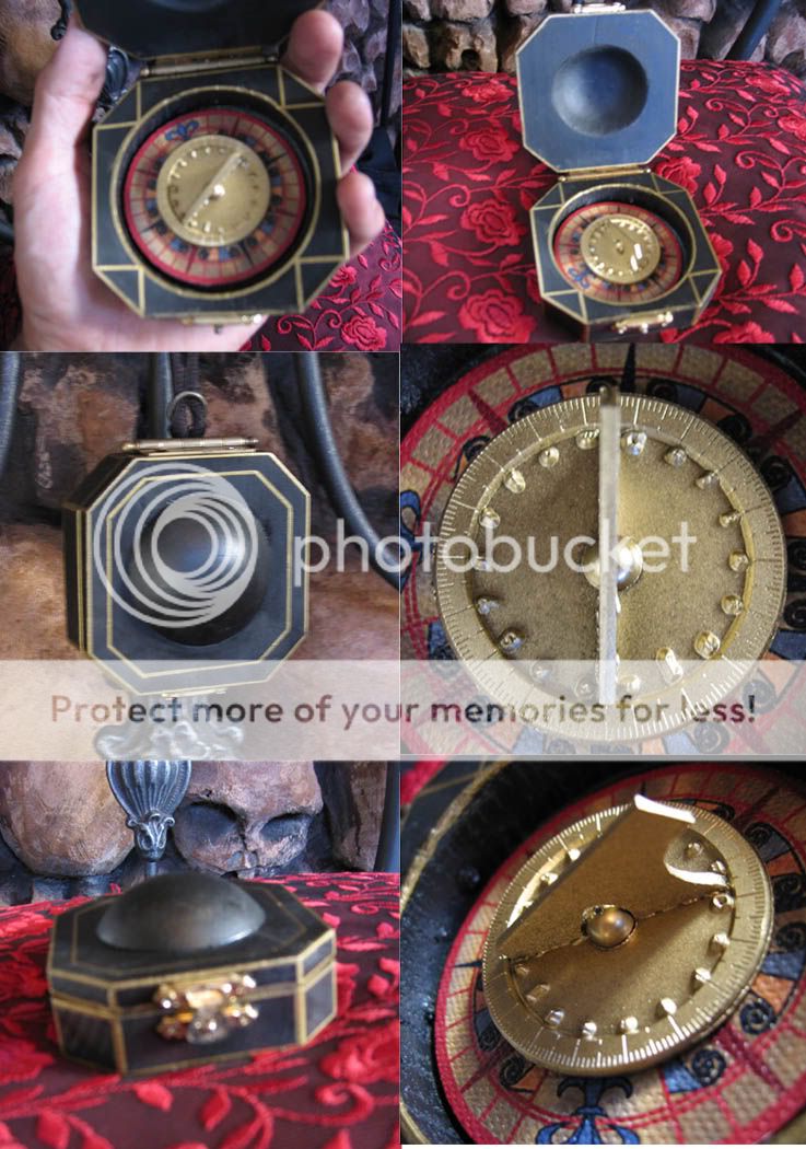

Here's mine -- finito today.
Click on the image for more pics...
Thanks everyone. The leatherette is imitation which came from a cheap case for glasses. I used paint from a vinyl car seat repair kit to color it.
Great Job PHArchivist. Looking at yours, I just realized I forgot to "chip" my inlay on the lid.
-Hans

Thanks, man...
Don't use mine as a reference -- its backwards.
PHarchivist --
FANTASTIC JOB. Perhaps the best of the toy conversions shown to date. NICE job on the sundial and VERY NICE job replicating the back lanyard ring -- I wish I had had the patience and determination to make my conversion look this nice.
I am sure you'll agree you wouldn't sell the one you made for less than $200, considering all the time you put into it.
Thanks for sharing the pics...I had a feeling yours was going to look incredible.
I still have extra leatherette material and the brass half-dome tacks (fo under the sun dial) for anyone wanting some -- just send me a an oversize padded or bubble-wrap envelope SASE with 3 first class stamps, and I'll send you enough to comlete one toy conversion...while supplies last.
