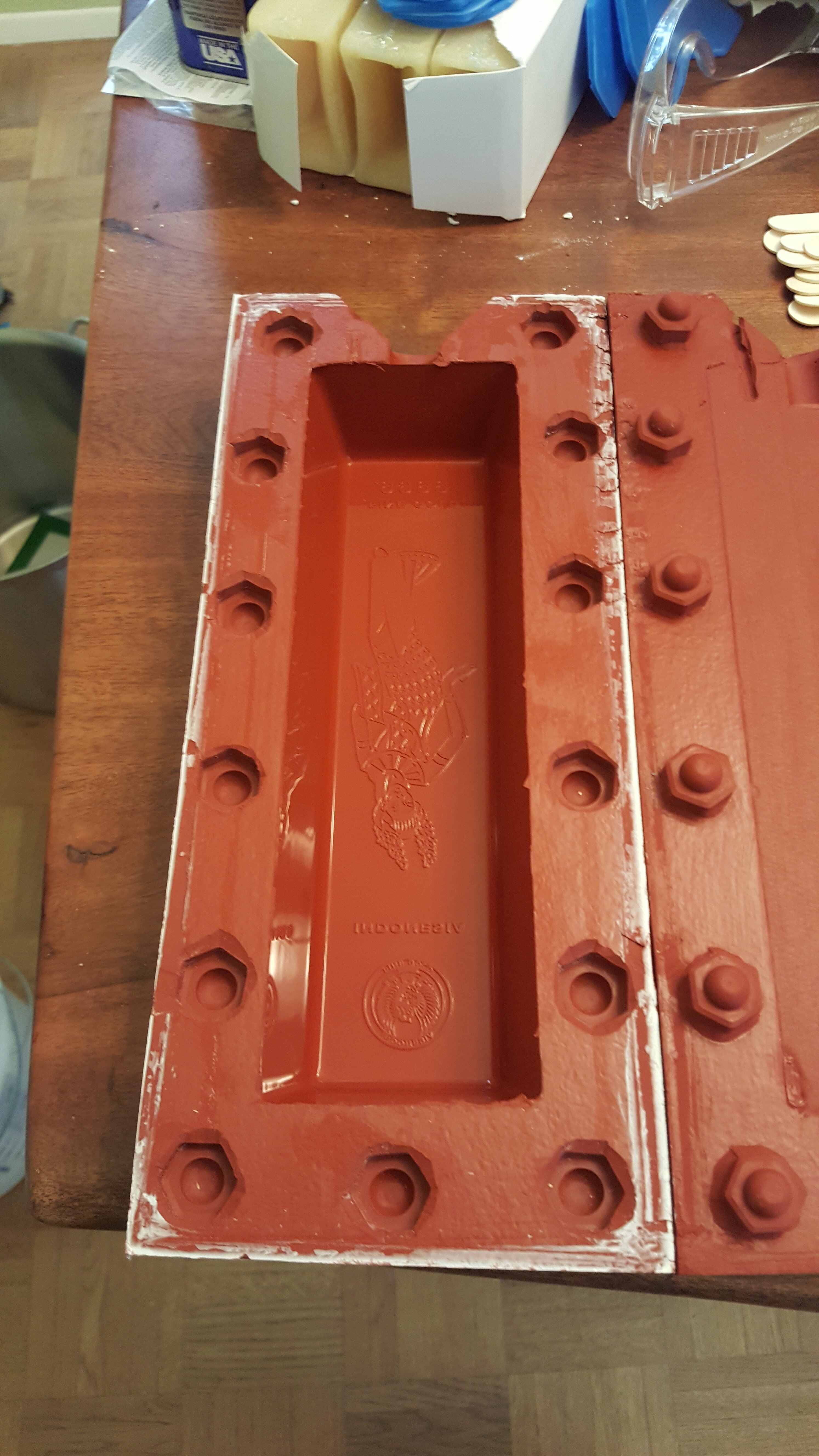

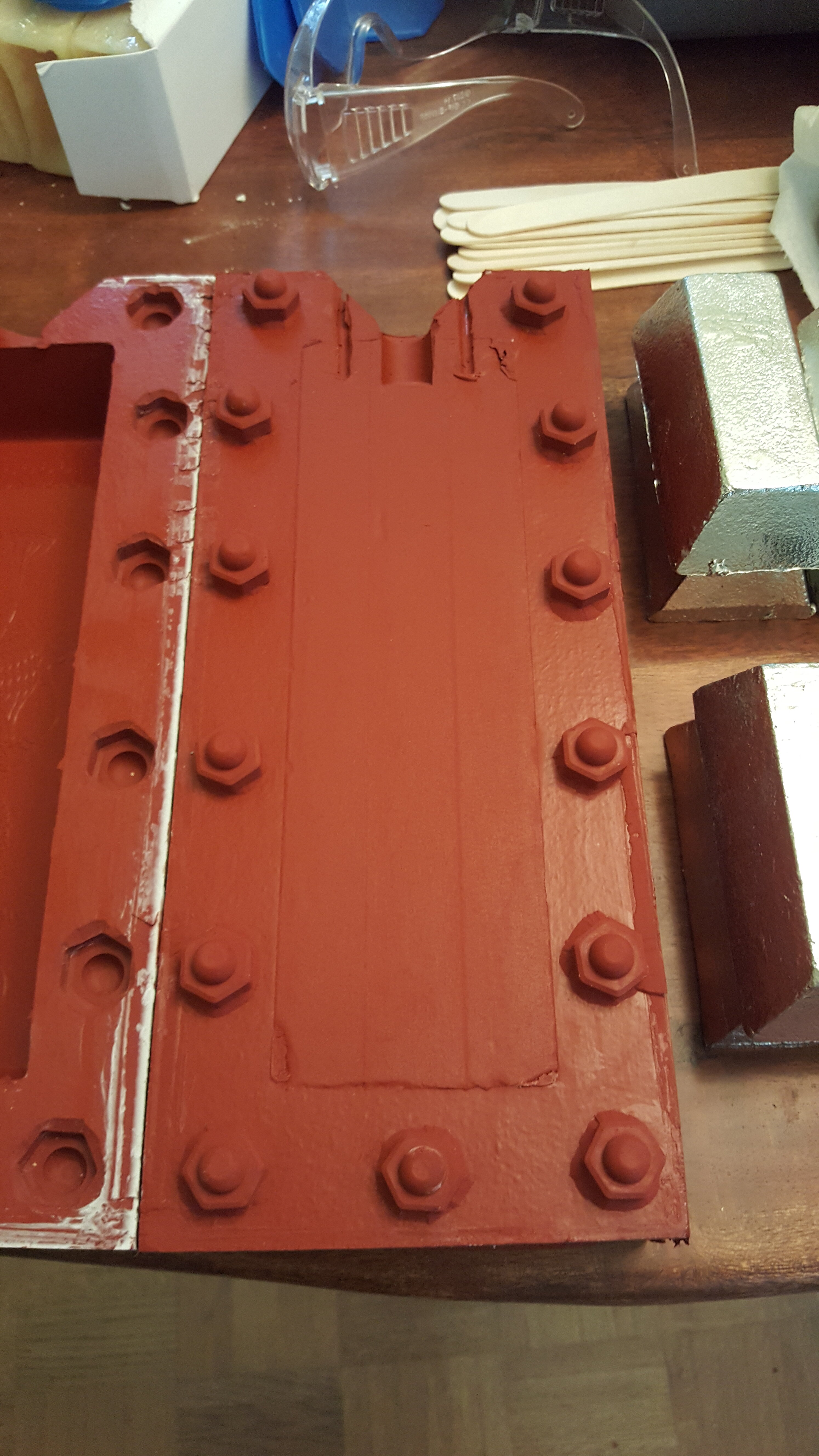

So I went ahead and created a two part mold using high temperature silicone (mold max 60)

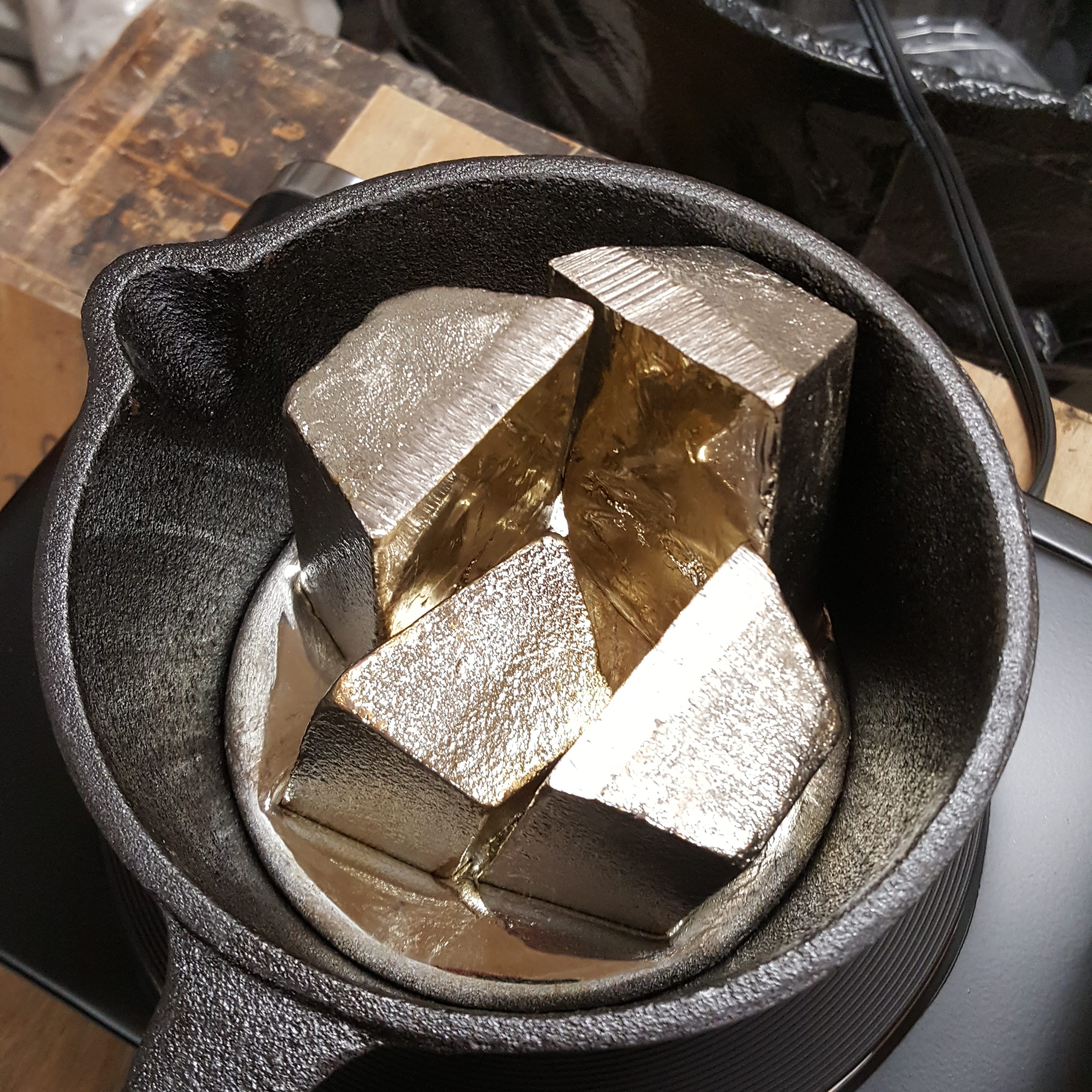

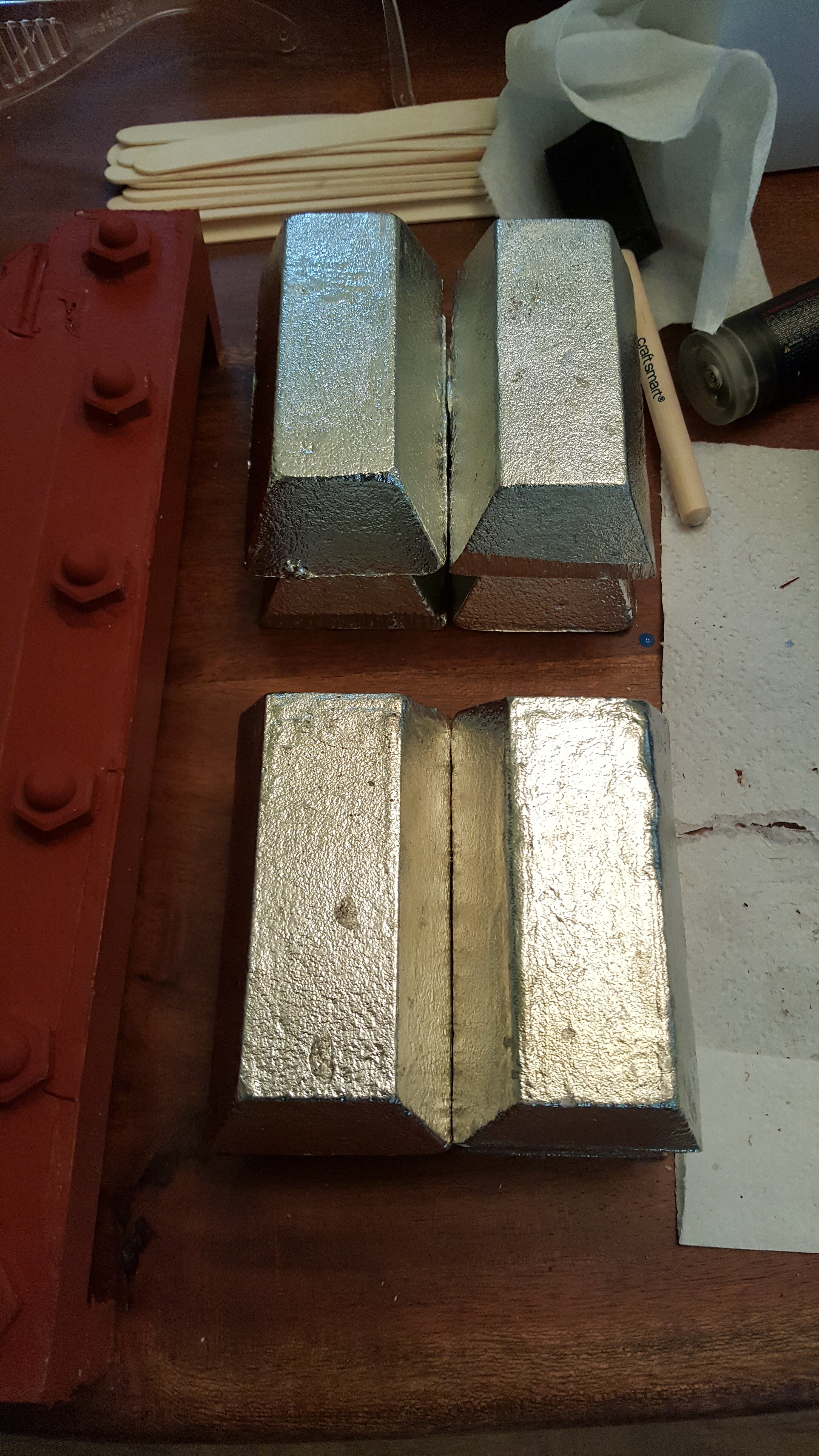

Also got myself hopefully enough metal in these ingots to get 2 solid bars out of.
I have 1 4-bar stack of Pure Tin and 1 4-bar stack of lead free pewter.
I'll do the tin first since it has the lower melting point and then see how well the pewter does. Will also try preheating the mold in the oven so the temp difference when the metal goes in isn't chaotic enough to cause artifacting in the finished cast.

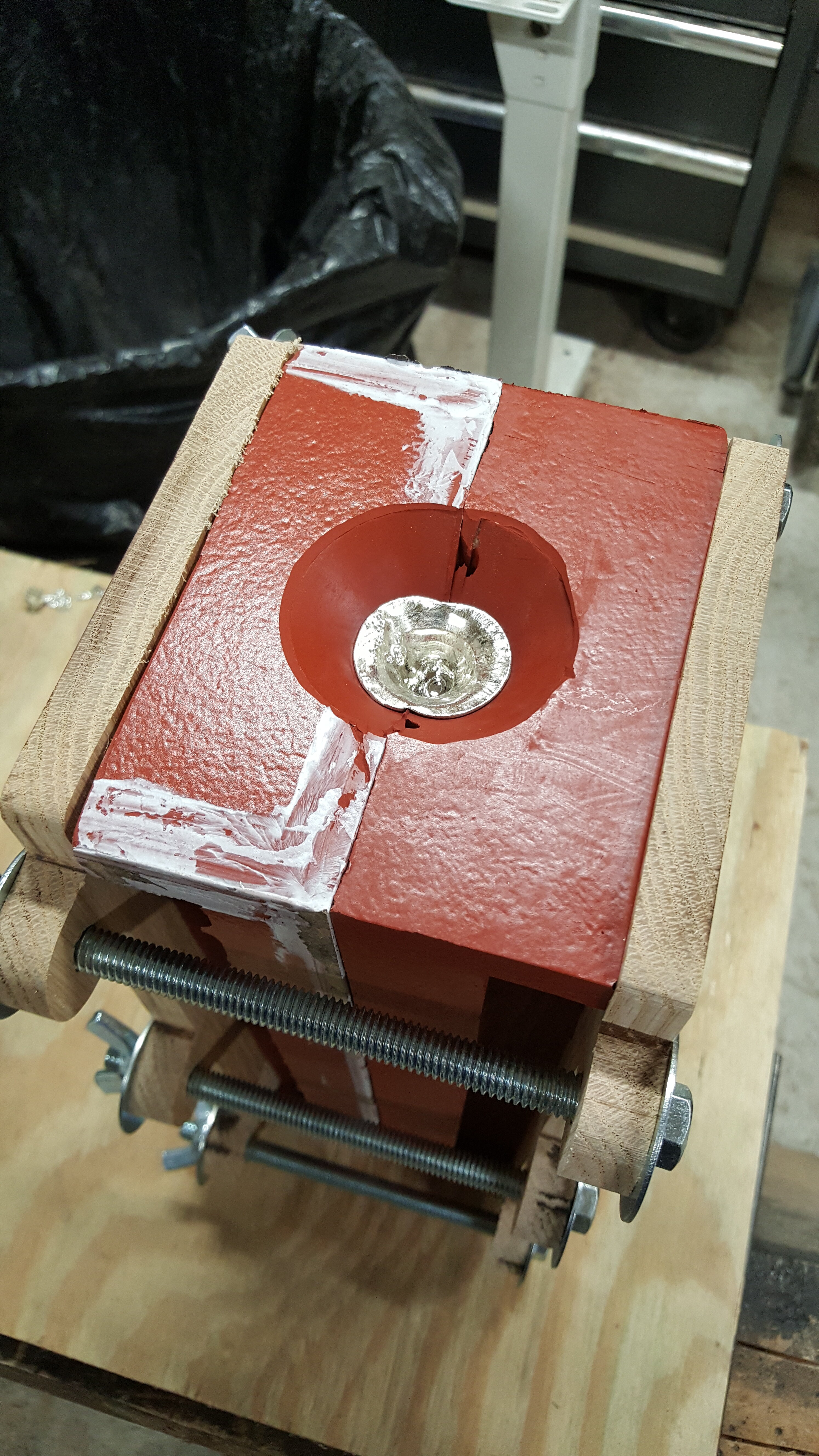

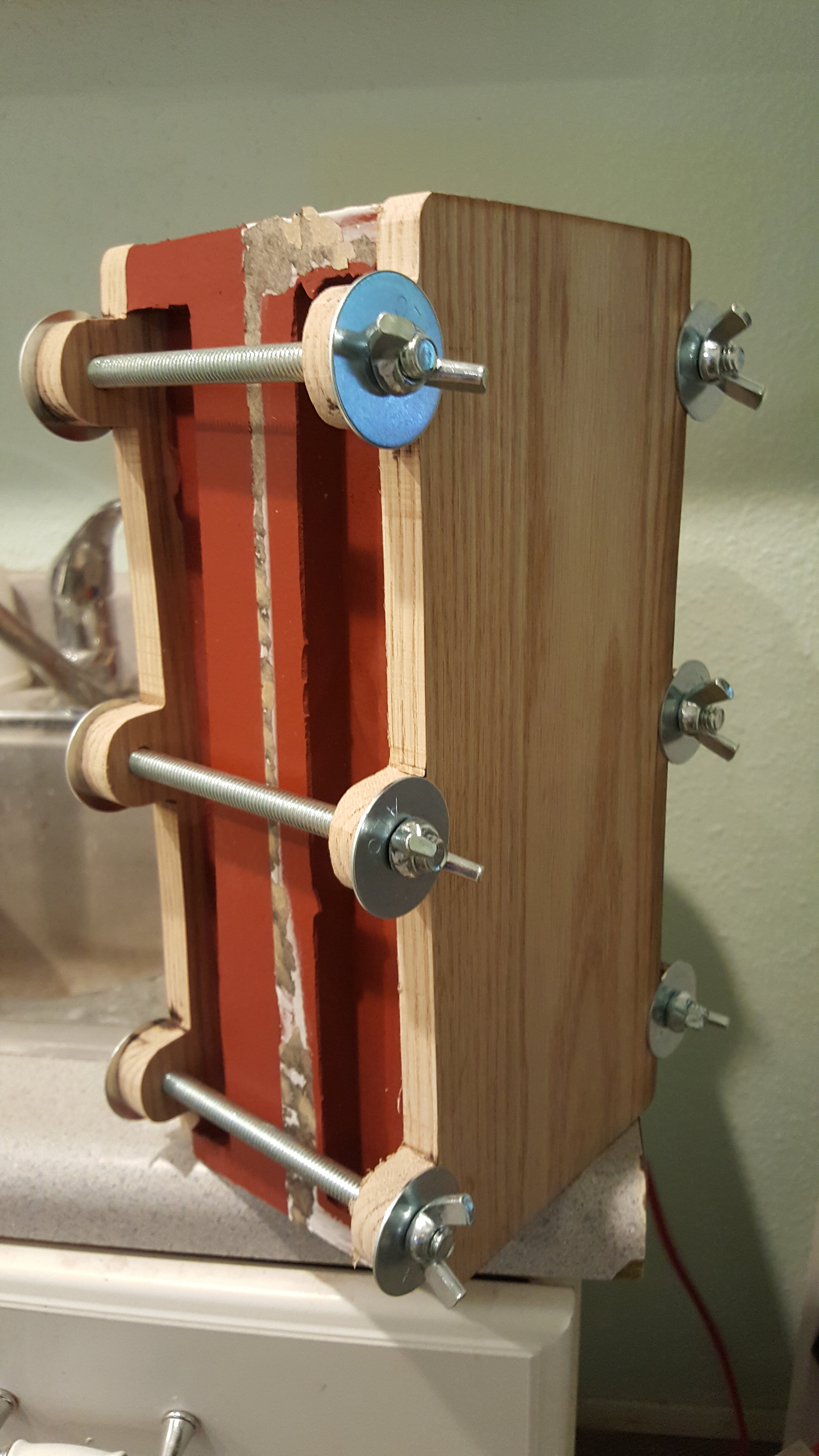

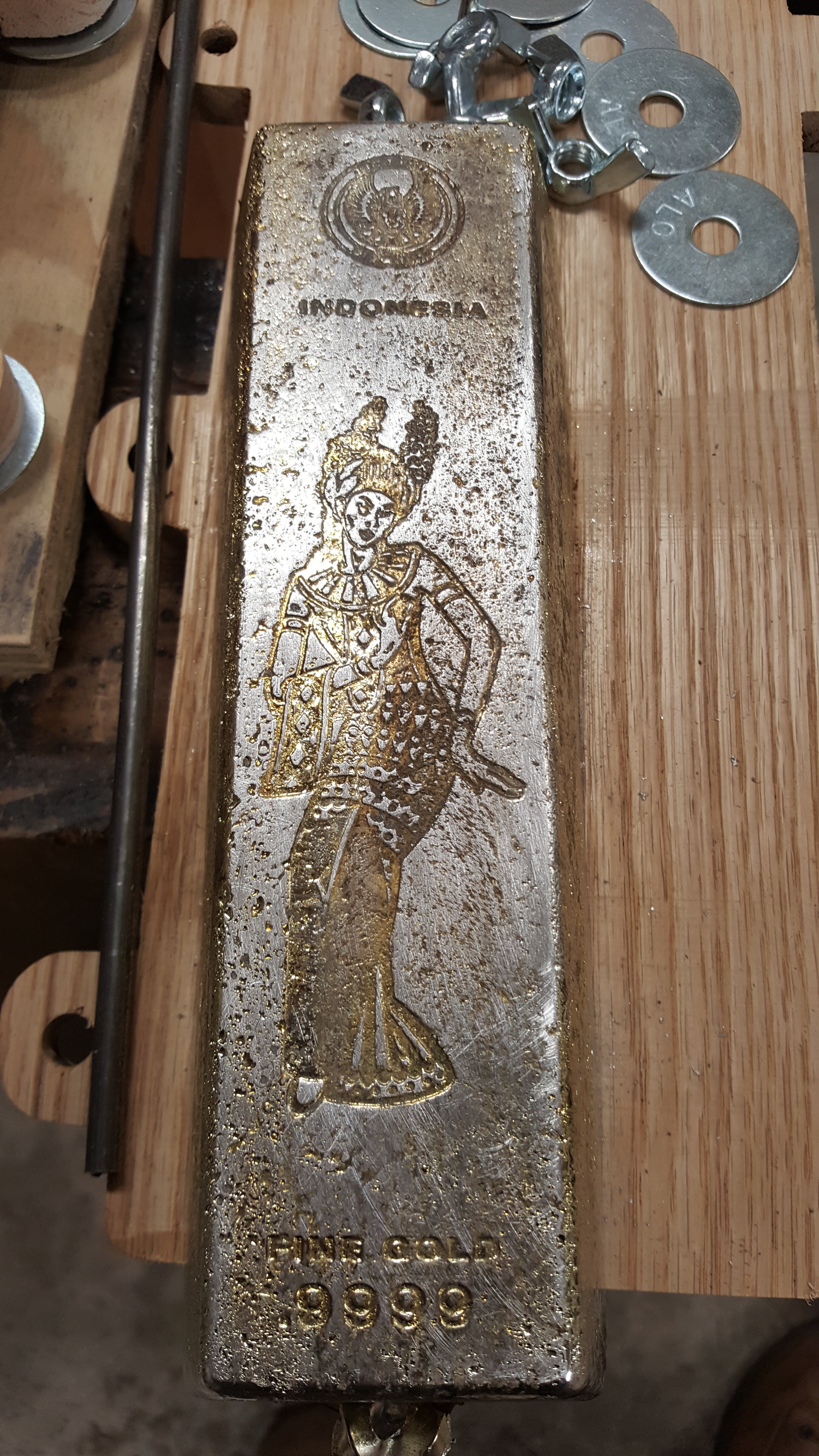

small update, waiting on a new hotplate to arrive since the one I have doesn't get hot enough to melt the ingots down. I built this clamp setup for the mold to keep it together while the metal is pouring and cooling.

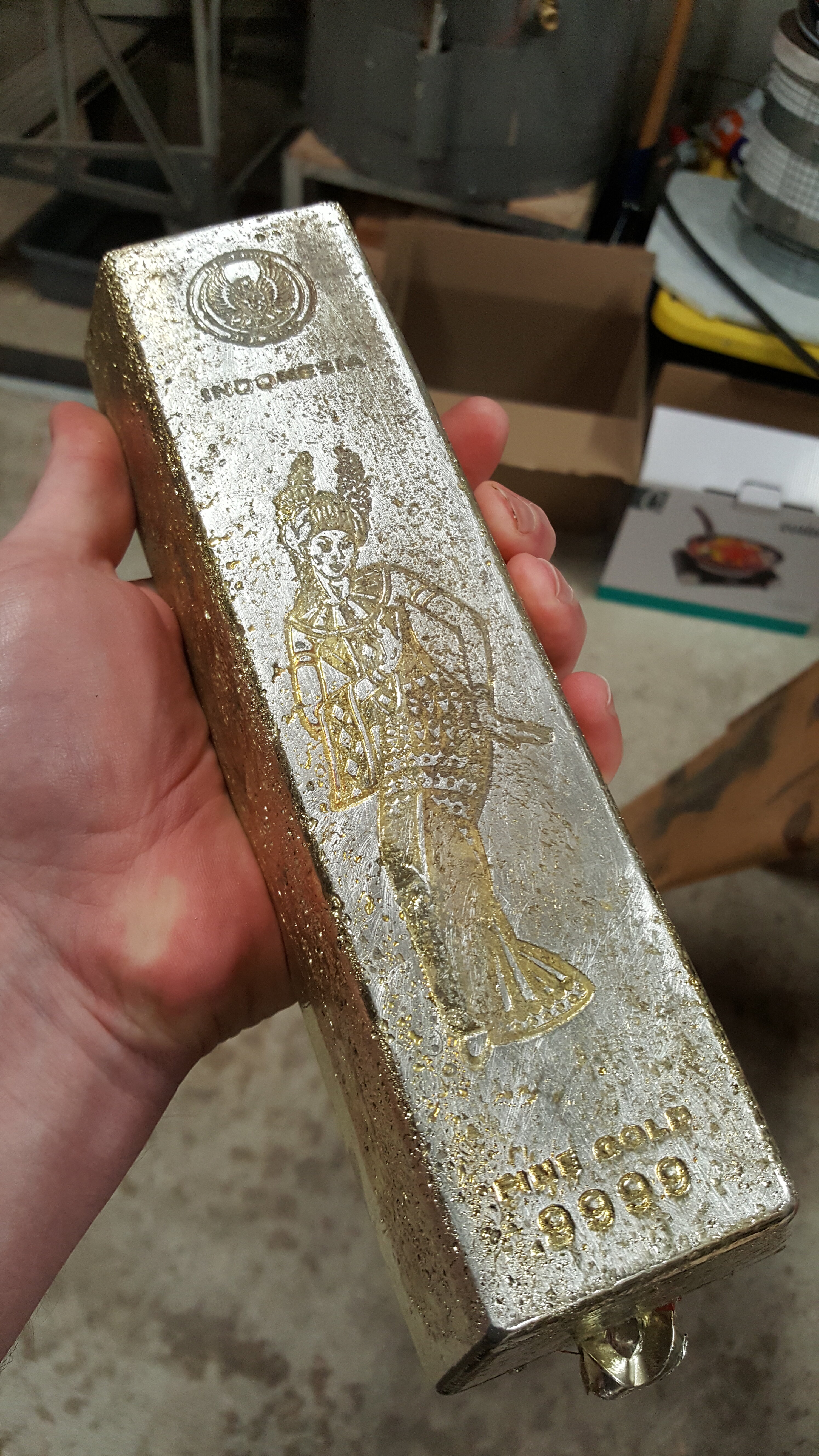

First bar from the high temp silicone mold is out. This was done using pure tin. I got better results and the size is more accurate to the original prop, but I'm having issues with surface air bubbles. I'm thinking this was due do issues with the heat and air/moisture still in the mold. Next time around I will preheat the mold and hope for better results
