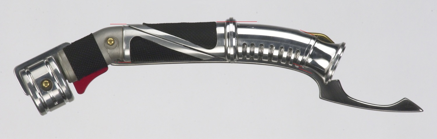

For some time now, I've been working on a Dooku model. There have been several idealized replicas of this prop, but I haven't seen any that capture all the wonkiness of the original. It's a bizarre prop, nothing is symmetrical. Nothing lines up. It has a real organic quality that I've tried to capture. Hope you all like seeing my progress
Oh. I'm sure this took weeks to machine. And it was put together with tons of love and care. But, if you're used to seeing an idealized replica like the MR, you'd be surprised how different the original prop actually is.
Take a look at the red lines I've drawn in this photo. You'll see how the lines from one section are completely misaligned with the next.
On the pommel, the base ring is thicker than the front ring. The recesses in the curved grip section are all spaced differently and measure different lengths from one to another. Then you move down to the emitter, which sits off-center to the curved grip.
Not slapped together. But, these peculiarities are what makes the saber interesting to me, and sets it apart from all of the replicas out there.

Actually it's more complicated than that. The AOTC hero, which I'm modeling and have posted pictured above, was reused and chromed for ROTS. But, there also appears to be a couple different ROTS props created, each with subtle differences in proportions and details. They also created dueling sabers for ROTS which had a straight grip section, where the hero bent.
Thanks for your support, everyone. I spent the last day or so redrawing the silver-painted knuckle section from scratch, because I wasn't happy with the part I had. It's quite a difficult part to model (well at least is was for me) but I'm pretty happy where I've got to with that part now. Again, it's asymmetrical, it's unbalanced, and the holes aren't centered. But, I kinda love it :)
