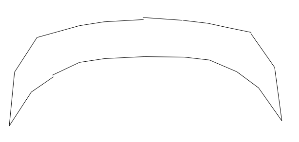

hey what are the gaps in the templates for? is it supposed to be smooth?
zoom in on the picture of a template from the shoulder and youll see what i mean
Yeah you will notice that from time to time. Just cut out the template just enough to make it work. It won't take away from the overall effect when using foam.
What I did, especially for the torso is just cut out the right hand side pieces and then flip them when tracing to get the left side. When you start making the back you'll notice that one sides pieces differs from the other. Pick the side that looks easier for you to cut out and do the flipping method for the stencils. It will save you a lot of time.

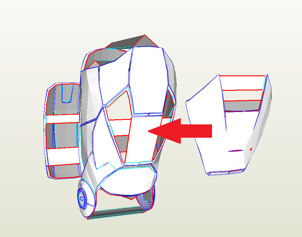

can i see what the back of the biceps on your suit look like? im having this problem where one piece doesn't fit into the other
This kinda shows the back.
Make sure you don't have the separators on. The parts that hold it together when making it out of resin and paper. They fit just right when lined up correctly.
This shows them better
