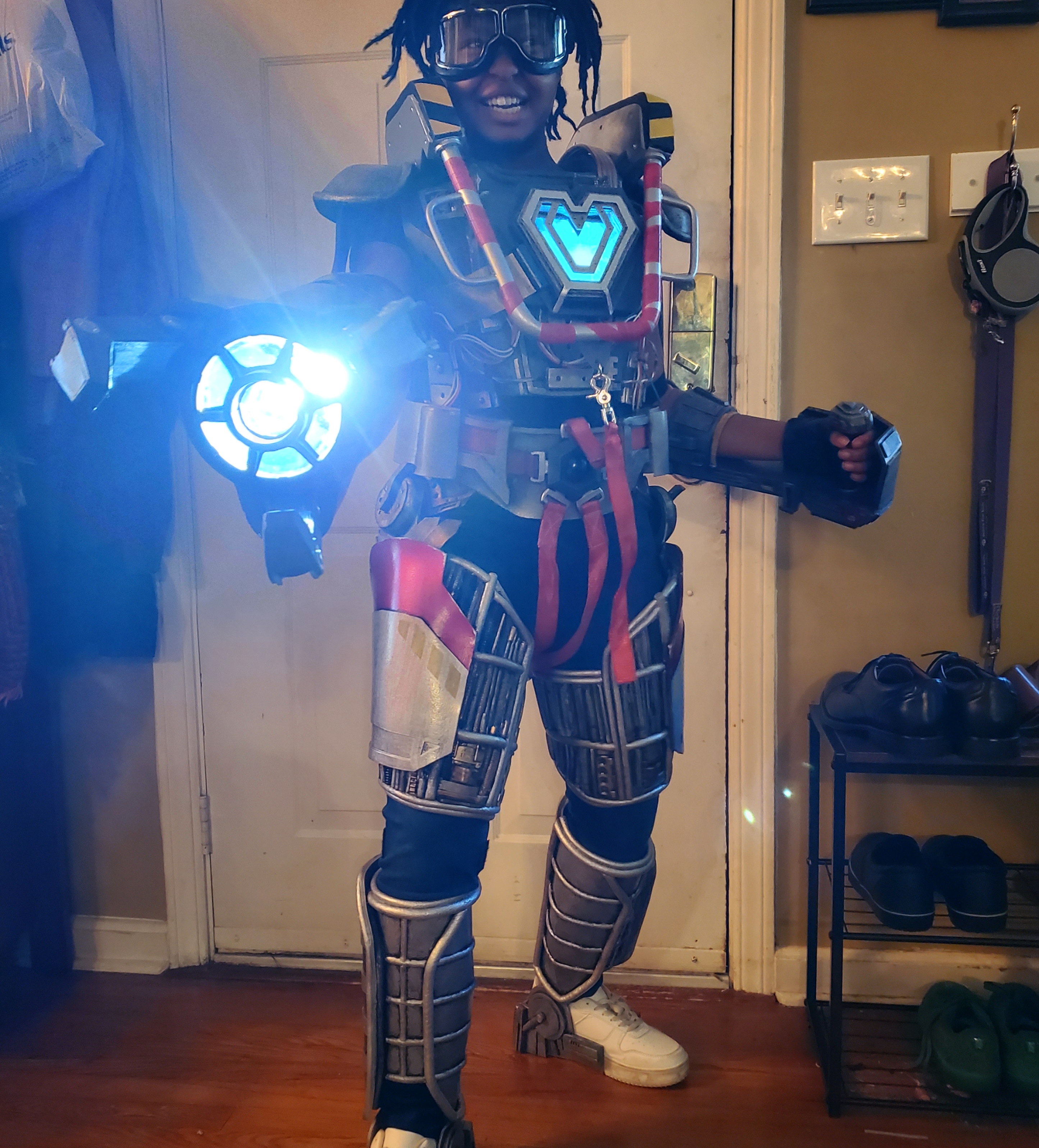

My 12yr old has pulled me back into a Marvel cosplay build. This time it's all about Iron Heart showing up in Black Panther 2. When I started the build there were VERY few images/art of this character from the upcoming live-action movie/series. I've captured as many reference images/videos as we had during the build below.

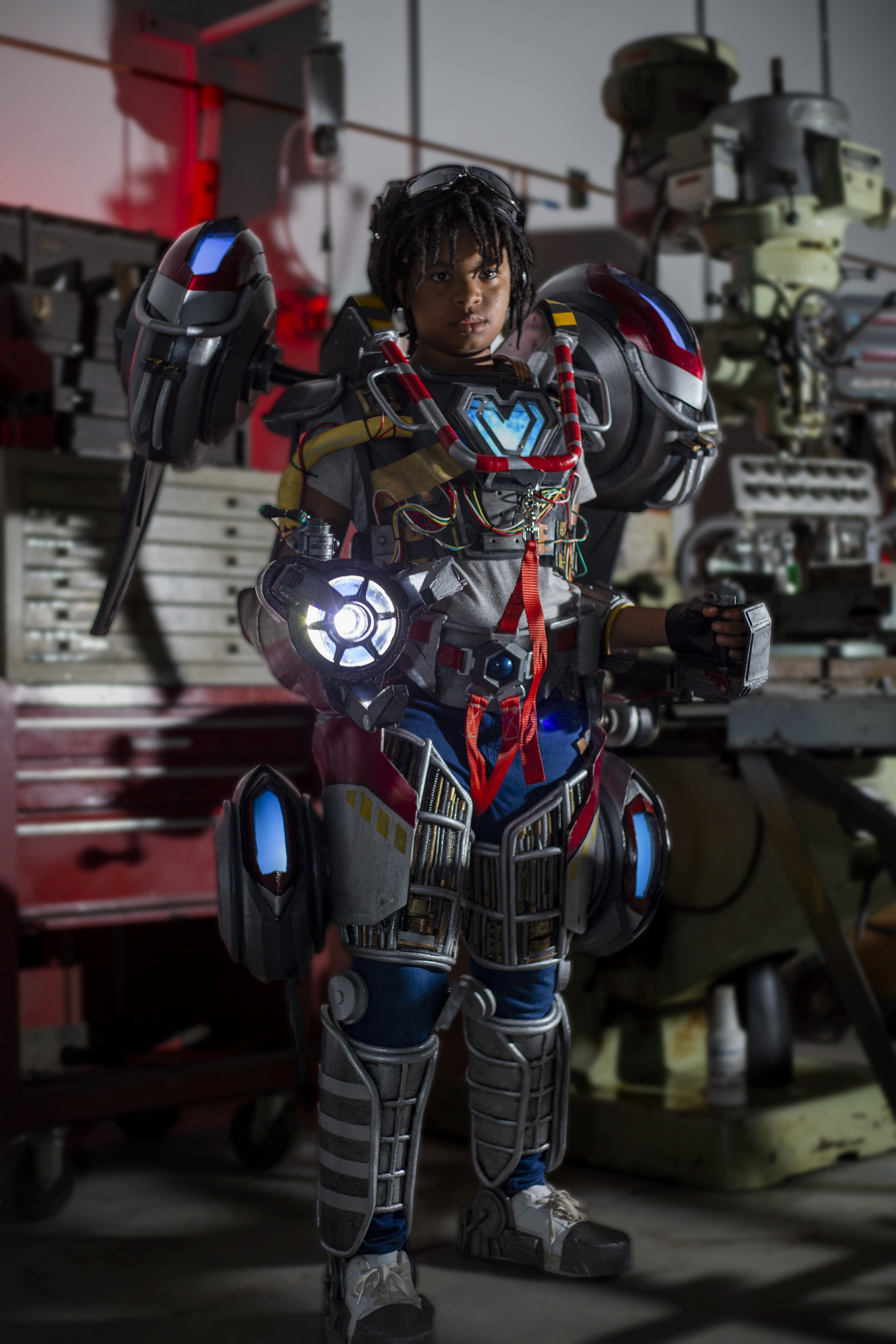

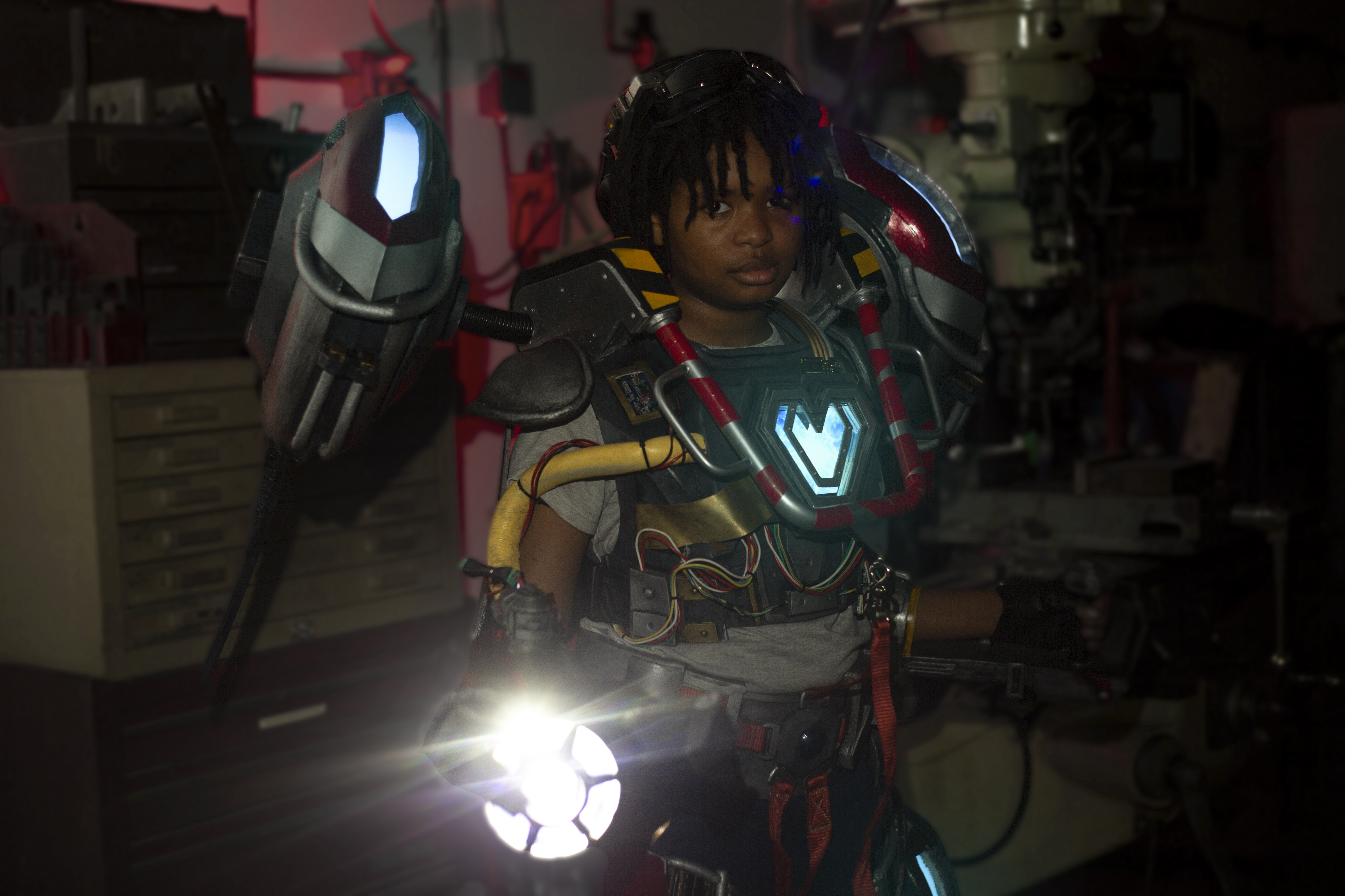

Here is a look at the finished suit!
It looks like the character, Riri Williams, starts off with test sections of the suit she builds at MIT (shown in the Black Panther 2 character art). This is the version I'm building for my 12yr old.

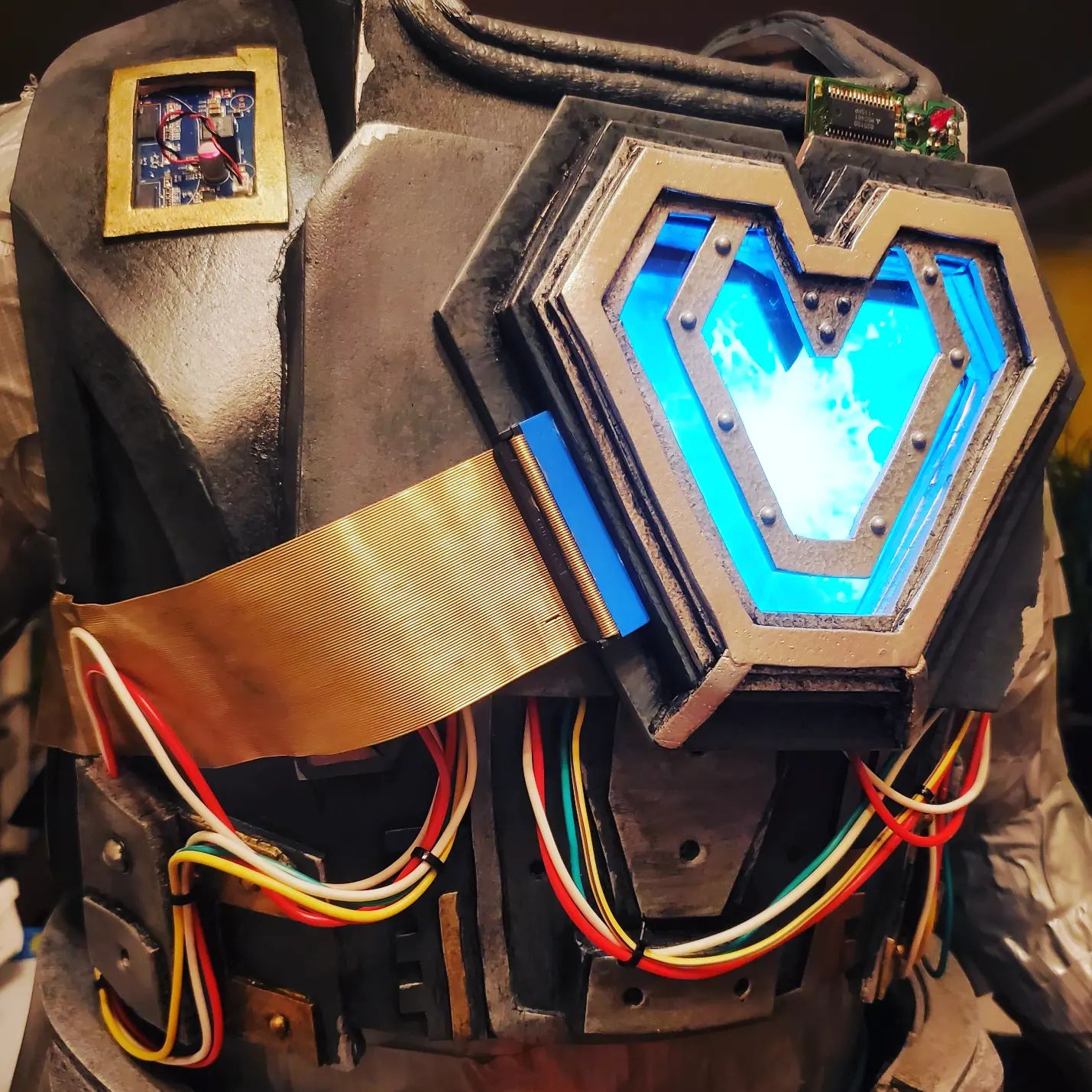

Close-up of the Arc Reactor - which is off-center (to the left - over her heart)

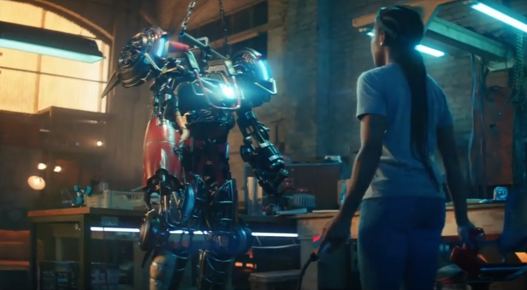

In this teaser ad (a guess a longer one is coming out on 10/14), we can see Riri working on her MK1 suit at a workbench. Looks like one of her thruster packs is on the table.
Then we get a short clip of the suit at the waist level. Things of note: The red bands on the chrome bars is clearly red electrical tape. That bar has a (not very secure) clip attachment. lol The 'data cord' coming off the Arc Reactor is GOLD (not yellow), and but the yellow (insulated) pipe heading from the Arc Reactor to the cannon looks to be yellow-ish or cream-color. She's also sporting goggles that look like Falcon's vs the bigger goggles in the character art.
Also, the lower of the frames looks to show off her left arm armor.
And, finally, She walks away from some drawings and we see one of her thrusters again on the workbench.

Also... my 12yr old has officially picked the MKI as her cosplay (or Halloween costume). So, I'm going to start diving into that build - starting with buying the goggles. I've found a pair from Amazon, and while they aren't an exact match to either the artwork drawing or the Funko, I think they'll work.
I started to fabricate parts of the belt, by 3D modeling the 5-point buckle/harness. I've got some old red tie-down straps, I'll use for the harness, but the buckle seemed easier to model than fabricate. Below is the model, that I then printed.
I did some sanding and filling. Then I primed it before hitting it with some gloss black, and then chrome (specifically for the buckle clips).
I then masked those clips and hit the main body of the buckle with a dark flat grey... next up will be ot paint the release button blue.
I also scratch-built the rest of the belt from EVA foam I had on-hand.
Once I had heat-sealed the foam, hit it with plasti-dip, and some metallic paint, it now looks like this:
I also started playing with how to do the exposed mechanical sections of her leg armor/suit. Some 1/2" foam insulation and some Dollar Store decrative tubing, doesn't look half bad once painted and distressed a bit. I will definitely want the paint color to be different for the cabling and the framework, but I think this method of fabrication and these materials will work for a very affordable solution.

Worked up the hip connection point and lower leg armor...
Here the final pieces of the upper and lower leg armor before sealing & painting...
For reference, I use the following method for EVA foam builds:
SEALING - Heat gun to close the cell (when possible)
PRIMING - Plasti-Dip (min 2 coats) + Adhesive Promoter
PAINTING - Base coats of main color followed by blackwash for distressed pieces
Here are the leg units in my 'painting tree'... since I don't have a painting space in my workshop.
Then (after another coat of plasti-dip and Adhesive Promoter) I hit them with a metal base color.
I then mask out and paint any other solid base colors...
From here I'll texturize and give it a 'lived-in' look with a black-wash. I use fabric paint thinned with water (if necessary). I'll point pics of these once I'm finished with that process. :)

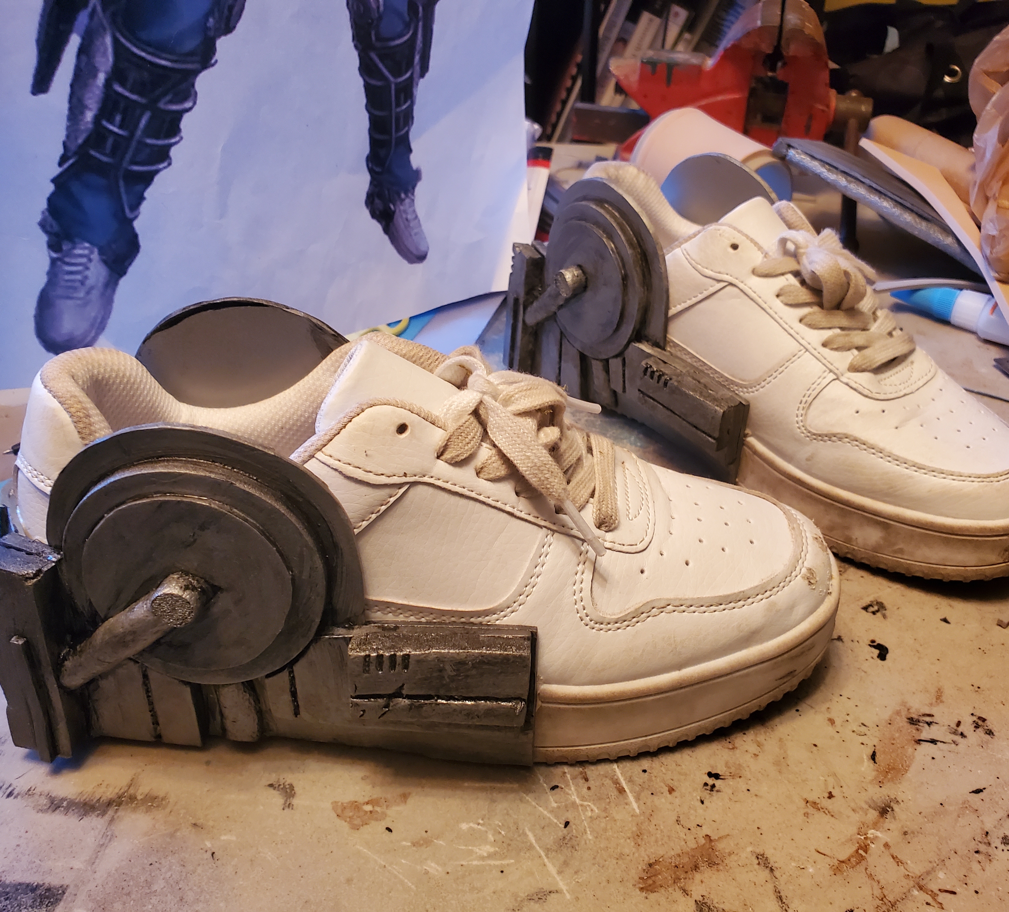

I also worked up the MK1 ankle pieces.
Sealed and Painted... But not yet attached to the shoe.
finished up the leg armor...
And the shoes (including making the new white shoes a bit broken in).

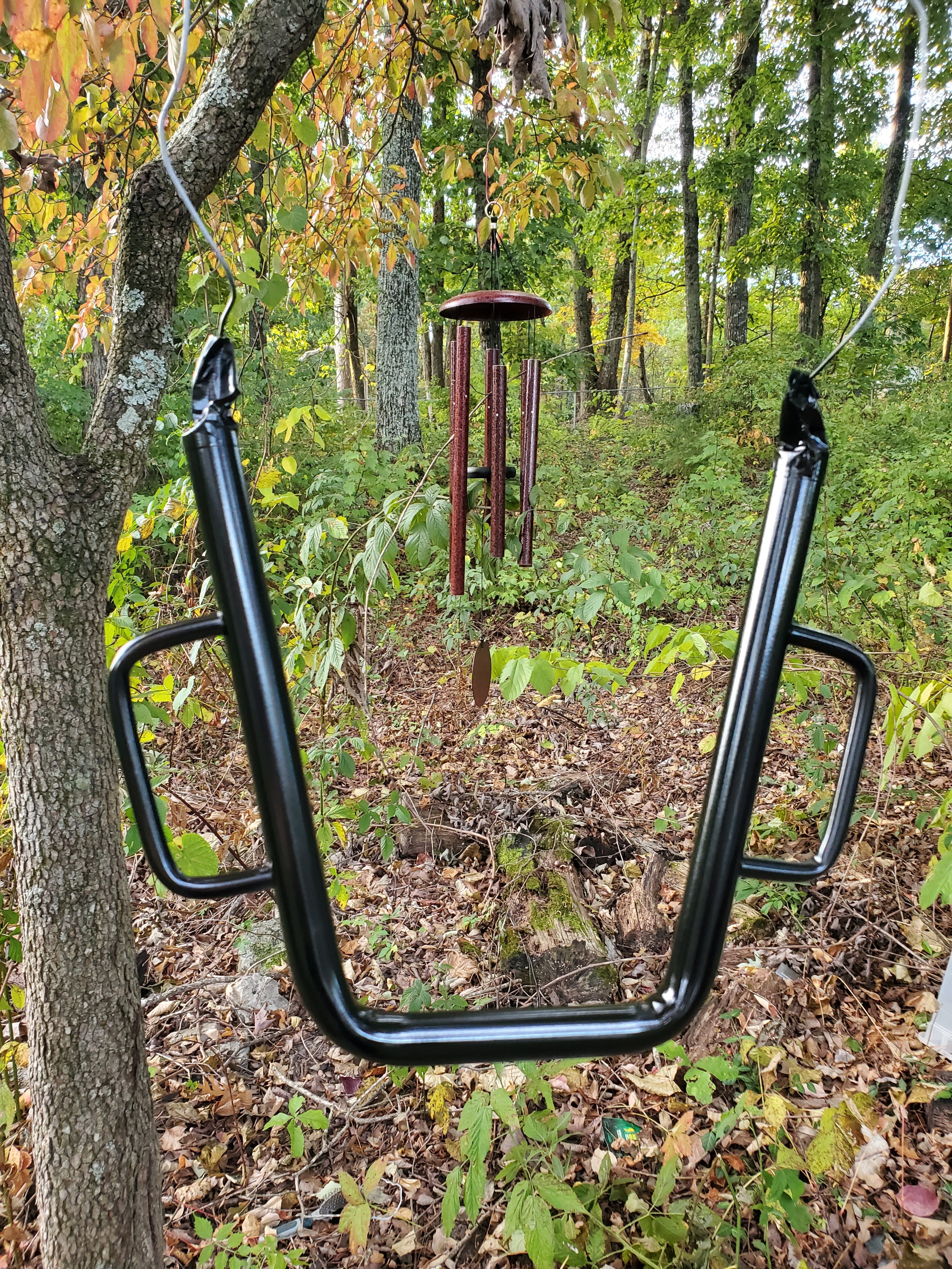

I've started on the chest armor. First off is the roll-cage - which is made of PVC (which I heat-bent) and some plastic tubing for the 'handles'
For best chrome results, hit your item with gloss black first....
More progress...
Using the new Target Ad footage, I matched up the safety bar latch.
Here is a pic (pre-painted chest piece) of my kiddo in the top of the suit. :)
I then did some sealing, priming, and painting of the chest armor.

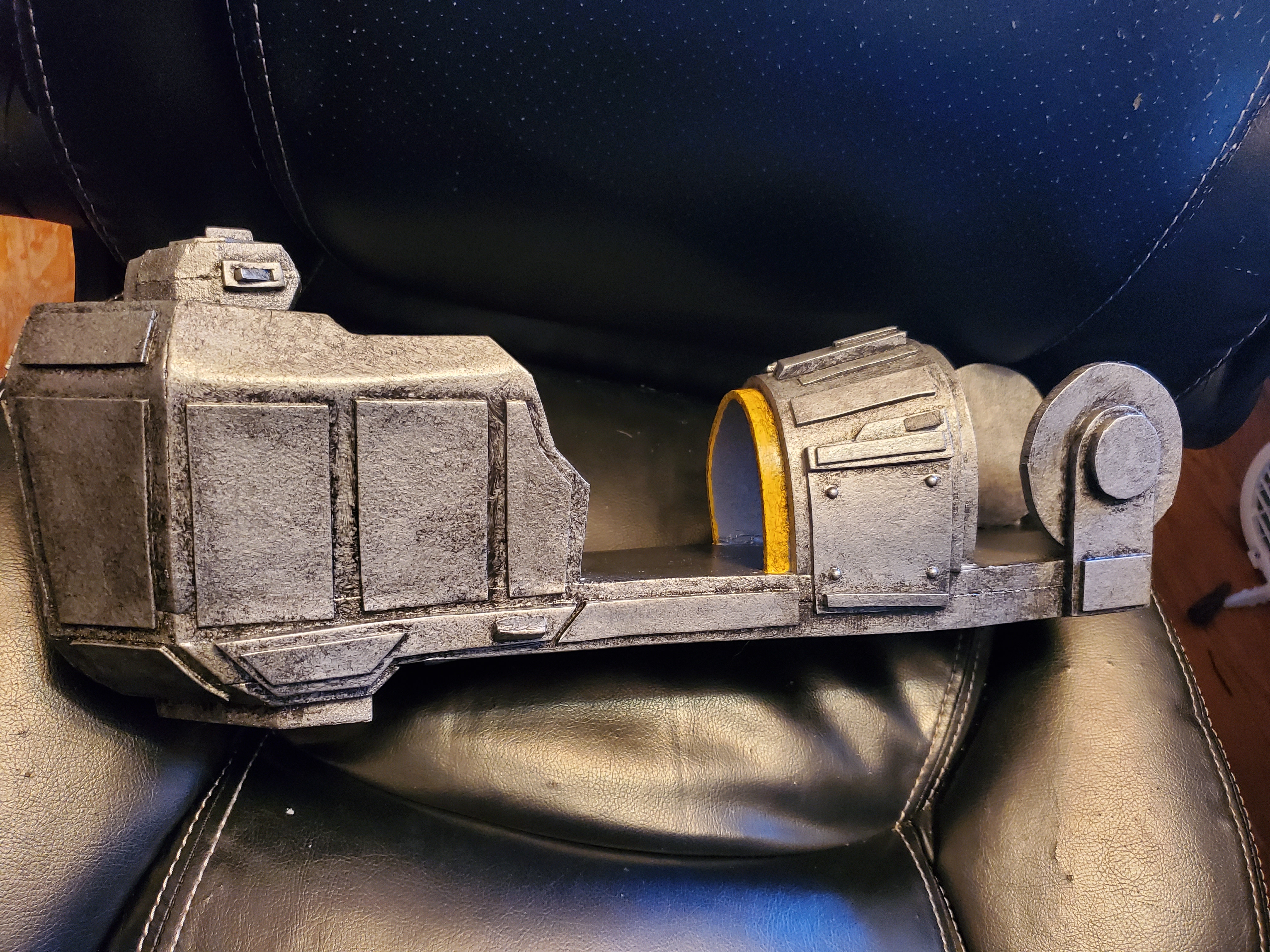

I've also worked on the Ironheart arm cannon...
I got this painted as well...
And I've also worked up the joystick arm...
More building coming up this weekend!
I'll shoot a video of the set up, but it's very simple... 7" tablet running a continually loop of an animation video I built in After Effects. :)
Kind of hat I thought, I put together a tablet on the front + camera on the back chest rig for a halloween costume a few years ago, a VERY good gimmick to simulate a large hole in your chest :)
