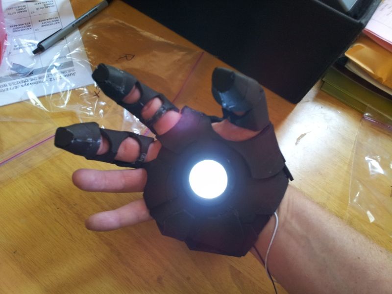

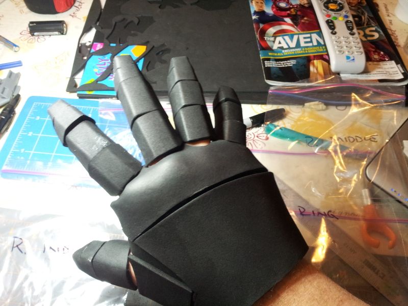

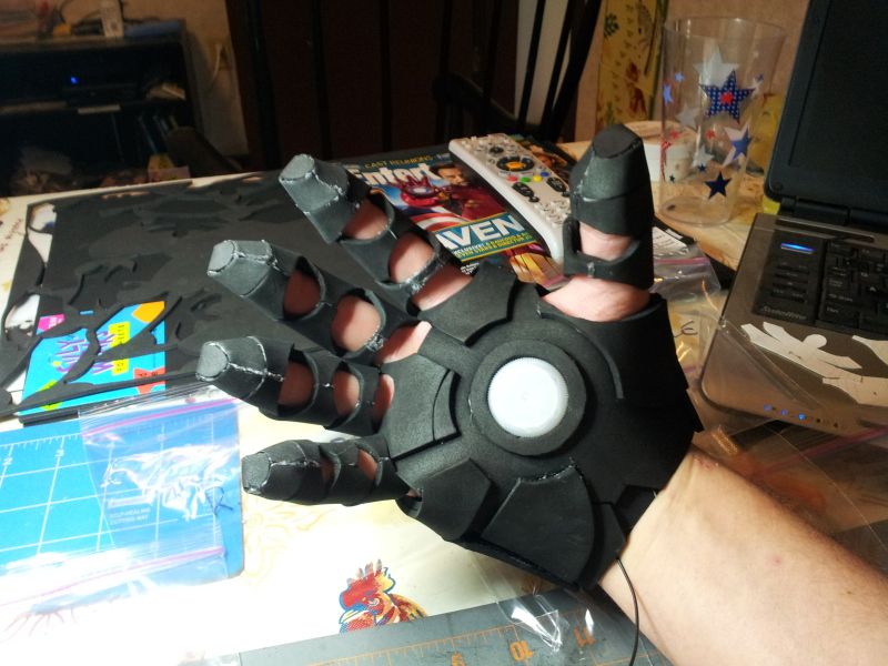

Wanted to share my success with j0wE's hand file. As is the case with ANY of these files, there is a bit of tweaking that needs to be done to fit correctly. I think this is especially so with the hand. After failing miserably on my first attempt, I was able to successfully complete the right hand. Each section for each finger had to be custom trimmed and fit to my hand. I had to reduce the "hole" where the finger goes on some and enlarge them on others. But, I think the end result is worth the effort. I shudder just thinking about having to do these with the original Pep files. :eek I will go back and clean up the glue areas before sealing.
The repulsor is made from a 9-LED flashlight from Dollar General (2pk for $4) and the top of a bottled water bottle. The light is currently running off of the flashlight's 3-AAA battery holder.
Awesome file jowe!!! Good effort mate. I was wondering, what are people using under the glove? There's bits of finger showing. I've never seen this attacked before. Any links to any finished gloves? Or any suggestions?
