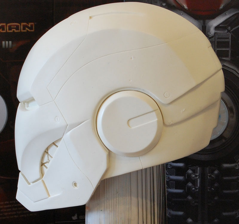

Here's the first cast.

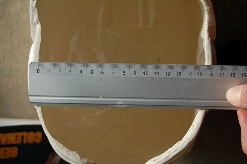

From side to side it's 15.5 Cm (about 6.2 Inches) The helmet is way larger at ear-height.
I've been able to slip the helmet over my head much better, compared to the previous casts (pulled from former molds). If you still have troubles, you can cut the back part easily. The ear can be cut fairly easy ;)
But anyways, I think most of you guys should be able to slip it over. The urethane plastic is a little flexible and that makes everyhing easier ;)

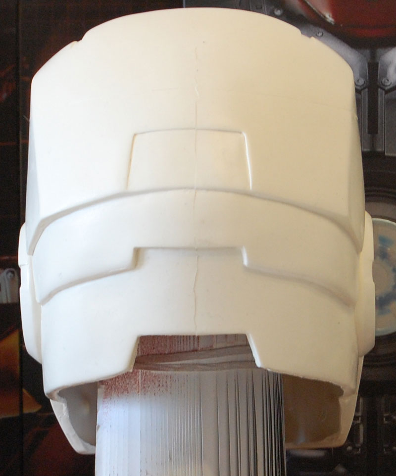

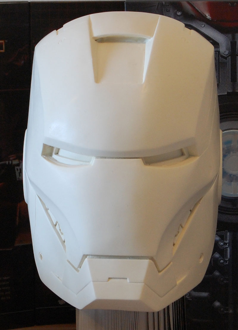

Here you have more pics of the first pull:
Actually it has some minor flaws, but I had a little problem with the rubber mold...I didn't put it well in the plasti-paste mold :D
p.s. the new mold has the line that goes from the ear to the bottom of the neck of the helmet, which the previous molds didn't have ;)

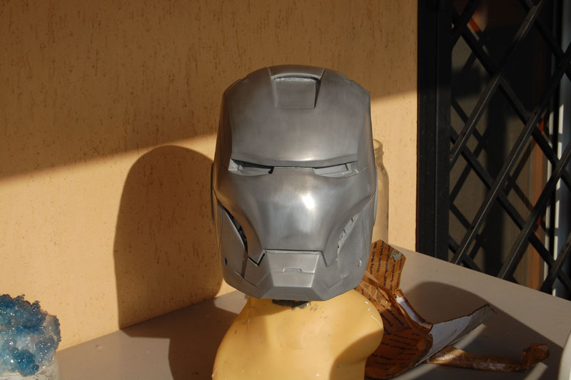

What resins and metal powders did you use to cold cast that last helmet? it looks awesome. Will it be able to take on a mirror shine finish like the MK II or is there not enough metal surface area for that?
Re: Iron Man Helmet Sintra V2.0 (V 1.0 lays in ruins)
That looks Great, keep on wirewool the piece. Dont put any clear coat or spray anything on top, it will dull it down. Keep it as it is.
The finish of the coldcast will not look like a mirror finish. The orginal was chromed and then wirewooled down. However i like the finish of coldcast better than chrome. It looks more industrial.
