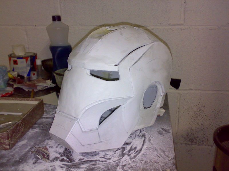

still needs a lot of work, but the base is 95% done.
It's all made of forex (european word for sintra), and it's been a real pain in the a**.
The faceplate was made 5 times, the part the covers the cheek, was too short, so I had to redo it, then cut the old one and glue back in the new one...
THe really good thing is that it fits a 7 3/8 - 7 1/2 head really good and it's really a small helmet. IF you put it on with no armor on and only a shirt, just looks like a regular human head ;)

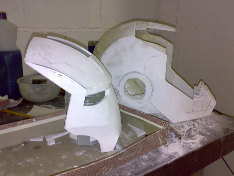

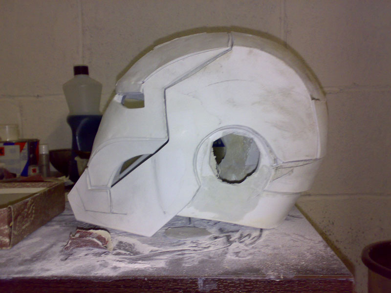

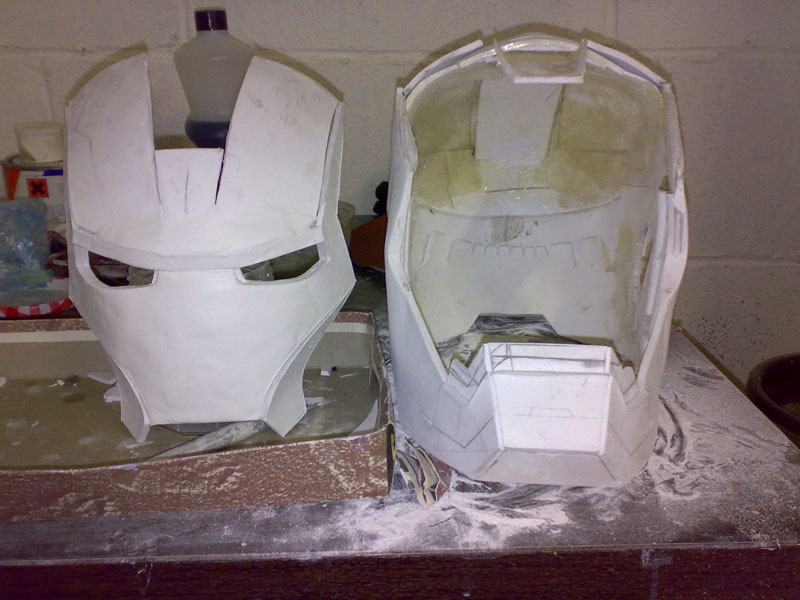

and here you have some pics of the early stages:
sorry for the huge pictures...

Yep. I'll probably fiberglass the entire thing from the inside in order to give it a tougher structure. I'm still thinking on how proceed to make a perfect match between the face plate and the rest of the helmet. I don't want to do the whole piece as a unique object.

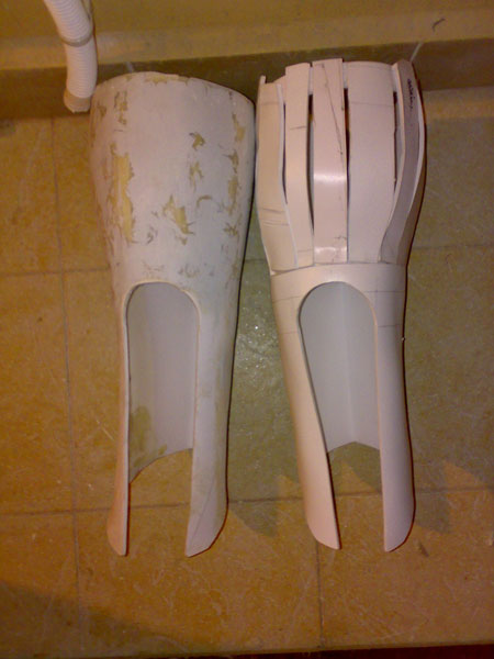

Usually what I do, is create the structure with the forex, then sand it in order to smooth as much as possible the different angles and bumps. Then I get to the fiber glassing process. But I try to use it as much as possible from the inside, in order not to have the fiber altering the height of the forex. Once I covered all the holes and I linked together all the pieces that were held together only through a piece of cardboard, I get to the bondo or body filling process.

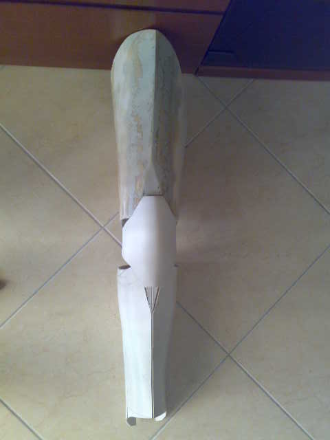

and for the clone armor parts:
Re: The Magic of Forex (sintra): Iron Man Helmet

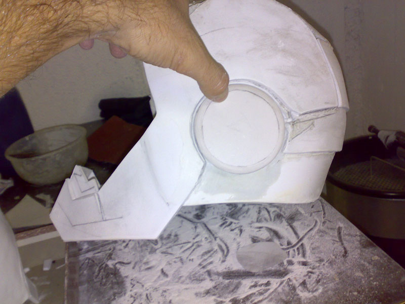

I started to put fiberglass on the inside and on other spots.
I also put some filler on the sides, right next to the face plate and I beveled the round parts that cover the ears.
This is going to be way harder than I thought. :(

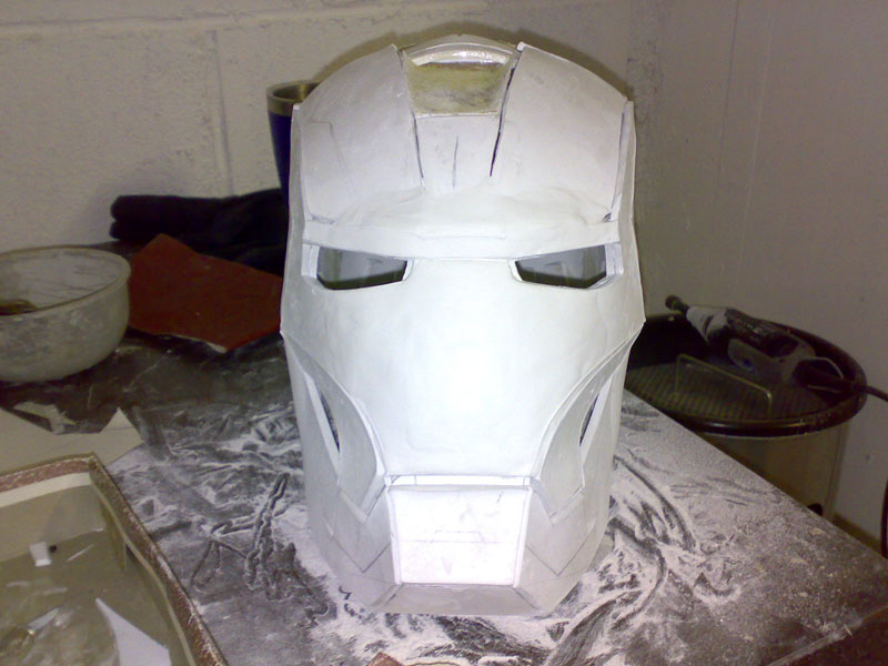

Ok, here we go: few other pics:
As you can see from the first pics, I added the bump of the nose (still needs sanding).
Also, not pictures, I filled the back top part with bondo and tomorrow I'll sand faceplate and that one too.
I also put some fiberglass inside the faceplate so that tomorrow I'll be able to body-fill the outside of the plate.
All along, it's coming out pretty good. I'm pretty satisfied :D
