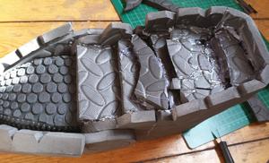

To build under the shoes I buy cheap flip flops and layer them underneath and use shoe goo to attach. They are already made for wear and tear and start with a good shape that can be trimmed.
That's a great idea actually. Thanks for the input, hadn't thought of that at all but picked up a couple of pairs for a pound each yesterday to give a try with. Do you think hot glue would hold it well enough or something more dedicated (like the shoe goo) would be required?

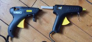

First off, my glue gun died, long live my glue gun.
The plastic sheath at the back came loose and over half of each glue stick at least was vanishing inside. I tried to resurrect it by getting as much glue out as I could but ended up just burning myself and getting the glue entirely through the trigger.
New one is working fine at least.

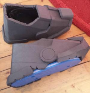

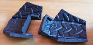

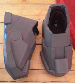

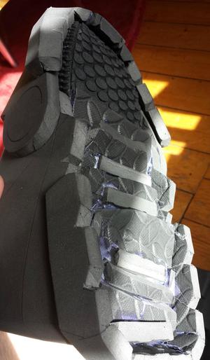

The boots are done as well. I went with the flip flop idea in the end and it seems to have worked out great. Cheers for the suggestion. I put together the shell of the boot then added the shoe in. I held it up at the heel with set of foam inserts all at an angle then filled in the gaps with smaller sections of foam.
The general idea was to try and get as level a surface at the bottom to then connect the flip flop to it. I thew a ton of glue in there as well from as many angles as I can to try and hold it all together. In the end I think there's around 10 full glue sticks in there so it should hopefully hold together pretty well. After each batch of glue I stood in it while letting it cool to make sure it was under the kinds of pressure it would be when I'm wearing it. Seems fairly sturdy overall.
I've been wearing them around the flat to get used to them and they're actually pretty comfy as well. Really had a lot of fun making these and it's a pretty cool piece even if people wont really be looking at the feet so much.

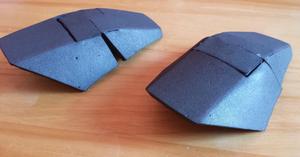

Done more work with the repulsor setup as well. I've got the back handplates made now.
The plan is to set up a hinge between the two parts and have the switch controlling the repulsors turning on and off mounted in there and dependent on the angle of my hands. I've been doing some work on the circuit itself as well. Basically I had the torch from poundland/world and got the LEDs off it but I wanted to put a delay in to it. The initial circuit plan I got from a quick google for ideas (circuit diagram and some details here: http://pcbheaven.com/circuitpages/LED_Fade_In_Fade_Out_Dimmer/ ). It didn't quite work out though and I had issues with the dimming working at all. First lesson, always read the details that come with the circuit diagram.
