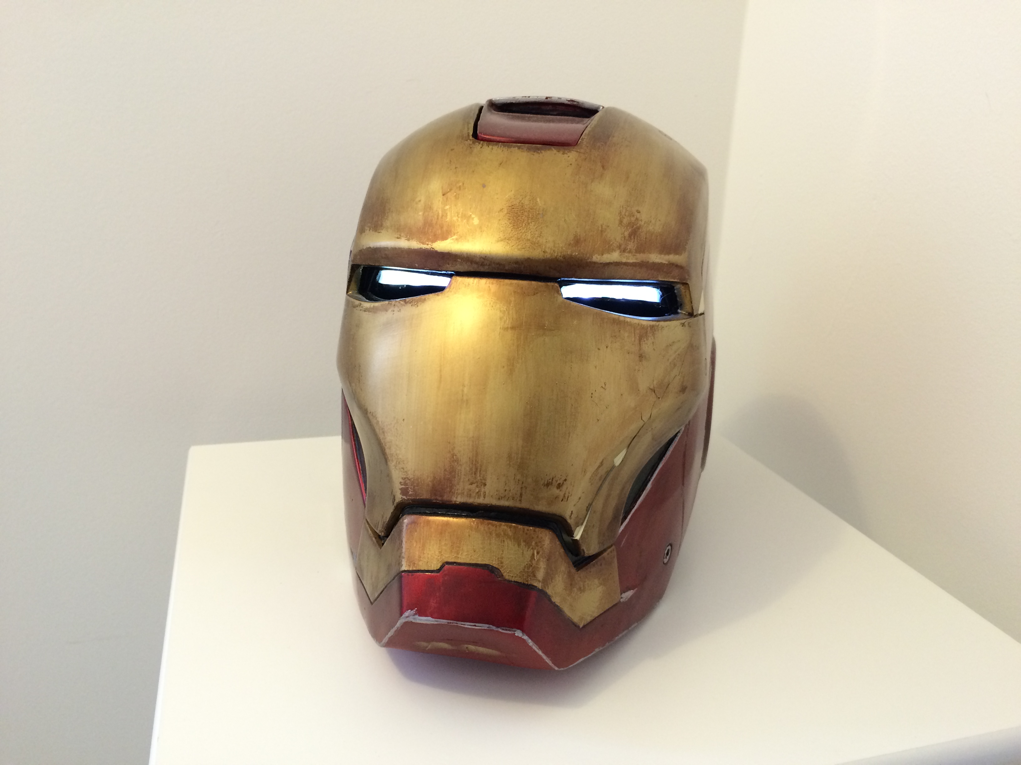

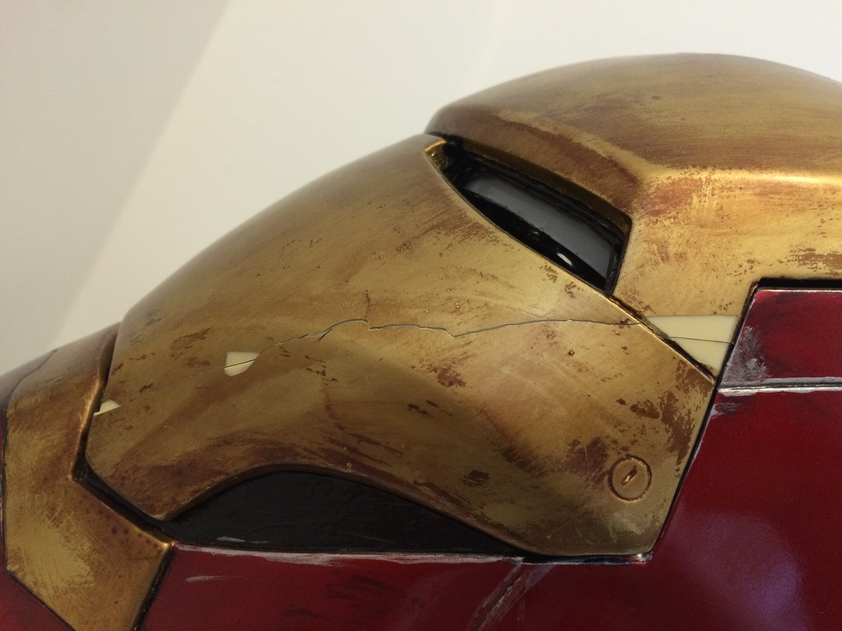

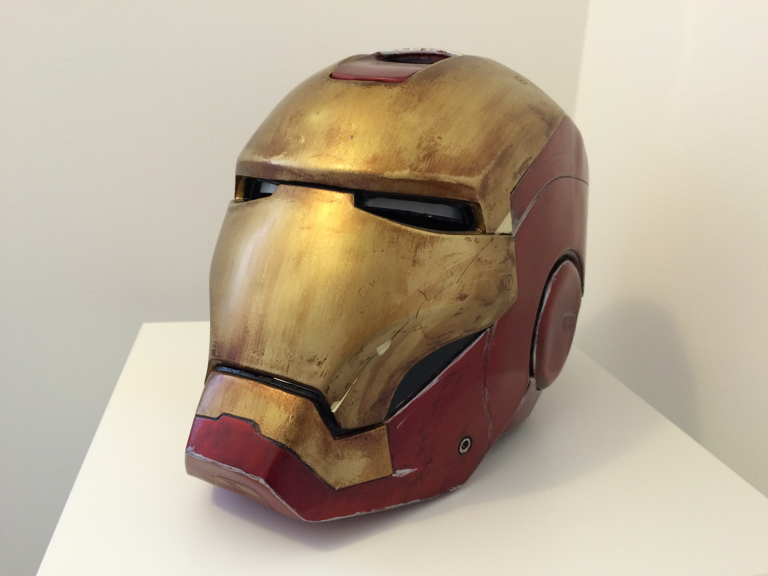

I bought this awesome helmet a few years ago from a guy on eBay, and it survived many trips but one day a builder working in my house cause a damage to its faceplate (see photos)... :-(
It has the battle damage look, but I didn't want REAL damage...lol
I am not good at all with building or fixing props/replicas, especially fiberglass or resin ones...so my question is: do you guys and girls have any suggestions on what I can do and/or buy to help me fix the damage? :)
Any feedback will be highly appreciated.
Cheers, regards.

i see it like this: take dremel, carefully work with damage places, than take polyester putty and make 1-2 layer. than try to make it nice and smooth. than primer and paint. if you try well - it takes 3 days max.
p.s. if this split not only inside, but in the outside - you will need polyester resin and fiberglass too.
Cheers.
Many thanks Jmen, I will try to do that...thanks. And to paint the faceplate all over again, which type of paint do you recommend?
Have a good day.
hmm. if you will use 2k bondo (polyester putty) - then better 2k primer. then - acrylic paint. by the way, its better to use airbrush for paintjob. for primer - it does not matter. (airbrush or balloon with paint). for me - i wait nice and warm weather for my projects. all materials and stuff i have, so wait for a warm days. after paint will make a post about paintjob. if you have some question - ask. i will say all i know)
hope, it helps.

I agree completely! from how it looks in the photos it looks as if its almost cracked and broke a section of the faceplate off so unfortunately Im afraid you may need to use fiberglass cloth and resin on the inside to re strengthen it :unsure. I would work around the broken area with a dremel to clean it up a little and then use the fiberglass on the inside once you've realigned and straightened up the broken area to keep it in place and give it strength, and finally use the putty or possibly a light coat or two of body filler on the outside to fill the crack and of course a lot of good old fashioned sanding once the putty/filler is dry and set to smooth it all back out before you re paint it! Good luck, I hate it got broke on you, I'm not the best in the world but ill give what advice I can!!
Oh and after thinking about it, if the face plate is removable I would make sure I tried to work on it separate from the rest of the helmet since the red helmet portion appears to be ok in the photos!! Id hate to see ya accidentally scratch that part or something while fixing the faceplate! Good luck buddy keep us updated with how its going!
