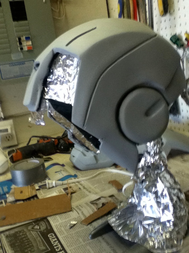

1. So I lined the edges entirely with tinfoil. I did this because I saw some other people do it their videos, and this is so you can extend the rubber mould past the edges, giving you more room to fiberglass up the sides on the finished product so you don't have any weak edges. These also came into play later (which you will see in another post) for a different reason.

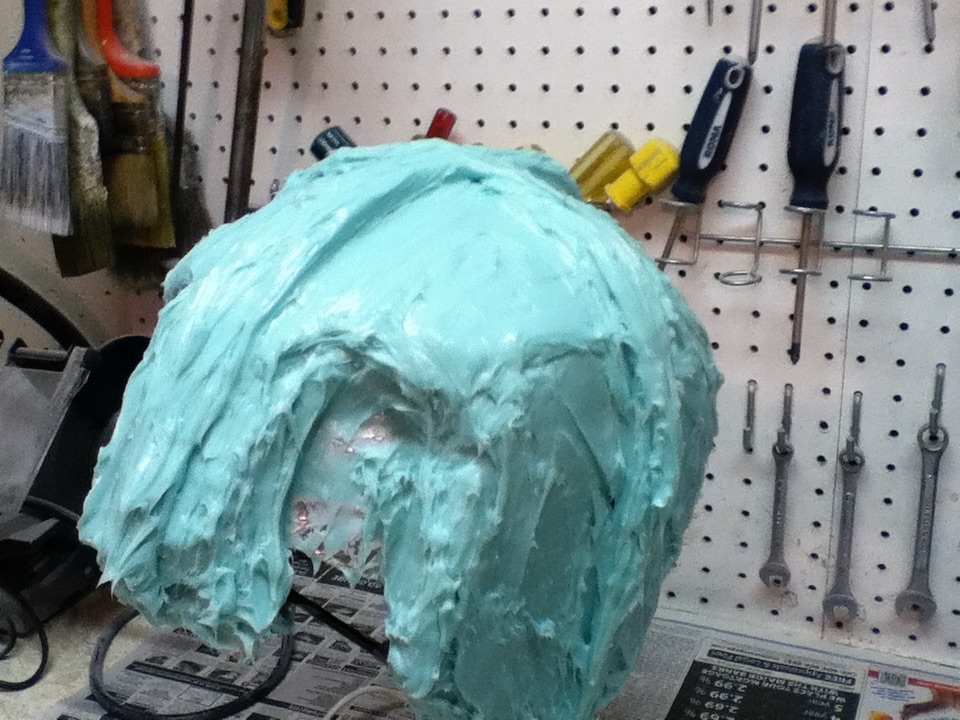

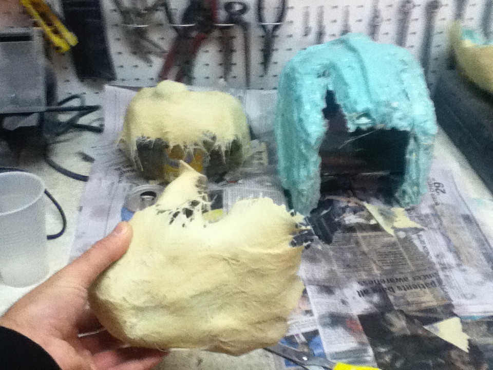

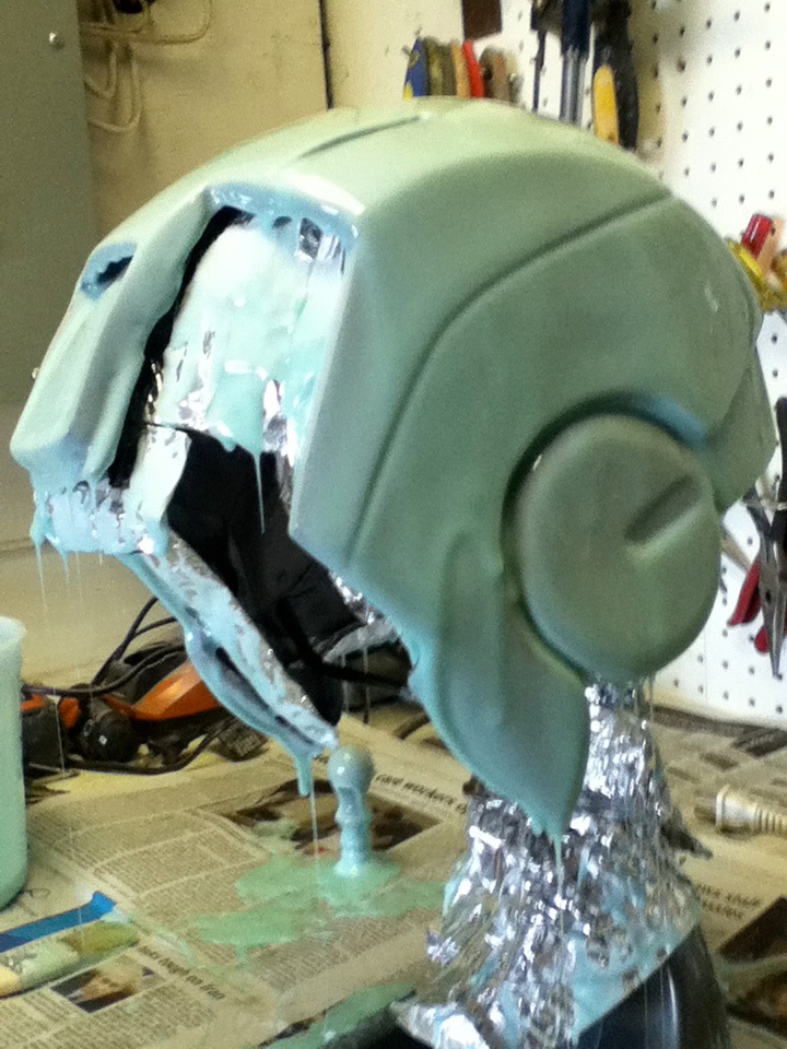

2. Once tinfoiled, I used my trusty drink mixer as a stand and then covered in Rebound-40. I was going to use Rebound-25 like everyone else but the store only had this. Again, knowing NOTHING about this process I was a little worried when they said it would cure thicker, but it actually worked out really well.
3. I did the next layer using the Thi-Vex II thickening agent. I broke my mixing stick on this step! Following a really detailed youtube video, I did two layers of this. The first layer was to cover the whole thing, the second layer was to do the edges and the keys (those lines that are sticking out).
Note: Those keys weren't enough. I actually had to throw away the original fiberglass shell, make a bunch of balls around my helmet with the silicone, and then fiberglass it all over again. I'll explain and show later.

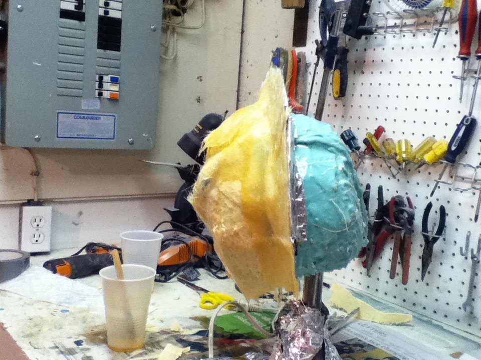

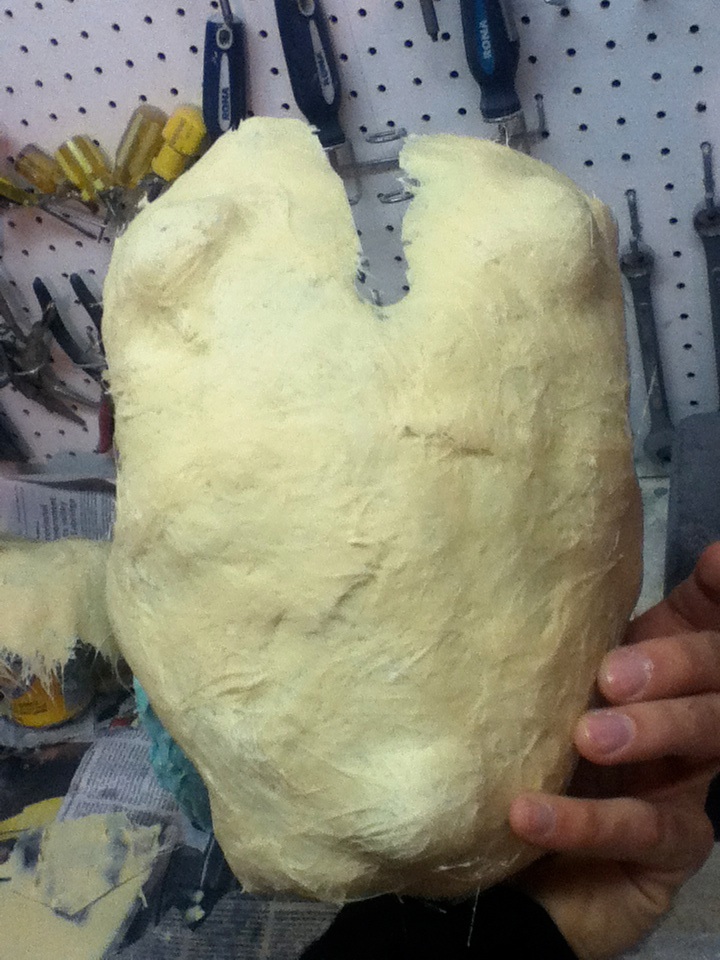

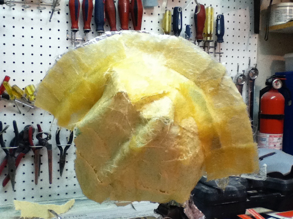

4. I then followed another youtube video and made the fiberglass shell (which was a waste BUT a learning experience). I had a friend help with the first half, and we didn't saturate the fiberglass enough. But on the second half I went to town and really realized the difference. I still went ahead with it and drilled the holes and clamped the two sides together.

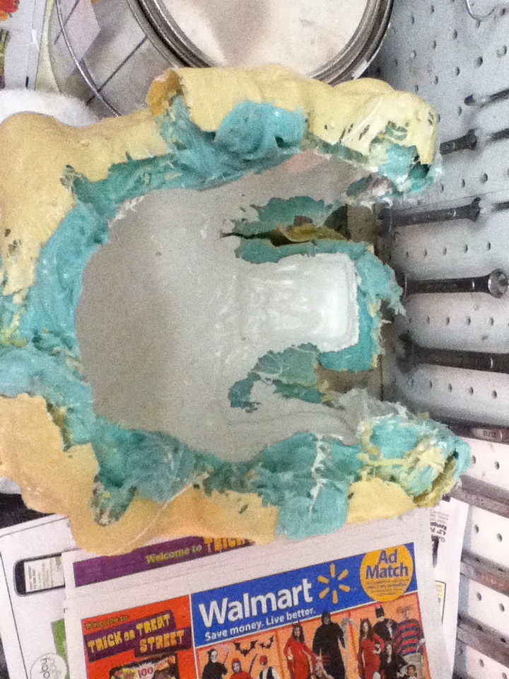

WHERE I SCREWED UP: So watching the full helmet mouldings on youtube, I saw some people cut their mould in half, or cut a line along the back to peel if off easily. Me, not knowing how hard or easy this hardened silicone would be, cut the line in the back thinking I needed to.
ADVICE FOR PEOPLE MOULDING/CASTING YOUR 4-PIECE IRON MAN HELMET: You don't need to cut that line. Because it's open in the front, you can just peel it from that direction. This stuff is actually pretty easy to bend (you can flip it inside out and it still doesn't screw up.. at least with rebound-40). So now I have a cut line in the back of my mould which will probably show up in the cast (hoping I can sand it or something). That's another reason I re-did the keys and mother mould, because I wanted it to fit even more snug and perfectly so I could try to close that line as much as possible. If it is at all loose, the cut line will appear even more in your casts.. or so I imagine.

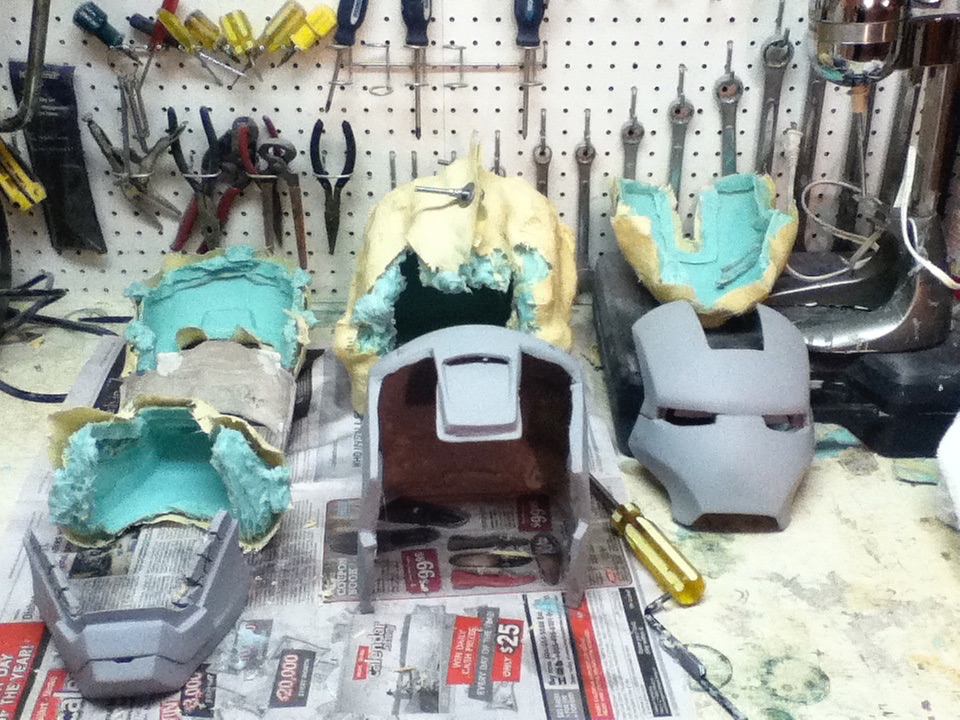

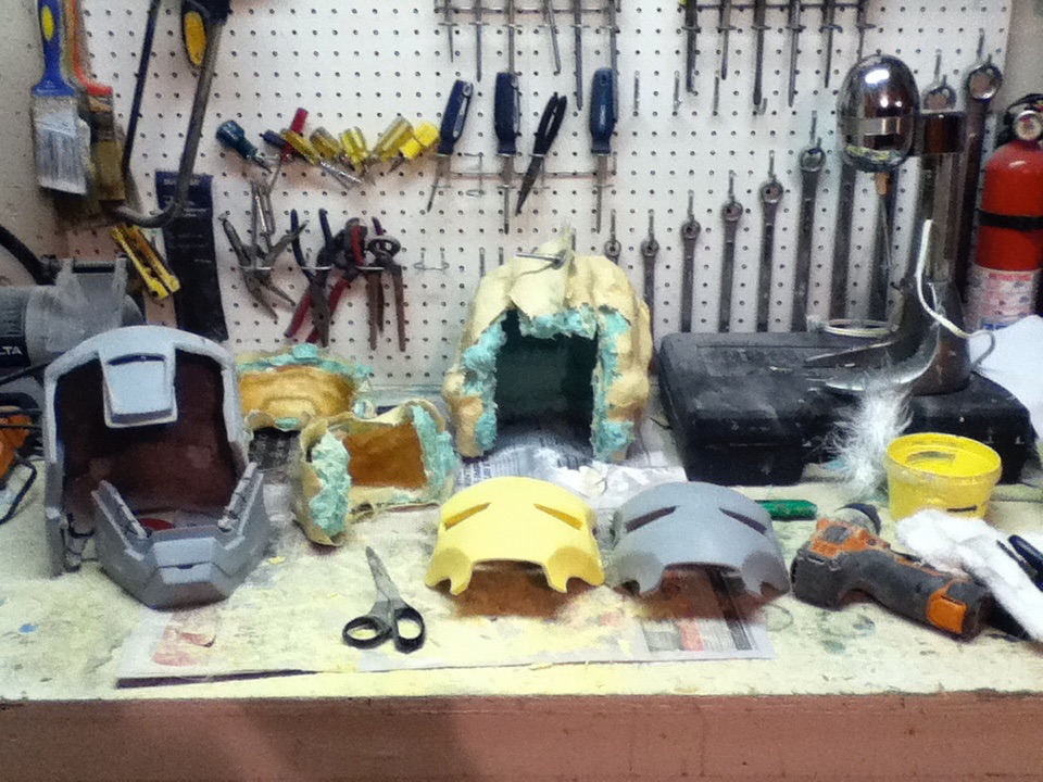

5. Here you may be able to see the difference in my shells. They are way better now as I did the other pieces because I noticed that my main helmet part was falling off the sides (as I didn't have enough keys on it), so I didn't take that chance with the rest. I also saturated the #&@* out of the fiberglass to make it super hard. That last image there is of the faceplate pulled out of the mould. I think it looks like it will work.
6. And here is my workbench with a bunch of random Iron Man bits everywhere.. and the drink mixer.

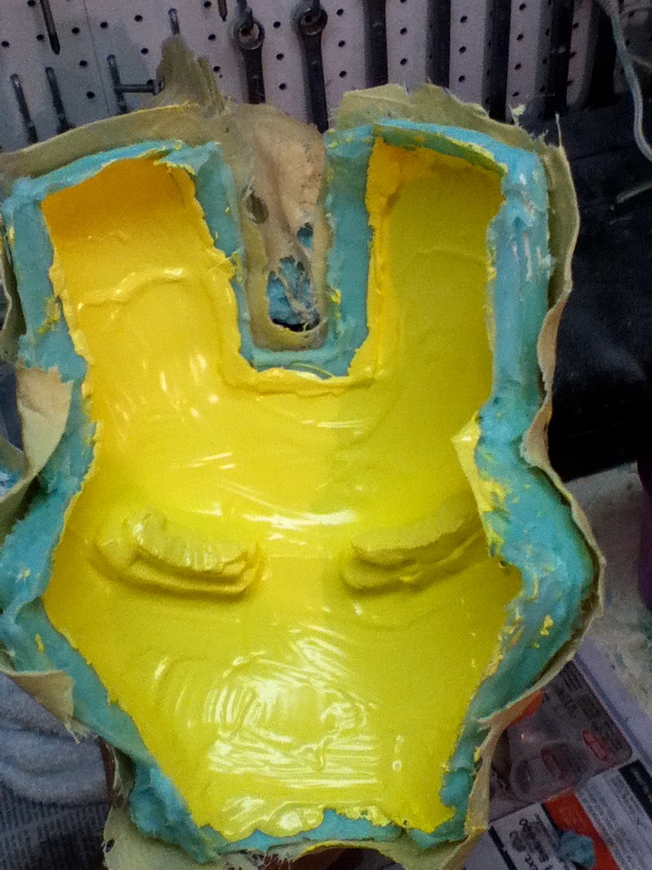

As mentioned in my last post, I poured the gelcoat into the face, chin and neck piece, hoping I wasn't screwing anything up. I was told I didn't need a release agent for these, and I was told I was. I was also told to lightly dust the mould with baby powder. I tried all these different techniques just to test out the differences. So far, the only difference I noticed was that there seemed to be MORE bubbles when I used the baby powder, but that could very well be for some other reason. Anyways... check out my pics!

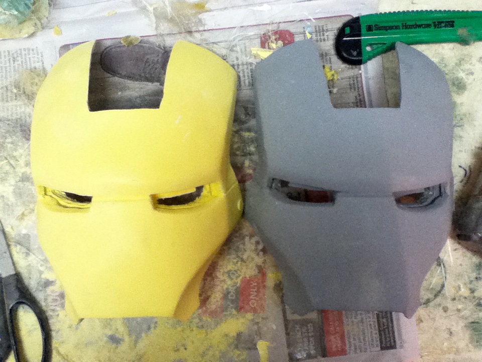

1. So here is the mould with the gelcoat in there. As I mentioned in the last post, I put yellow dye in this one.

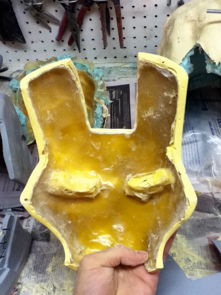

2. Here is the back of it after I fiberglassed it and pulled it from the mould. The resin I used was EXTREMELY thick compared to the smoothcast 321 I used when making the master copy and so this new copy weighs a lot more but it's a lot stronger. The resin I'm using now is just the regular bondo fiberglass resin you can get at Canadian Tire. I thought I would give it a shot and it seems to be working well. Only problem is that EVERYTHING sticks to EVERYTHING when you work with it.
3. ZOMG it worked! This is after I cleaned up the edges. It looks pretty spot on, though I won't be celebrating until after the main helmet is done and everything lines up. *fingers crooossed!*
4. Here is the chin piece next to the original. It actually looks even better and it's way stronger than the original. I'm quite happy with how things are going. Edging all of the pieces though is a b*#&h. Any tips out there??!
5. And here is a picture of the pulled faceplate, chin and neckpiece. They are actually looking and feeling very sexy.
6. Tomorrow, I fiberglass the inside of the main part and pull it, edge it, and FINALLY see if it all fits together.. so. extremely. nervous.
Any tips on how to edge these faster?! It's taking me around 25-30 minutes to edge each piece..
