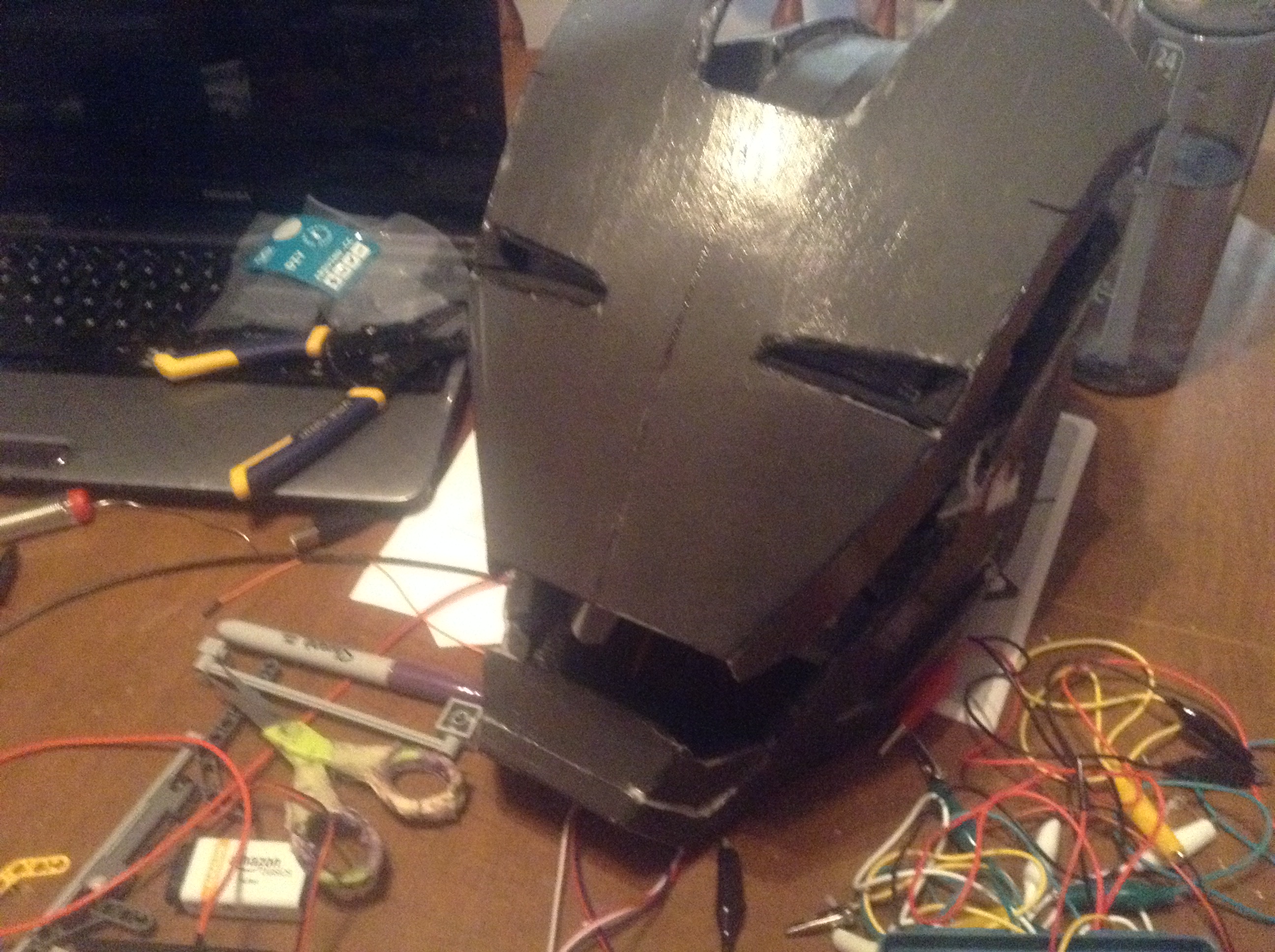

Faceplate:

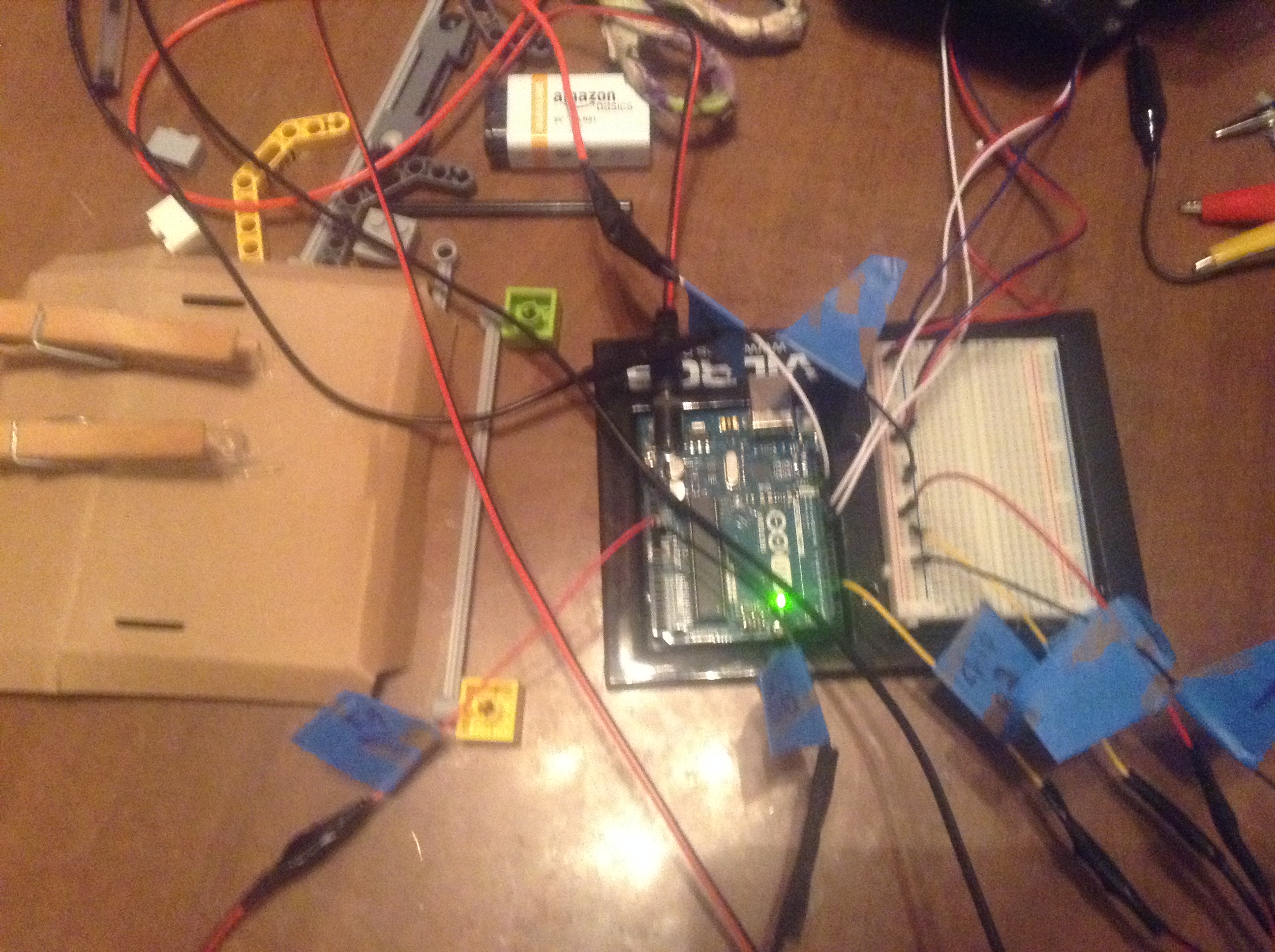

First thing I did was to follow this tutorial. http://www.uncannydani.com/makingstuff/electronic-iron-man-helmet/. It helped me to get the basics of my code in place and the arduino circuit set up properly.
Here's just a few pictures to show you the rough setup. The tutorial above is detailed enough Note: When I added more than one servo, I had to connect the 9v to the Arduino, otherwise the code wouldn't work. Also, the push button in the starter kit doesn't fit in the breadboard where the tutorial says to put it, so you need the smaller ones up above or you need to solder jumper cables to it.
Now that the circuit is working, I've started soldering everything together and taking it off the breadboard. Eventually I will be transferring the code to an Arduino Pro Mini 5v to mount inside the helmet.

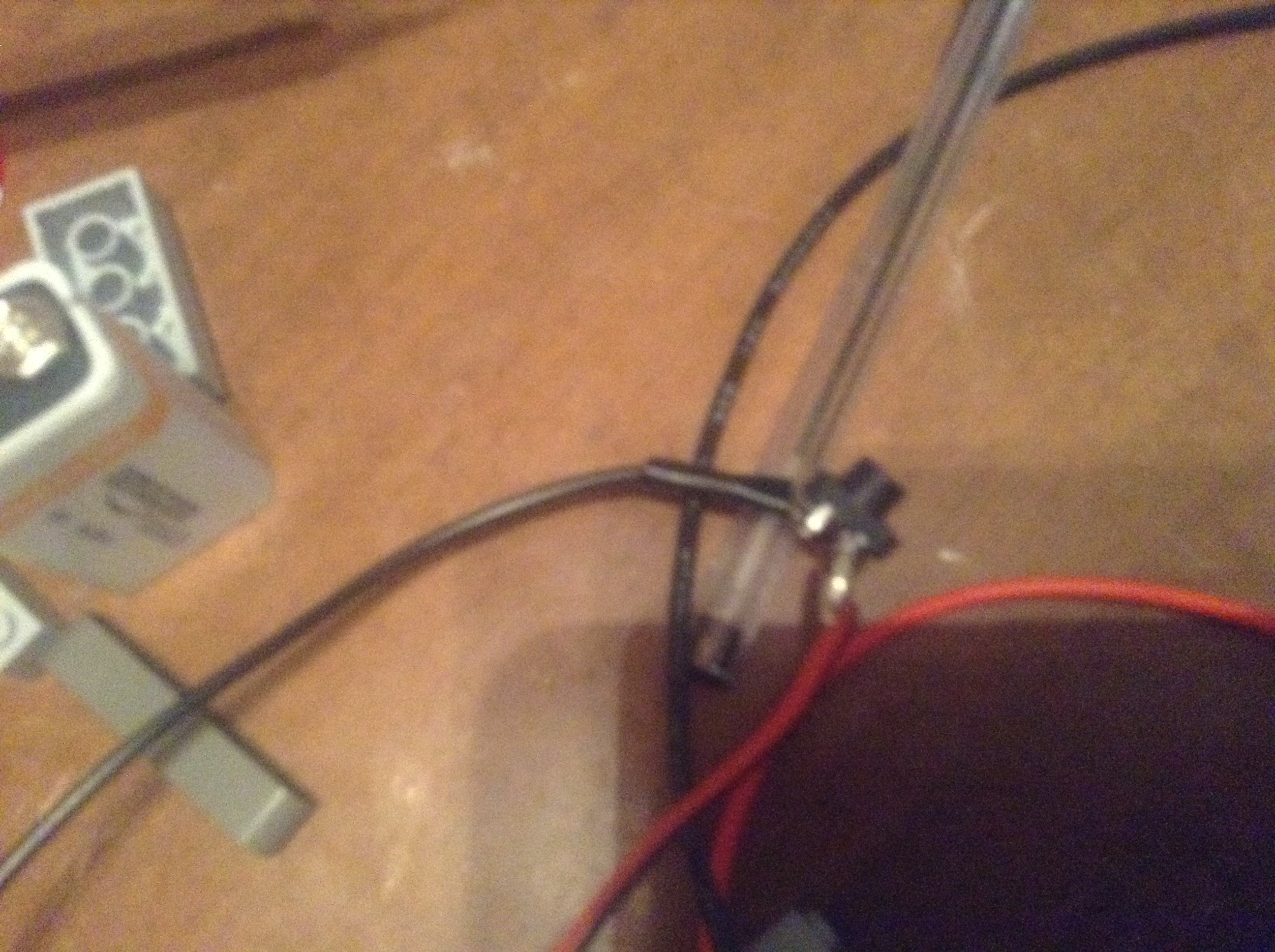

For the led eyes I mostly followed the steps laid out by James from xrobots.co.uk, except I used the plastic canvas instead of the wedding veil fabric. I did buy some fabric but I didn't like the way it looked. I will post more pictures once I get the whole system mounted, but they look just like the ones on the above website. I will explain what I did with the leds themselves.
I cut them off of the battery box, because I'm using the 9V battery to power the servos and leds. I wired up red and black wire to the appropriate ends to extend the length. Then I put the negative (black) wire into the negative rail on the breadboard and the postive(red) wire is in pin 13 on the Arduino. There is a length of wire between each LED on the strand, so I just bent it so each led sat next to each other on the lenses.

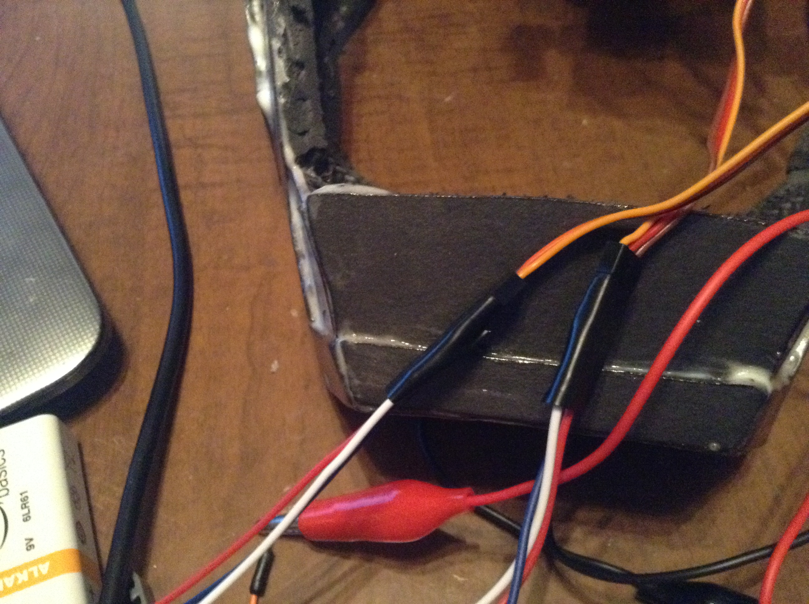

Mounting system:
I'm still working on this system and will update when I have it working. So far I'm trying to use some Lego pieces to make a hinge on the inside of the faceplate and have pieces connected to the servos. Here are some pictures of what I have.
