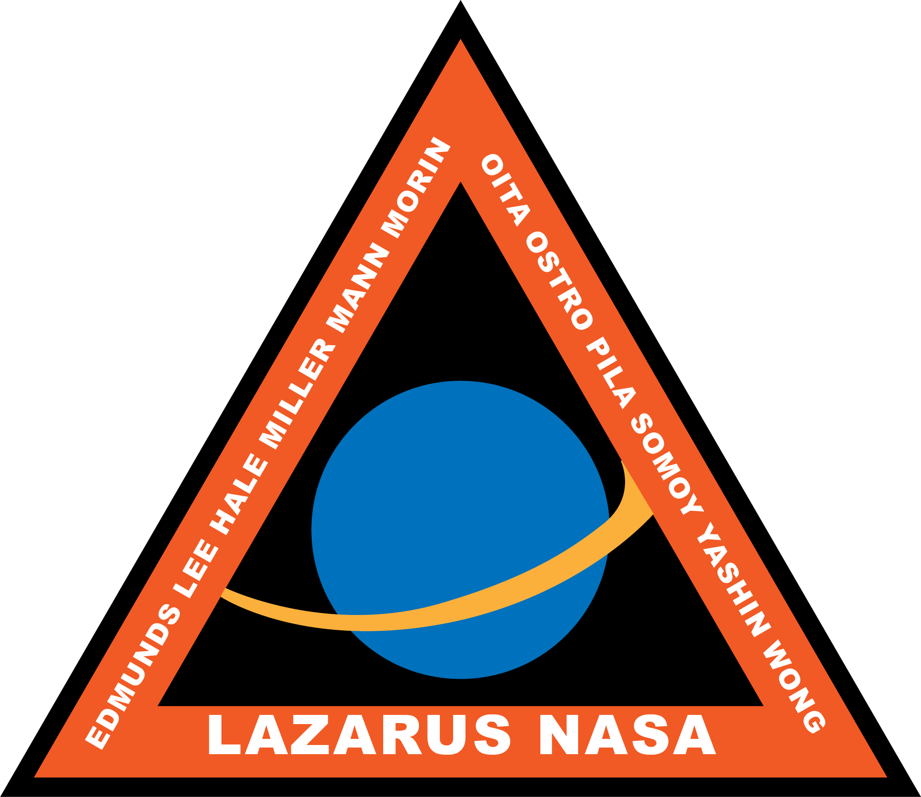

For Dr. Mann's spacesuit, does anyone know what the triangle patch says? I can make out the LAZARUS NASA but not the rest. pwTGQw5.jpg

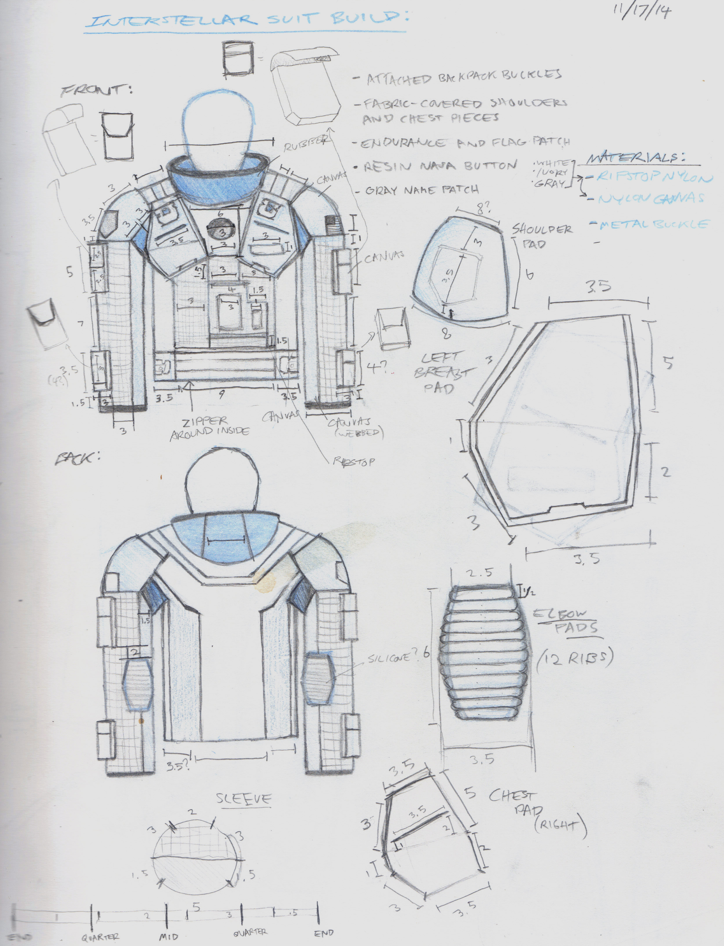

While I am not new to making, I am brand new to the RPF. I am planning to build the Interstellar suit, so I registered to join in the discussion. I have read through this entire thread and I was wondering if anyone is still pursuing this project? Or have any of you completed your Interstellar suit? I studied costume construction as a minor in college, so I am pretty handy with textiles and most things under the heading of sewing. I don't know what use that might be to any of you, but I am happy to offer help or advice if it is needed. Did any of you come up with a sewing pattern? I saw that Taylor Jean had posted some terrific sketches.... I will start looking at the reference material and try drafting out pattern pieces. In the meantime, if anyone is still active on this thread, I would love to have the 3D print files of the final backpack, chest piece, etc.

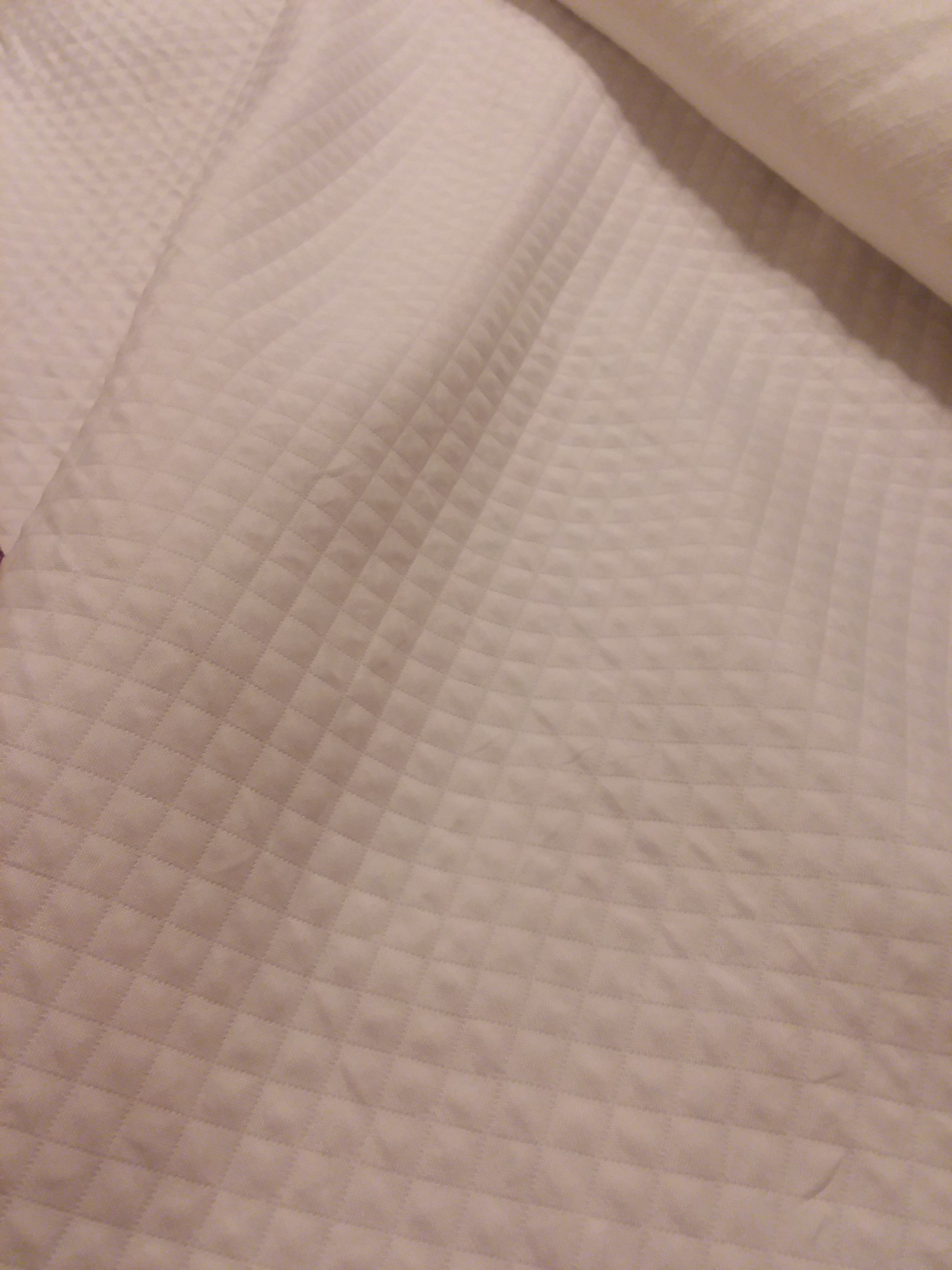

I have also been looking far and wide for the white fabric used on the sleeves and pants. Someone earlier in the thread suggested waffle weave fabric, but I don't think that's right. Whereas waffle weave has indentations like a waffle, the fabric used on the actual suits is the opposite — it appears raised, almost embossed, or even quilted. I can't tell which, and I'm having a hell of a time locating anything similar. I found one fabric, but it's a knit, not woven, which means it may be too stretchy. Look at color #32. I will update you all when the samples arrive.
Mike

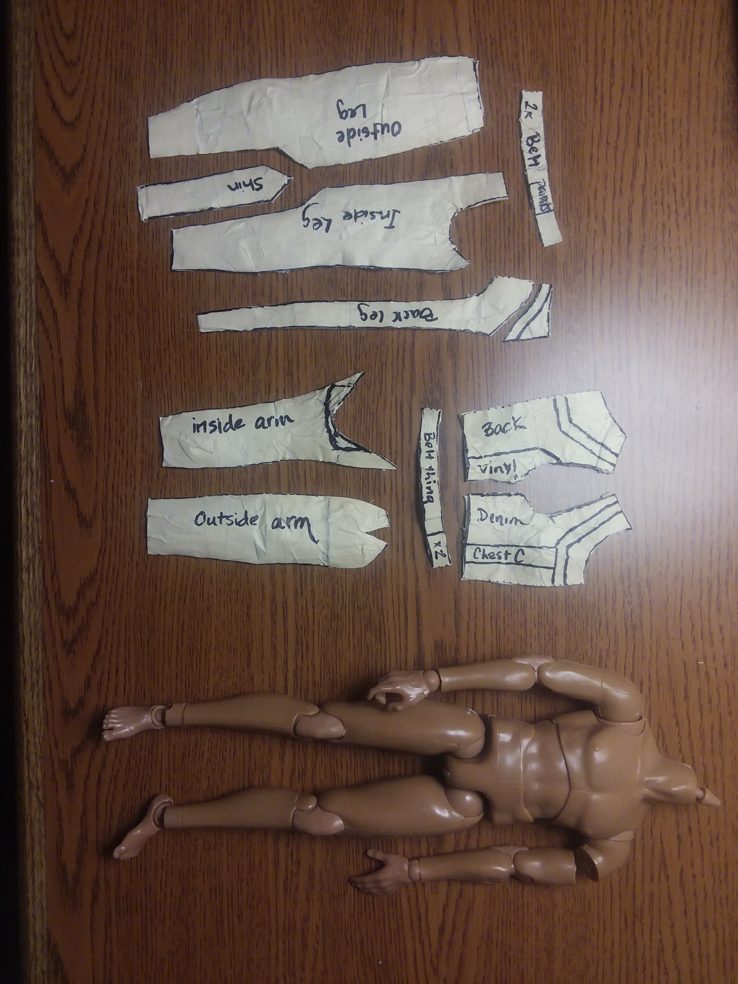

The fabric for the outer sleeves and lower legs arrived. The color is bright white, which doesn't show in this picture due to the lighting.

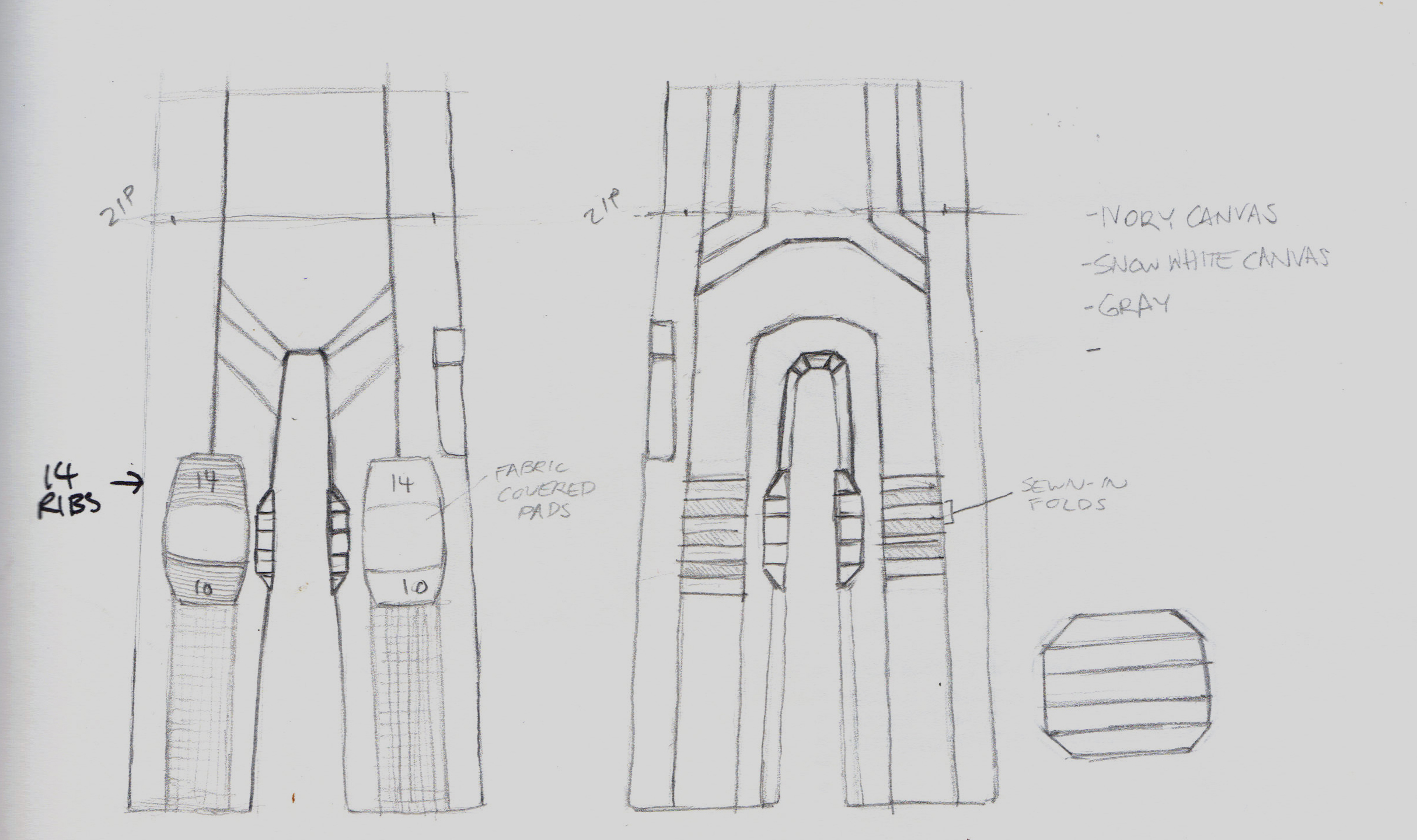

I also spent this evening drafting a 1:6 scale sewing pattern. It's pretty basic and doesn't include any of the armor, pockets, or panels. I plan to add all of that later. My poor figure model suffered an injury in the process.... By the way, if you want a 1:6 scale figure model like this, you can find it on Amazon.

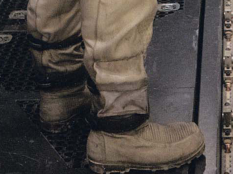

A few people posted links to rubber fishing boots and the like, but I decided to buy a pair of white military issue boots on ebay. I paid about $60, including shipping. I think they look similar enough to the boots used in the production costumes to get by, not to mention I LOVE the air valves and military text on the sides.
My focus has always been the hardware of the suit, mainly because i can't sew to save my life. These boots have the right shape, with a little modification( adding quilted material to hide the laces). You should watch the extra material on the "Interstellar" Bluray about the construction of the suits, I have watched it many times. Although most of it isn't the finished suit it very informative on how they built them.

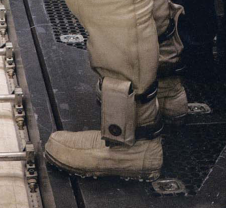

There's a suit on display in the Into the Unknown exhibition at the London Barbican. Unfortunately it's displayed rather high up, and the lighting isn't great - here's the one shot I took at the time:
There are some other great spacesuits there - Trek TMP (the orange one), Sunshine, Alien...
Jonno thanks for posting that picture. The lighting isn't ideal, but that shot will definitely aid in designing the sewing patterns, especially for the bottom half of the suit.

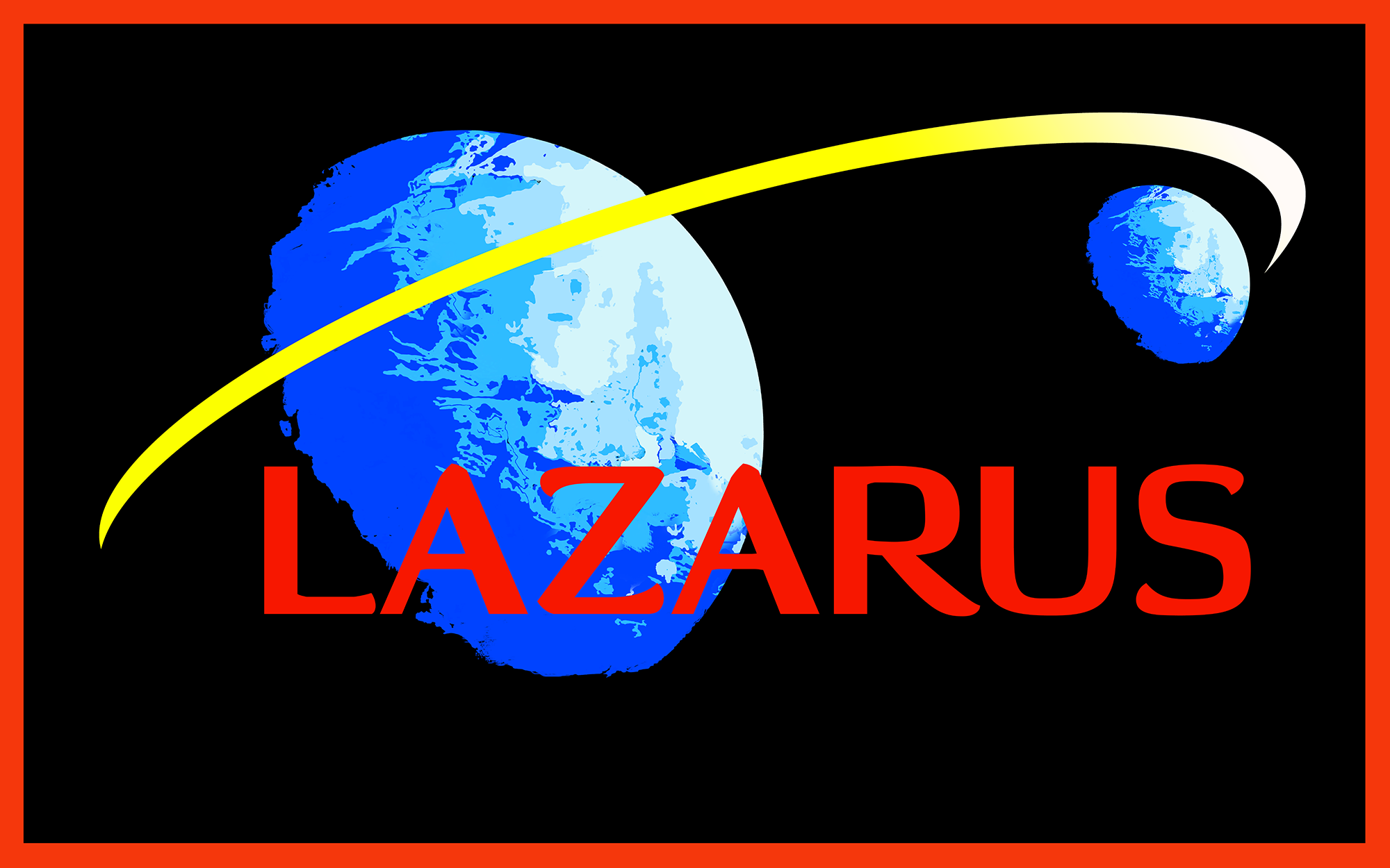

A quick mockup of the Lazarus patch on Mann's suit. Not sure if it's the right font, the images are a little blurry.

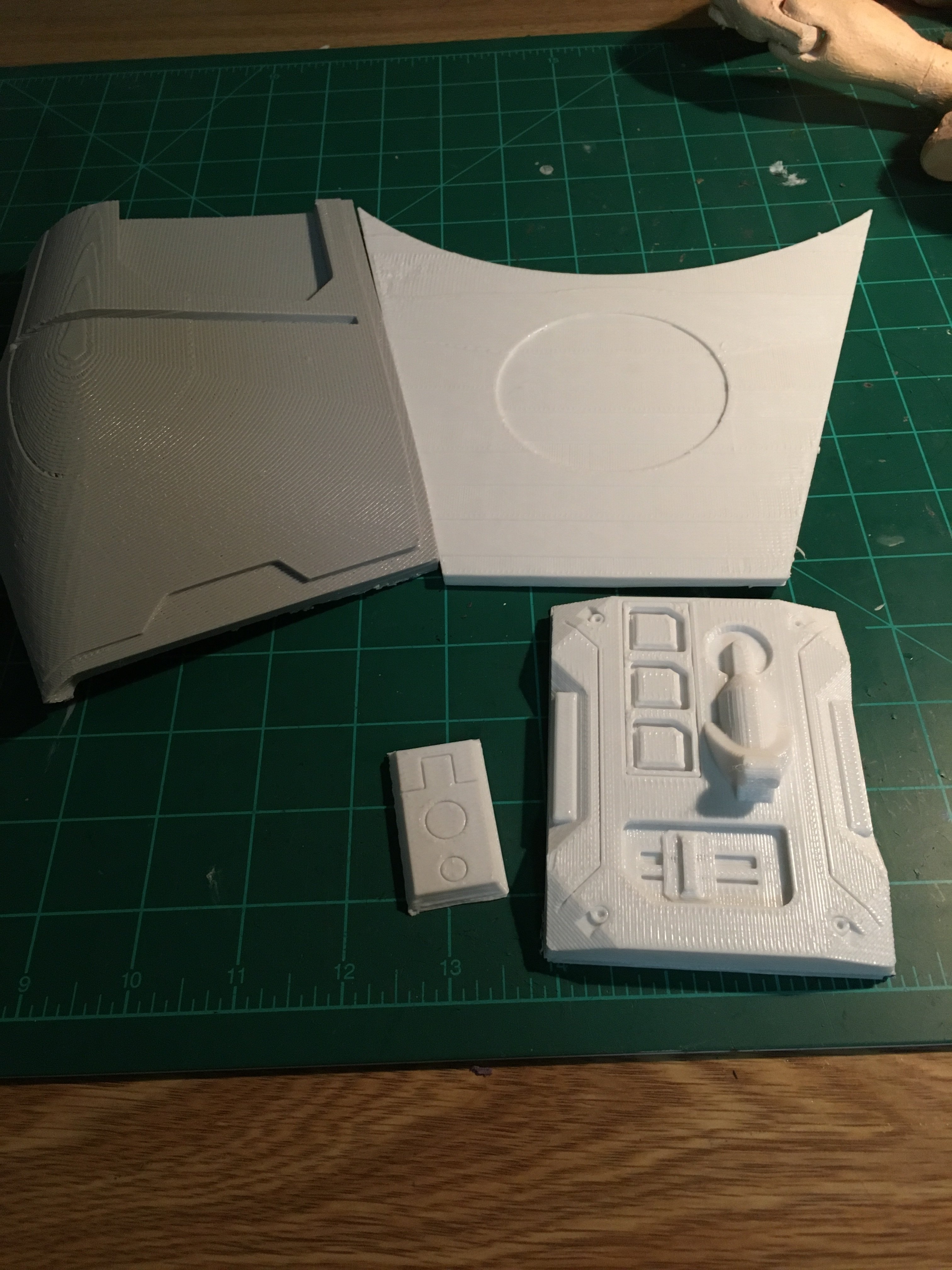

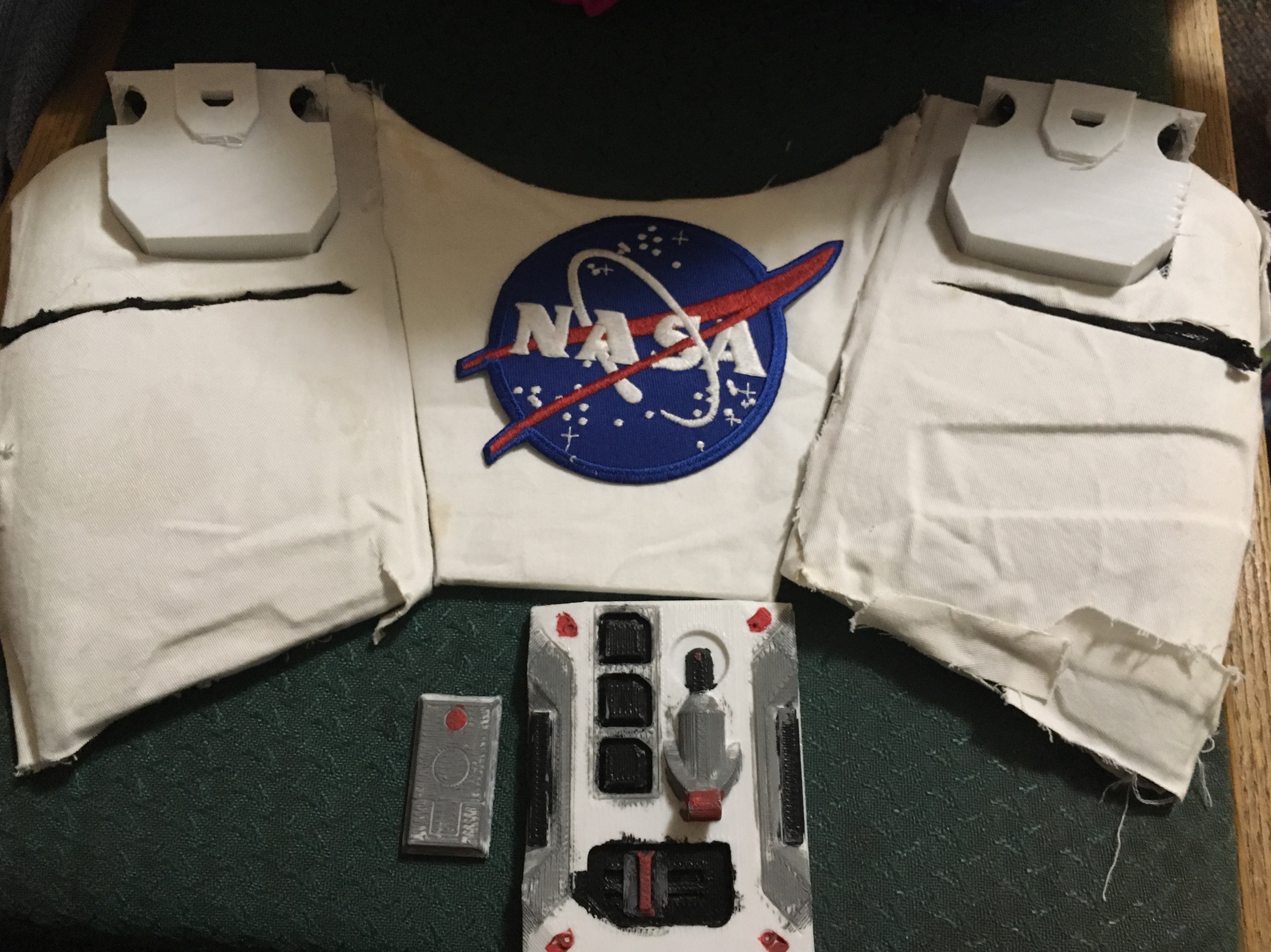

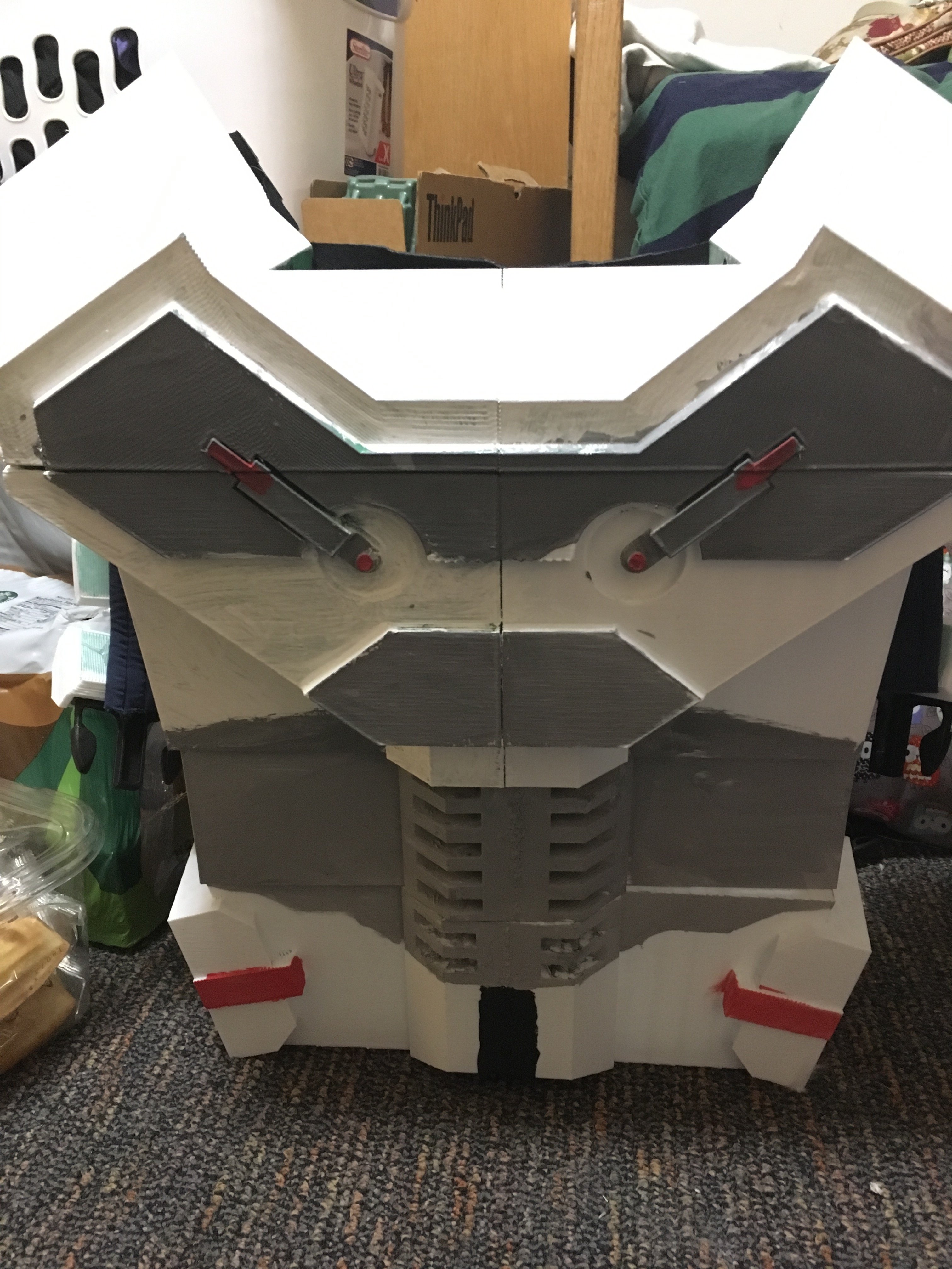

Well, I am done for the time being. My build isn't very good but had a lot of fun. Turns out PLA on fabric wasn't a very good idea, and neither was printing the entire backpack.

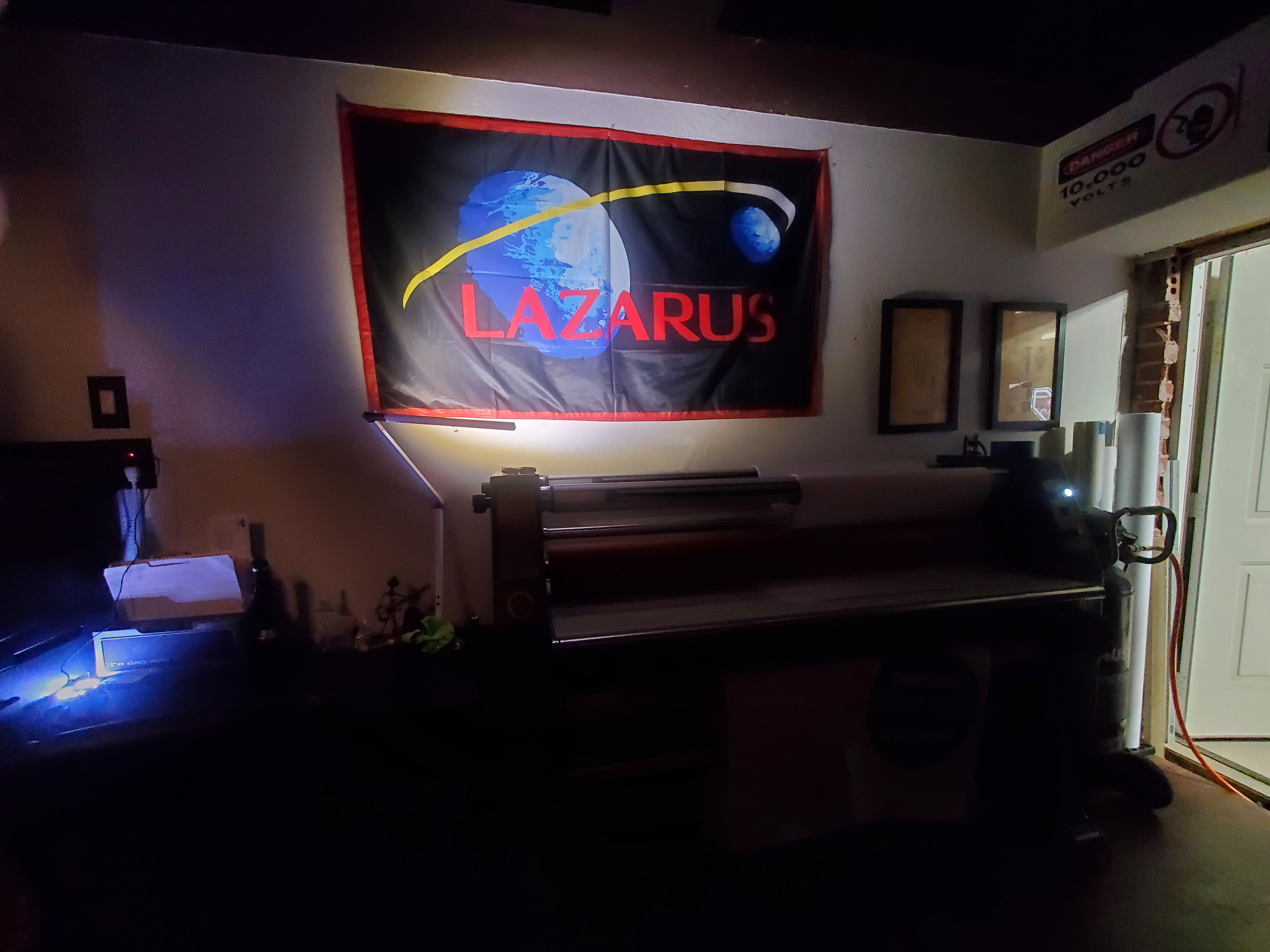

Let's pull a Lazarus as resurrect this thread ;) Google was turning up some low-quality results for this flag, so I made an attempt to recreate it.
Accurate: planets - traced from a photo of the screen-used flag
Less accurate: the typeface. Couldn't find the exact match to save my life, this one has a similar "1960s/1970s" vibe that I was getting from the original though.
This pic is scaled down from the giant version I made, which is suitable for 3'x5' sublimation dyed custom flag printing. This is also a "6 color" version, removing the gradient from the swoosh.
