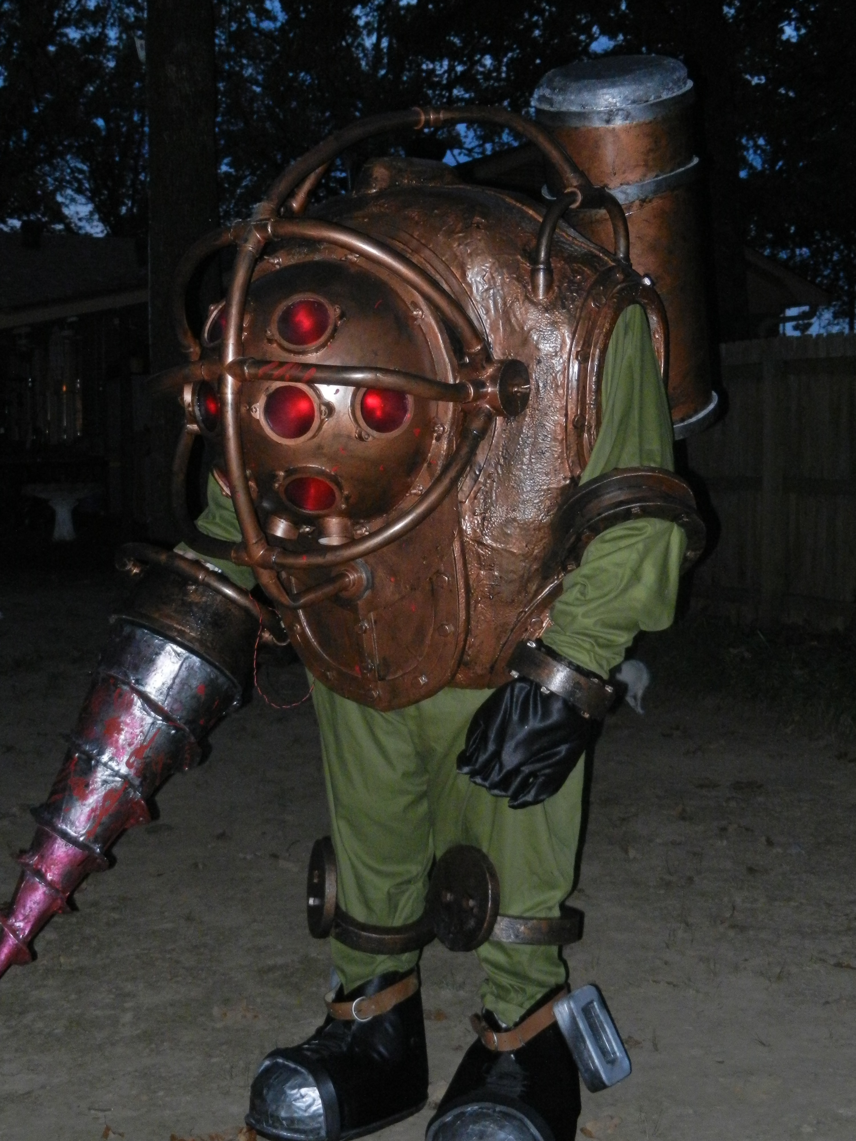

Hi everyone! Long time reader of RPF, but I never post... but I thought I'd share some photos of my (re-worked) Big Daddy costume. I had made the original costume for SDCC 2010 and while it was wearable, there was some definite...issues..... As all projects, I had run out of time, and there were some things I wasn't happy about how they came out, but the two biggest issues was that it was ungodly heavy (85 ish pounds), and swelteringly hot. I'm a 5'4" girl and pretty much the farthest thing you can get from a body builder. However, I recently had a chance to rework the costume (more importantly, make it lighter!)

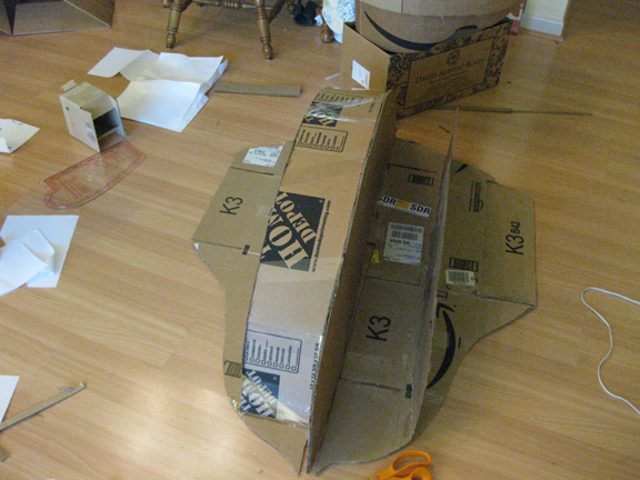

The proportioning work gave me a pattern of the front/back and side/side axises that I developed in cardboard (unfortunately, the figure wasn't available until after the costume was complete, so I had to guesstimate some of the curves in between
At this point some reconsidering should have taken place, but there was math involved! it must be right! >_<

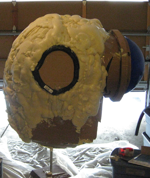

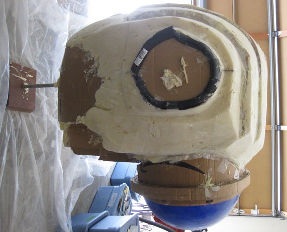

Once I finished roughing out my shape with cardboard, I then poured a polyurethane Expanding Foam (Foam-It by Smooth-On) on to the body shape. It's an awesome product which I have used for numerous other projects due to how light and shape-able it is. However, I strongly discourage you from using it for this particular purpose. I didn't do enough research before hand and assumed it could be dissolved by acetone once I finished. However, it can be dissolved by no known solvent. OOPS. *sigh* When the costume was complete I ended up having to scrape it all out with a putty knife.

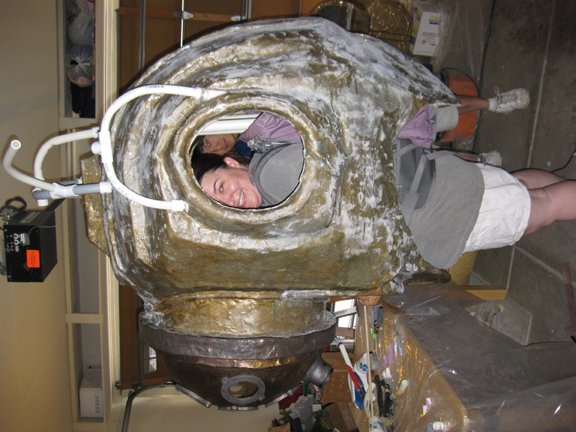

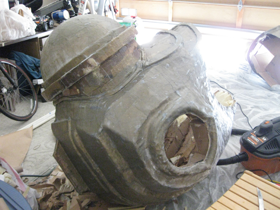

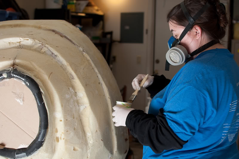

Once I finished sanding the big daddy, it was time to break out the fiberglass.
I used a epoxy resin (EpoxAmite by Smooth-On and S-Glass. I chose to use these two products because they offered the greatest strength in relationship to weight (as far as I'm aware of, anyway), and were within my price range. The big daddy has approximately 3 layers of S-Glass, more on the edges and support sections. The basic body shape that I'm working on now, weighed 22 pounds and is amazingly sturdy. (However, 22 pounds is only the body by itself with nothing on it. The whole costume is about 75-85 pounds) I've bonked it about quite a bit and the only (minor) cracks are on sections that I missed full coverage on.
Fiberglass is done, the innards partially removed.

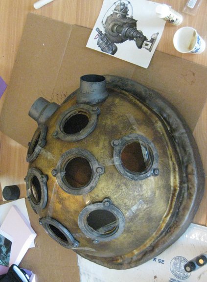

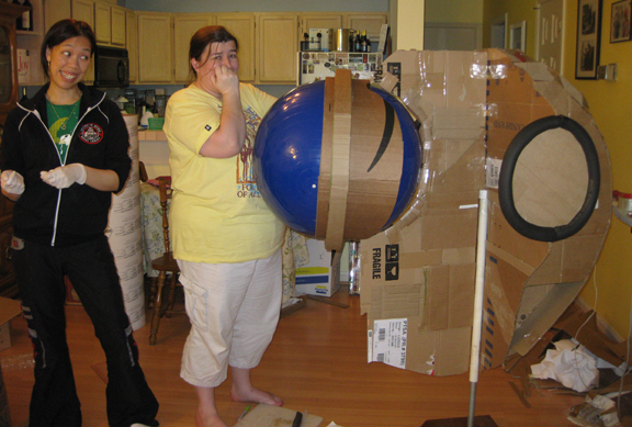

THE DOME! The bane of my existence, lol. I originally wanted to make the entire big daddy as one piece, because it would be stronger and lighter (connection points adds weight and lessen sturdiness). However, the finished shape would just be too big and therefore, untransportable. So, the dome attaches to the suit on a raised ridge. I first fiberglassed the dome (i.e. yoga ball) and the entire ridge, being careful not to have any of the fiberglass pieces extend to the body of suit itself. I then put mold release (i.e. vaseline) on the back of the raised ridge. I then fiberglassed the body and the back of the ridge. Once it was entirely cured, I carefully slid a knife between the layer attached to the body, and the layer attached to the dome, punctured the yoga ball, and pried the two layers apart. The dome piece would now bolt on to the resulting flange.
I cut out holes for the portholes, and the portholes were cast out of resin with acrylic discs for the windows.

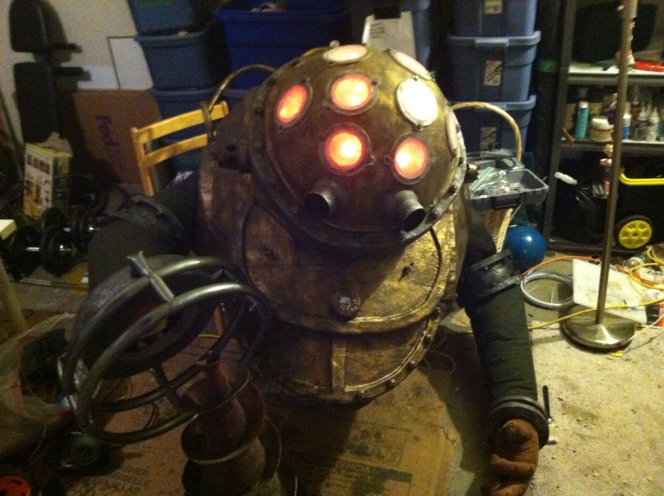

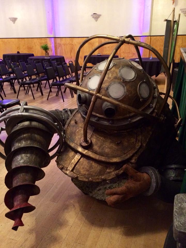

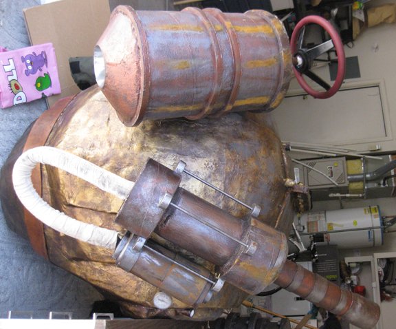

My favorite part, the tanks!

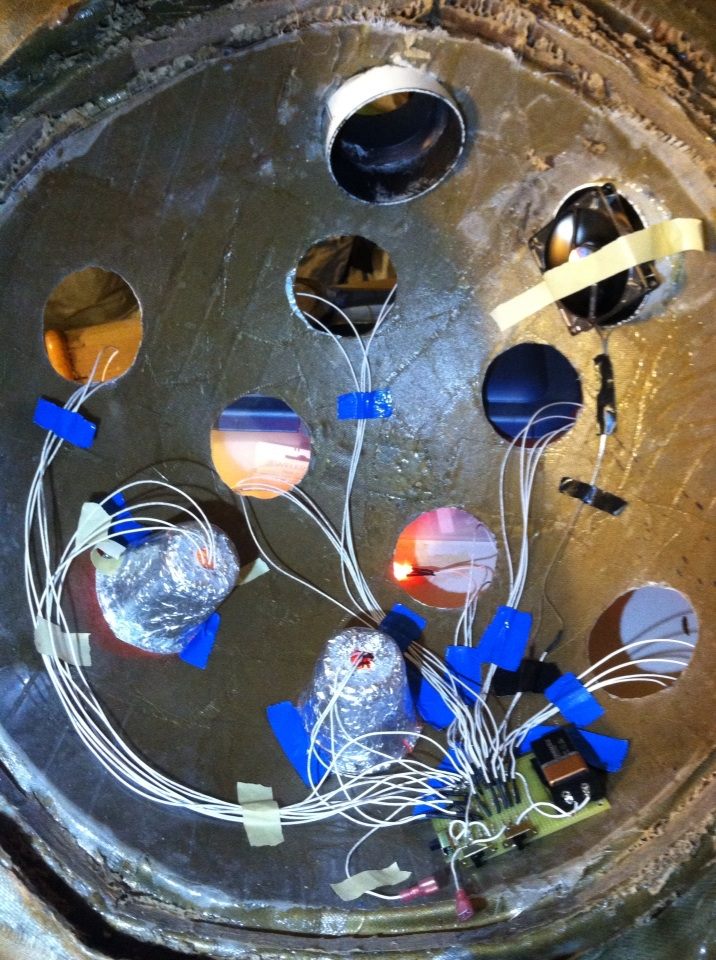

Dome lights and fans in progress
